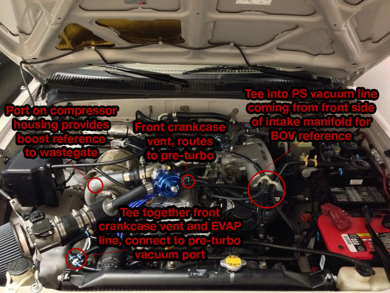

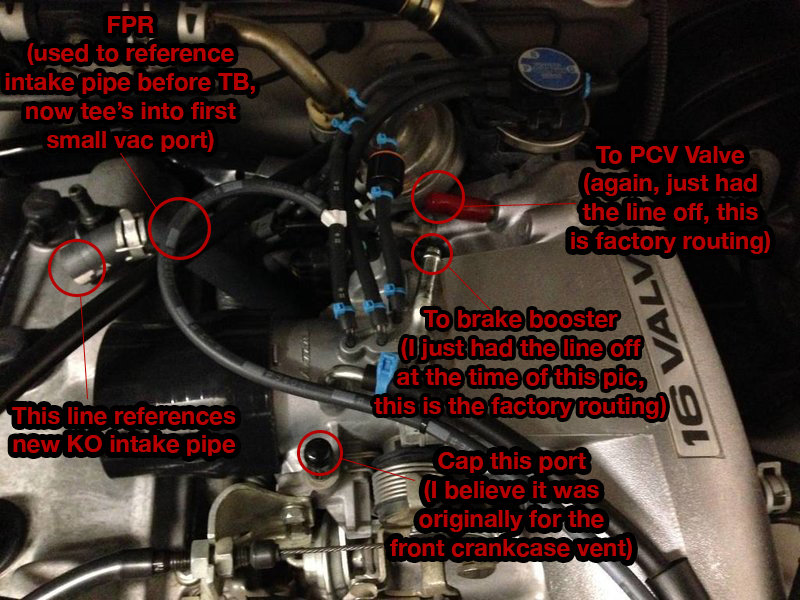

I just whipped these up in Photoshop, hopefully they help clarify the vacuum routing. It's pretty straightforward for this engine, but I definitely know that it can be overwhelming trying to figure everything out at once. If you don't have bulk line in stock, I recommend picking up an assortment (SiliconeIntakes is a good source), as these lines are at least three different sizes (can't remember exactly how many different types there are).
I believe that covers vacuum for the turbo conversion, but it's been a couple years since I did mine so I might be missing something. If you need any clarification just let me know.
I've got this stuff figured out:
Bov is 100% plumbed, directly to front of intake so it gets vacuum at idle.
Factory stuff is good, PCV and Booster left alone. The EVAP vent goes to the pre turbo intake port by the bov recirculation port.
I know the FPR needs to see boost but not vacuum.
I'll get that front crackcase vent hooked up easily.
Really my main problem is I have a line from the fitting on the compressor housing, it comes to a tee with one port plugged, the other had a line, I don't know what to. I know this connects to one of the wastegate ports.
And, the wastegate is a huge one, I don't know anything about the vacuum function of it, and my tial 38mm has 4 separate ports, I know what none of these do.

I'd venture to guess that the tee with the port plugged originally ran to the wastegate, with the other port that is now plugged running to a boost gauge. I have my boost gauge referencing the brake booster hose since it was best for routing in my case.
For the wastegate itself, if you are running it on spring pressure only (i.e. no boost controller), take a look at this diagram from TiAL. You should be leaving the top air ports open, and plugging two of the three bottom air ports. Then, run a vacuum line from the compressor housing nipple to the last open bottom air port. You should have a banjo fitting/nipple to facilitate connection to that air port, as well as thread-in plugs to plug those remaining two bottom air ports. There are also water ports if your wastegate is a v-band MV-S (not sure about the old flanged 38mm), so make sure to pay close attention when plugging ports. The water ports can be left open if not water cooling, as they bear no weight on boost control at all. Hopefully that helps. Also, don't forget to make sure the correct wastegate spring for your application is installed in the wastegate before bolting it up in the truck, as its a royal PITA to change the spring afterward without pulling the wastegate again.
That's mine the V-band MVS. Sounds simple enough, from that I'm getting that I just need the line from the turbo ran into any of the lower ports, plug the other 2 and the rest is all irrelevant to me. Nice, I was hoping it would be that easy.
