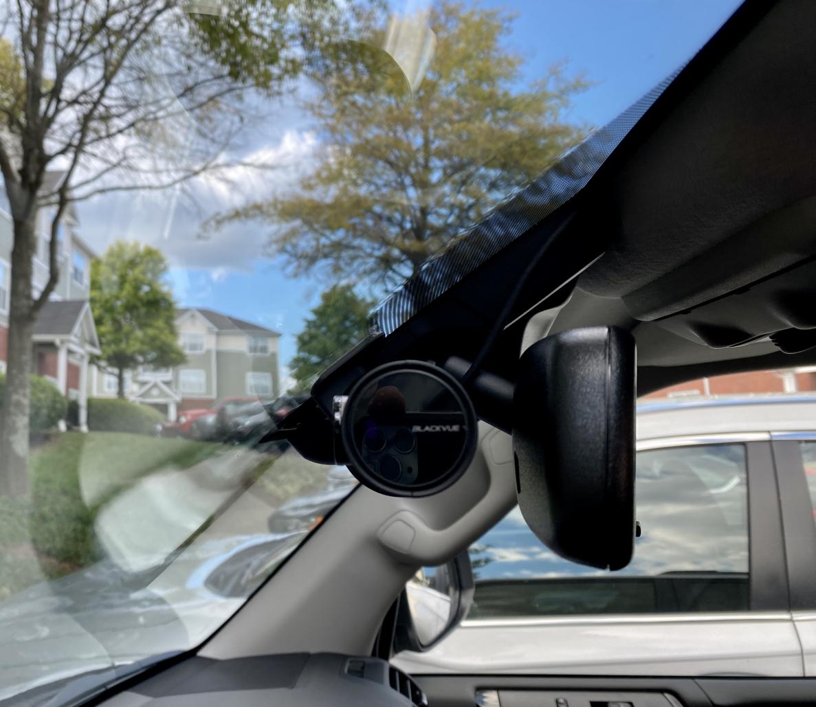

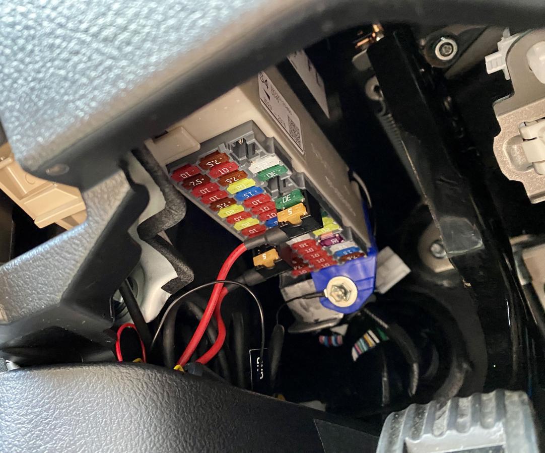

Answering my own post, in case it helps someone in the future. It's all pretty easy, once you actually know what you're doing (which I didn't). For clarification, this is for a Blackvue 900x, with the included hardwiring power cable.
I was able to tap power - both switched and unswitched, from the fusebox under the dashboard. You need two fusetap devices in the Low Profile Mini (ATM-LP) size. In my 2021 ORP these is one unused fuse spot, that has always-on power, so use that for the BATT+ connection, And you can use just about any of the fuses on the other side for the switched (ACC+) connection. Definitely check with a DMM to make sure that the fuse socket is switched, and to make sure which side is live so you can orient the fuse correctly. Find instructions on how to use these fuse taps online if you're not sure. There is a large obvious bolt right behind the fusebox that you can use for the ground connection - you want a 10mm nut driver to remove and retighten it. Note that your fusebox cover won't fit back on after doing this - store it in a safe place until you decide to change this, or sell the car or whatever.
Running the wire is simple - attach the camera to the windshield, plug in the power cable, and start tucking it - first behind the headliners, then work your way around above the A pillar cover, then down behind the weatherstripping - use your spudger of choice to make it easier, although you probably won't need it for most of this. Then there's a little pocket to the side of the fusebox you can put your surplus wire into. Disconnect the wire from the camera before making the power connections. After making all the connections, tuck the remaining loose wires into that same pocket. Then plug in your camera and let it do it's thing - done!
I haven't wired in the back camera yet - still trying to figure out how to best attach the camera to the headliner.
