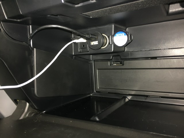

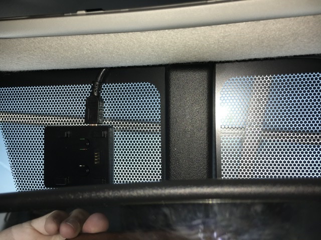

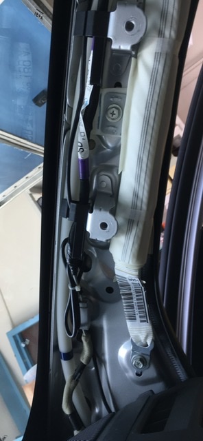

I installed my Viofo A129 today. I ended up using the cig lighter adapter in the glove box and ran the power cable down the passenger A-pillar. Was nervous about pulling covers but it ended up pretty easy and looks clean. I may do a more permanent hardwire down the road.
Took a few pics…
Edit: Fixed upside down pics.
