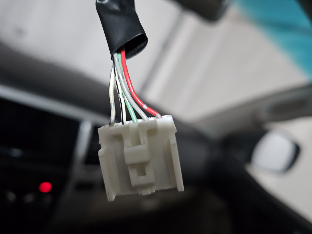

Hello all,
New to the forum, with a 2008 SR5, and looking for info on how to wire my dashcam to my moonroof wiring. My multimeter is FUBAR, and I don't have a schematic. Anyone know the pinout for these wires? I need 12v ignition and ground. Thanks in advance!
So mine uses something like this. It is a power plug with wiring that taps into a fuse spot. I basically run the wiring through the head liner, down the pillar down the left of the windshield and into the dash and the little interior fuse panel next to the steering wheel. It plugs into a fuse spot for 12v, ignition on slot
