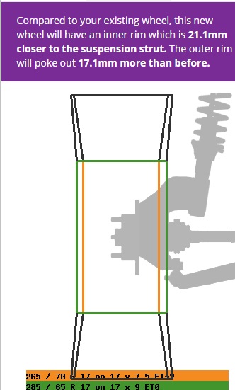

You know guys, I didn't realize it yesterday, but there is a 285/65/17 option as well. That tire is 1.2" taller than the stock 30.4" but 1" shorter than the 285/70/17. That might be the ticket and work well with the amount of Daystar lift I will have. Here is a comparison, pictured below:
Stock 17x7.5 30mm Sport wheels with 1.25" spacer and 265/70/17 (what everyone seems to run with Daystar) VS. 17x9 0 offset wheels with 285/65/17:

Also curious to know what BMC is? I'm in a similar situation here. I ordered my wheels but have 2.5" lift along with 4 new 17x8 zero offset with a 265/70-17
Did enough research to eliminate the 285/70/17
So now the question is do the 275/70/17 or the 285/65/17. The latter has limited brand options but the 275/70/17 will still be a very tight fit.
Decisions decisions
BMC is body mount chop. The body mount behind the front tires. The front tires will rub there in many cases.
