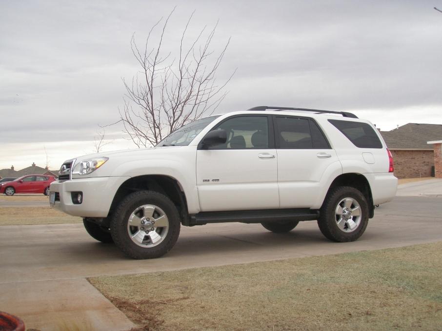

My TE finally got some attention this weekend with some help from a friend using the above mentioned instructions. Install was very straightforward. The Daystar kit I installed was the combo preload/topout kit still available from wheelers offroad and required disassembly of the front shocks for the spacers but with a heavy duty spring compressor this was very easy. Overall install time was right around 4 hours with plenty of time spent making sure we werent breaking anything or double checking things were back to together properly. If I had to do it again I could do it with a friend in probably 2.5 hrs. The rear was pretty easy too but def needs two people. With the preload spacer the ride is firmer but still very comfortable. Tires are 255/75r17 GYSA's on ProComp 7098 17", there is some minor rubbing but only at full lock in reverse coming down my driveway. Tires need some more help in the balance dept but Ill be working on that this week. Alignment also ran into typical issues, initial alignment resulted in a very twitchy ride but after I took it back and told them to max out the caster (2.1 a side was all I could get) the steering is much more manageable. Overall extremely happy with the results and the writeup here certainly made for very smooth sailing.

Finally installed my Daystar 2.5/1.5 today. Father-in-law helped out and took about 4-5 hours. Rented the strut/compressor from Autozone. Figured out I need to invest in a new hydraulic lift that provides at least 20" of lift...
Thanks for your write-up Richierollz!
Here are my measurements I took pre/post install:
Grount to highest point fender.
Stock (approx.):
Front L - 33 3/8"
Rear L - 35 3/8"
Daystar installed (approx.):
Front L - 36 3/8"
Rear L - 37 3/8"
