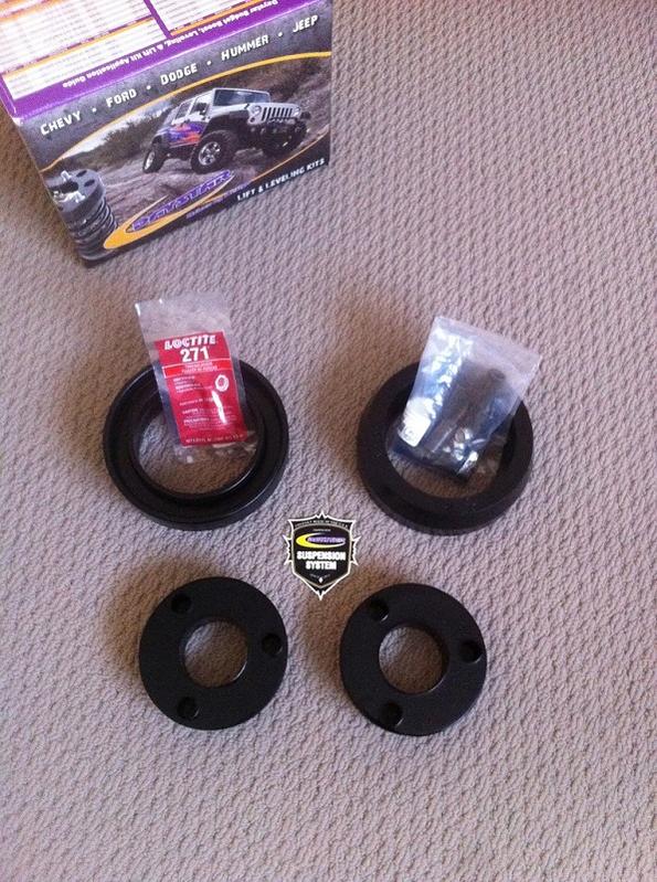

Now it's my turn..
Bought them yesterday from a local dealer. Only one kit in Edmonton.
DS 2.5"/1.5"
Will report later!
Max
