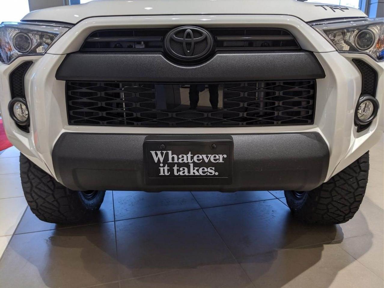

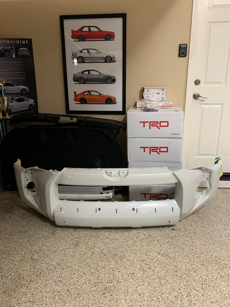

Just picked these up from the paint shop tonight. The valances use to be silver. The scoop was unfinished. I was going to use the finished scoop which is already black but I want the valances to match. I’m sure these will chip in a few weeks [emoji12]
But for now .. they look so purty :-)

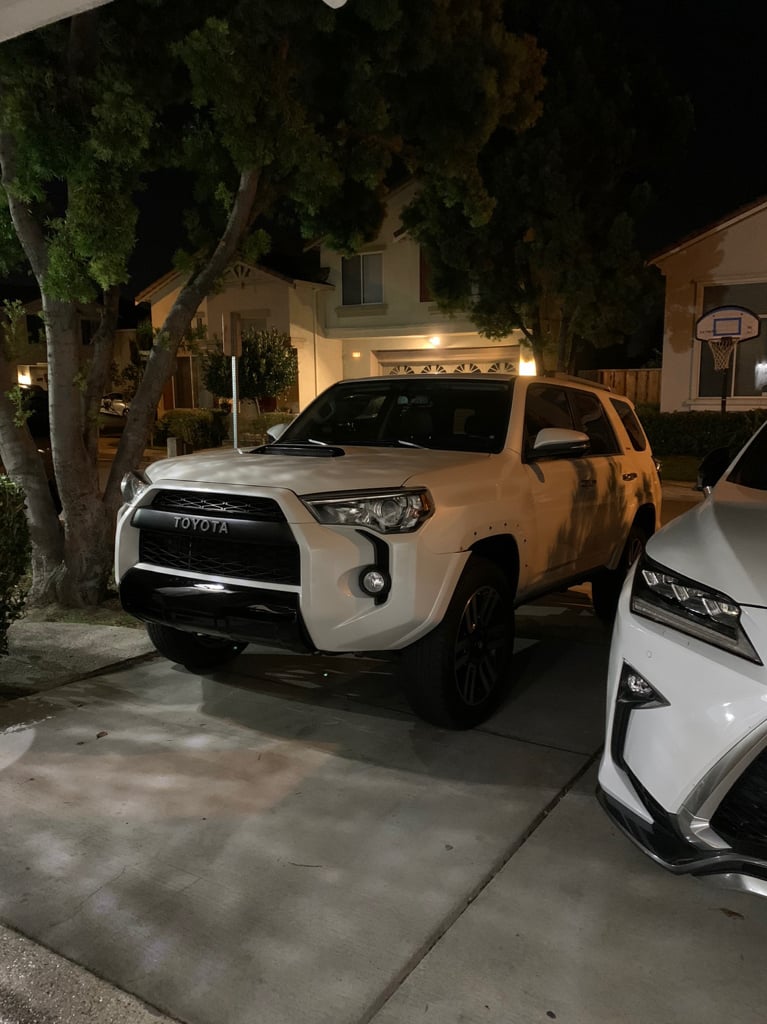

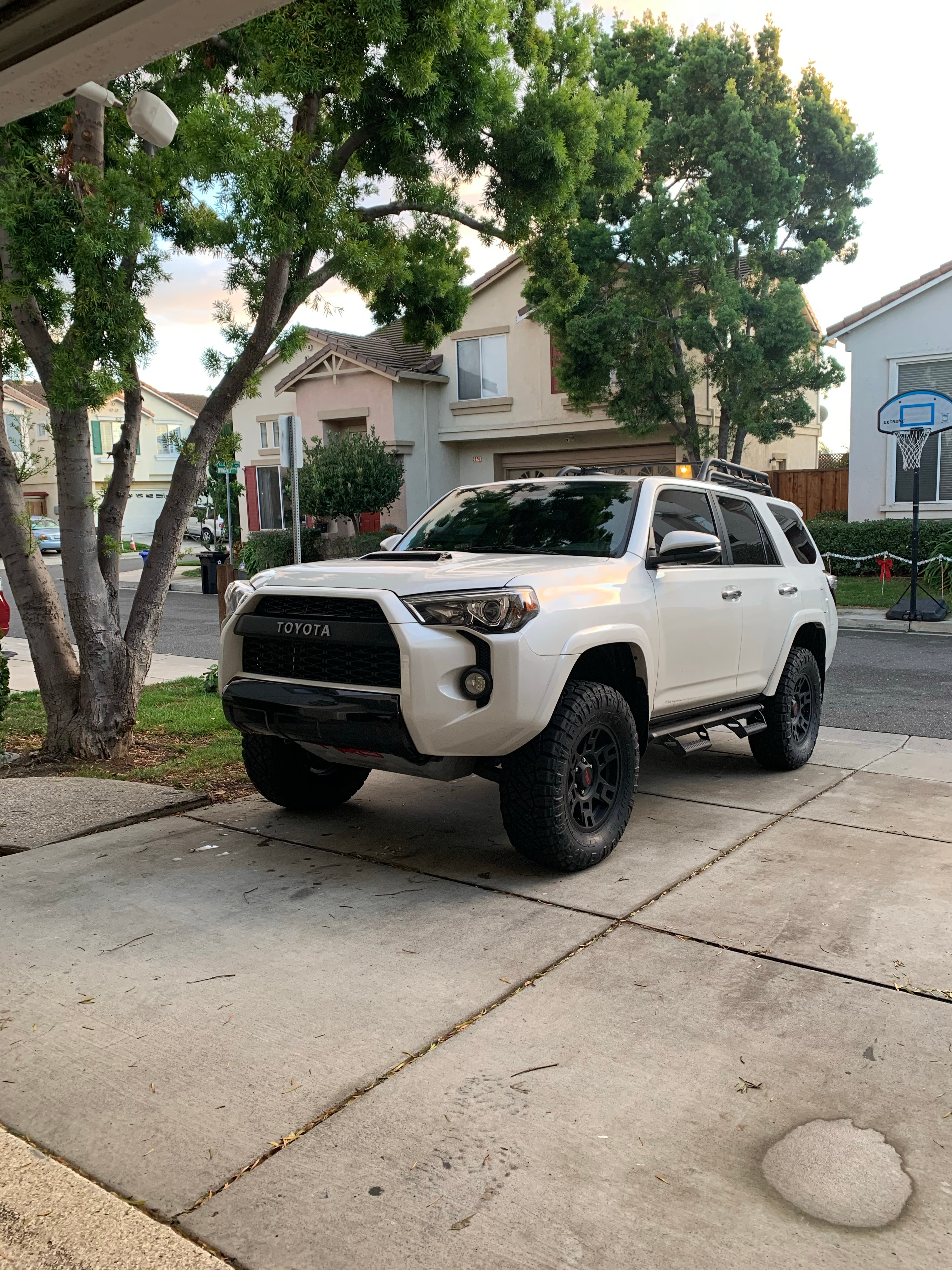

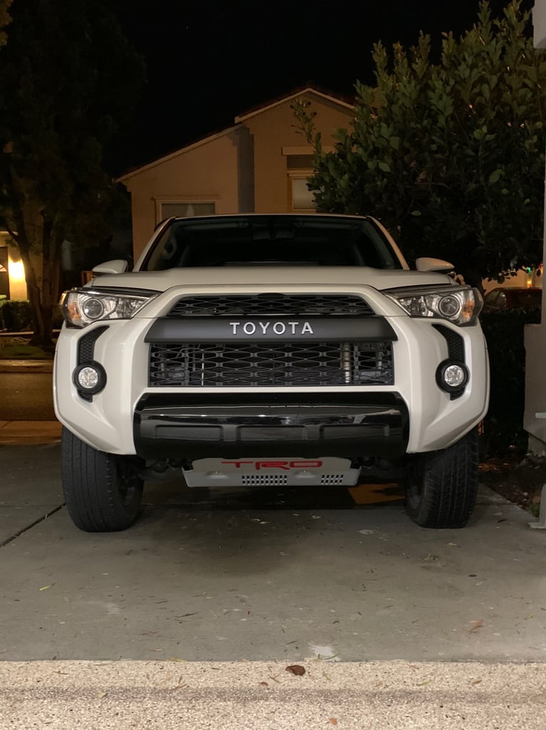

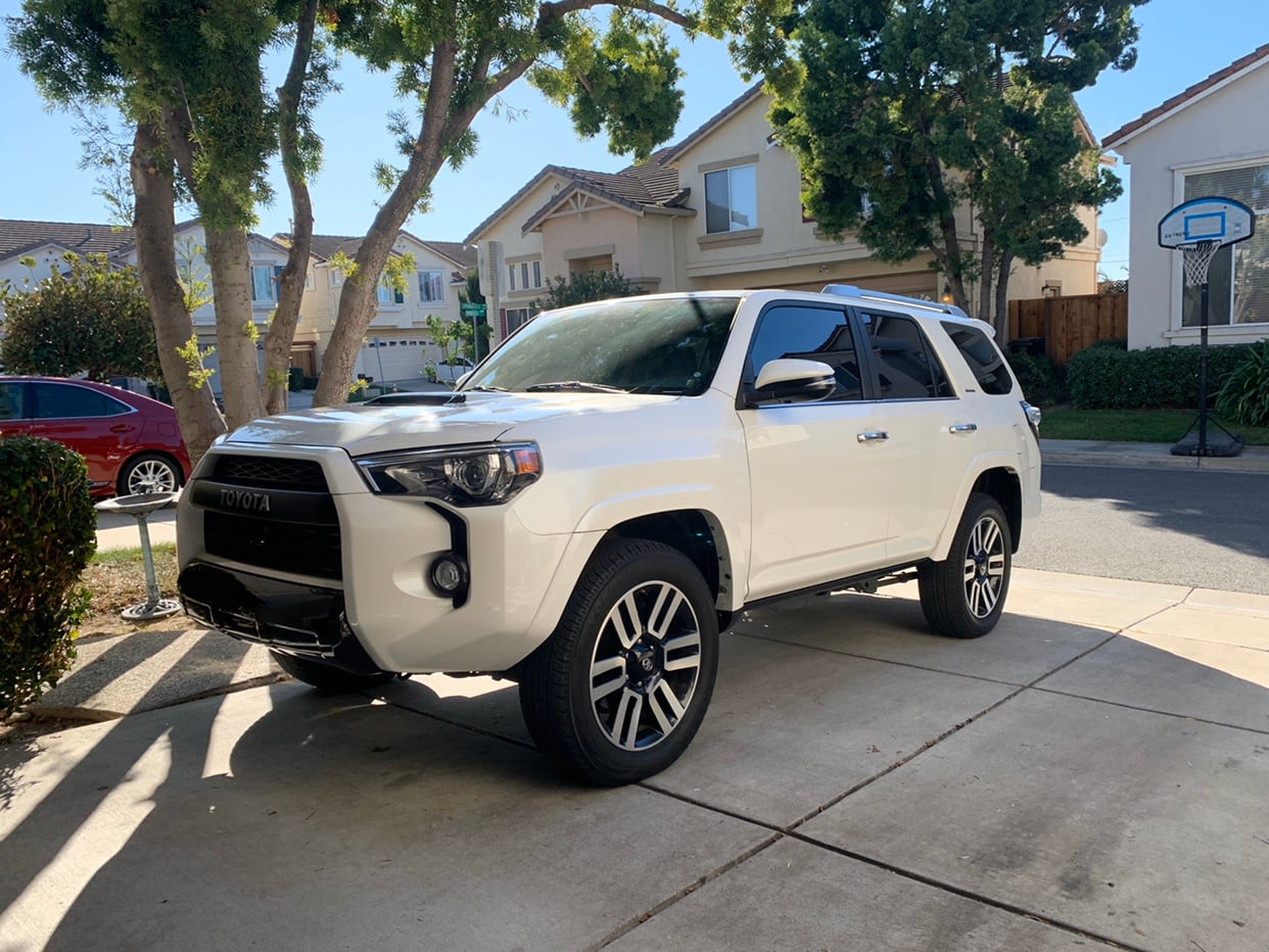

Spent a few hours Saturday afternoon and few hours today. I was able to complete the following
1. Fender liners
2. Rocker panels
3. Hood scope insert
4. Front bumper
5. Pro grille
Unfortunately while taking off the front fender flares (required when removing fender liners) I broke several clips on the fender flare. I can’t believe how weak these were. I ended up using epoxy to repair the clips. I learned that the clips used to hold in the fender liners are not reusable.
Before
After
Fixed fender flares

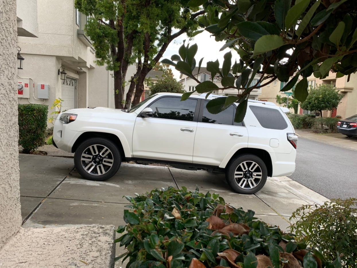

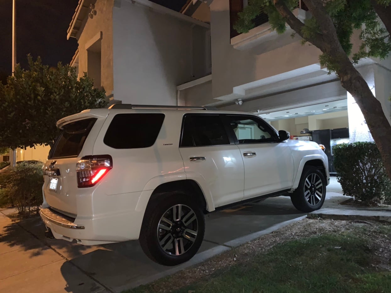

trd trim on limited

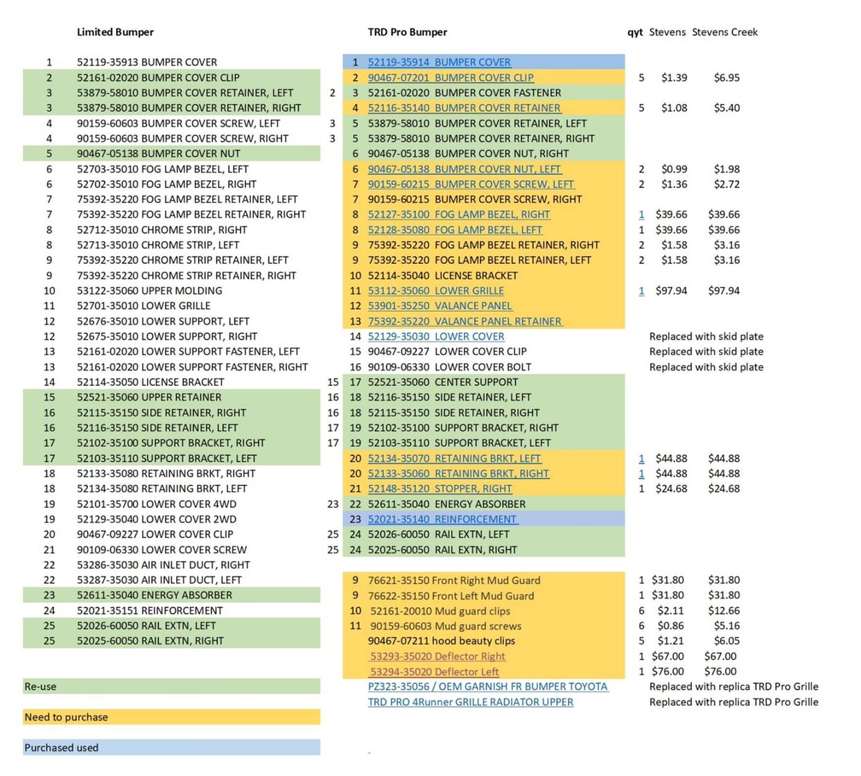

Hi Daytonaviolet,
Im looking to do the same TRD conversion to my 2016 limited.
What parts were needed to complete the front bumper?
Thanks any info helps.
Hi Daytonaviolet,
Here's my bumper list. Let me know if you have any questions. Some of the items I put qyt5 as I was unsure how many clips I needed. But most of the clips I re-used. Let's just say, I have some extra clips. :bravo:

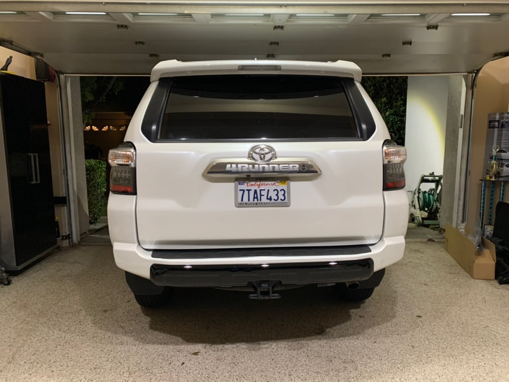

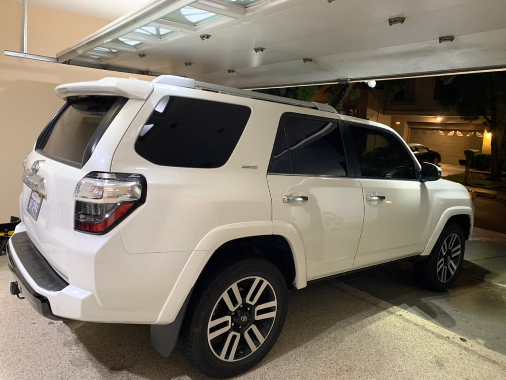

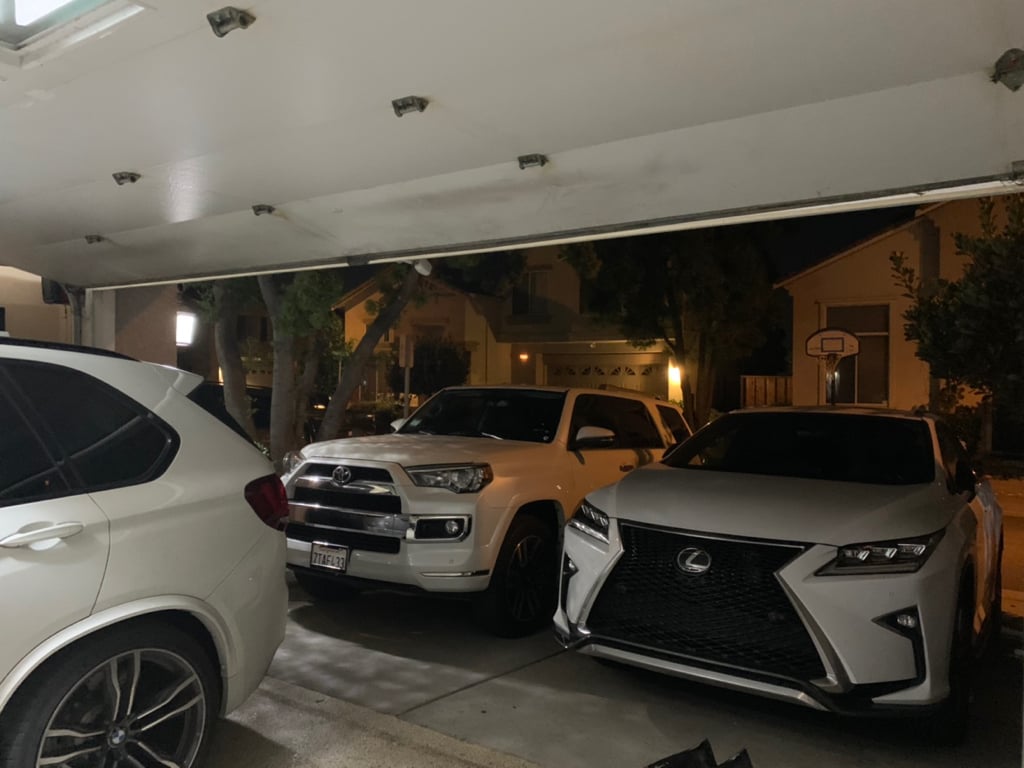

Could we get some side shots to see how the bumper hangs as compared to the rear? Is the rear bumper noticeably lower now? Also, did you retain the rear parking sensors?
I’ll take some today. As for the rear TRD bumper, I may install those tonight. If not for sure this weekend. But yes, the rear will hang down like 2”. I plan to re-install both front and rear parking sensors. For the rears, the outer ones will be in the standard location. The two inner ones will be on the valance. Well that’s my plan.
Were you able to reuse the limited reinforcement, or did you have to buy one?
That would be #24 on the limited list, unfortunately no. But luckily, there are many folks doing the winch style bumper or full metal bumper which requires them to remove the Sr5/TRD reinforcement bar #23. Usually you’ll find them used on the forum or Craigslist .
Only the items in green transfers over.

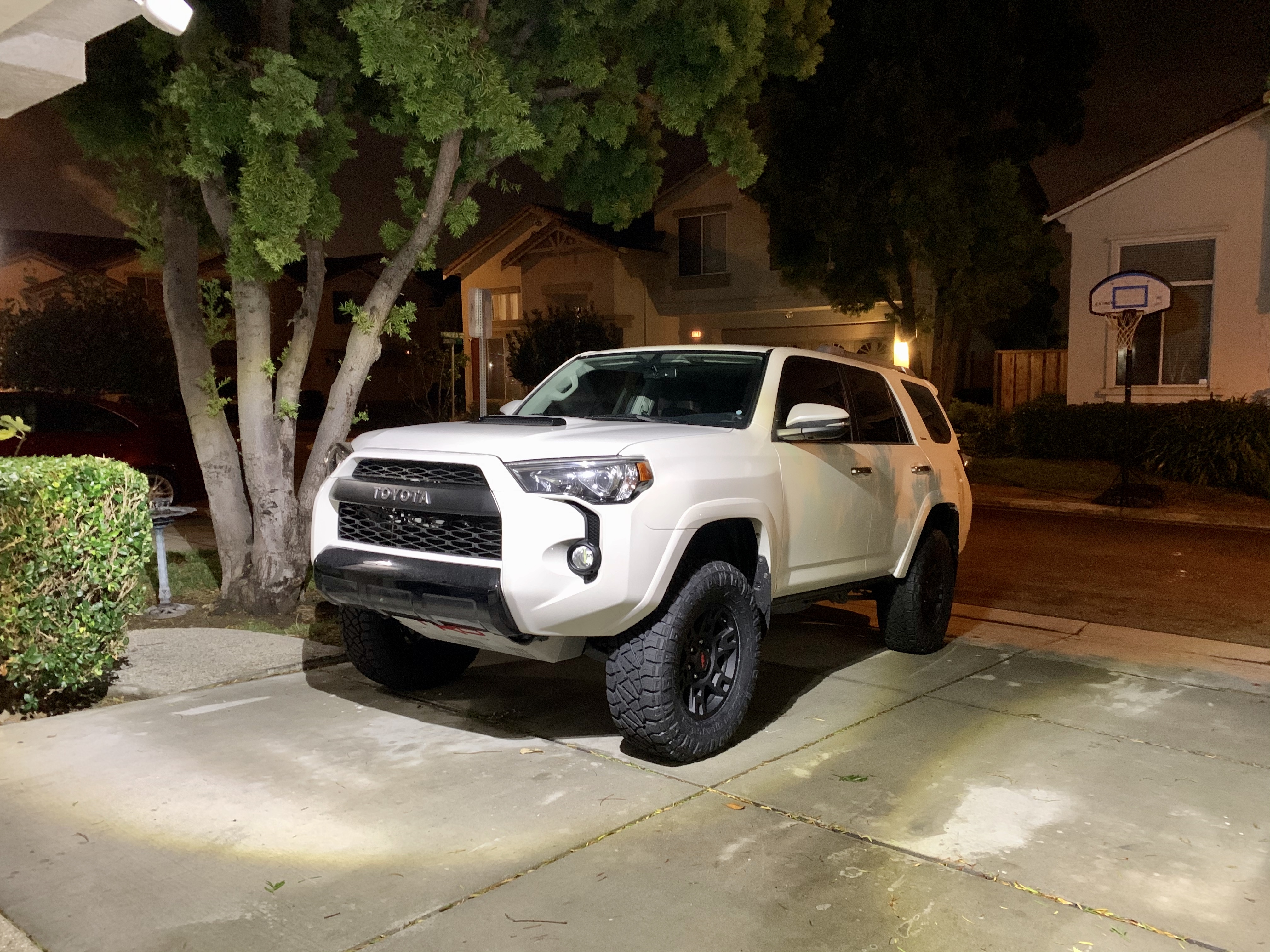

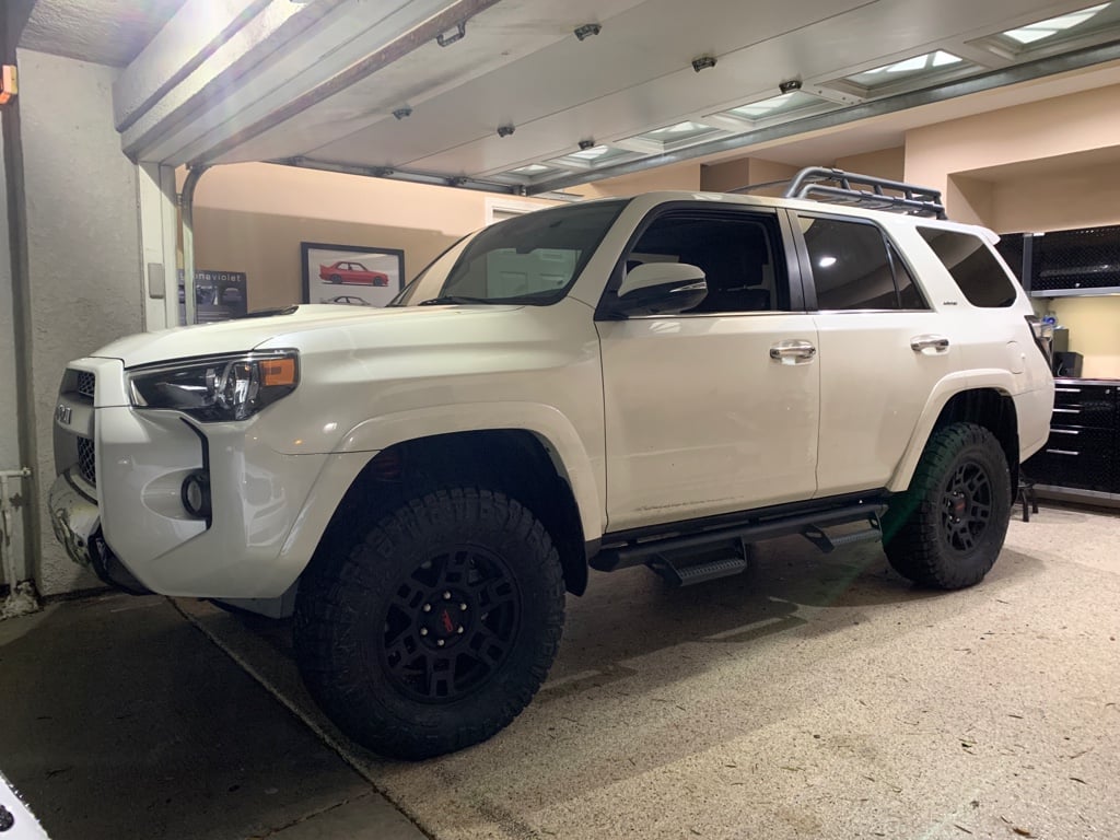

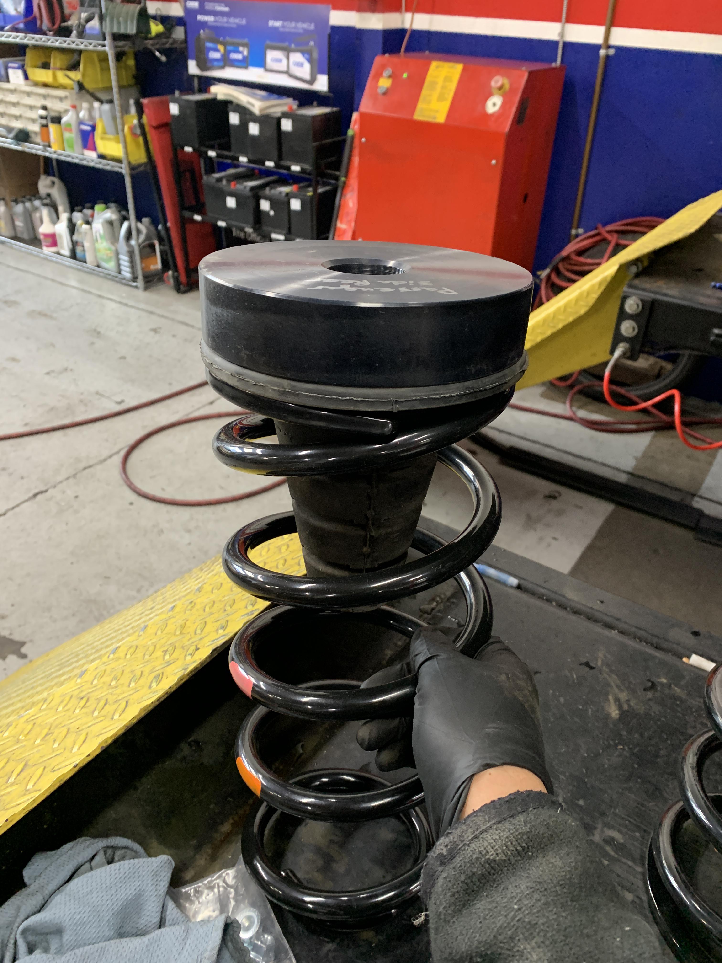

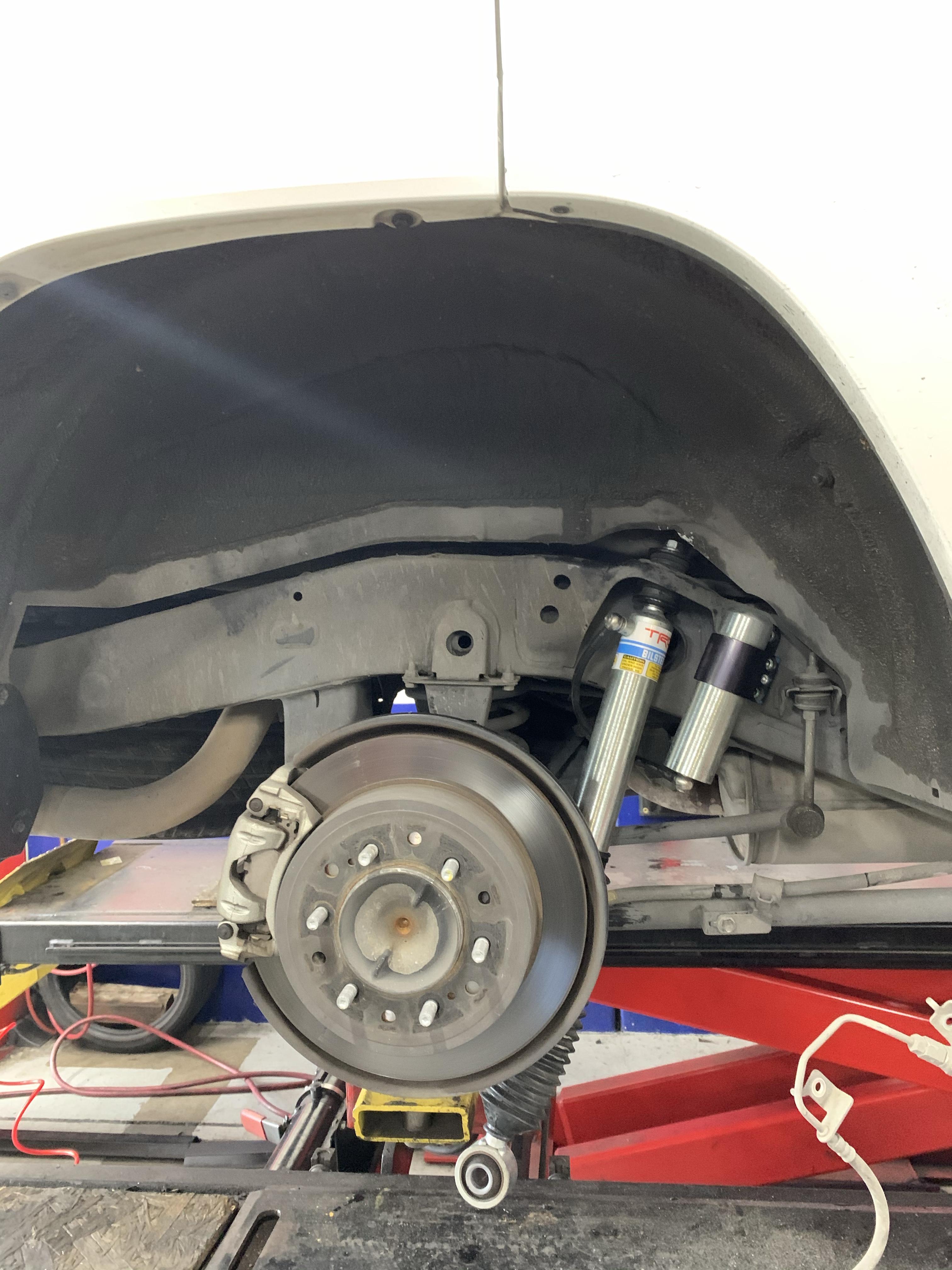

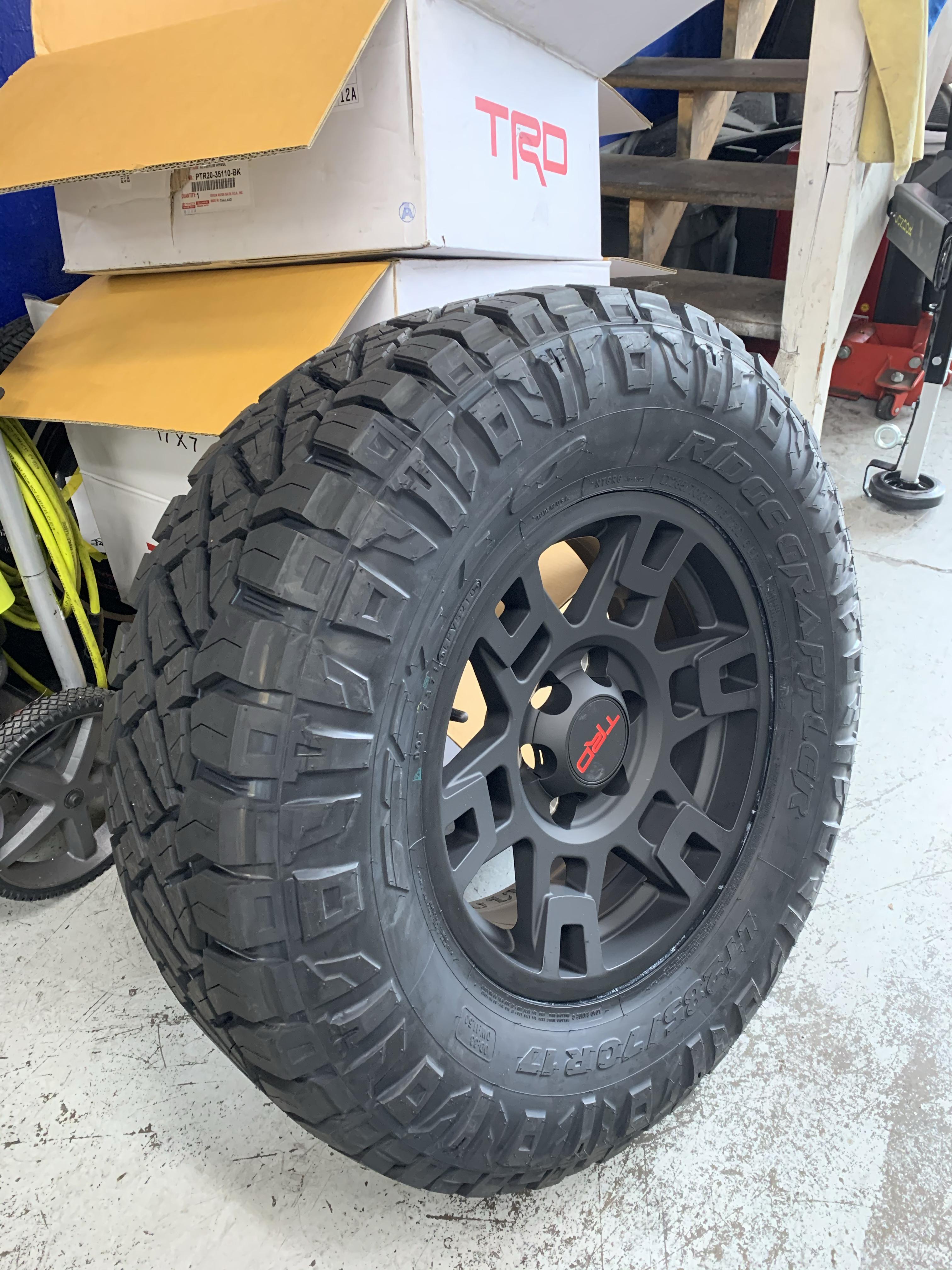

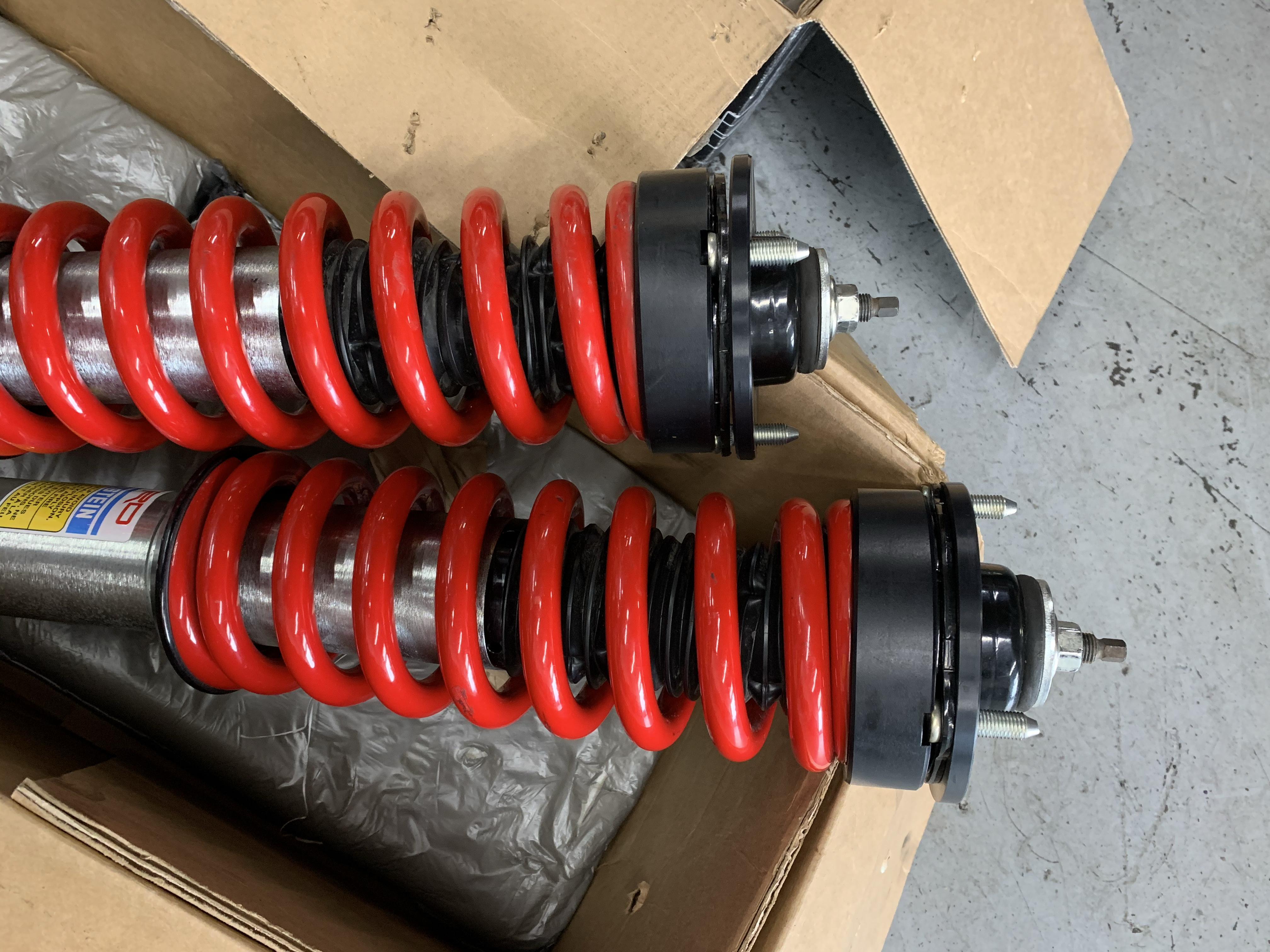

Yesterday I installed the TRD wheels, Nitto ridge grapplers 285/70/17 and TRD pro Bilstein suspension with Cornfed 2/1.5 spacers. I’m so amazed how much firmer the truck has become in a good way. The overall height is now about 2.75” higher then stock.

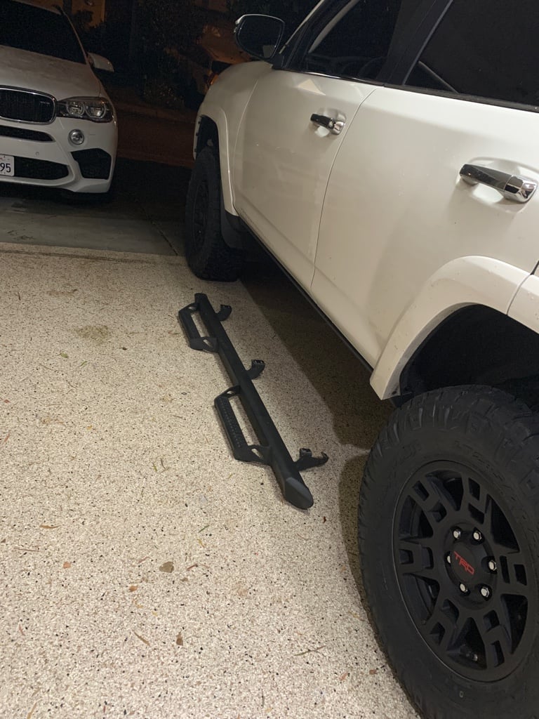

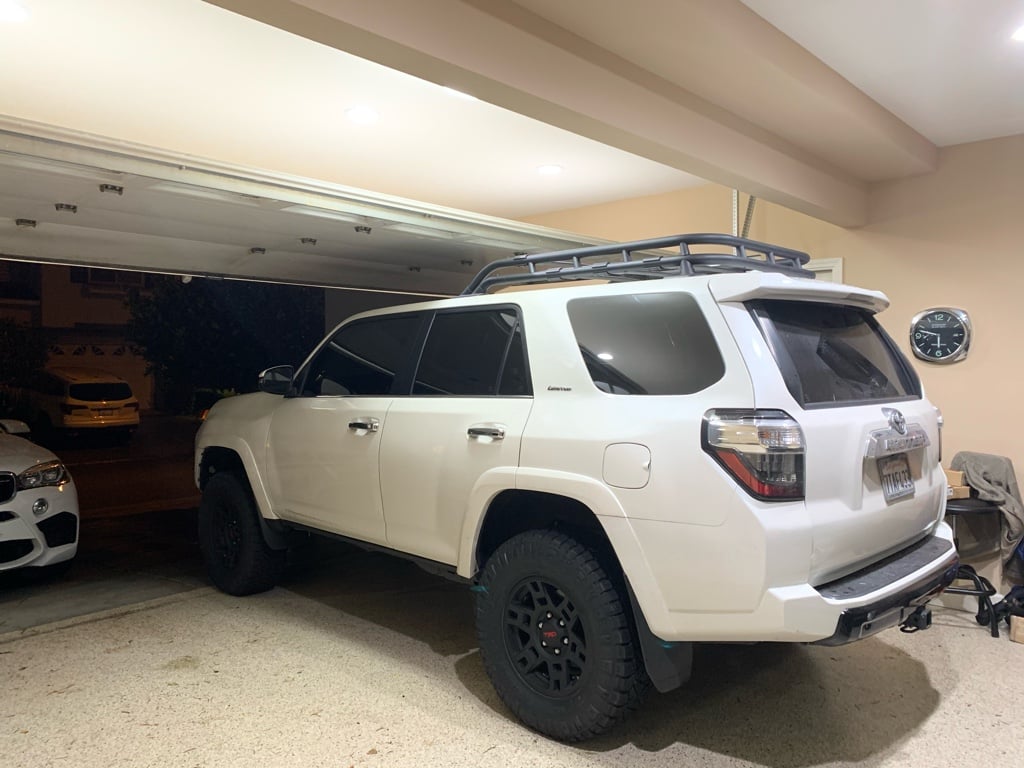

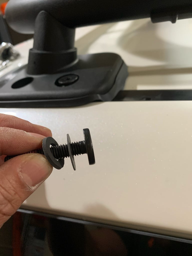

This past Saturday I added the following :-)

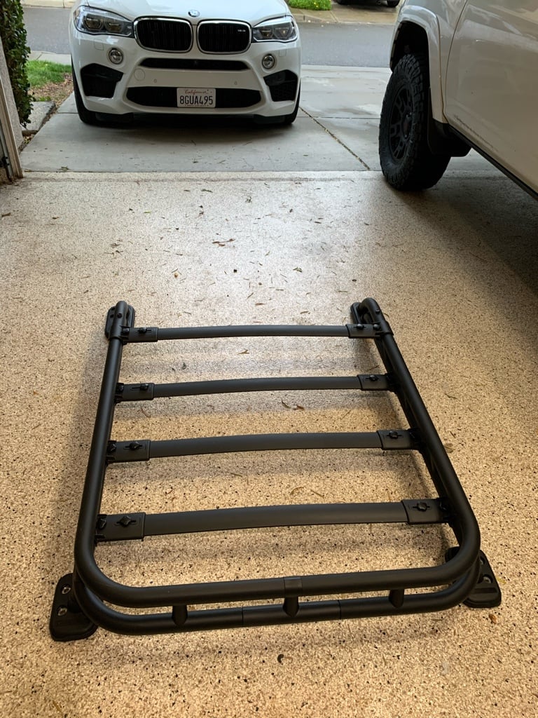

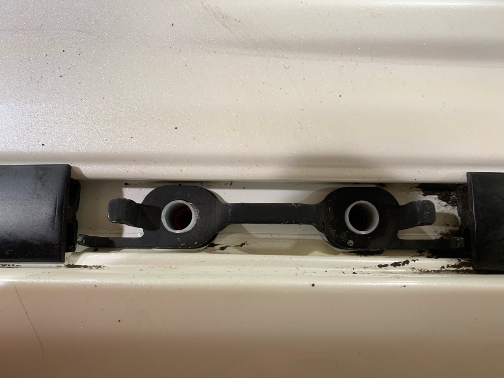

TRD pro roof rack
Predator steps

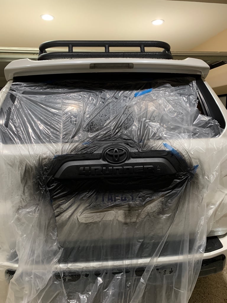

Plastic dipped tailgate garnish

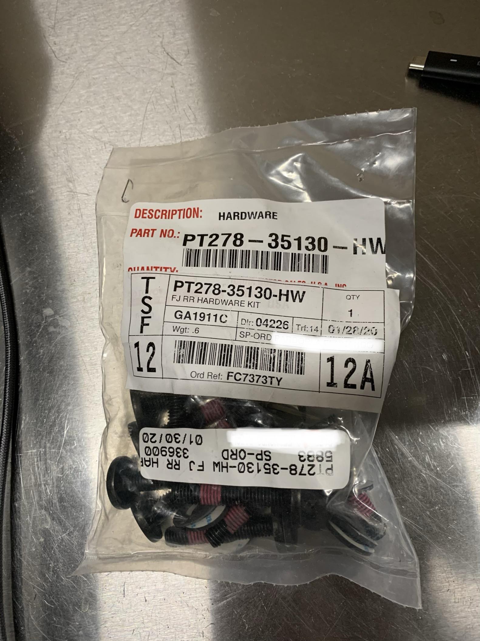

Hardware install kit for TRD Pro rack
Roof brackets 63185-0R010 qyt 4
2e2c5b1d7e904ba7d7f4dd49ef5610a2.plist

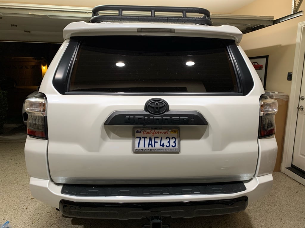

Proper gaskets and bolt

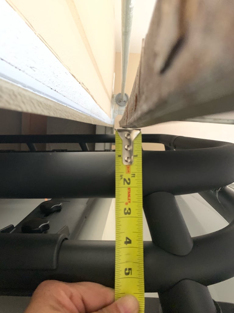

Less then 1” clearance
Done
Predators steps
Plastic dipping garnish
