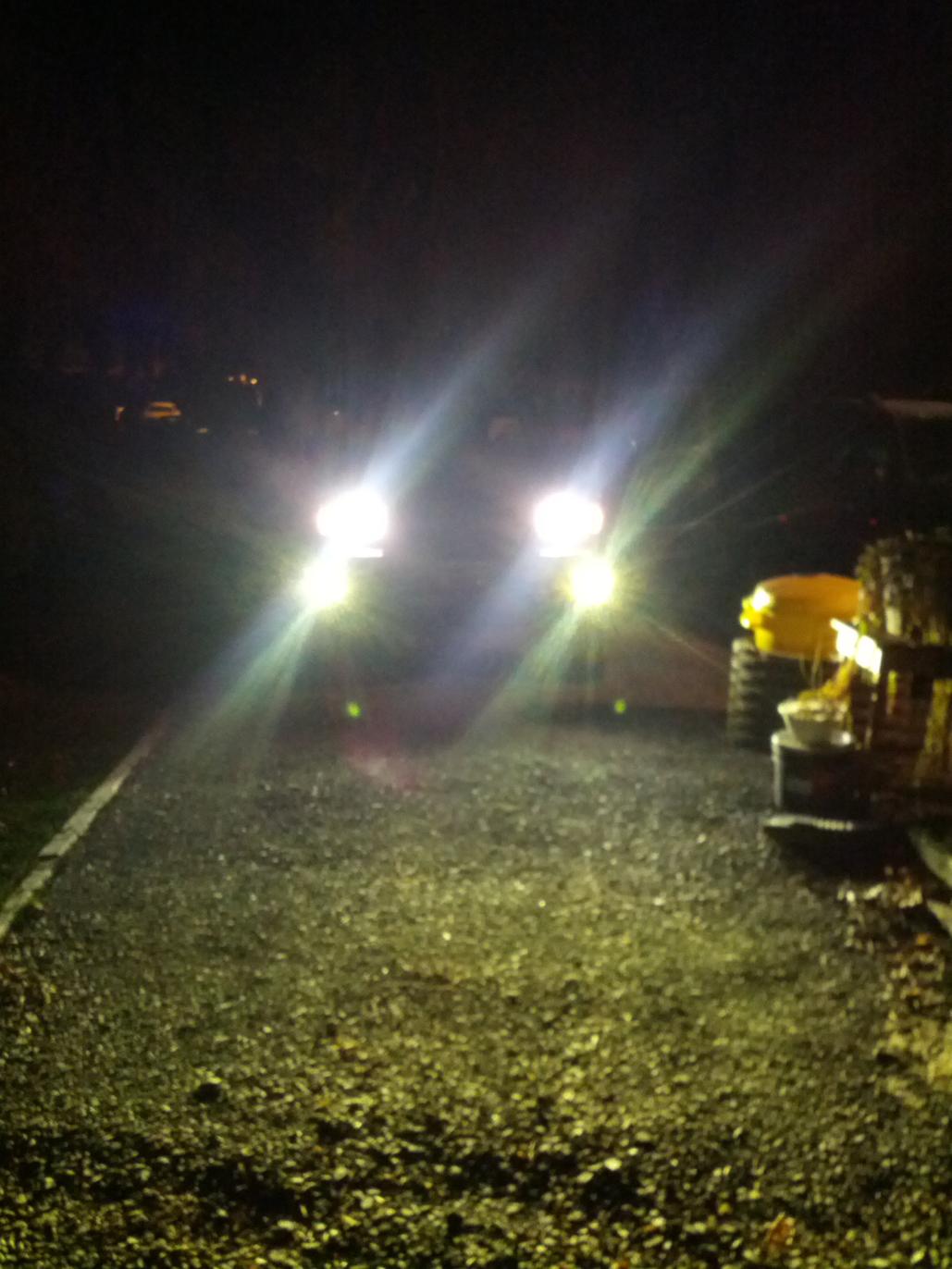

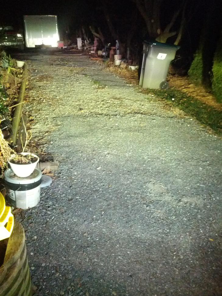

Here are the only two pics i have so far from Fridays install. I have not aimed them down yet before i took the picture so there is a lot of glare plus I'm standing on a slight decline
