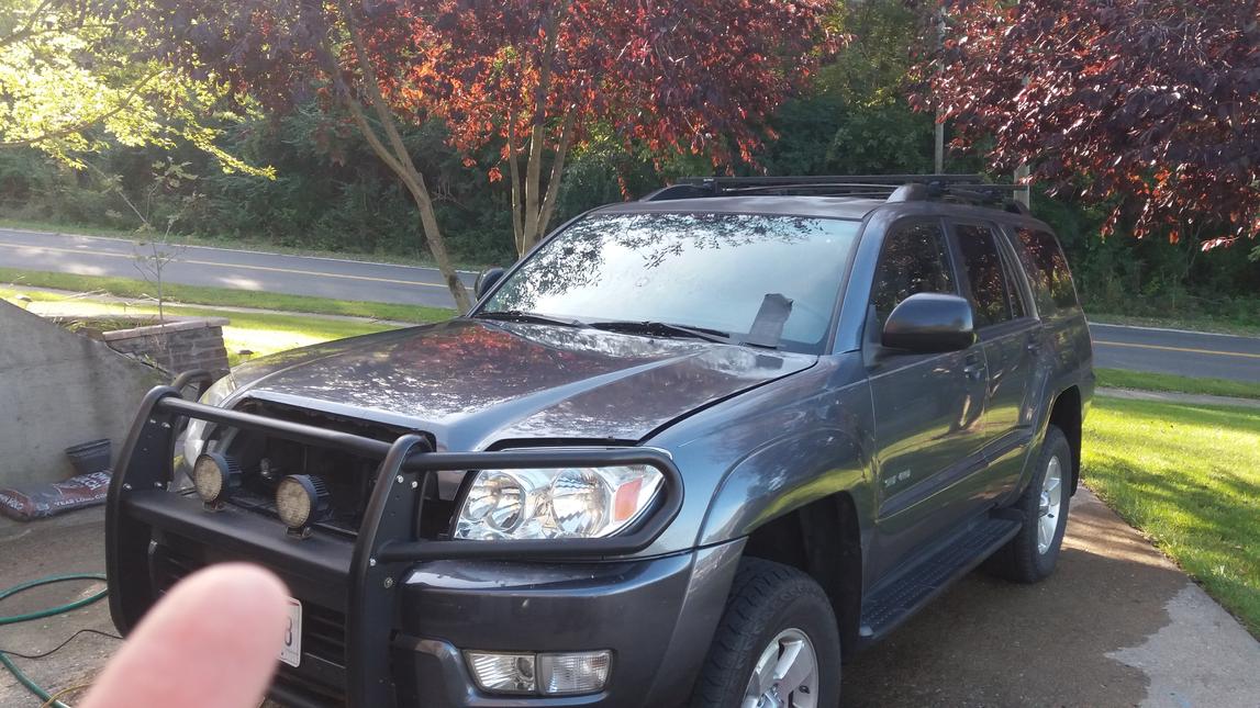

2005 grey here. Hood was shot so I picked up 2 part clear for about $80, sanded and shot the paint on. I'm not the best painter, and I was worried it would look too new, but I got just enough orange peel to match the 15-year-old factory paint on the rest of the car. Was a 3 hour job.
My roof is way shot and my tailgate is getting there but I've been lazy. Took about 1/2 quart for the hood and I'm afraid I'll run out on the roof if I start that project.
Good news on a roof is nobody sees it so it doesn't have to be a great job, just needs to keep it from rusting. https://www.toyota-4runner.org/attachments/4th-gen-t4rs/316099d1540419596-what-did-you-do-your-4runner-today-20181024_161021-jpg
