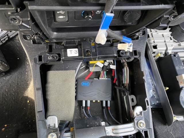

After combing through this forum and trying a couple of suggested set ups (4 ohm JL C2 replacements, etc), I finally found something that works:
Amplifier Integration Interface for Select 2014+ Toyota and Lexus vehicles with Premium Amplified Sound Systems - PAC
The PAC AmpPRO is basically a T-Harness that robs the signal from the head unit and sends it back. It’s a little pricy, but you don’t have to replace your head unit or get a DSP. I’ve found that it’s really flexible and allows you to put any of your speakers or the sub onto an amp. The t-harness is plug and play and the unit fits nicely in the center console.
