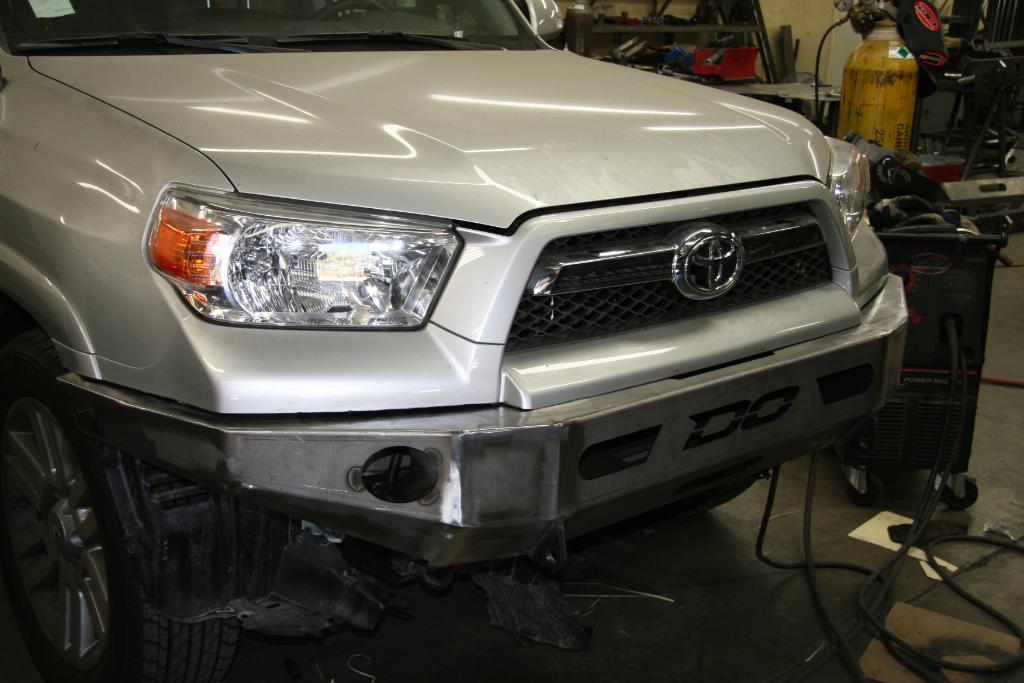

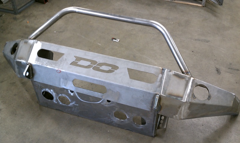

"Sorry it's taken so long. We built it one way and didn't like it so we started over.
The final production piece would still be different than this one. Moving the DO to the lower right corner next to where the shackles are now and smaller. The winch line hole would be moved up to where the DO is but slightly lower. Were looking at moving the shackles up and making them taller on the bumper. This bumper is far from done but you can see which way we are going. LED turn signals will still be added to this one. Were also going to put a single hoop on it to match the grill".

I like where this is going, but it's not just the bumper valence that is being cut, the fender liner is needing work too (you can see the uncut unit still hanging in the background). The integrated lights are fog lights and turn signals. If they include wiring paths for fogs under the hoop, that would be relatively easy to wire into by unhooking the factory fogs and plugging the aftermarket fogs into the OEM harness... Or to include them integrated into the bumper below and outside the DO.
Having just cut my rockers for Shrockworks Rock Rails, I am not sure about cutting the plastic bumper. Getting it straight and "finished" looking is going to be hard. I had to high-speed cut the rockers with a jigsaw to keep the plastic from biting or melting.
Is DO planning on including a top-shell with the bumper?

Yes they have to cut the fender liner aswell since this is a high clearance bumper that can give the 4runner that much more capability. I have already dented up my stock bumper twice just doing moderated offroading and now having this much more clearance will give me piece of mind and also keep my wife of my back for damaging the family vehicle. Lol. This clearance would also compliment the rocksliders due to the fact that the sliders probably are mounted at the level or higher than the stock bumper. The stock bumper will be the first thing to meet a nice boulder before the sliders come into play. Sorry for the rambling but IMO an aftermarket bumper is probably the second or third best mod for body protection.
i am highly disappointed that they're not incorporating the oem turn signals. I asked about it on their facebook page and they pretty much said you will have to wire in the aftermarket lights they sell which is additional. i like the oem functions of the drl, fog light and turn signal.

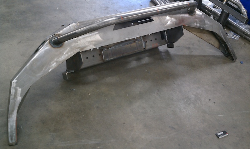

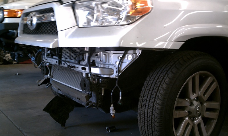

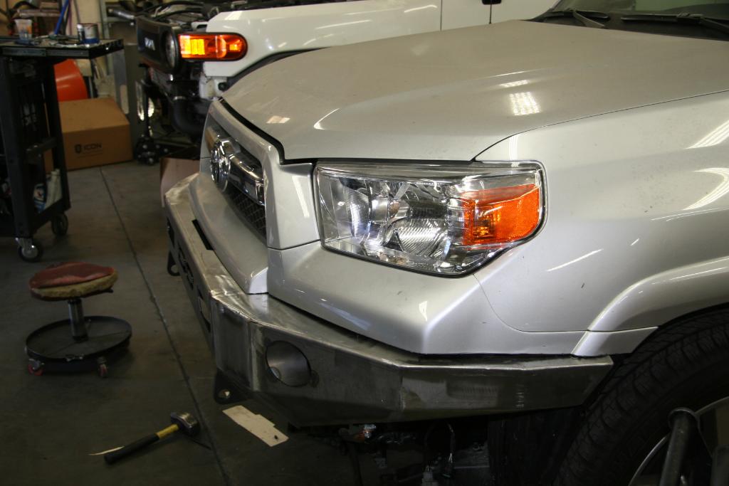

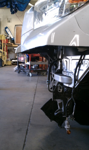

I stopped by Jason's shop today and really like the look of the bumper. I was told the final product will be slightly different than below where a winch can be mounted and there will be extra support brackets for the sides of the bumper since they are long.
A lot of work will need to be done with the stock bumper and plastic fascia where one will have to cut off a substantial portion (i would be scared to tackle this on my own, especially with the stock bumper). You can see just how much was cut off in the pictures below. I was also told they were thinking about making a cutting template to make this process easier for the consumer if they plan to install themselves. After seeing this in person, I have no doubt that the final product will look and fit great on the 5th gen.
