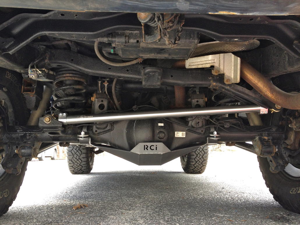

you have it installed correctly , I have the pinch collar flipped around so the bolts are on top facing out but basically you have it installed correctly which is the opposite of the directions I called icon to confirm. You can adjust on the truck no problem
Here's mine which was installed by Demello Off Road.
Huh. I noticed when I ordered mine there was a 3 week backorder from icon. The pinch bolts would not install from the other direction because they were not threaded on one side so that option didn't work for me. Guess I got unlucky with the timing of whatever re-design they did. Icon gave me an RMA number to return so I'm happy about that!
Mine was pretty straight forward and super easy although not Icon.
