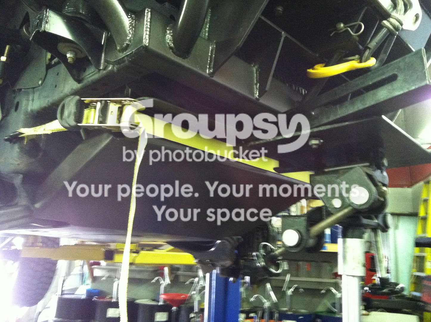

Damn that rear setup is getting better and better. What size strap did you go with.. Looks close to a 12" or 14"
Thanks man! They are 14" straps.
Yea x2, limiting straps are going to be one of my next purchases, I just can't figure out what size to go with
Thanks! You really need to measure for your own vehicle and where the mounts will be, the adjustable clevis gives you some room (around an inch each way, and it's really a must) to fine tune stuff.

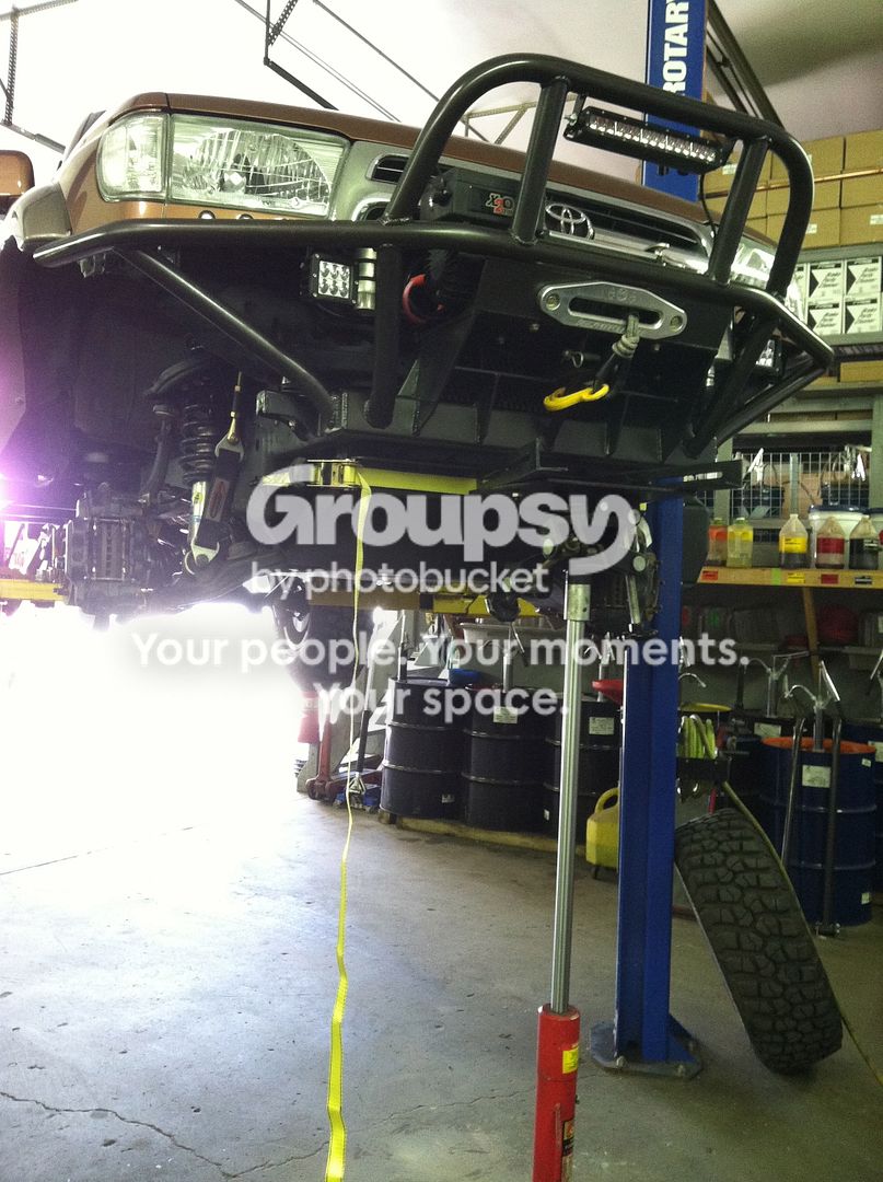

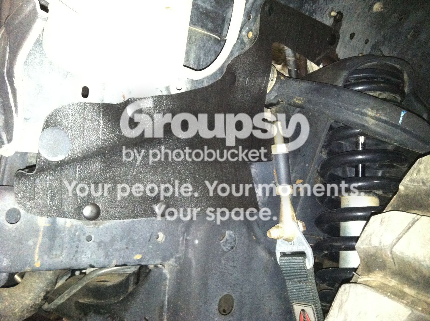

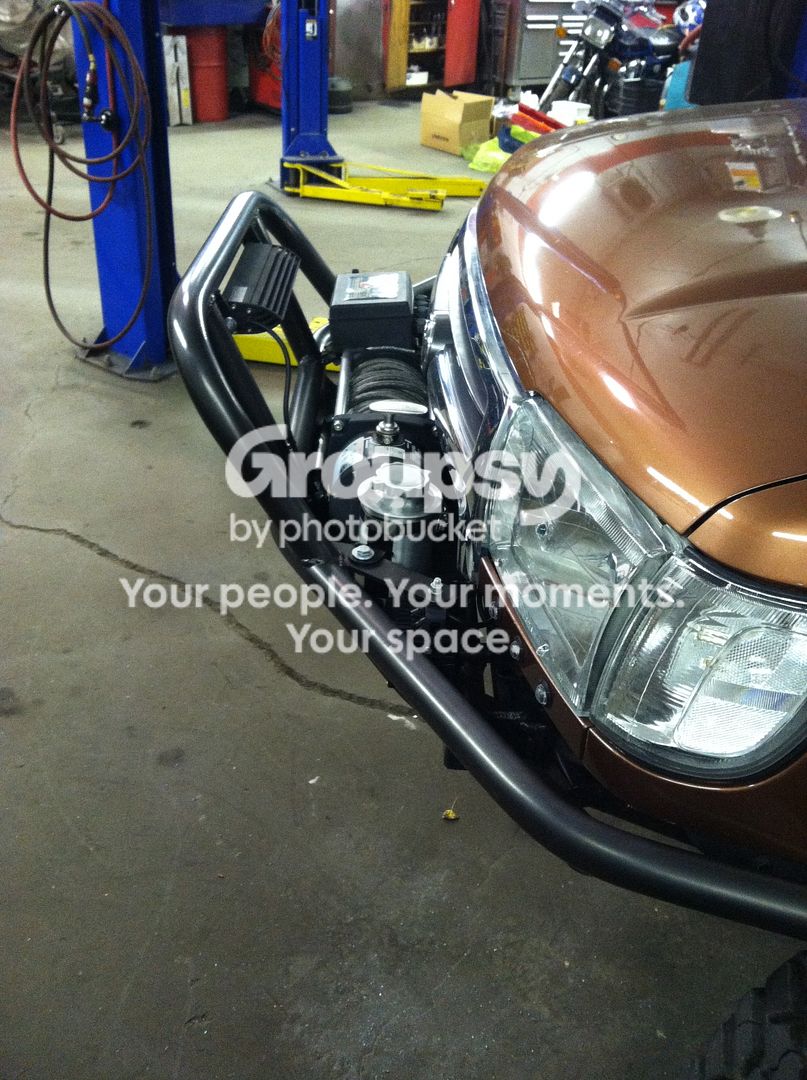

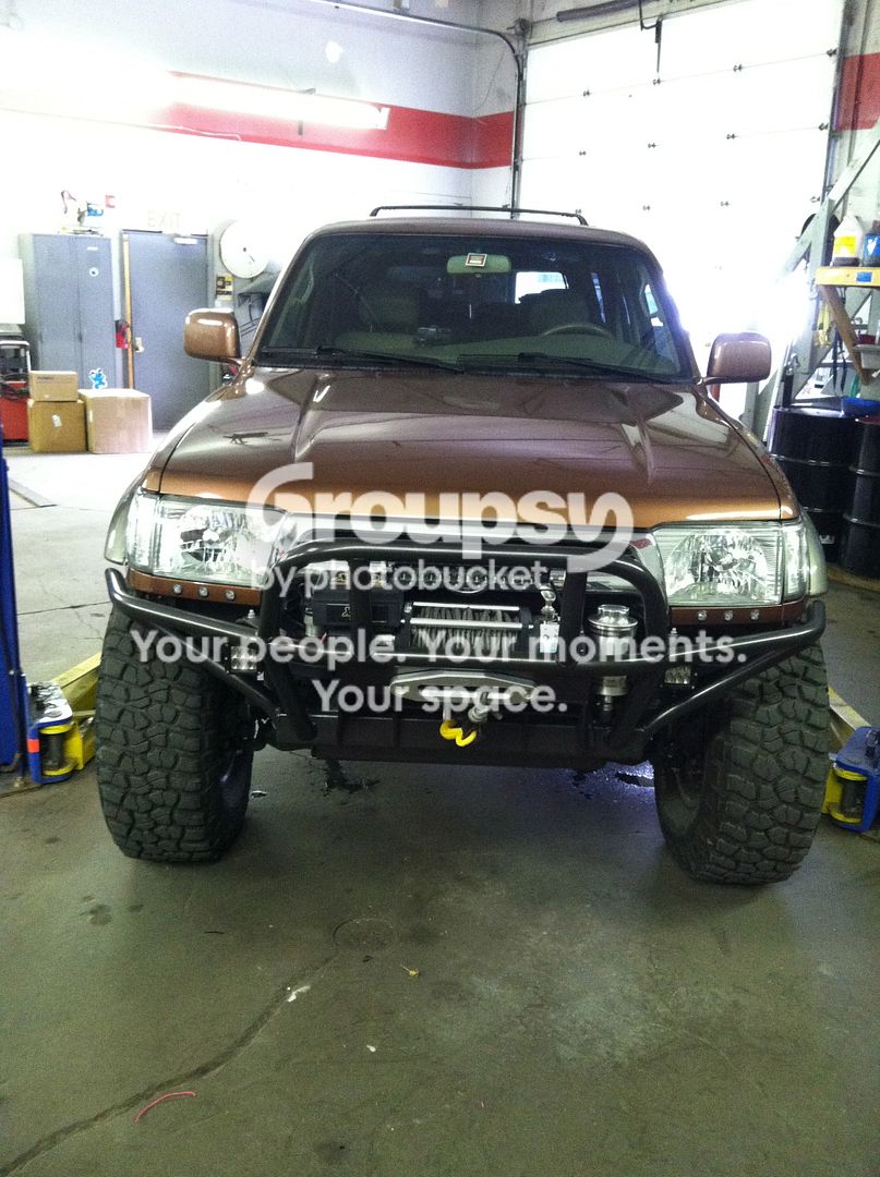

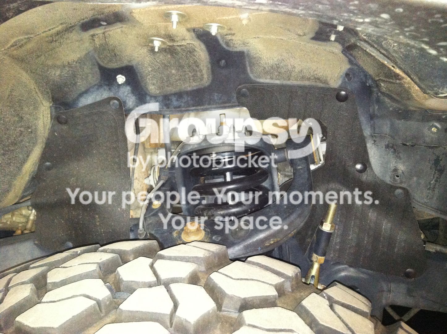

With my 1” body lift the stock front “Inner fender, mud deflector, engine protector, … flaps :)” didn’t fit worth a crap. I enlarged the holes on the stock units, but they just started tearing and coming apart. So I bought the cheapest floor mats at Wal-Mart, used the old ones as a template, and added an extra inch. It’s not fancy but it gets the job done.

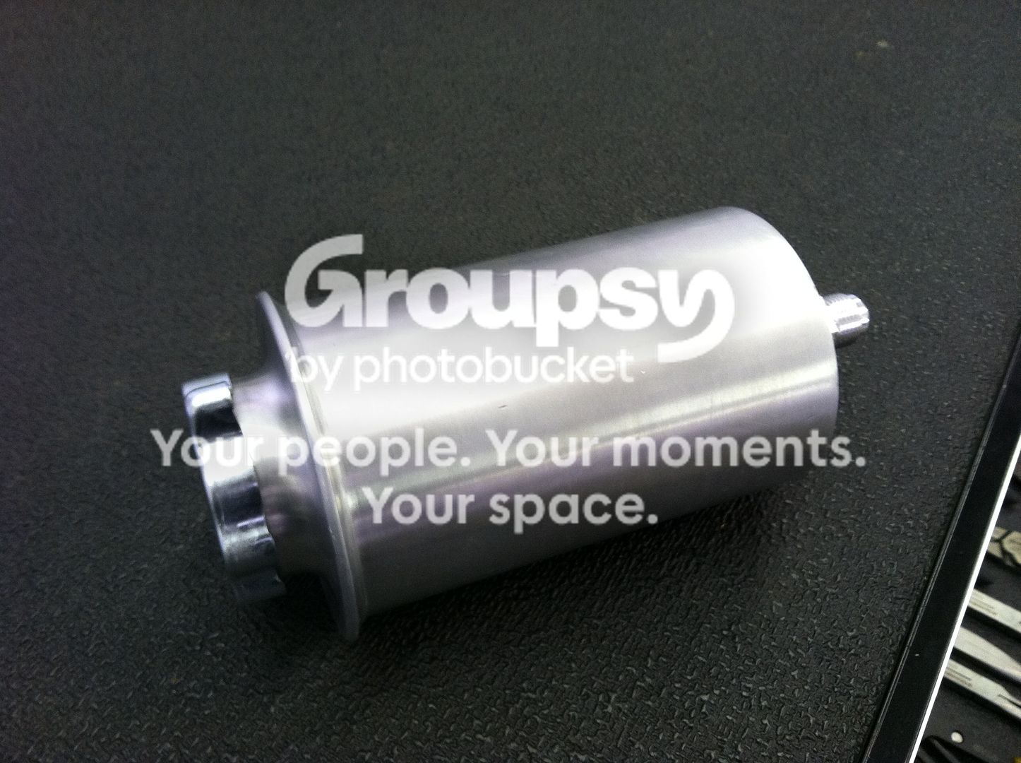

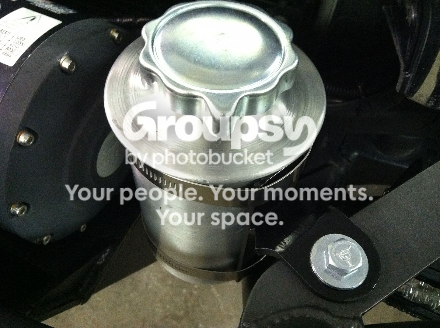

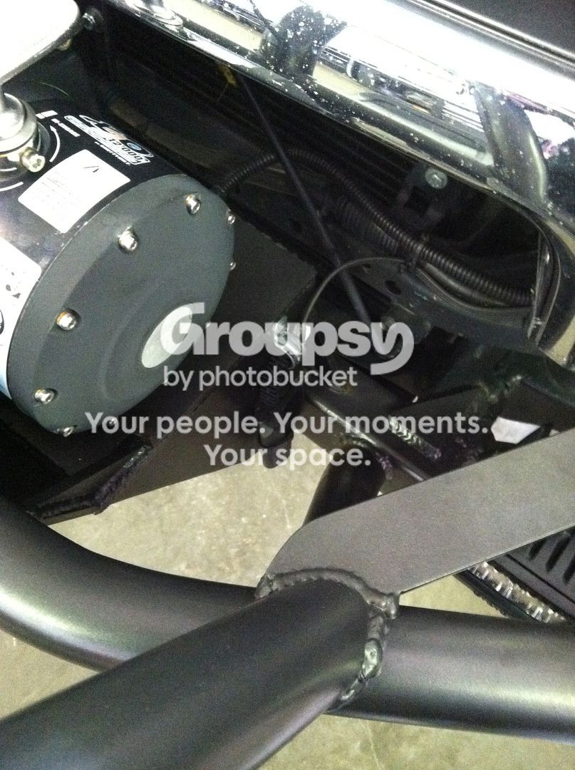

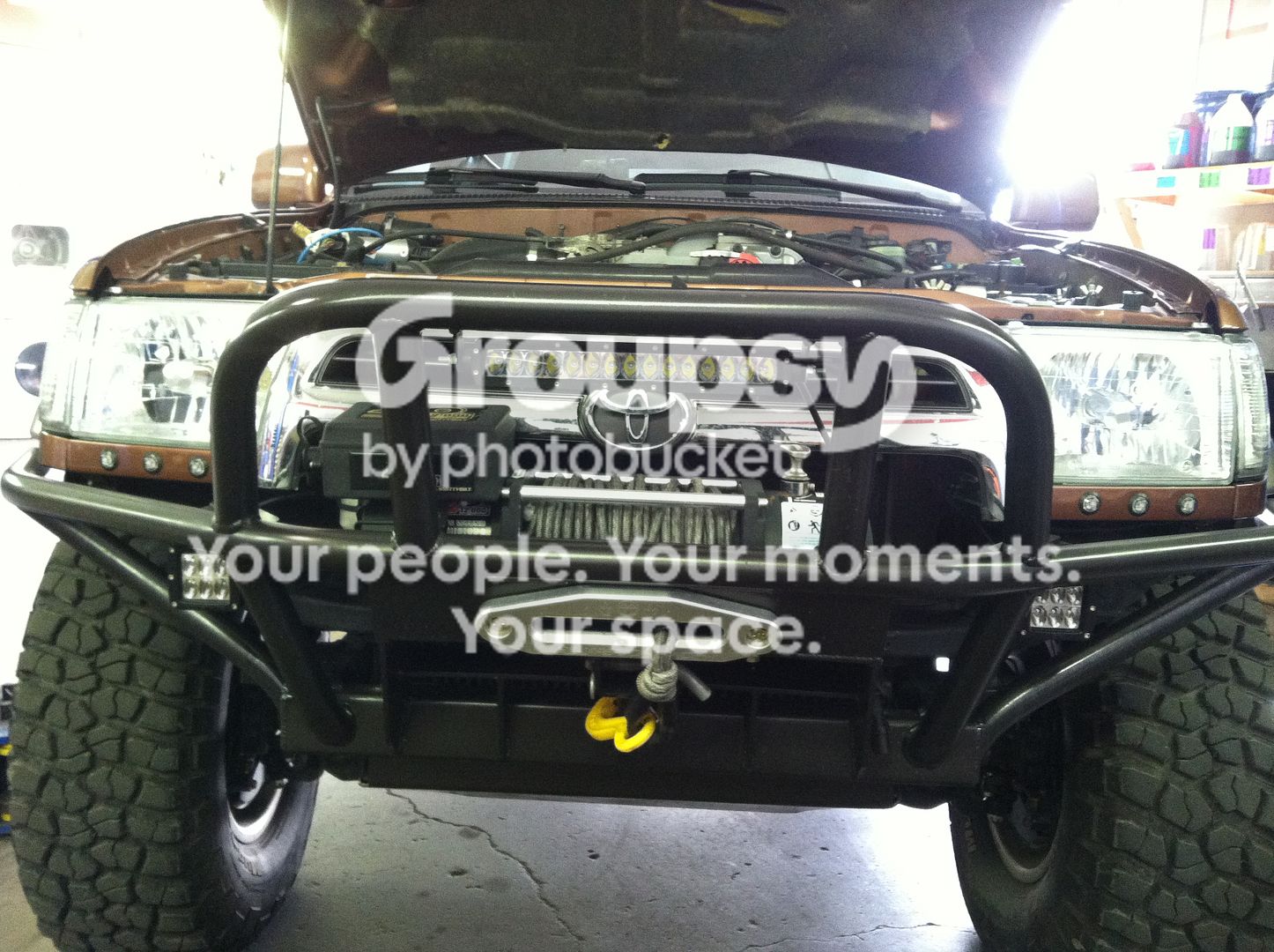

I‘ve also been running around without a windshield reservoir since I installed the 35’s, the stock unit got in the way of the tires. With winter coming I needed to find some kind of a solution; I was given an aftermarket power steering reservoir years ago, and there was a big empty spot on the driver side of the front bumper. Hmmm…
IMG_0699.jpg~original
IMG_0696.jpg~original
IMG_0697.jpg~original
Since it only holds a quart, having it outside the vehicle will make it easy to top off. I’ll carry a gallon of washer fluid in the back.

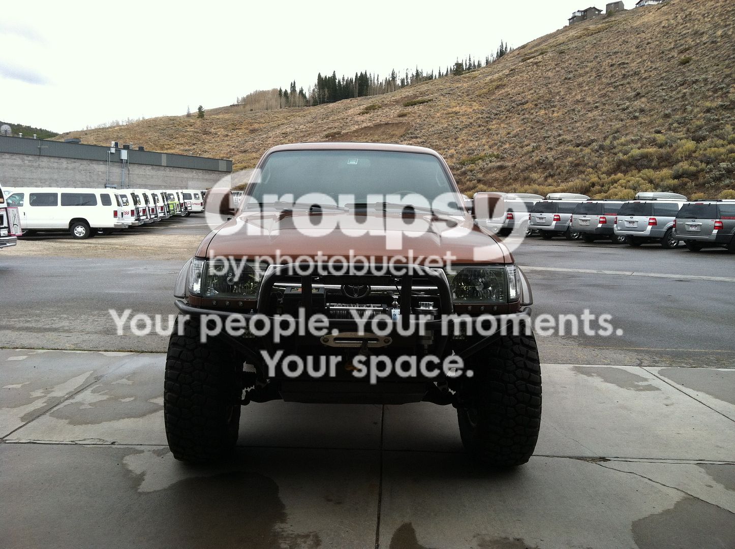

If anyone else said they were going to put a washer reservoir on their front bumper I would said they were stupid and insane.
Some how you can manage to make anything look magnificent :trophy:
Yeah, like that awesome Toyota in the parking lot of fleet vehicles.
LOL, I had several people tell me it was stupid and insane when I mentioned it! :D

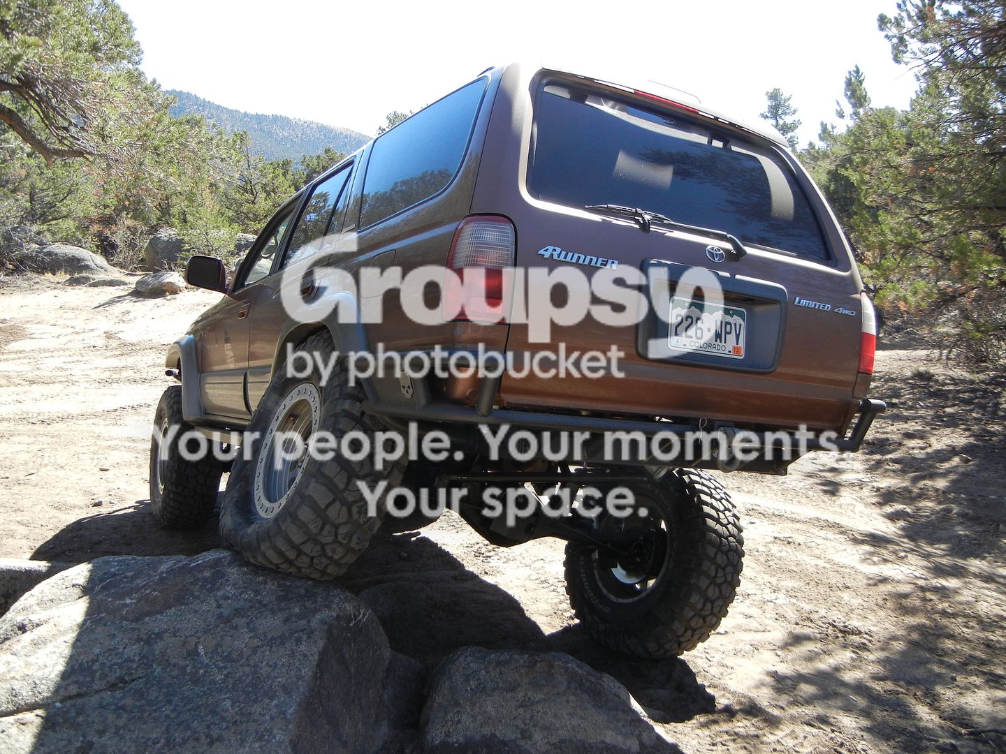

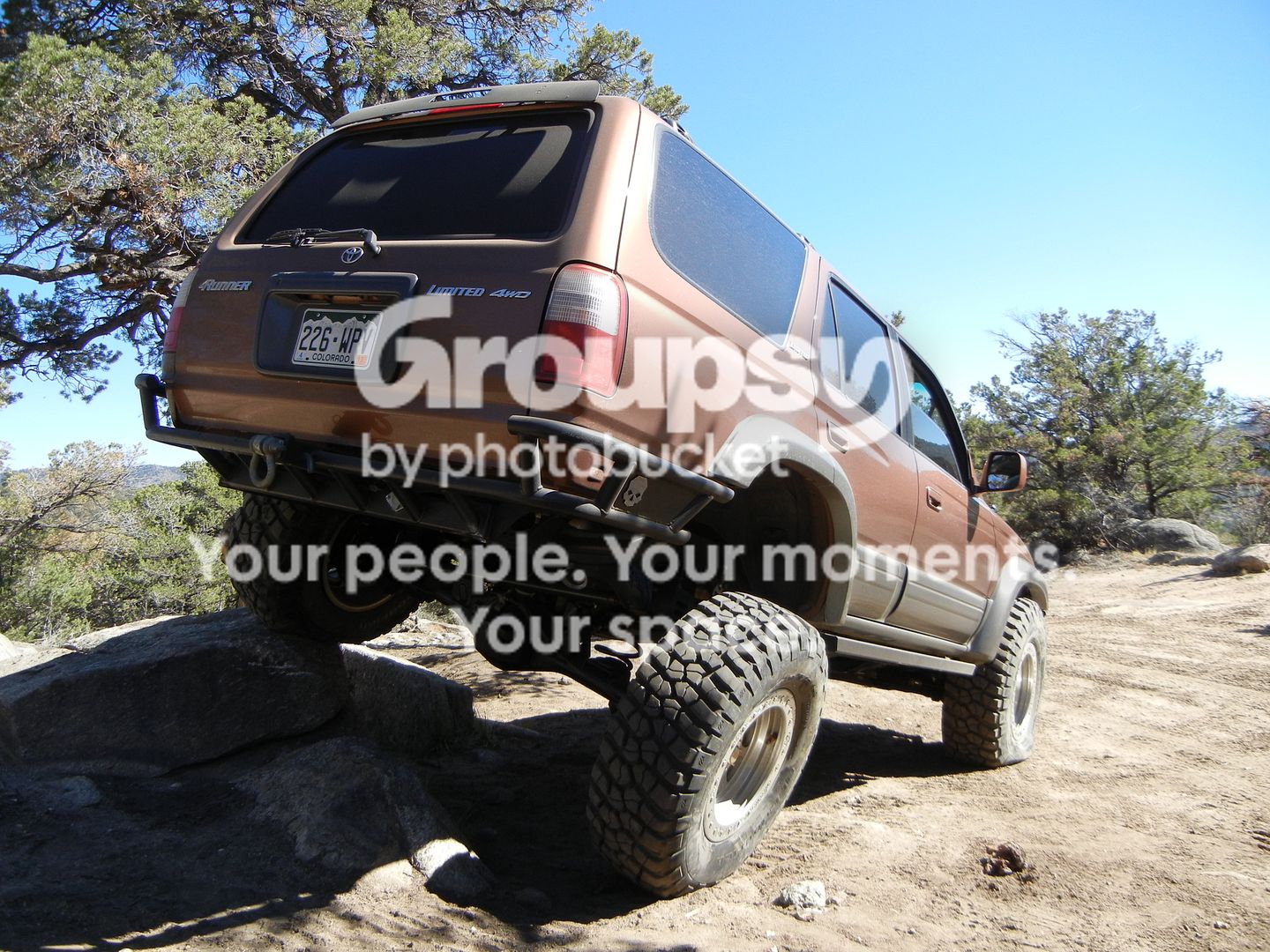

I wanted to give the rear suspension a good shakedown run, so I ran one of my favorite trails, Chinaman's Loop in Buena Vista. I was concerned about the limit straps getting caught in the bump stops, or folding around into the wheel/tire, but everything worked fine.
The suspension still has a little more up and down travel, but it's a good shot of the clearance.

When I first read that you were going to put a washer reservoir in your front bumper, I thought to myself "this is the 1st bad choice Dirtco has made with his build." Now after seeing the finished product I find myself frantically looking for a spot in my front bumper to mimic this originality. Why would I ever doubt you Dirtco? Hahaha seriously looks great as usual..... Let's see more shots from the trail!

Seriously though, I like the washer reservoir a lot, it looks perfect in the bumper. In reference to your rear limiting straps, from the pictures, it looks like you have the perfect amount of rear flex/travel to match up with an IFS.
Hahaha! Thanks! It wasn’t my first choice, but I needed a washer fluid reservoir before winter came. I thought about mounting one in the rear cargo area but that seemed like a pain to fill, and I would loose some cargo room. I saw the way ARKRWLR mounted his, but I always have my deck plate open (the supercharger hates it closed) and it would block the air flow. I had the bottle, it fit great, so I gave it a shot, and it also makes it really easy to top it off since it only holds a quart. I like it!
That’s the only pictures I took, I was just enjoying the day and wasn’t concerned about taking any pictures! :)

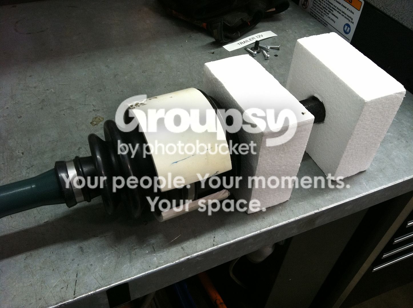

I finally got my hands on some Lotus Development axles! :bluejump: I’ve been waiting to get these since I first heard about them!
Lotus Axles Chromoly -
I was a little concerned about shipping, but that was not an issue at all. I really like the pipe that protects the seal.

Everything went great besides for the bent Budbuilt skid plate. I removed it so I could top off the gear oil, but when I tried to re-install it none of the bolts would line up. It took a transmission jack, and a ratchet strap, to get everything to line up. I almost braced up the skid plate while it was off, but I decided it was a lost cause. If I added bracing now I don’t think it would flex enough to re-install the skid plate and get the bolts started (without enlarging the bolt holes).
