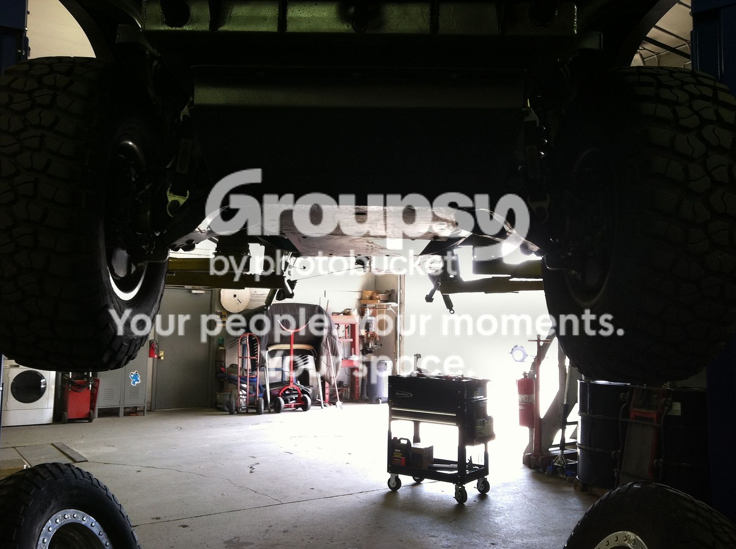

I hate mud too! It’s my daily driver so I really try to keep it clean, but one look at the under side of the 4Runner and you can tell that it gets wheeled on a normal basis.

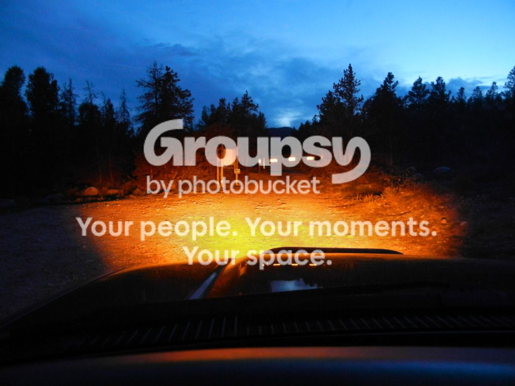

It took me a long time before I could pull the trigger on them too. Both lights are very bright, the Dually’s seem brighter in the pictures but it’s the color, pattern and the fact they are aimed lower. The light bar is aimed higher for more distance; look at the trees behind the gate, the light bar has the advantage when it comes to distance. Like I said above, I bought the amber color for snowy and dusty conditions, they cut through the snow great. The white is better for normal conditions.
DSCN1602.jpg~original
DSCN1601.jpg~original
I would have to look up the price, but I think the 10” Specter series SR light bar was close to the same price as the pair of D2 Dually’s. Both are driving beam patterns. Between the two I have a good combination of light for different conditions.
These are not my pictures, or the best, but it gives you a good idea of how the light color can change your vision in snowy conditions. I found these on Pirate when I was researching the lights, I will try to take some pictures of my own once it starts snowing again. The glare back from the white light is crazy in a snowstorm, but the amber cuts right through it.
DSCN0201.jpg~original
DSCN0204.jpg~original

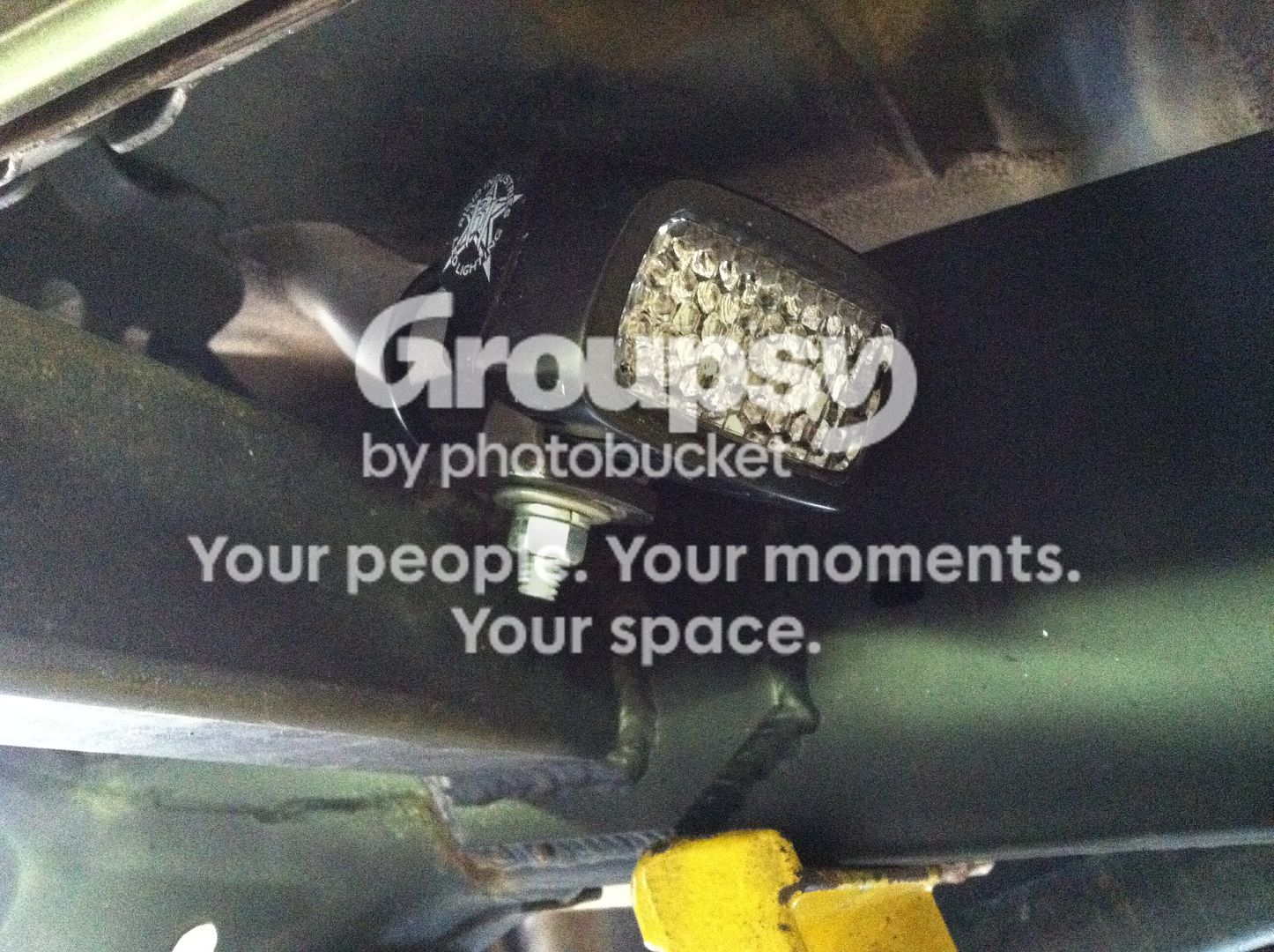

It's been a while since I updated this, we'll start with some small stuff...

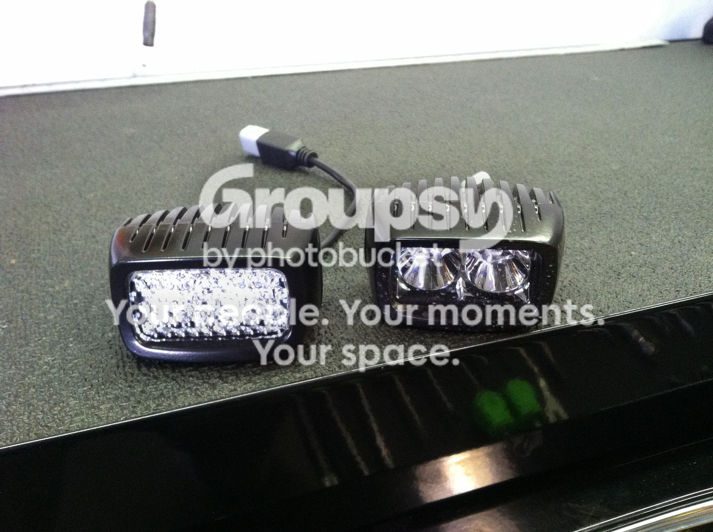

I got the new Rigid diffused light in and installed. They made a huge difference; the light is not so intense and the pattern is more spread out. I don't have nay pictures in action yet, but I'll get some in the next week or two.
IMG_0513.jpg~original
IMG_0528.jpg~original

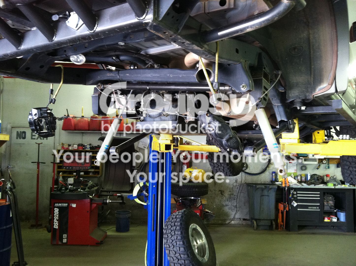

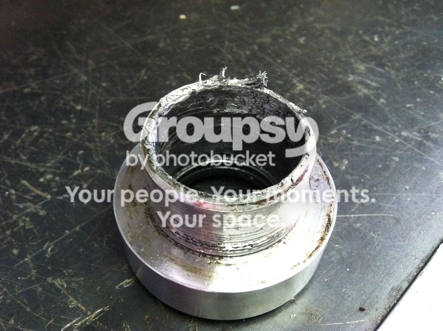

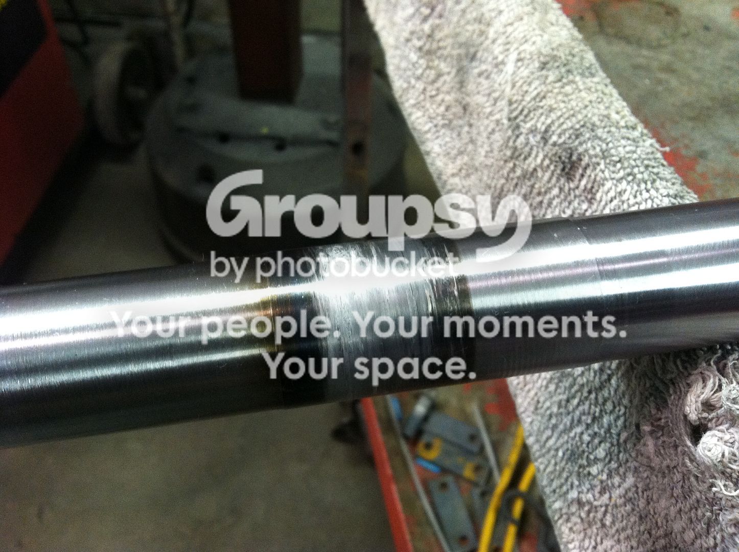

It’s been a rough couple weeks, I took the 4Runner out to do some light wheeling on a couple trails I have never ran before. In the process of airing down I noticed gear oil leaking out from the driver side rear hub. It was obvious that I had a leaking rear axle seal, so I took it back to the shop and removed the calipers and ABS sensors to see what was going on. I could see the seal and adapter where it presses into the front solid axle spindle. There was a little flap of rubber hanging down off the seal, so I ordered two seals and one extra adapter so I would have a spare. I put the truck back together and waited for the parts to come in.

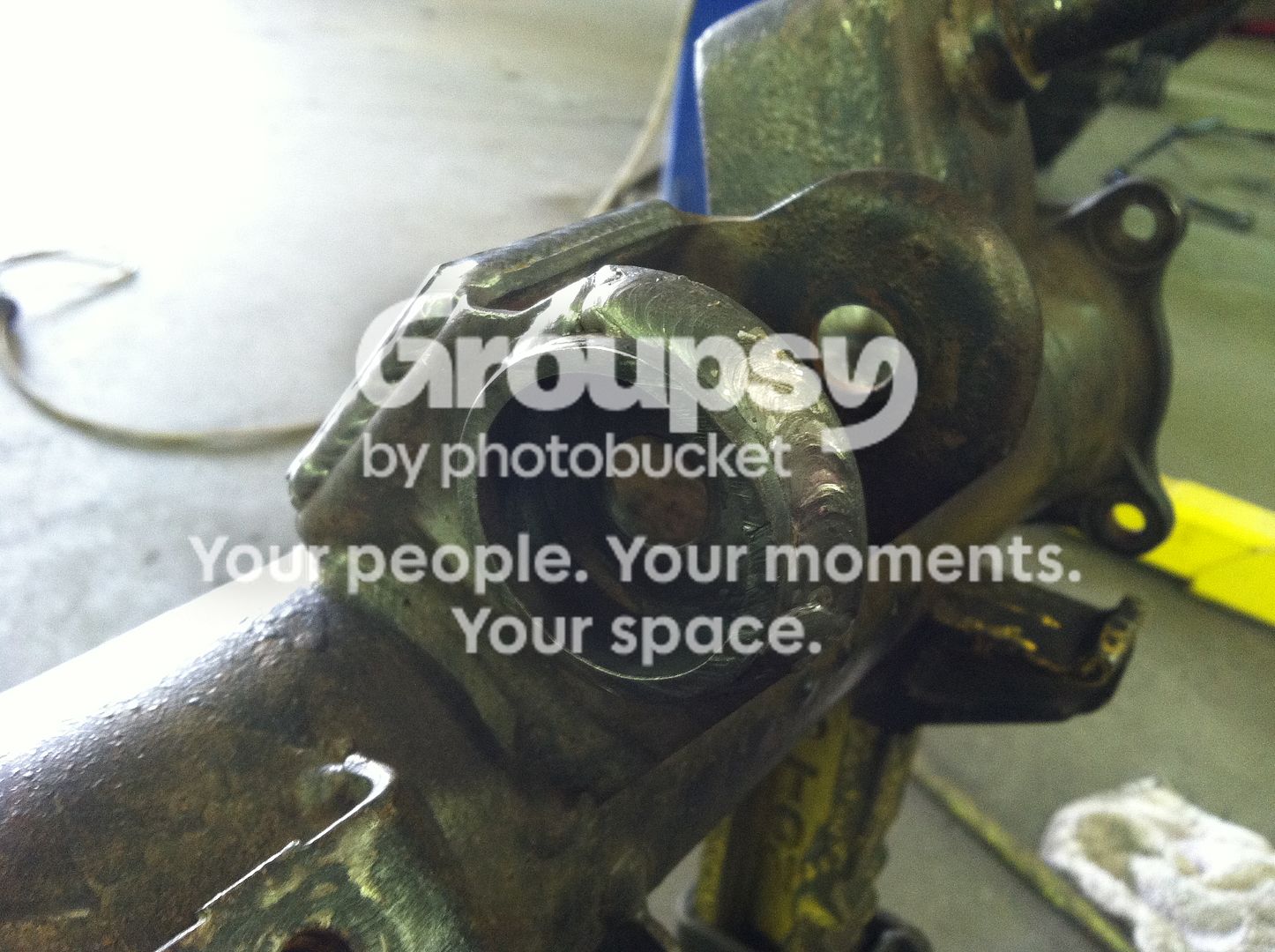

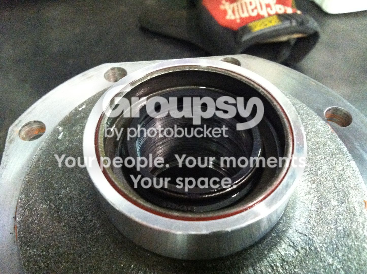

Once the parts came in I tore the driver side all the way apart and found more damage than I expected. The axle shaft had been rubbing the seal adapter and ate away at the seal too. I spent a lot of time looking at the spindle and it looked like it was not machined correctly, the old stock bushing where the new seal adapter presses in had an oblong wear pattern. I didn’t think much of it, but now it seemed like a red flag.
IMG_0515.jpg~original
IMG_0517.jpg~original
I had a spare spindle, and the adapter, so I installed them and put the truck back together. I took it for a short test drive and everything went to hell, fast! After five miles it sound like the rear end was coming apart, I pulled over, felt the d/s of housing, and it was so hot I almost burned myself! I limped it back to the shop and tore it apart again the following day and this is what I found.
IMG_0521.jpg~original
IMG_0518.jpg~original
Aluminum in the gear oil

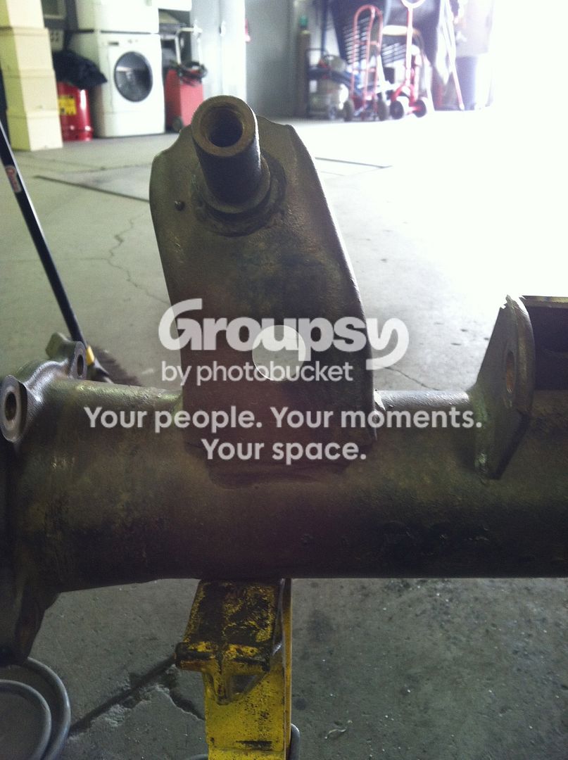

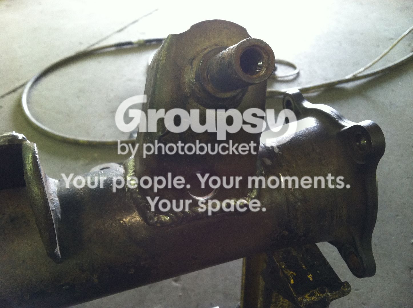

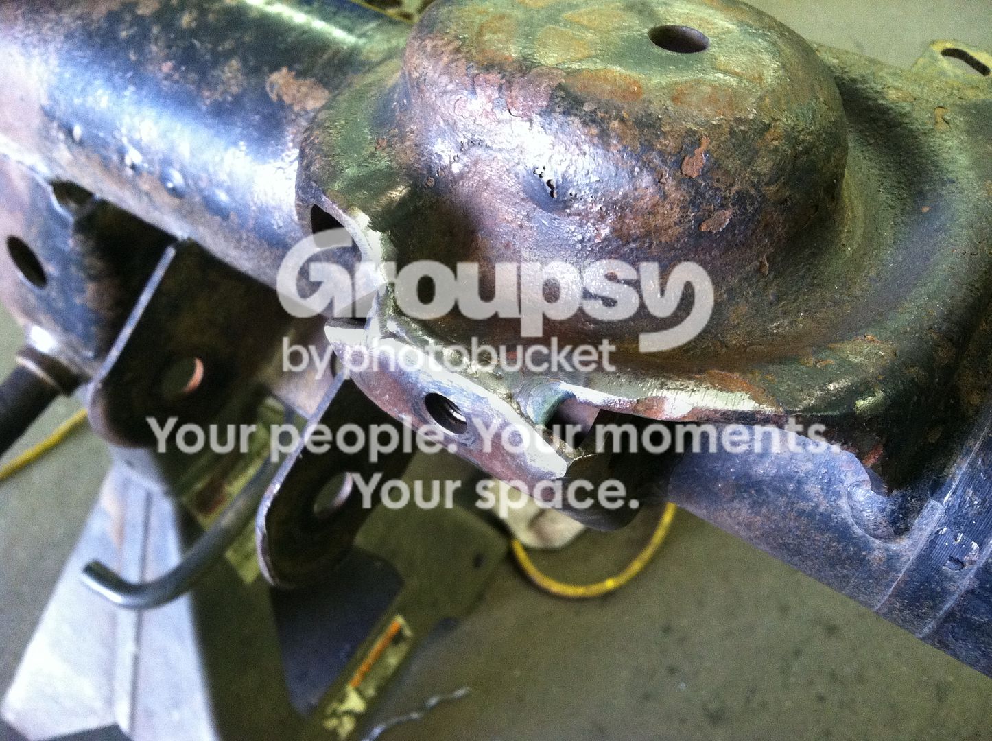

In the process of getting the housing ready, and wire wheeled, I noticed that the sway bar brackets were messed up. It looks like PO beat them in with a sledge hammer! WTF? You can see what looks to be hammer marks on the bracket and the coil bucket, it also had some surface rust so I don’t think it was salvage yard. If Toyota changed the bracket design for a certain model year please let me know, but this really doesn’t look like it’s factory.
IMG_0553_zpsf263fab1.jpg~original
IMG_0561_zpsbd66b5e8.jpg~original
IMG_0562_zpsa75713ff.jpg~original
My truck
IMG_0556_zpsb74a0206.jpg~original
IMG_0564_zps8c97833f.jpg~original
I’m not going to lie, after seeing the sway bar brackets I was a little concerned about the housing. I did a dry test fit with all the major components but I really can’t see or tell what’s going on. There’s no scratches or rock marks on the housing, as long as the PO wasn’t out jumping it, or hit in in an accident it should work fine. So I crossed my fingers and said screw it, I REALLY hope this housing isn’t bent!

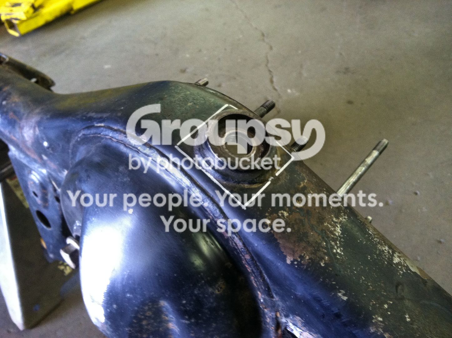

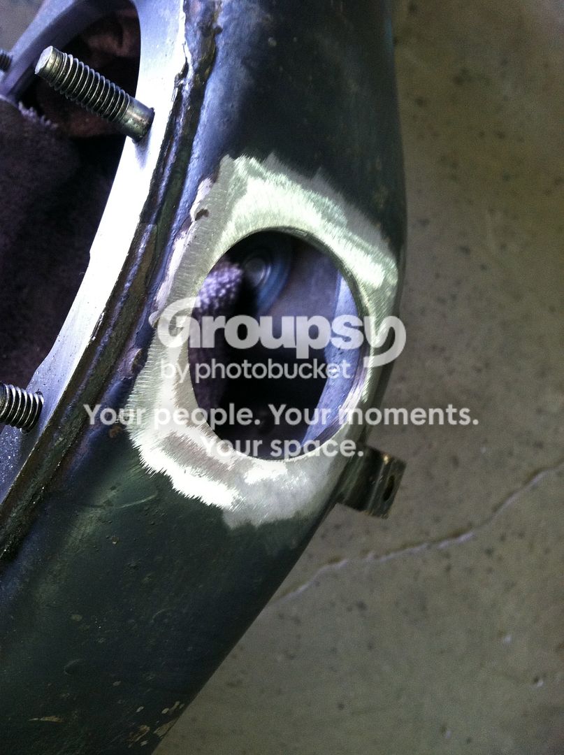

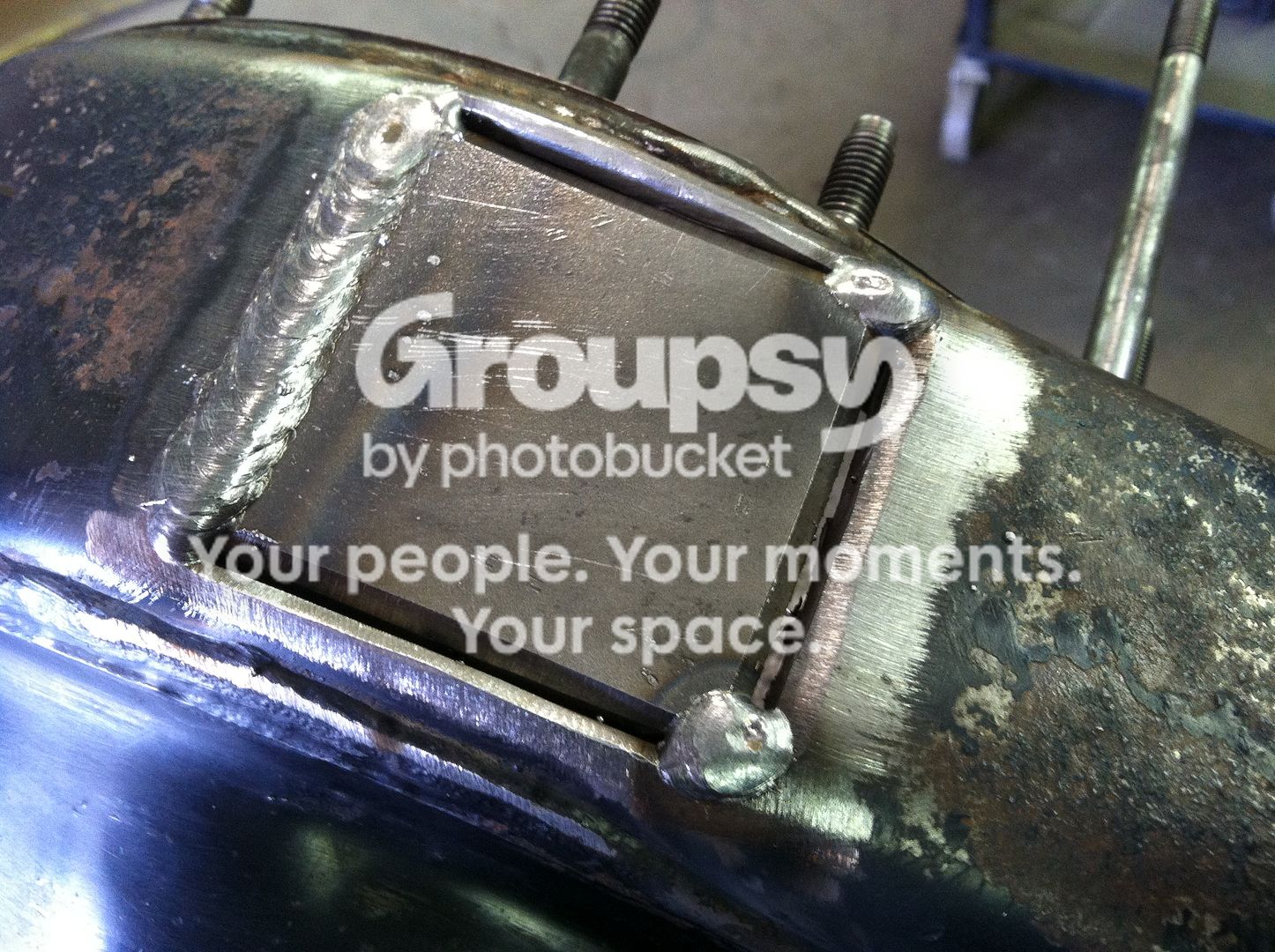

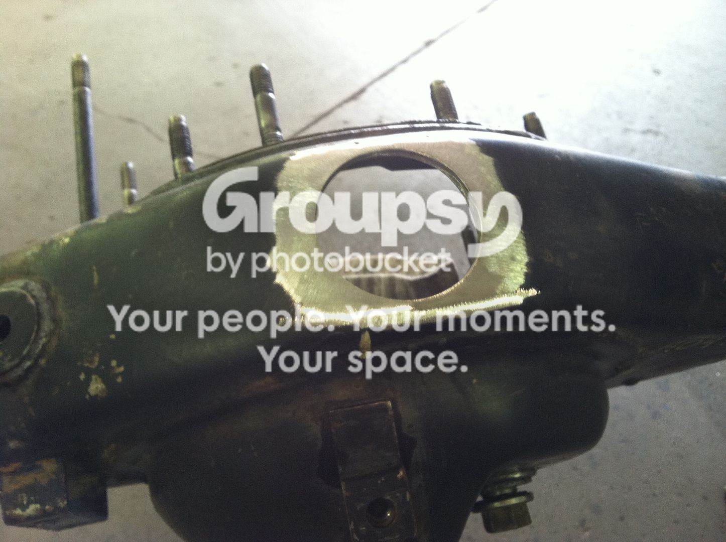

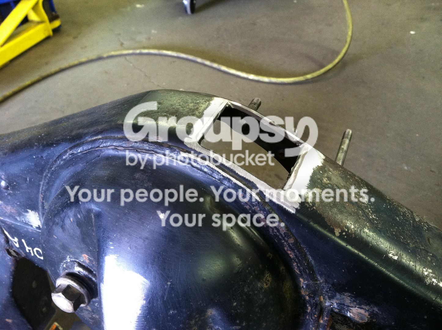

Since the housing was out I decided to make some other modifications. First on the list was to cut out the drain plug; it catches on everything, and over time the rocks will knock the drain plug loose, or make getting the drain plug out impossible.
Here’s the old drain plug after a few trips
IMG_0558_zps679ab90c.jpg~original
IMG_0560_zps31361524.jpg~original

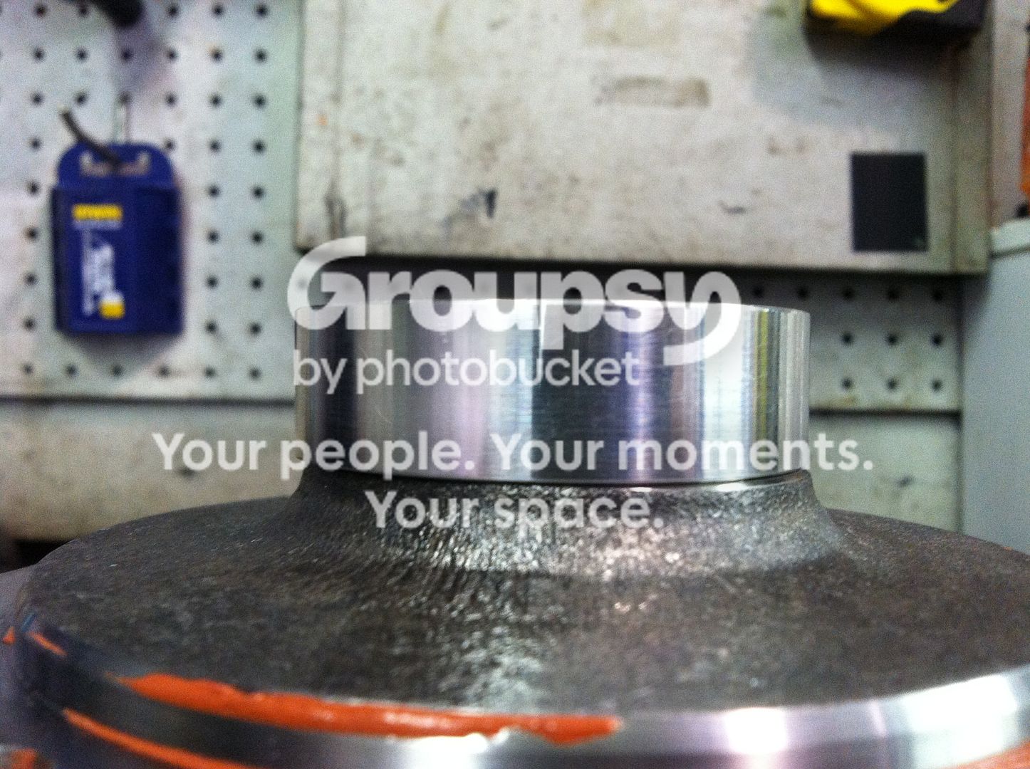

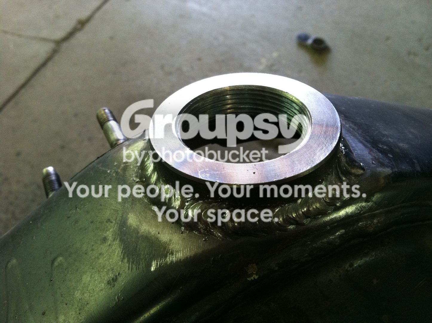

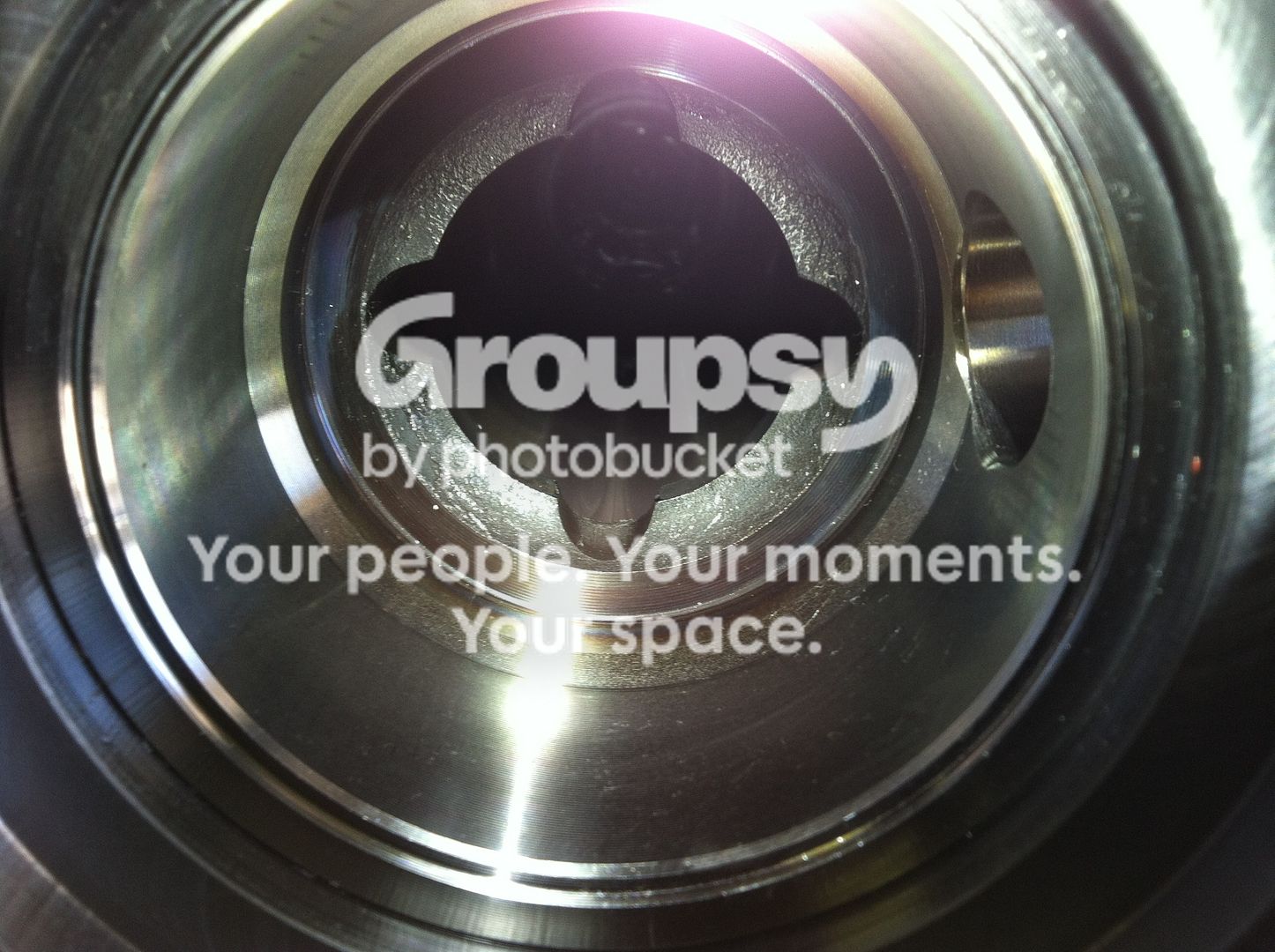

Next I installed an inspection/fill plug; I can see the both the ring and pinion through the access port, and it makes adding oil easy.
IMG_0586.jpg~original
IMG_0587.jpg~original
IMG_0592.jpg~original

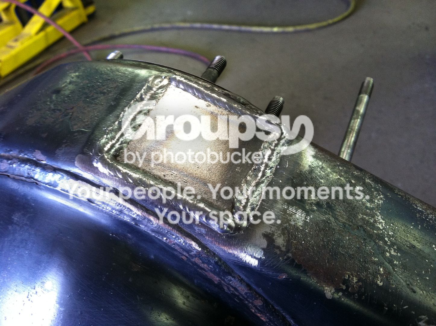

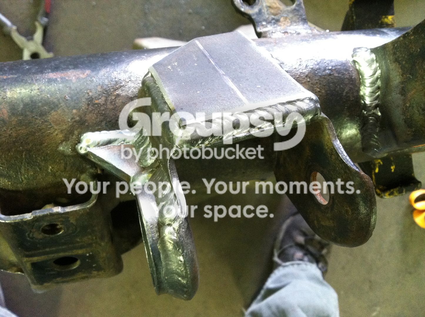

Since the brackets were bent, I just welded them to the coil buckets for a little more bracing.
IMG_0590.jpg~original

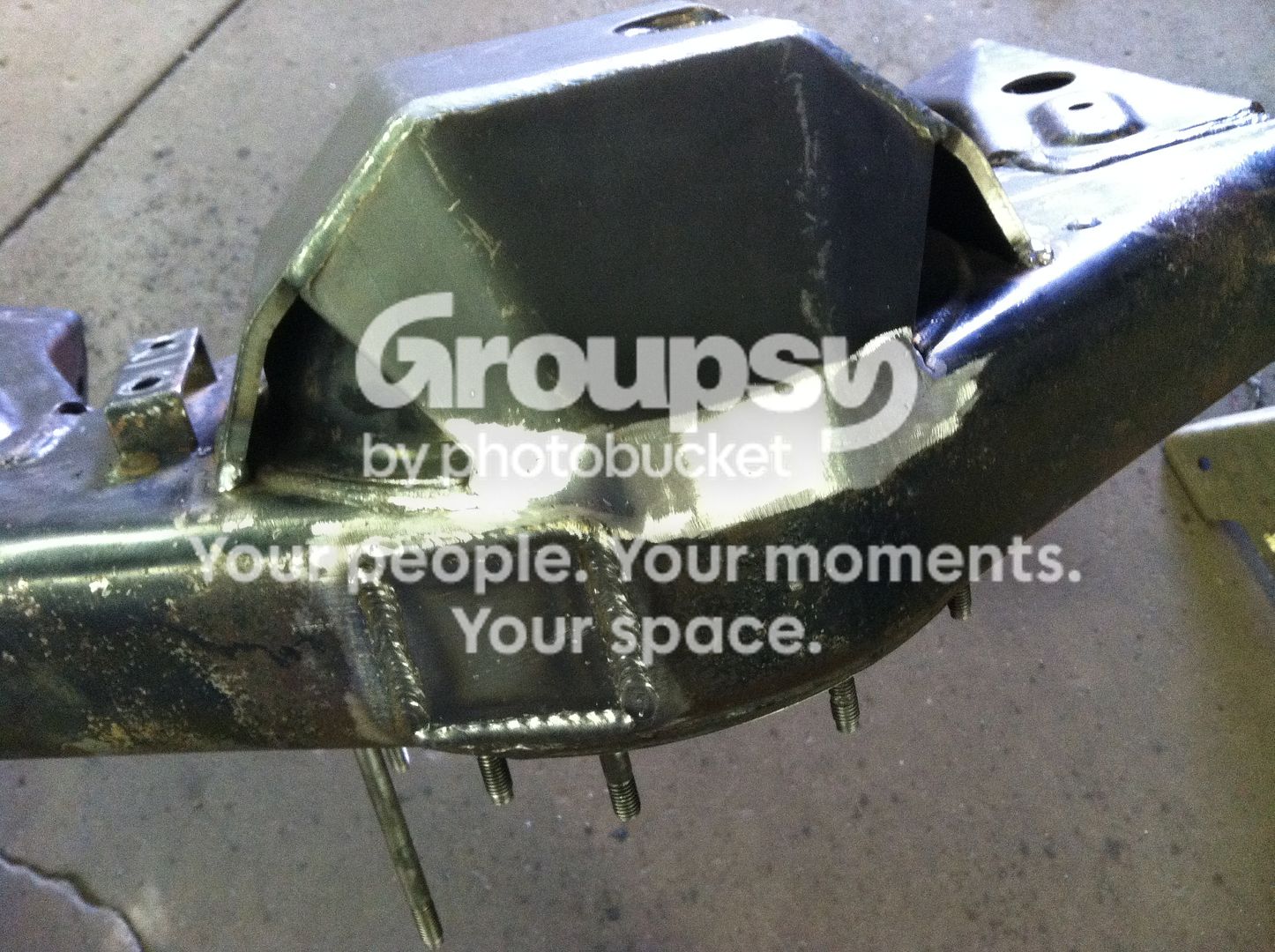

I also installed a HD diff guard; I trimmed the bottom down a little bit, made several passes with the welder and smoothed it all out so it will not catch on any rocks.
