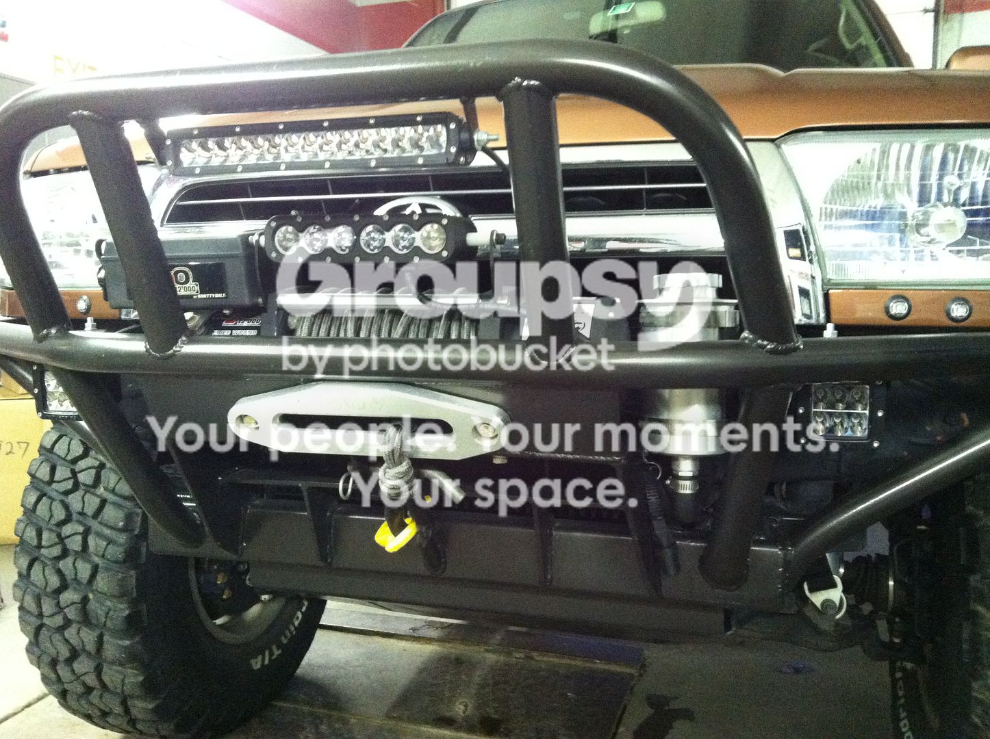

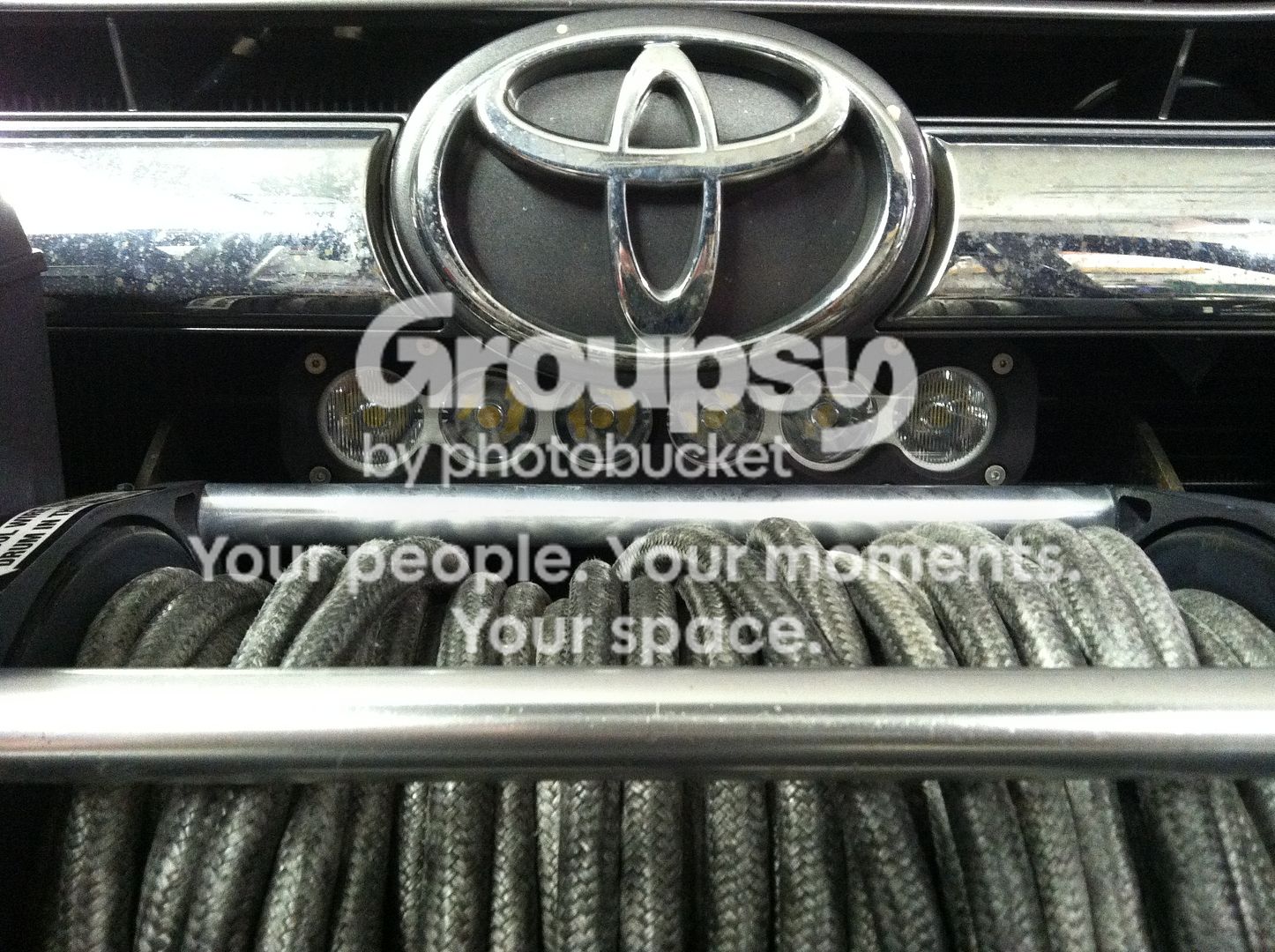

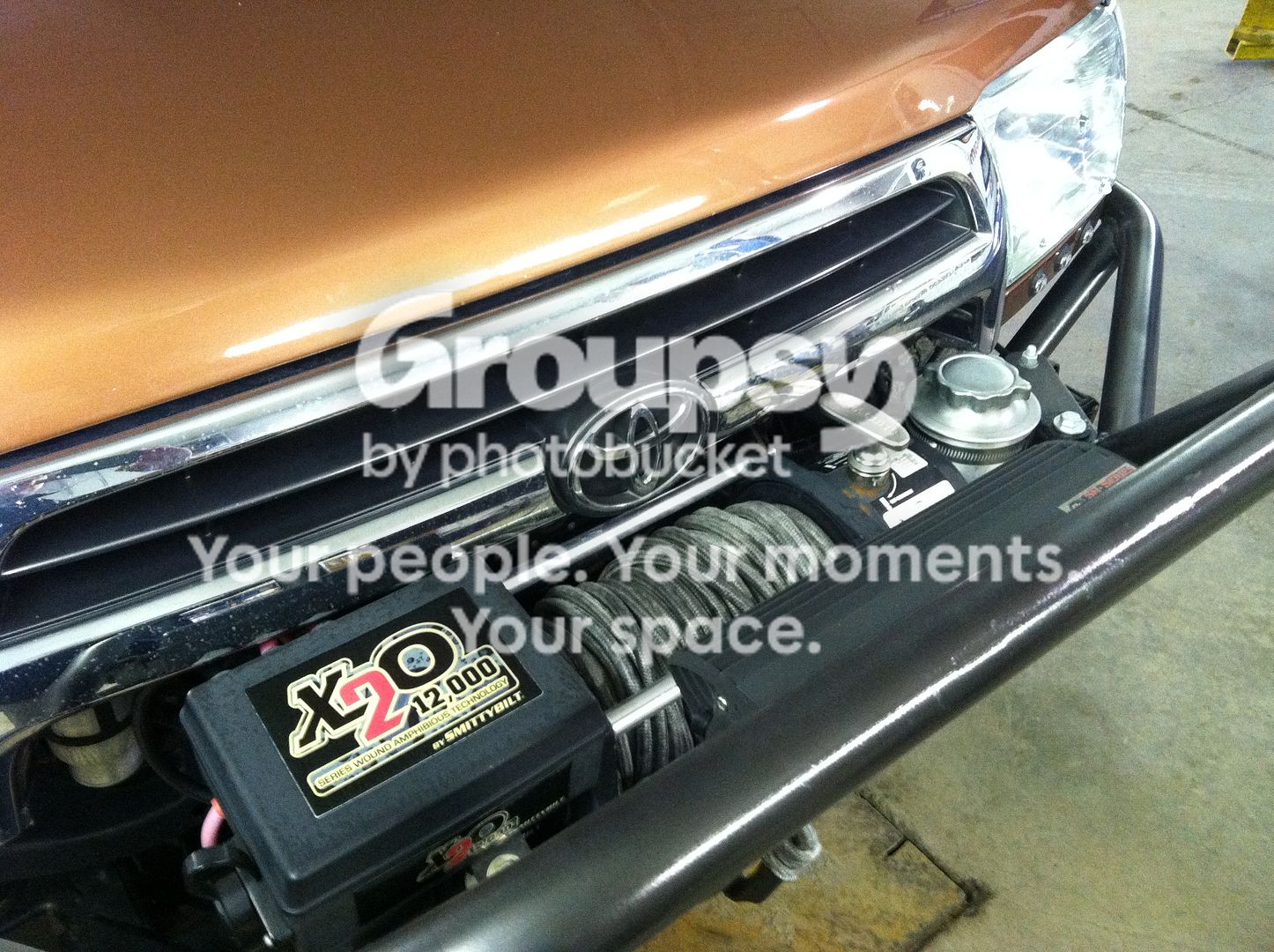

I installed a Rydel light bar not too long ago, but I really wasn’t happy with the placement of the light. It bugged me, and it kind of stuck out. So, I stared at it for a while and came up with the idea to tuck it back behind the grille.
Before
IMG_0765.jpg~original
After
IMG_0903.jpg~original
IMG_0906.jpg~original

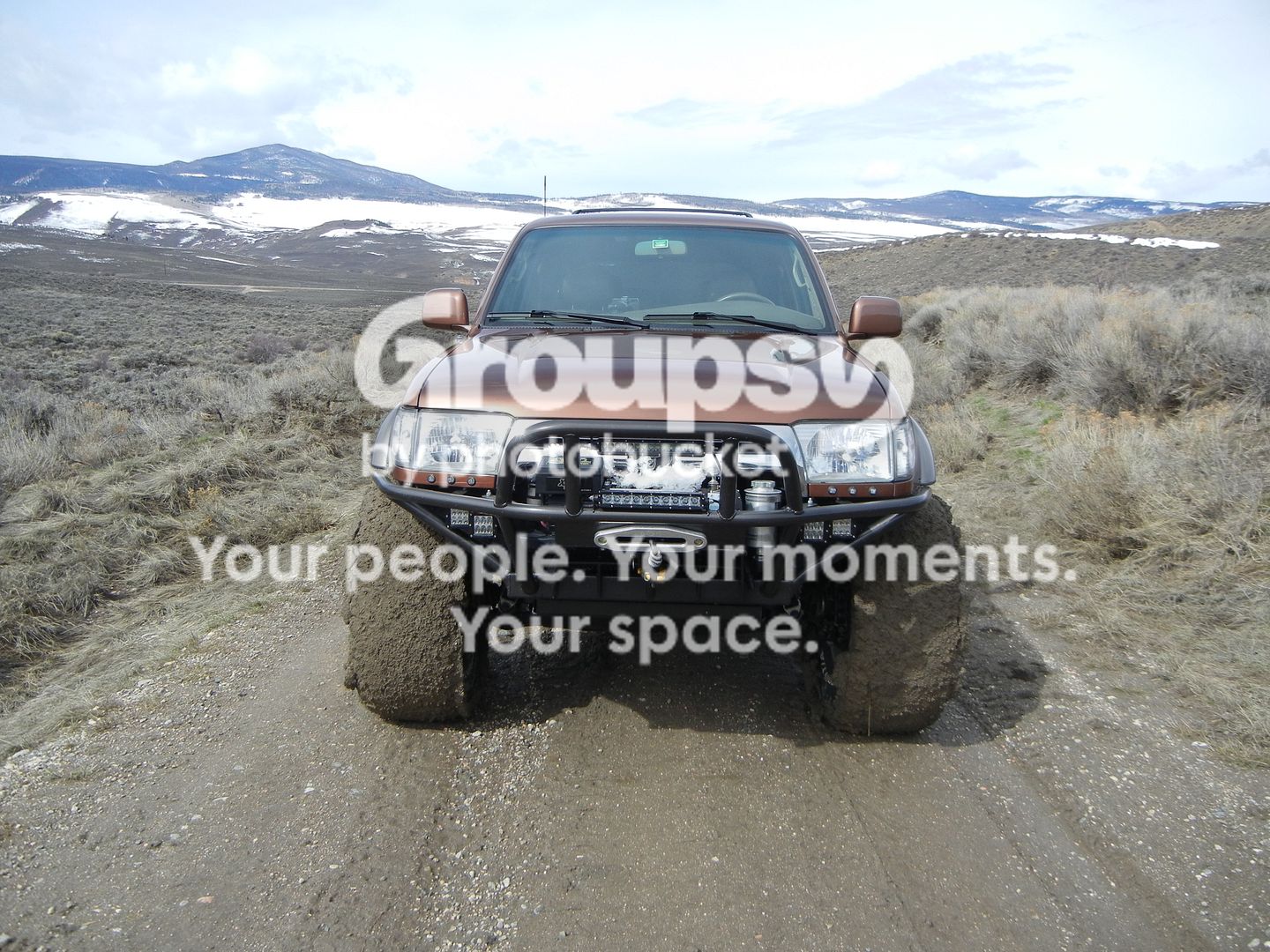

I bought the Rydel bar to compliment my Rigid Industries 10” Specter Series, driving beam light bar. I like the Rydel bar, but the color temperature did not match the RI bar. (Rydel @ 5000K, and RI @ 6000?) There were times I liked the Rydel bar more, and times I liked the RI bar more; it just depended on the conditions.
The Rydel Bar is a great addition to the stock headlights, and works great for wooded trails and slower rock crawling. The color and beam pattern work well in these conditions.
But, I still felt that I needed more light for high speed, open area, desert style wheeling. I decided that it would be best to add to the RI lighting, these lights are top of the line and while there are cheaper LED lights out there, the cheap versions do not have the optics and patterns that make these lights what they are. I decided to add a RI 10” single row spot pattern light, and a pair of D2 white driving lights. That gives me more distance, and width. Also, because the lights are separate of each other I can adjust beam width and height.

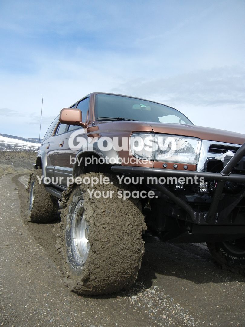

The trail started out a little muddy, it was sticky crap that is hard as hell to get off of the truck (pervious experience). So I took it slow to keep the mud to a minimum, I hate mud!
I now know what my rig would look like with 15” wide slicks! :D

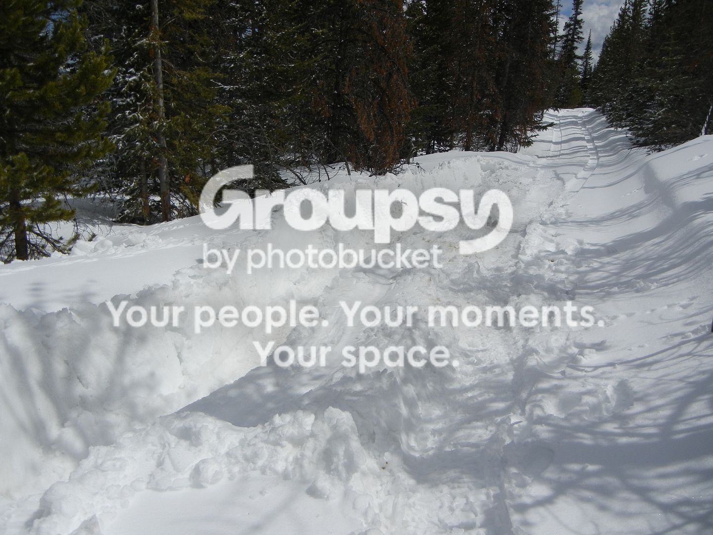

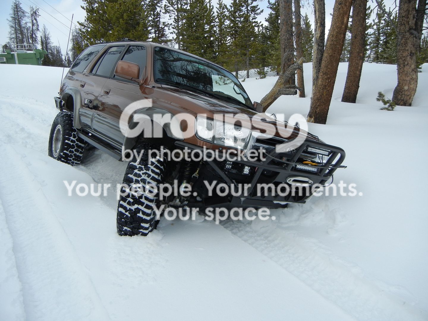

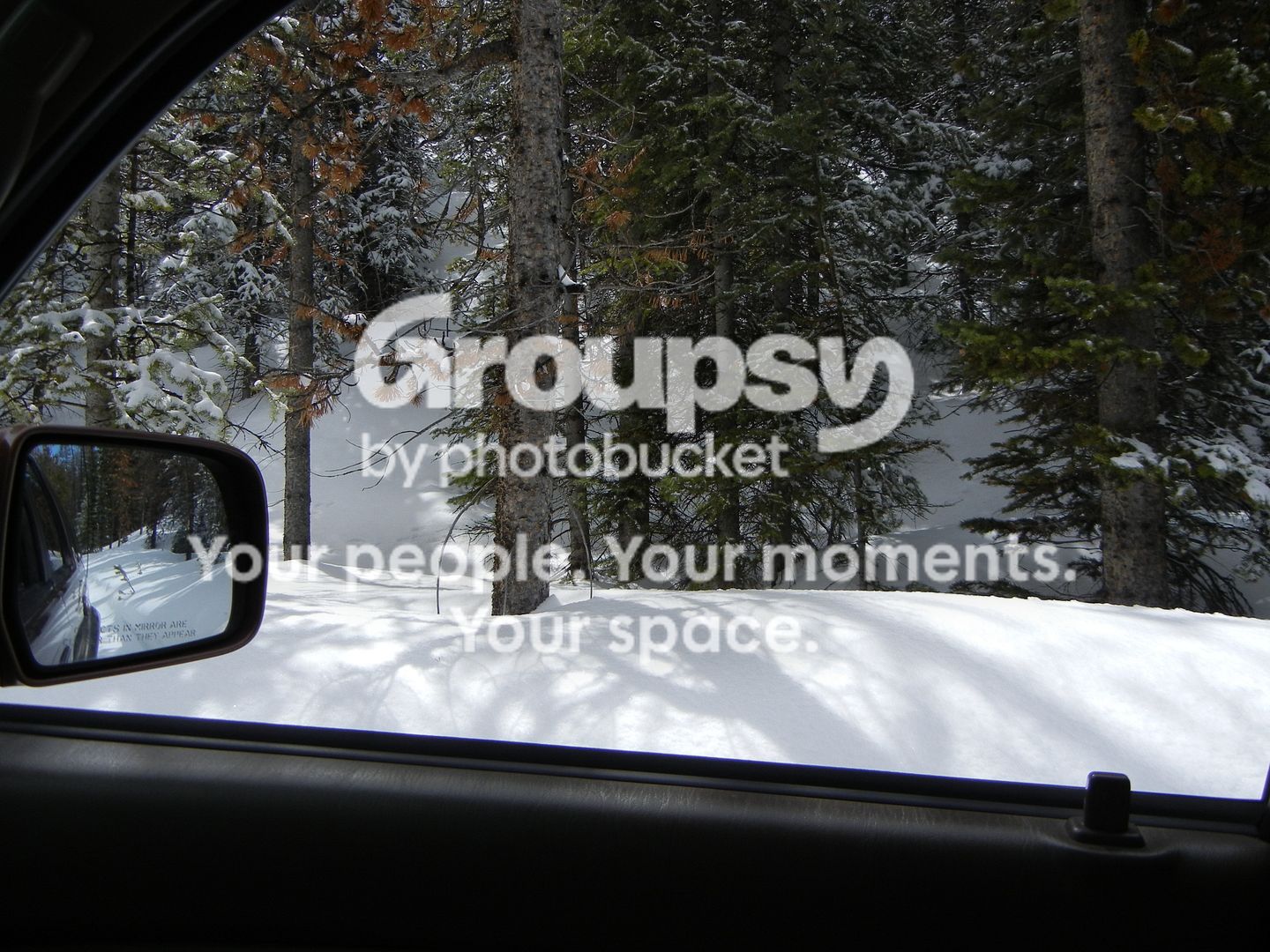

Once I got to the snow I aired down to 5psi, then once I got to the deeper snow up in the trees I aired down to 2psi (the lowest I've gone to date). It was a warm day and the snow was wet/heavy.
I've always wondered about tucking led bars behind the grill, but it seems like not many of 3rd gen owners do it (if any). When you purchased one back before Christmas, I was dead set on buying one, but looking at the limited mounting space behind behind the grill left me timid. So are you still using the Rydel bar and what did you mount it too back there?

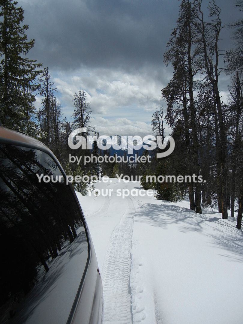

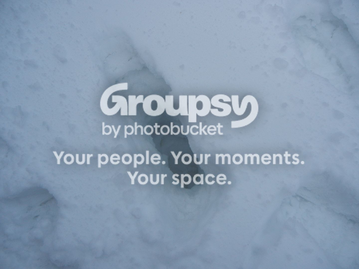

The main trail was packed down from me going up there several other times this season, and from a snow cat going up there to service the radio/cell tower that is at the top. Once you got off the packed trail it was a good 5'-6’ deep!

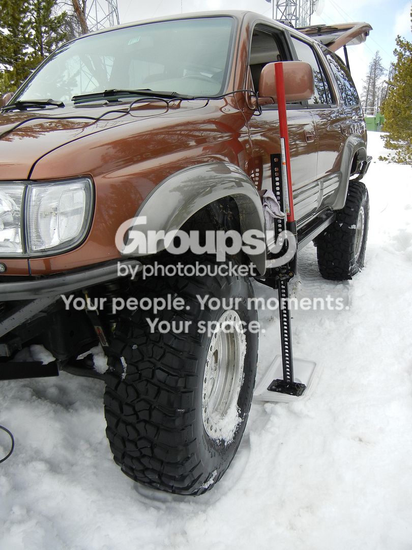

Once I got to the top (about ten miles in), I turned around and started to head back down. It was slow going to get to the top, and I was looking forward to playing around a little on some of the side trails and camping spots. A couple car lengths later and I fell off my tracks towards the driver side of the 4Runner and dropped to my bumper/headlight, this was normal for the day. I turned on the front ARB, cranked the wheels hard to the passenger side, and started to crawl out of the hole. I heard something break, and the driver side tire stopped spinning.

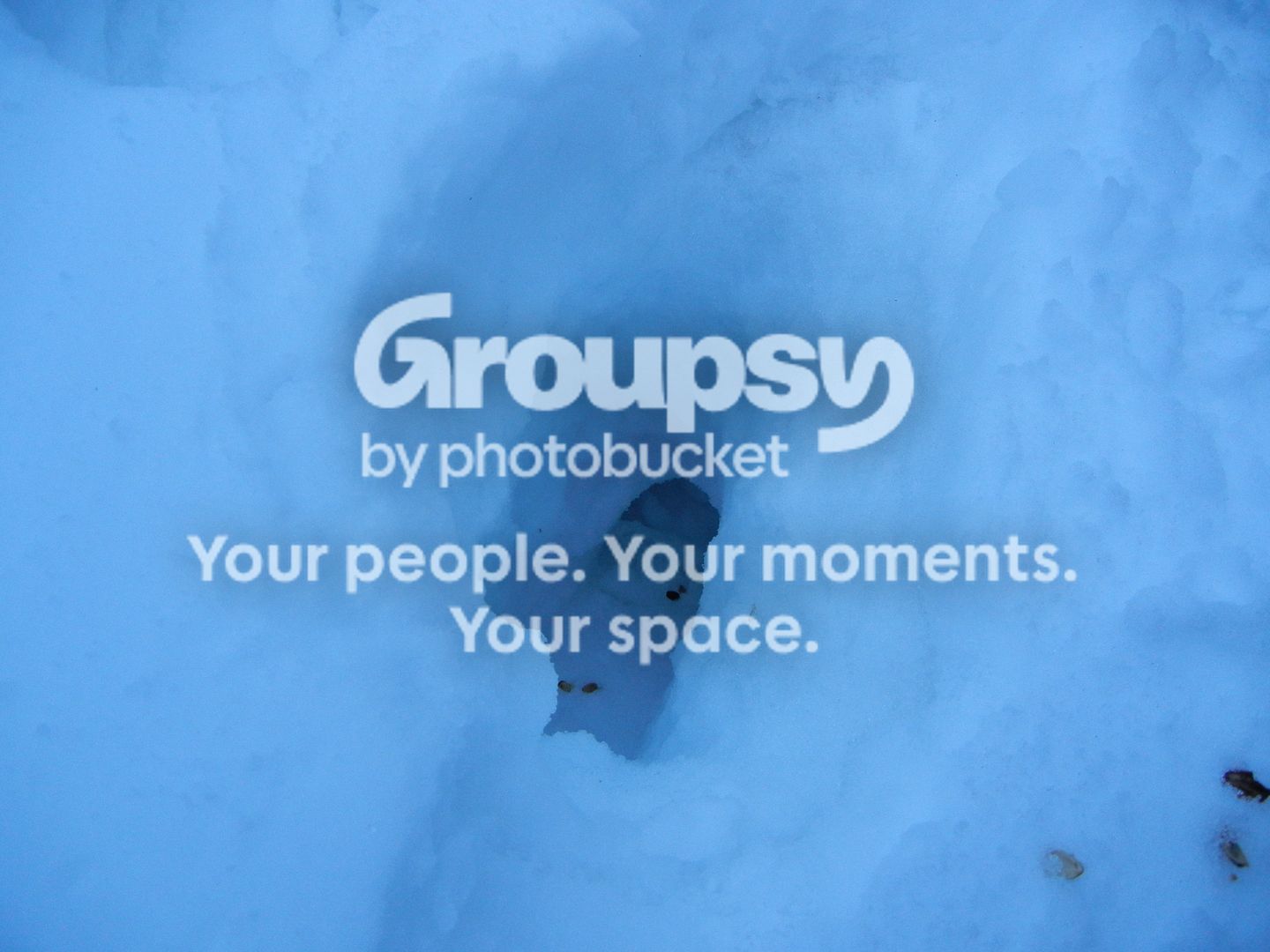

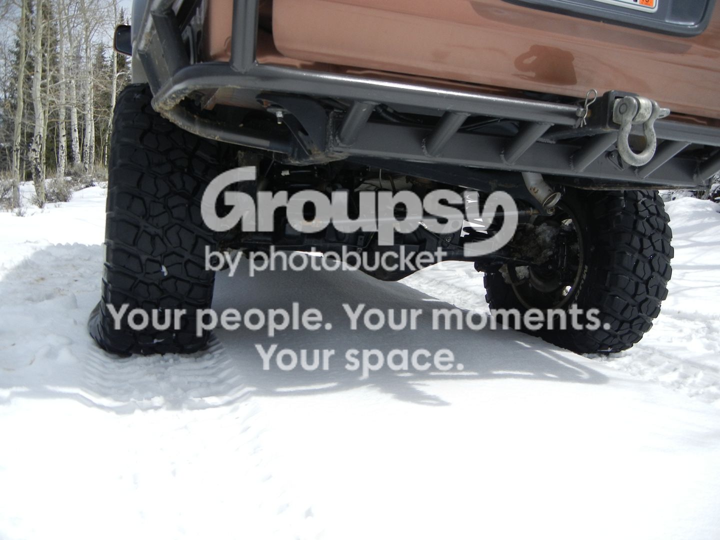

I winched out of the hole and found this!

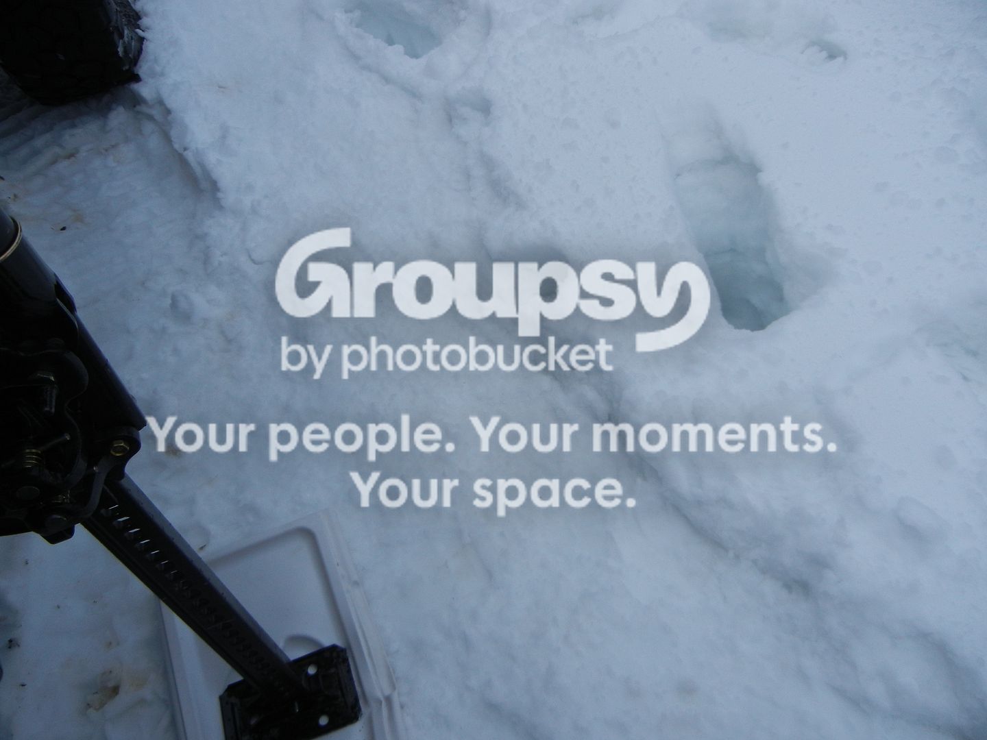

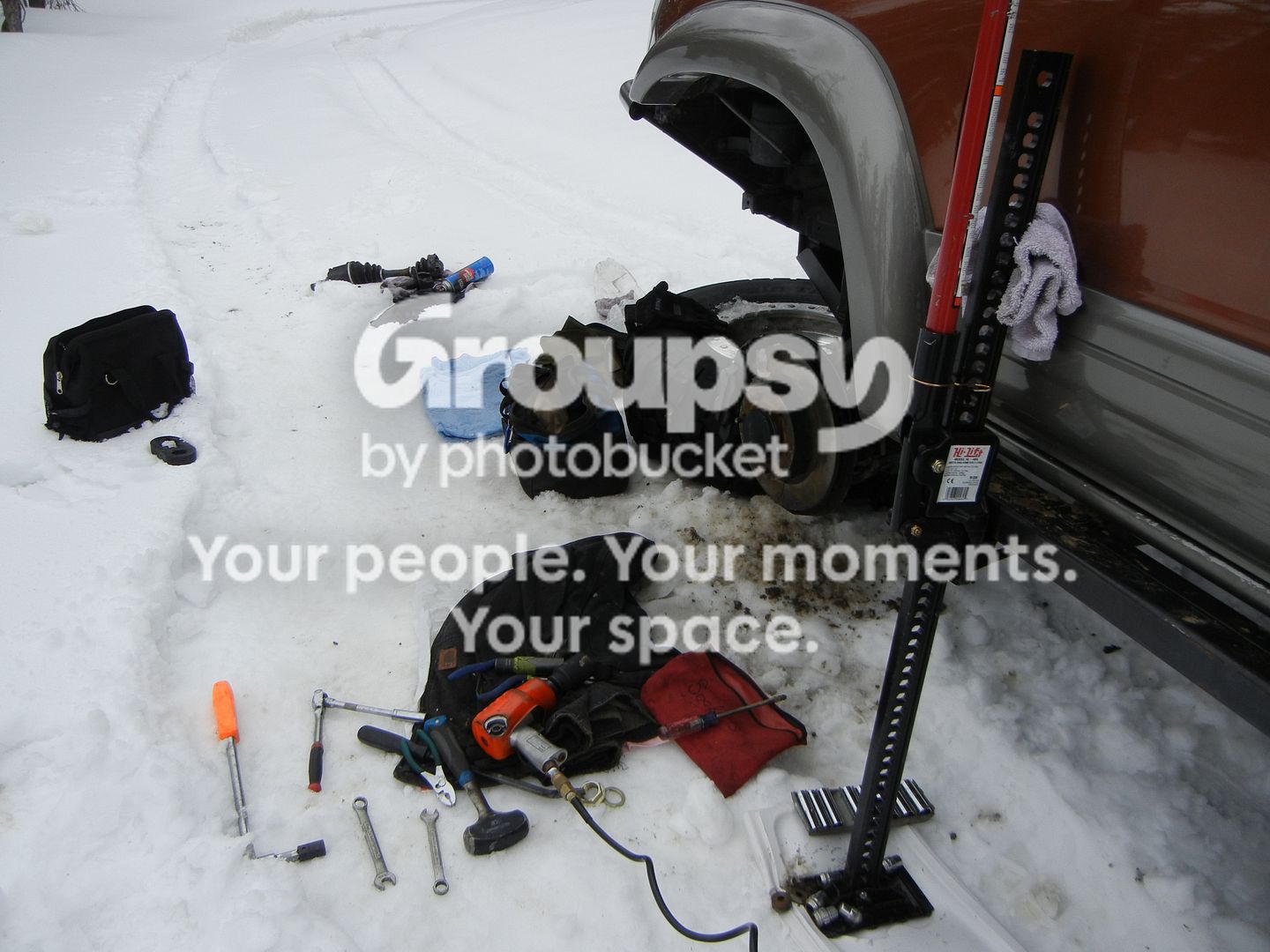

I had no choice but to change it where I was; late in the afternoon, 10 miles in and on top of 5’ of snow! :D
I stole the lid off my cooler to keep the jack from sinking and got to work!
The snow doesn't look that deep, but if I got more than a foot or two away from the 4Runner I would sink!
If you look at the before picture you can see that I made a couple brackets that bolt to the side of the winch. I just moved those to the rear winch support and angled the light back. The location is not ideal, you loose some light output right in front of the truck, but the headlights make up for that and between the color / beam it's almost a seamless transition. I also bought some replacement spot optics that I might swap out with the flood optics that are in it right now, they were only $1.50 each.
I can mix and match, but I have three main aux forward facing light modes:
1. Stock headlights with Rydel bar - 5000K
2. Amber - RI D2 driving lights, with or without headlights - Wired to fog light switch
3. 6000K - 10" RI Specter Driving bar, 10" RI Spot bar, D2 Driving lights - All controlled with one switch.
