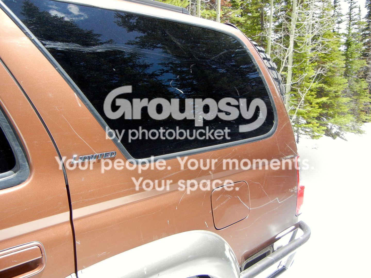

Going through an off camber section the 4Runner slid into a tree, luckily there was no damage, except for a couple scratches that should buff out. I’m really surprised the rear side window didn’t break; you can see the mark from a branch dragging across it!

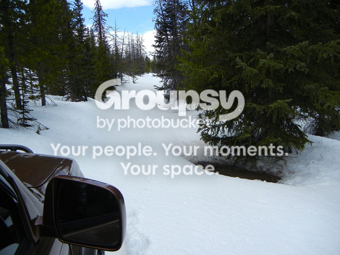

And this was the end of the trail for the day, the snow was just too slushy and slippery to try and cross this spot. I really pushed my luck just getting there, and I would have slid into that tree if I had gone any further. I tried to back up and slid off my tracks, I ended up having to winch myself 180 degrees to get out. It was a little interesting, but I made it work.

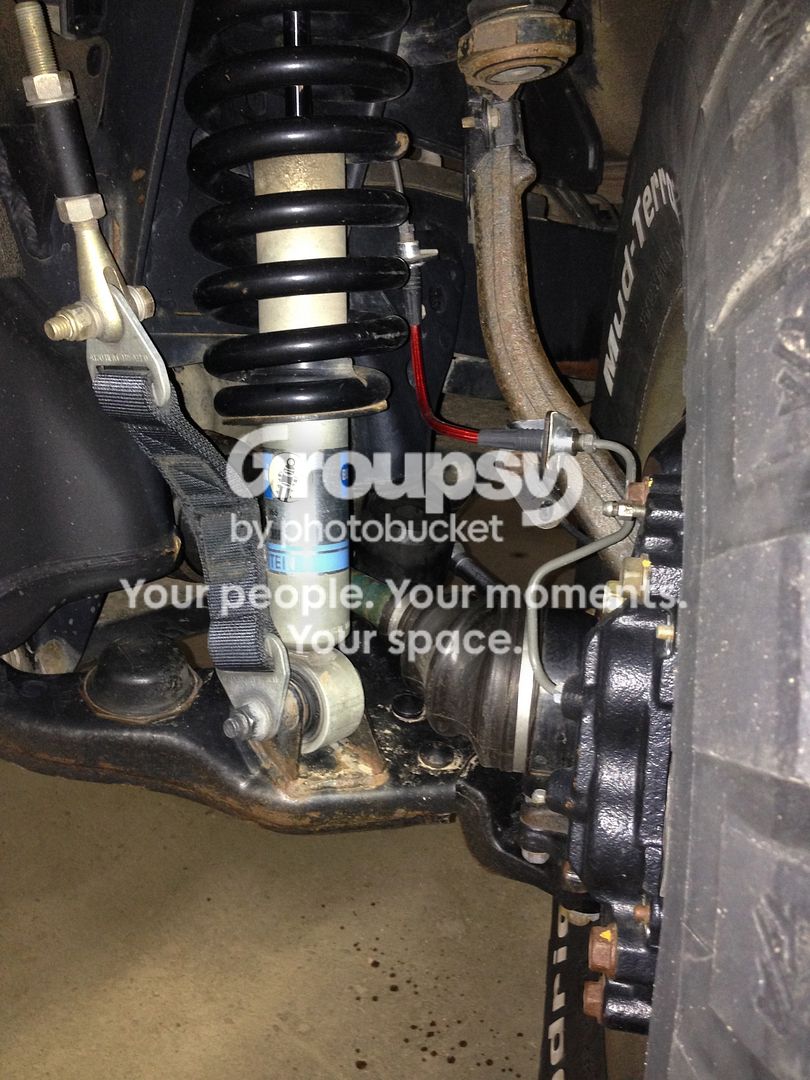

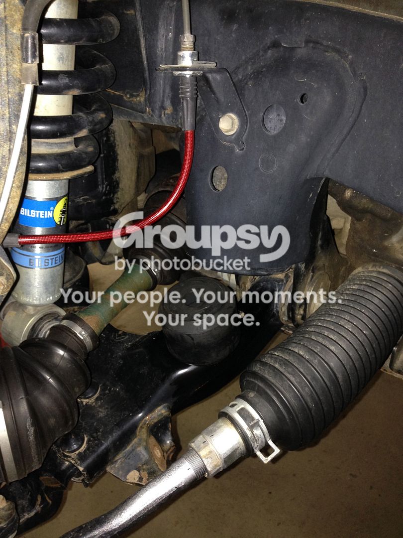

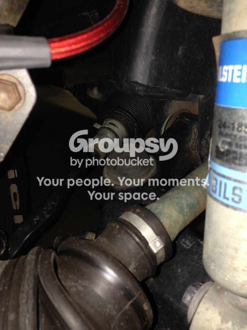

When I removed the front sway bar I gained a bunch of up-travel in the front suspension; this was a good thing and really smoothed out the ride, but it also led to some issues. Primary during high-speed trail and expedition style driving, the front suspension had a tendency to bottom out during harder hits.

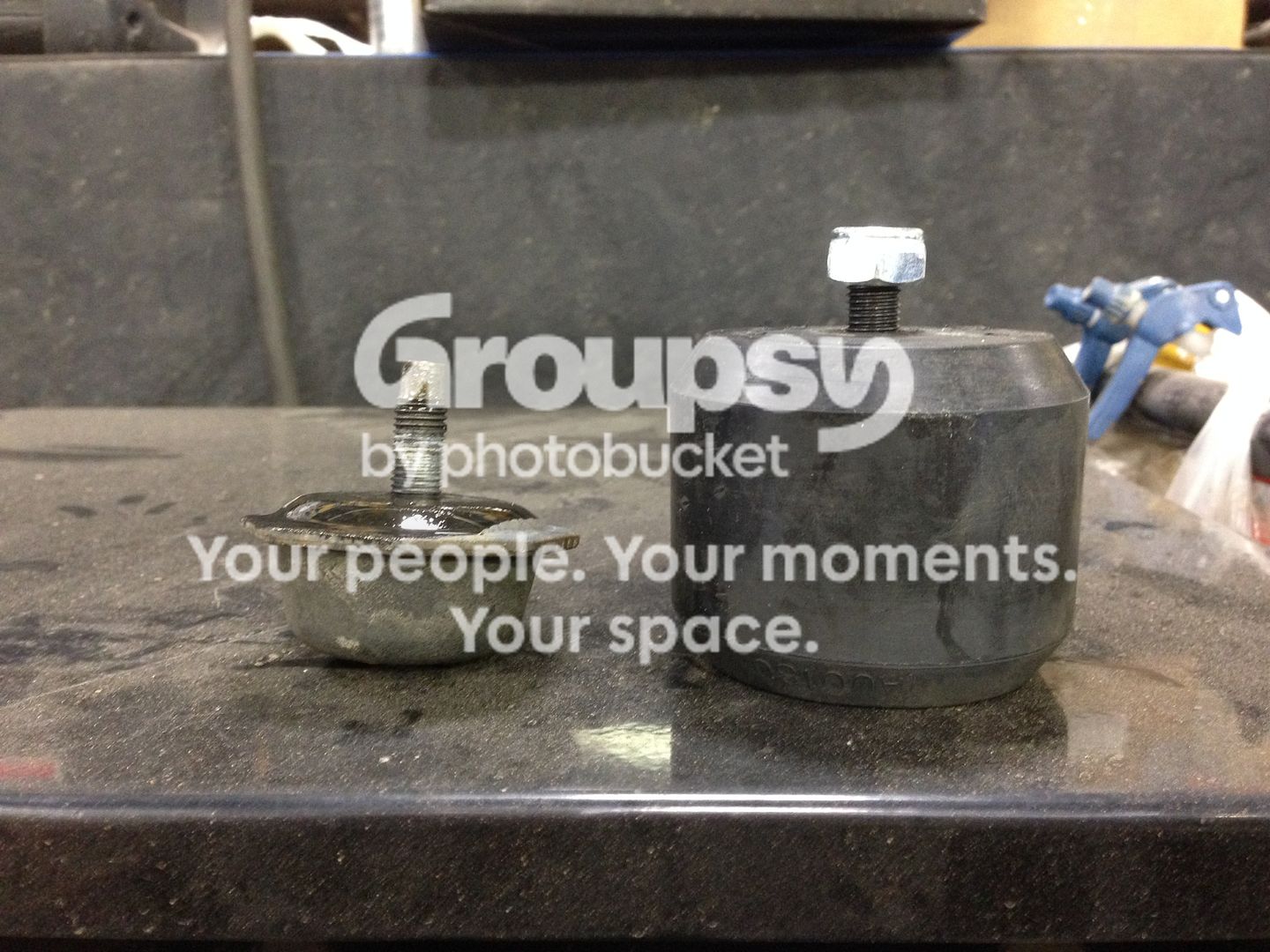

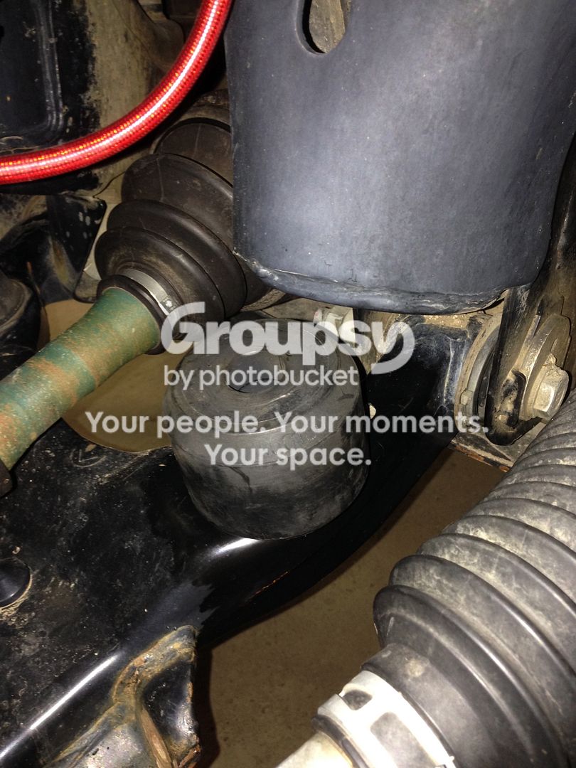

So I bought some Timbren bumpstops; they are a progressive rate elastomer rubber spring. They are a little expensive for what they are, but if it does the job it will be worth it.
http://timbren.com/single-convolution/
Old and new
Old
New
Part# TOFTAC4A
And, have you had a chance to drive with them yet? Thoughts?
I ordered mine through Wheeler's Off-Road and they sent another part number, which I believe is a Tundra application. Maybe they can chime in and give some more info on why they use that instead of the part number you listed, which is the correct model for the 4Runner.

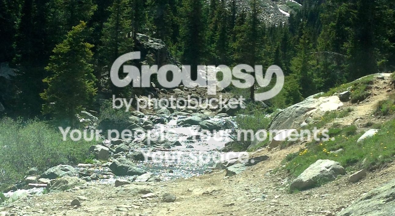

I headed up towards Ptarmigan Pass; the lower section starts in a riverbed and usually has water flowing through it. This time the water level was very high, and the entire lower section was in water. The stream crossings were a good 30-35” deep!

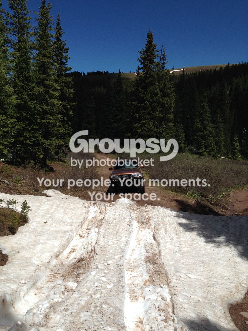

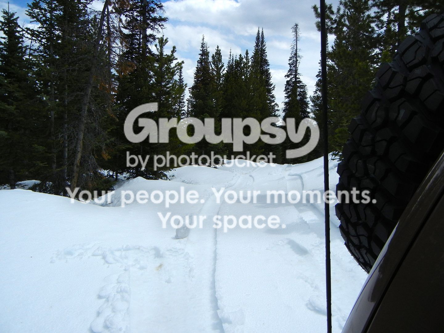

About ¾ of the way up the trail I hit snow; it was solid, but I was in more of a summer wheeling mood and really didn’t feel like airing down more (or recovering the truck if it got stuck).

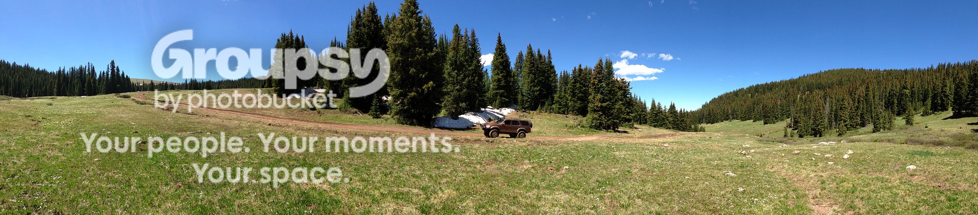

So I headed back down the trail and made the decision to go check out Holy Cross, since it was only 20 minutes away. It was late Sunday afternoon and there was no traffic on the trail, so I made record time up to French Creek. At the creek I ran into two guys, they were headed down and they told me there was a small group still up the trail. I decided to give it a quick shot…
