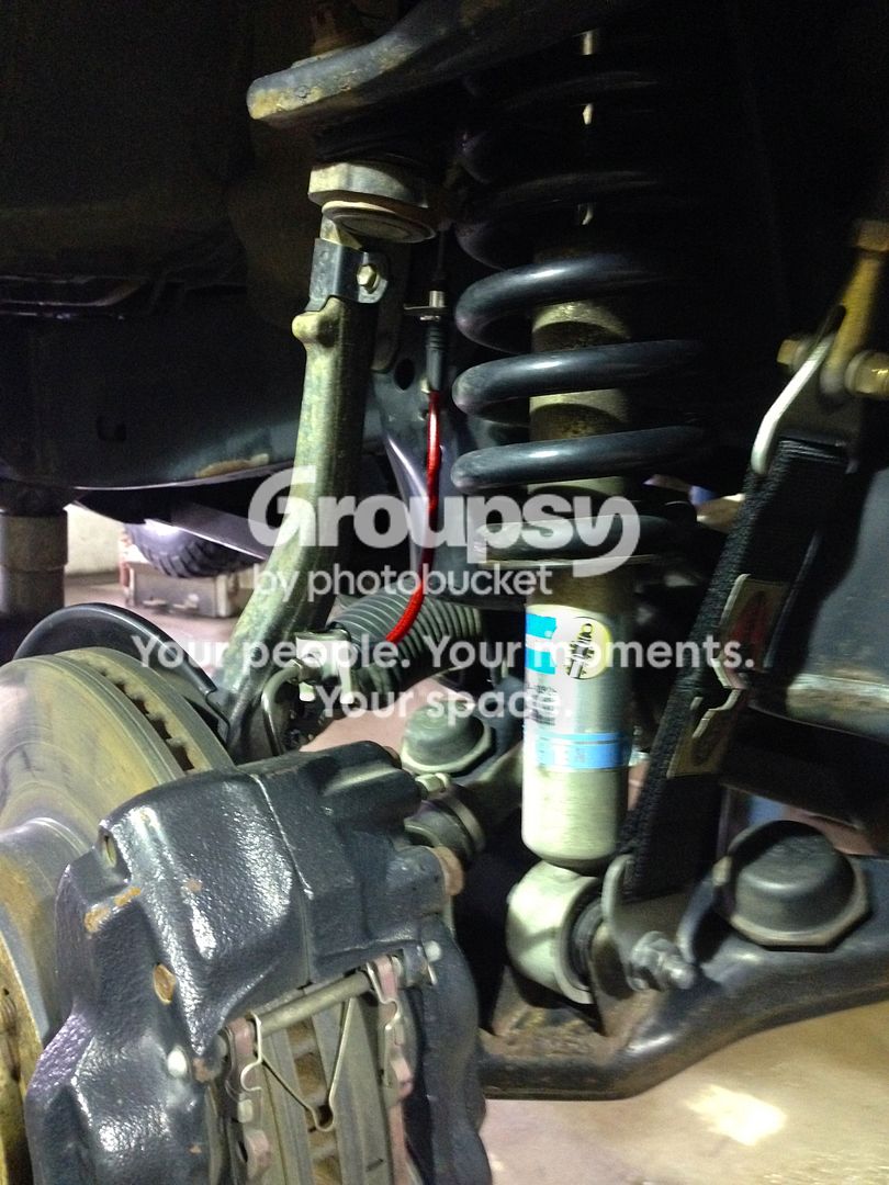

With respect, I suggest you go read on the differences between an IFS (Independent Front Suspension) and a Solid Front Axle.
The only 3rd gens with birfields are those that have SAS'd, or Solid Axle Swap'd.

Yes, the picture you posted is a CV axle. Lotus Axle makes a chromoly CV axle.
Birfields and Longfields are axles for straight axle trucks. I wouldn't expect a response back from Trail Gear.
This is what a Birfield/Longfield looks like: http://www.nitro-gear.com/storage/AX%20TBIRF-30-KIT_small.jpg?__SQUARESPACE_CACHEVERSION=1275515503462
You need to buy a CV Axle , NOT a Birfield because you do not have a solid axle truck.

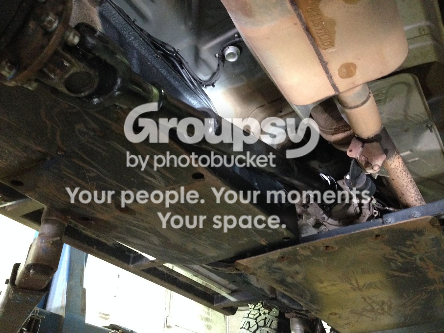

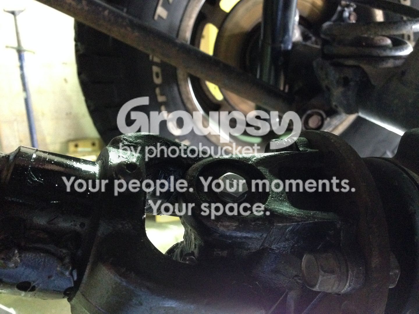

For a while now I have noticed a small amount of vibration coming from the rear driveshaft. It wasn’t that bad at first, but it’s slowly been getting worse. So I decided to have the driveshaft rebuilt before it became a major problem.
I took it down to Rocky Mountain Driveline to have it rebuilt, and while it was there re-tubed with .120 heavy wall tubing. They called me a couple hours after I dropped it off and told me the CV was not repairable, so they had to replace that, along with all the u-joints.
Not much to look at, but hopefully it will do the job. You can see why I wanted the heavy wall tubing by looking at my skid plates!
I removed the grease zerks for the slip and rear u-joint, and installed bolts instead. The rocks will just break the zerks off, and let water and dirt inside the grease. When it comes time to service them I just remove the bolts, reinstall the zerks, add grease, and reinstall the bolts when I’m done.

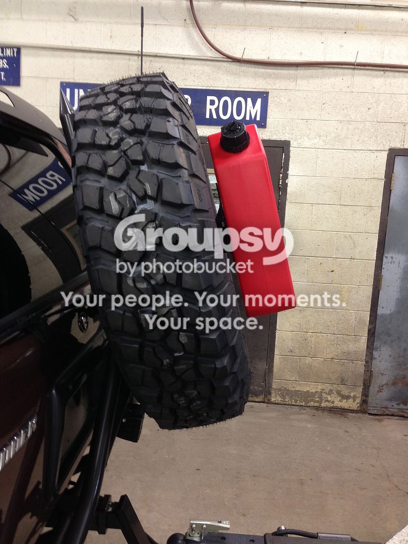

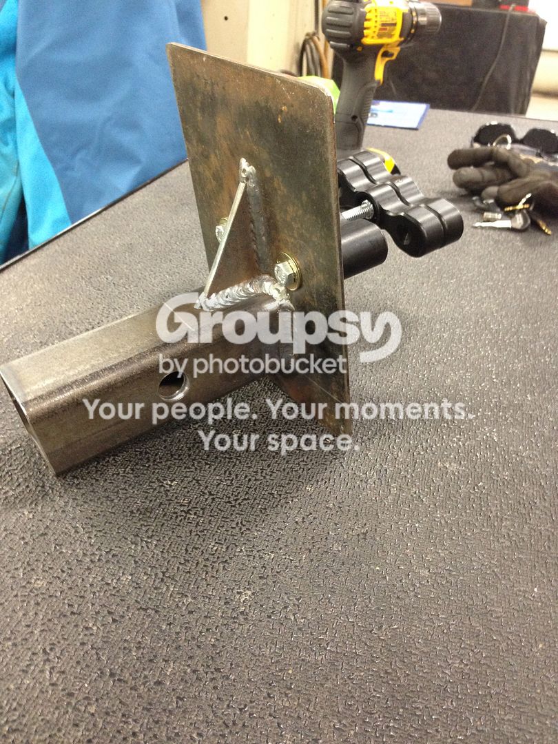

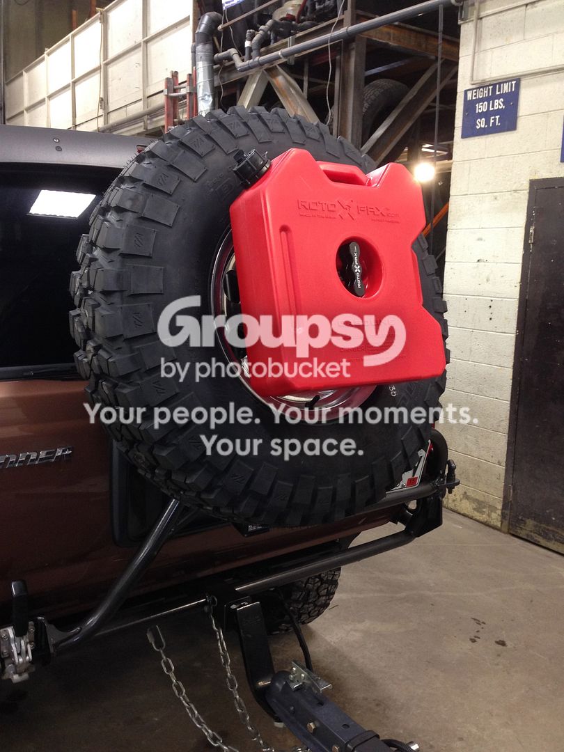

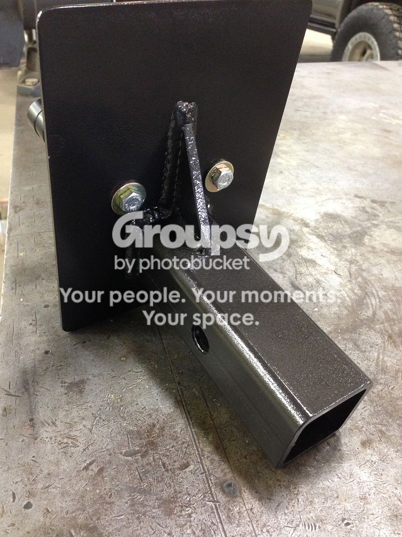

On one of the Moab days I will be running a pretty long stretch of interconnected trails. I was a little concerned about fuel range, and the saying “It’s better to have it and not need it, than need it and not have it” kept ringing through my head. I wanted a small fuel container, but I didn’t want it inside the vehicle.

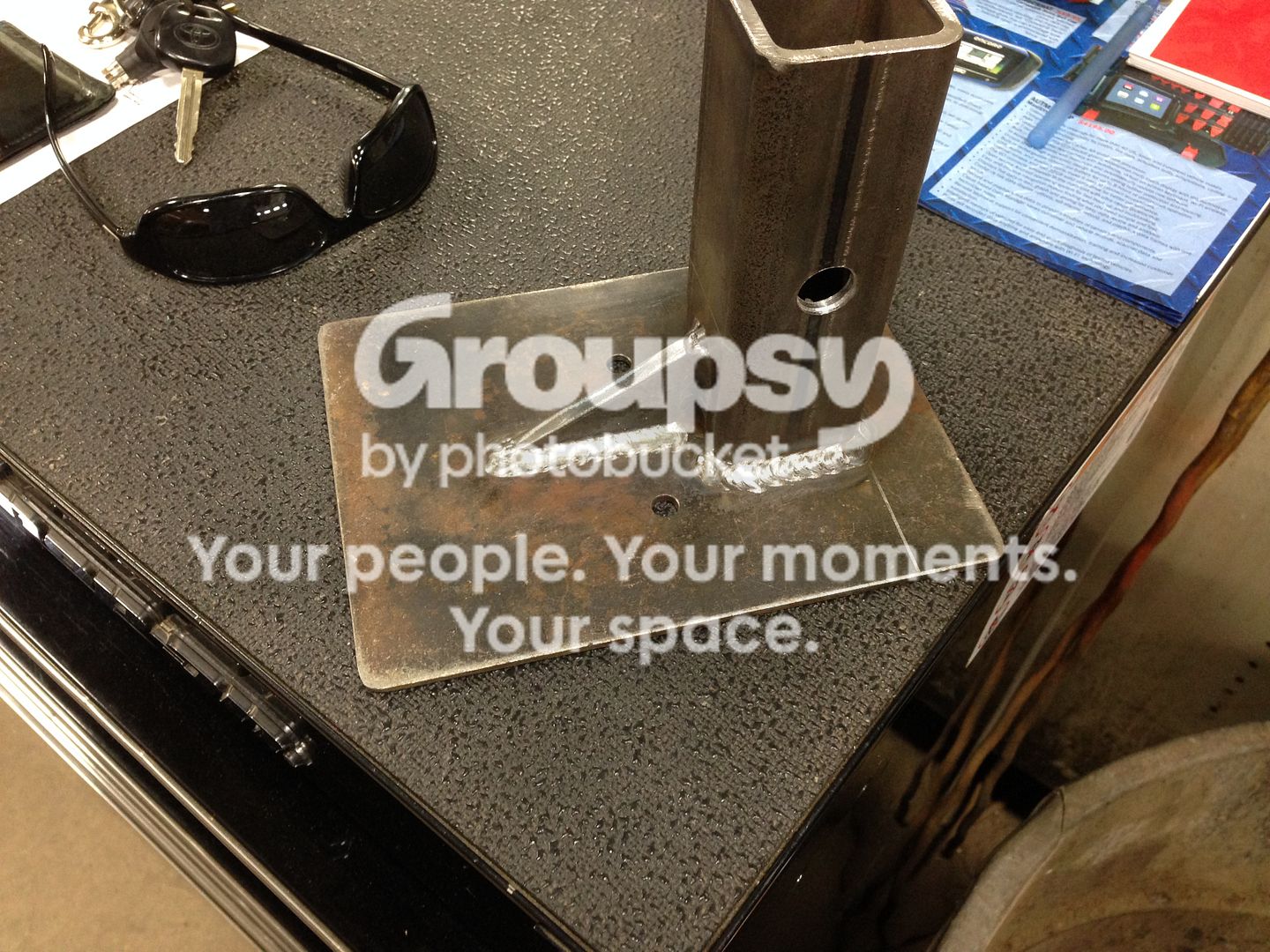

I decided on a Rotopax three-gallon fuel jug; it’s small, but on longer trips I have the trailer, which has an 18-gallon fuel tank. It will really only be used for long trail days, more than a day and the trailer will be with the truck. I fabricated a quick bracket that would use the 2” receiver I built into the spare tire carrier.

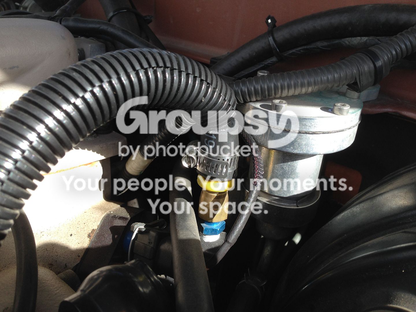

I forgot to call URD about the fuel line, and it’s too late to get it for this trip. The old line wasn’t leaking, but it was dried out and cracking. I pulled the line off, installed heat shrink on the ends, and then hose clamped them. The glue and tension of the heat shrink will keep the hose from separating any more, and the hose clamps will keep everything nice and tight. I will still order a replacement when I get back.
Before
After

Nice welds :thumb3:
Thanks Rob!

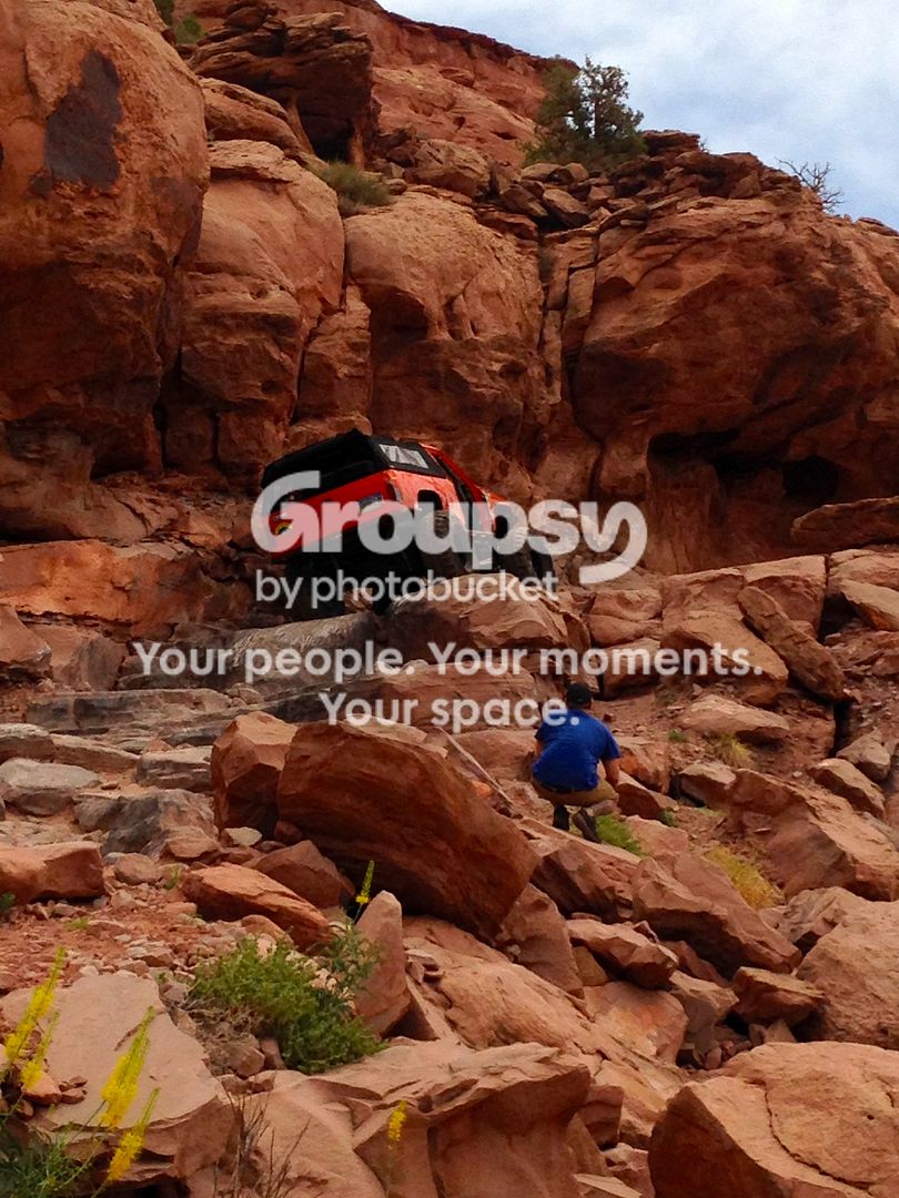

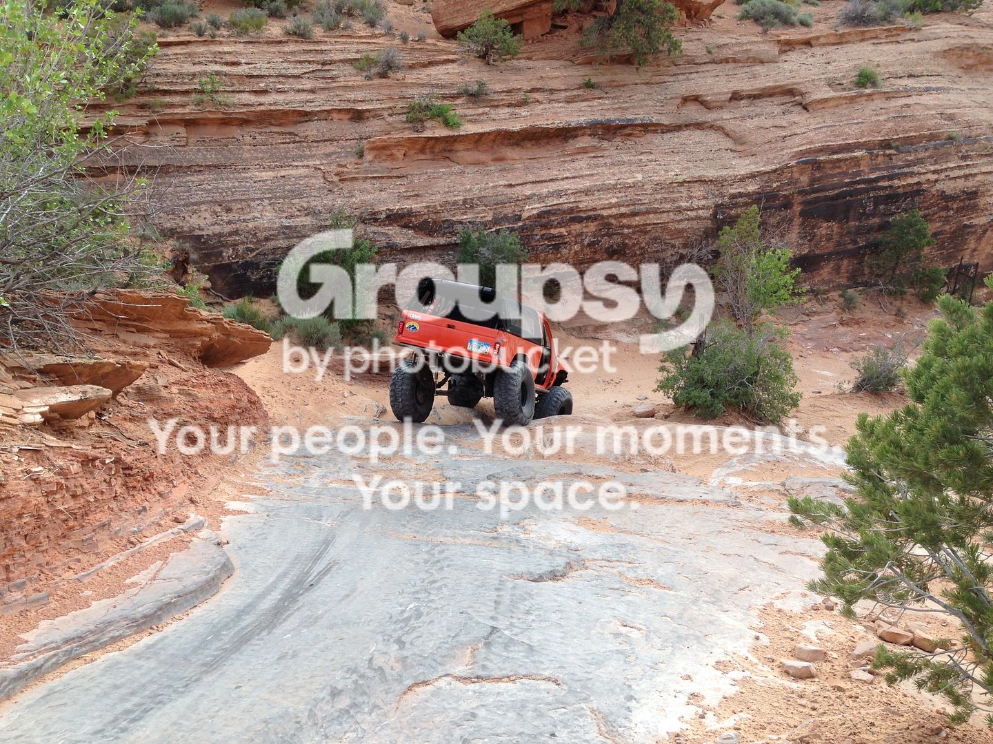

Monday was Cliffhanger, and it’s been on my list for a long time! It’s one of those trails that I have wanted to run, but was a little intimidated by it considering it’s on the side of a cliff with a pretty nasty obstacle. I felt the need to check it off my list, so off we went!

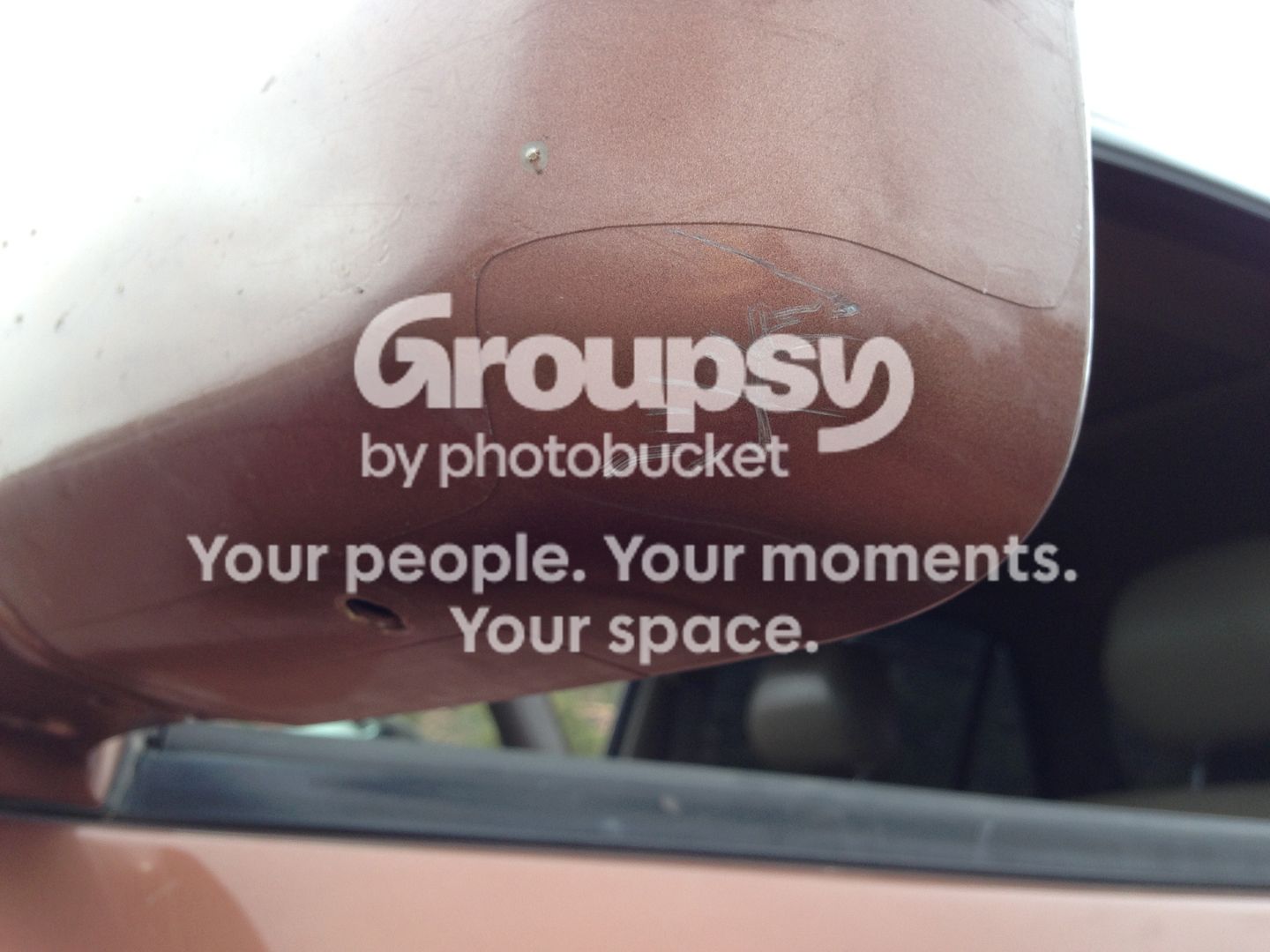

I scratched the driver side mirror a little bit, but that was it.
