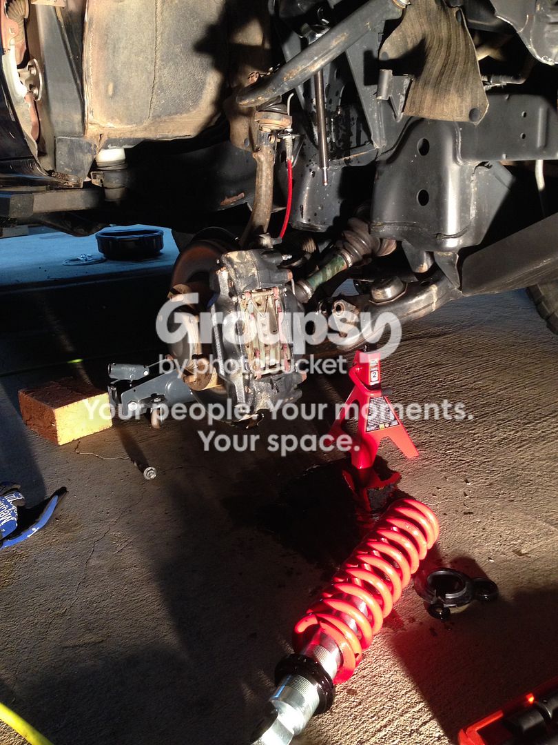

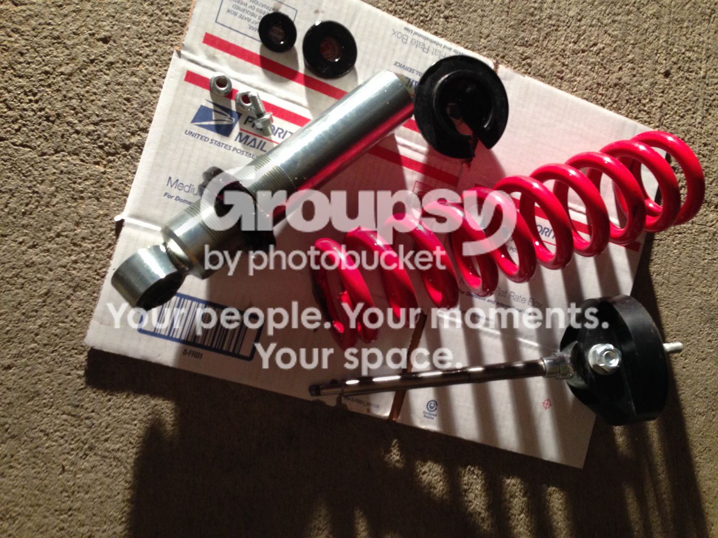

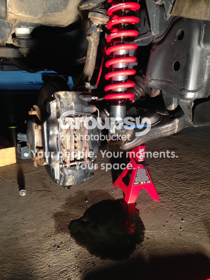

Also, I raised the front end up to check it out and see if anything was loose. In the process one of the new shocks on the Boss coilovers blew it’s seal (or I thought) and leaked out all the oil in the shock (the passenger side). Kind of sucks since I only have a couple wheeling trips, and a couple trips into town on it.

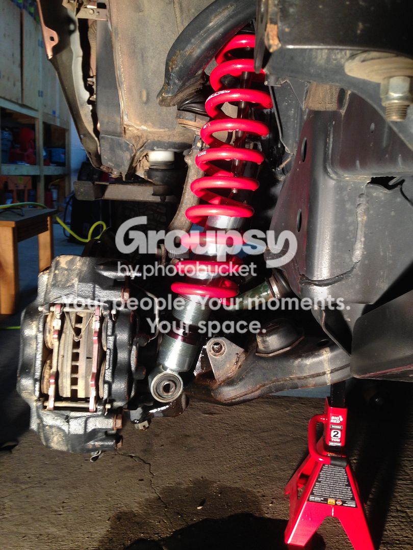

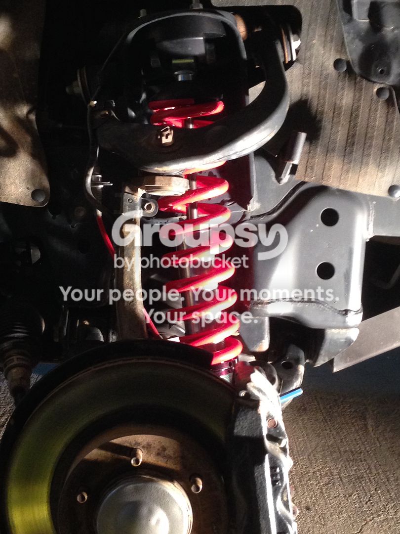

I talked to Toytec and they said that they would warranty it, but I needed to bring it down to them so they could swap out the coil on the shock. My wife had some stuff to do down there today, so I pulled the coilover last night. Much to my surprise it was a bit more than a leaking shock.
First, the suspension seemed to droop a lot more than normal. I pried down on the suspension but the coilover kept pressure on all the hardware, I was able to drive the lower bolt out with a punch but then it got stuck in the process. The whole time the shock was puking fluid. I stepped back to think for a few minutes and things were not looking right…

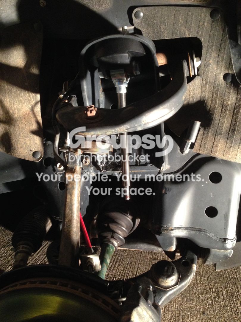

After fighting with it for a while I got the punch out, and my concerns were realized.
Toytec was great about getting it all swapped out as my wife waited. It seems like it was an isolated case, but I will be reinstalling my front limit straps to take the stress off the coilovers.
The bad news is that the unrestricted down travel took it's toll on the front suspension. The boot on the upper ball joint separated, the stainless steel front brake line bent and broke the ends, and the outer CV boot split. At this point I'm looking at yet another front end overhaul.

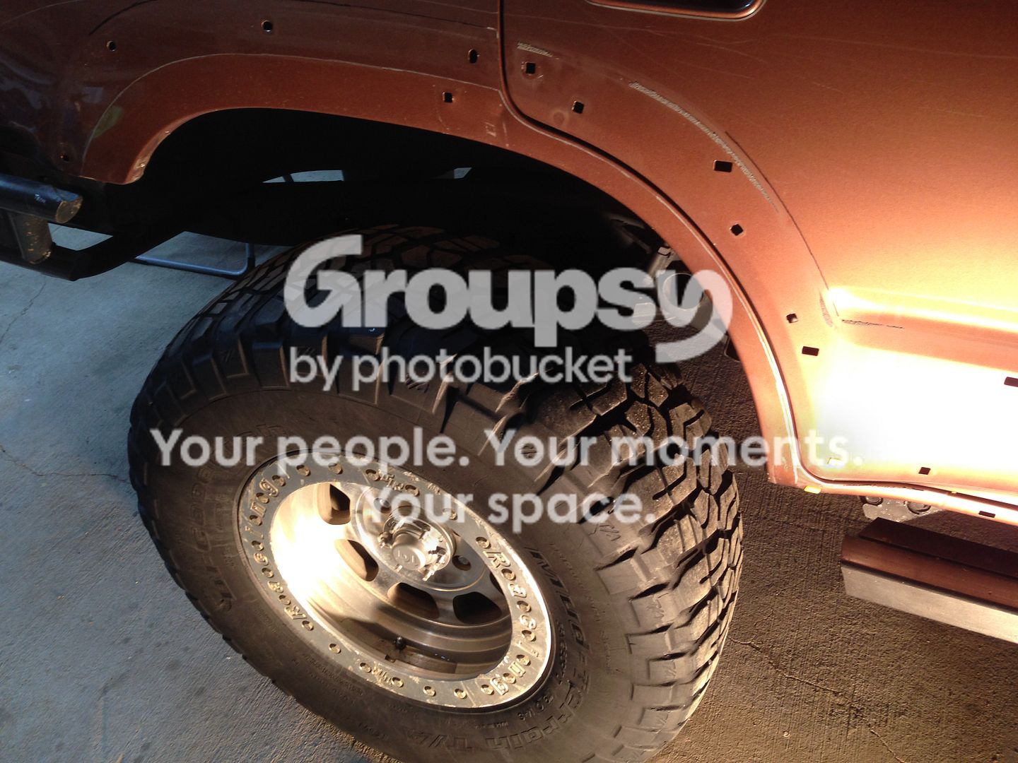

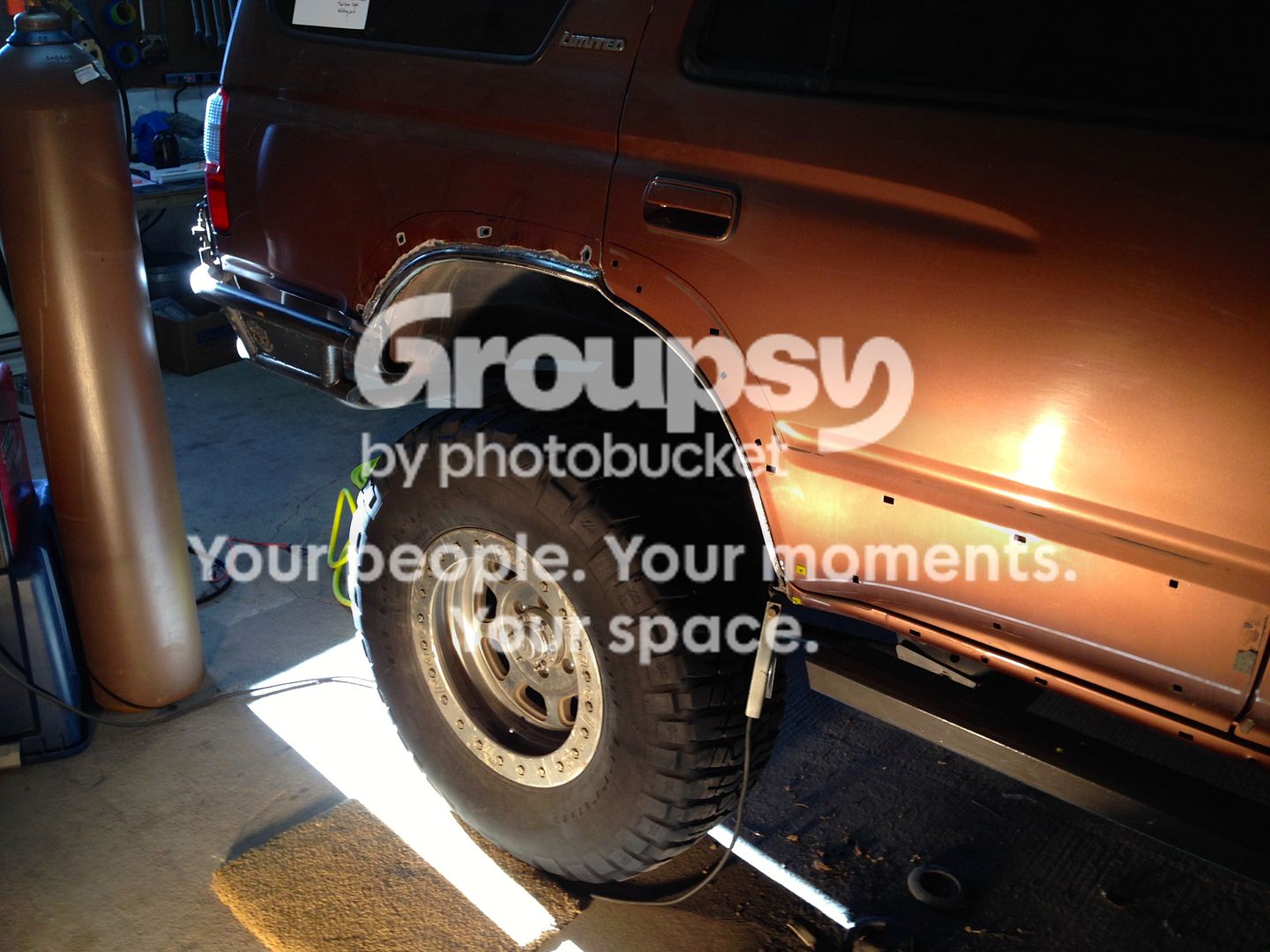

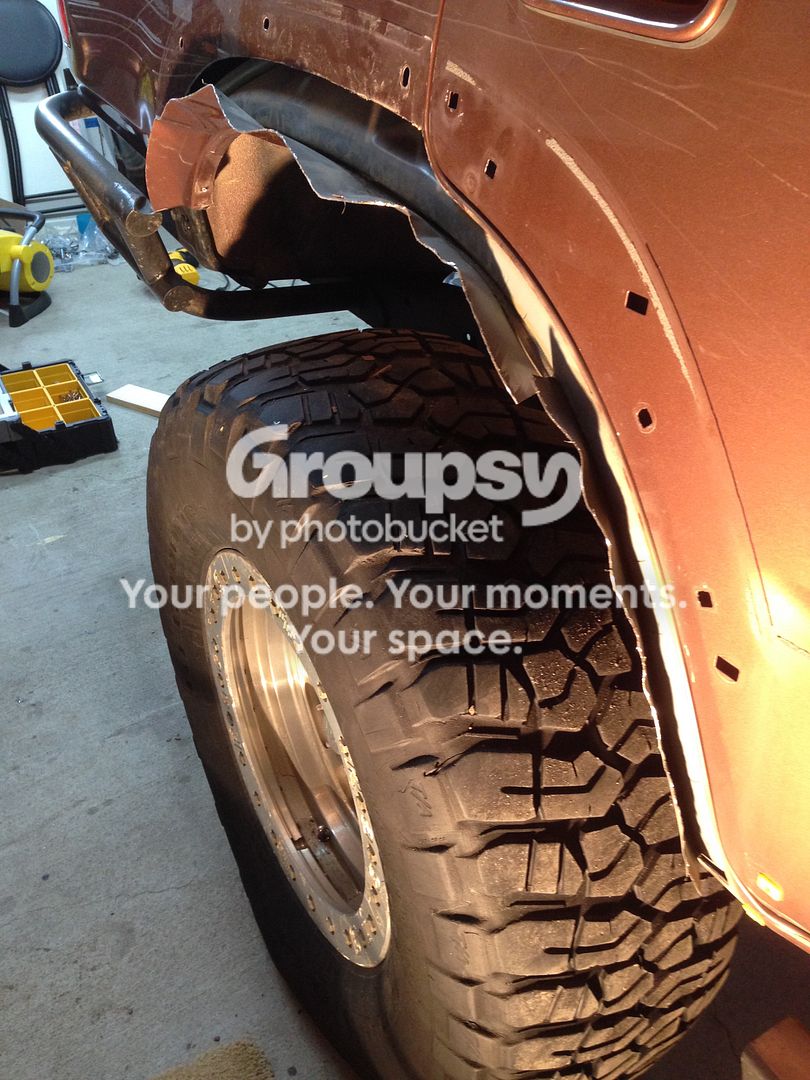

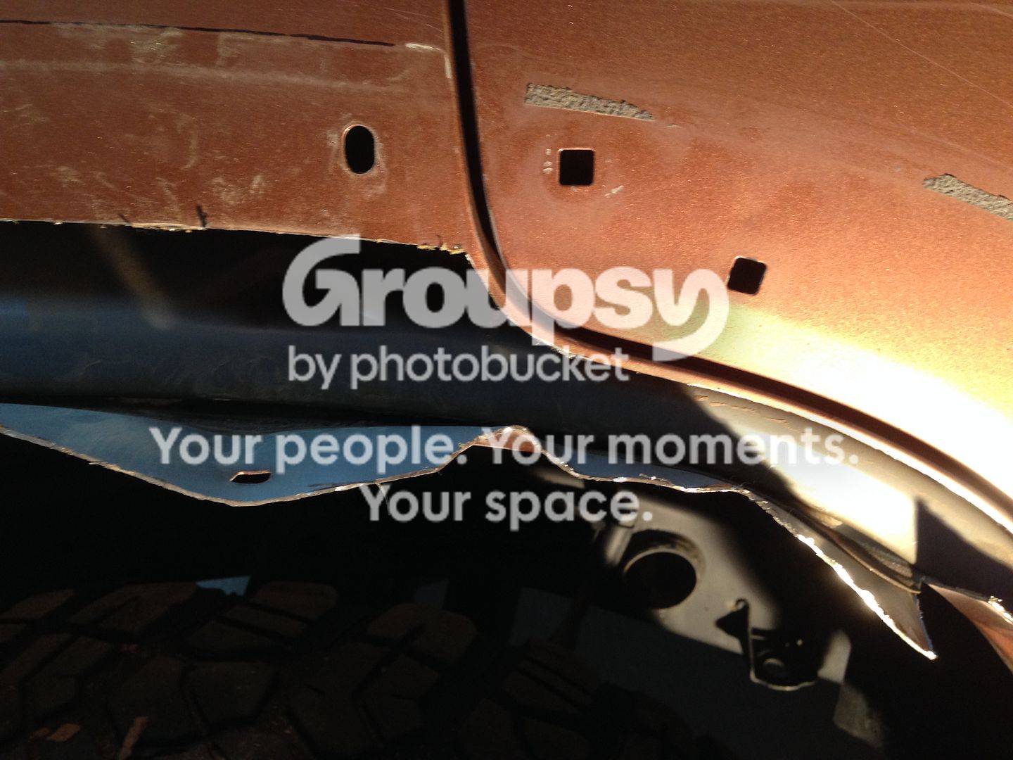

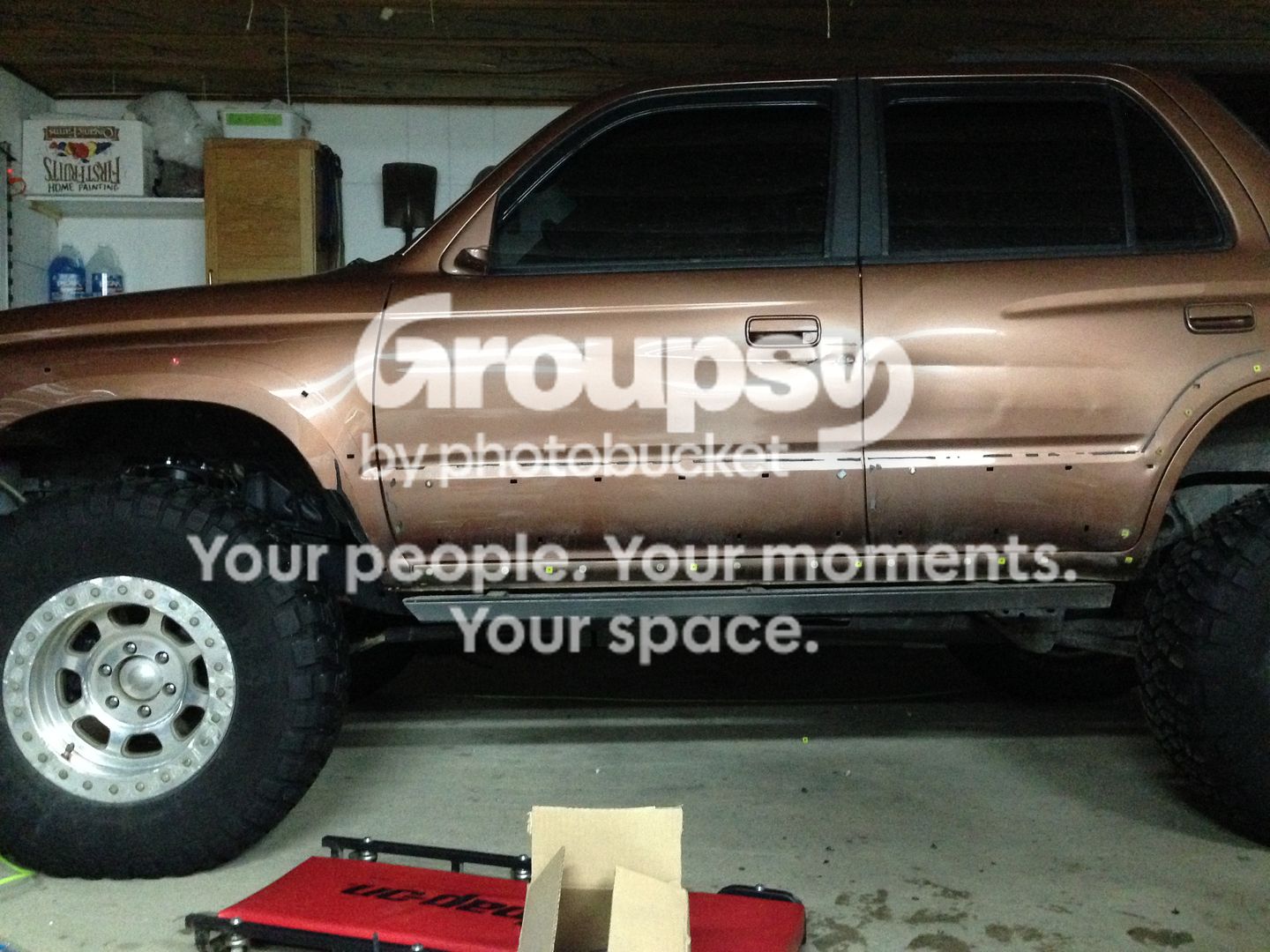

I was having a hard time committing 100% to the plan, and I was rethinking things on a daily basis. The only solution was to rip off the rest of the plastic and start cutting so I can't go back! :D

You really took the saw to it didn't you!! :biggrin1:

It was the only way to not change my mind or back out! :D

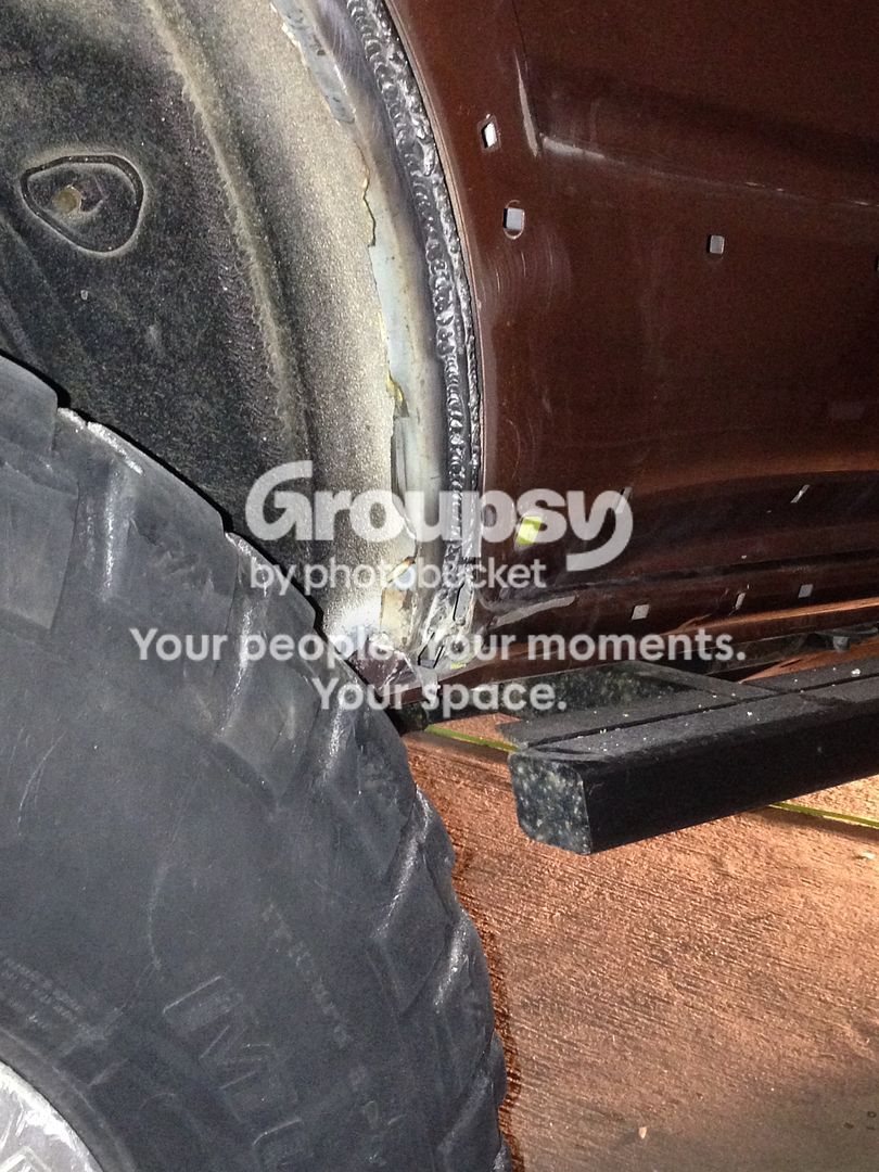

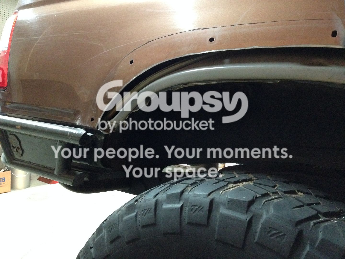

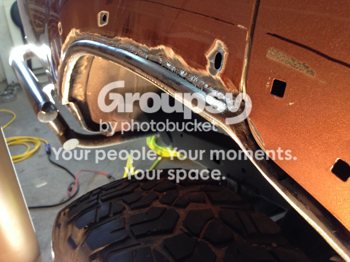

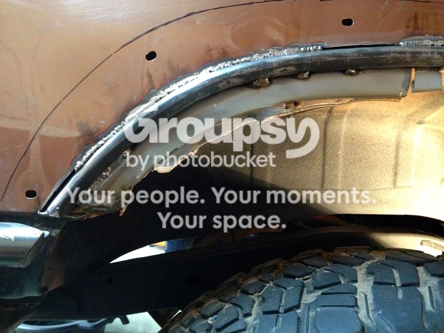

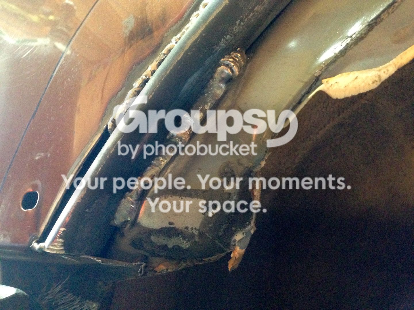

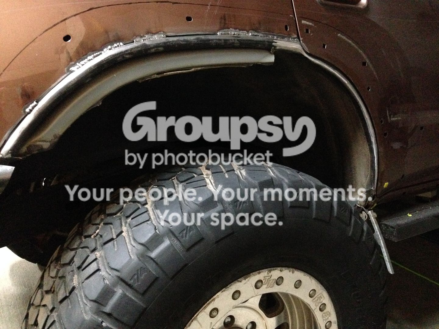

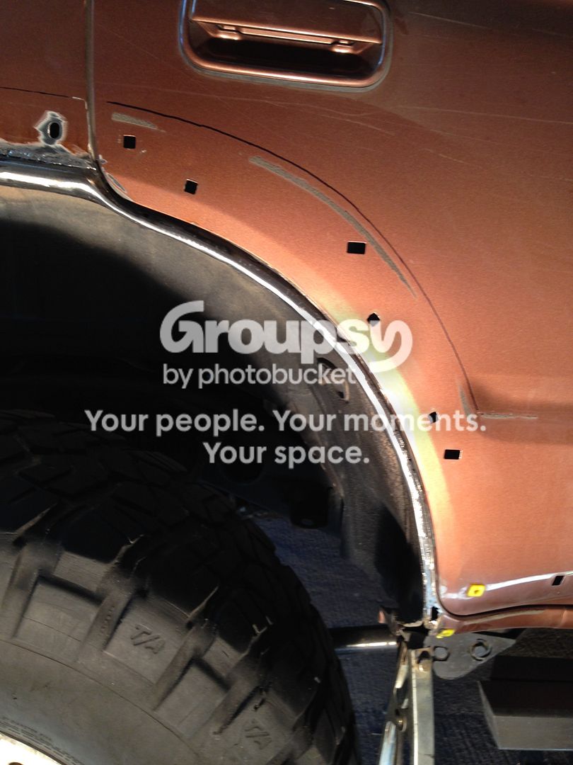

I needed to fill the hole between the inner fender and outer body, and add some strength to the body. So I used a method I’ve used on my past 4Runners and I welded in a section of 1/4” round rod on the leading edge of the fender.

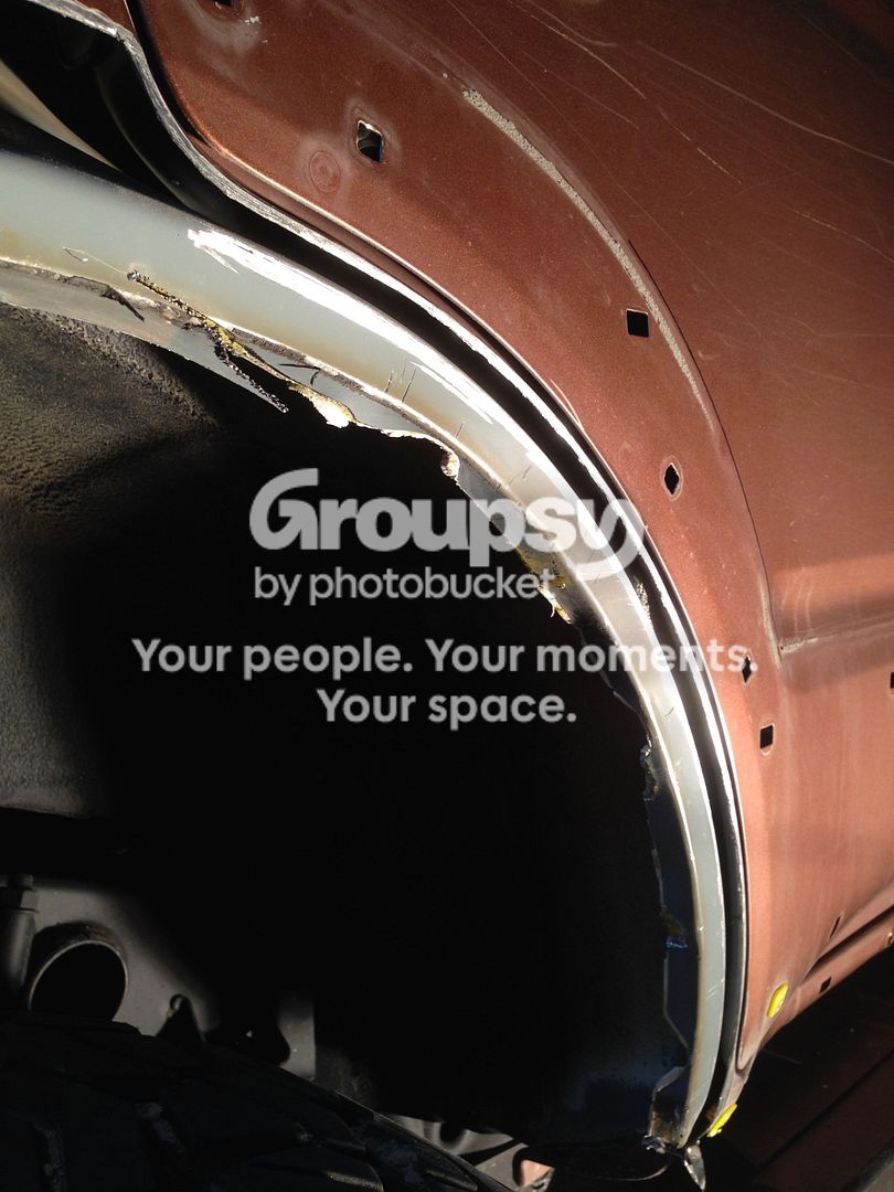

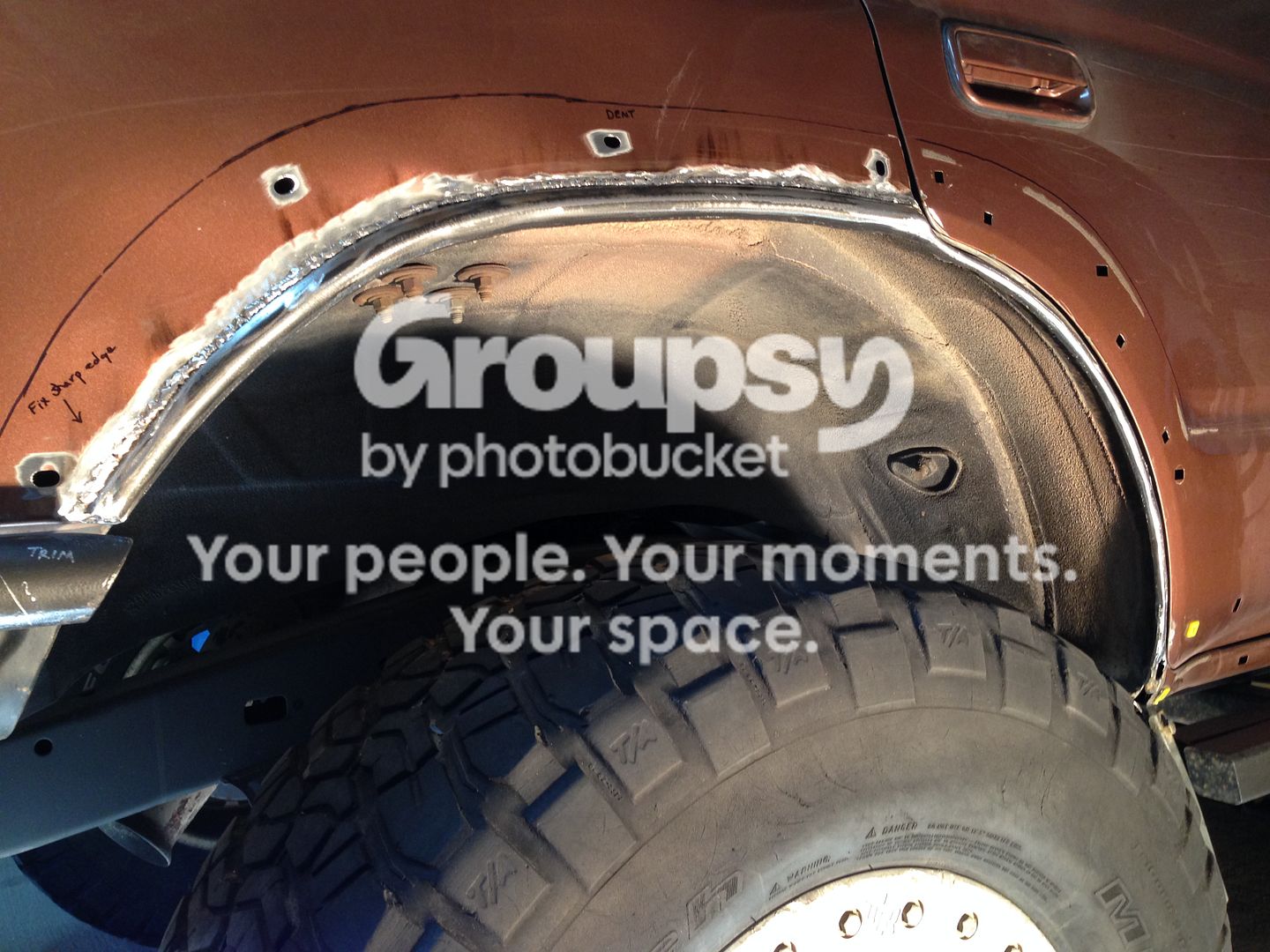

On the backside of the fender I tried something new and used small diameter tubing and bent it to follow the shape of the body. Not only does it add strength to the body, it should add a little bit of body protection to the rear ¼ panel.

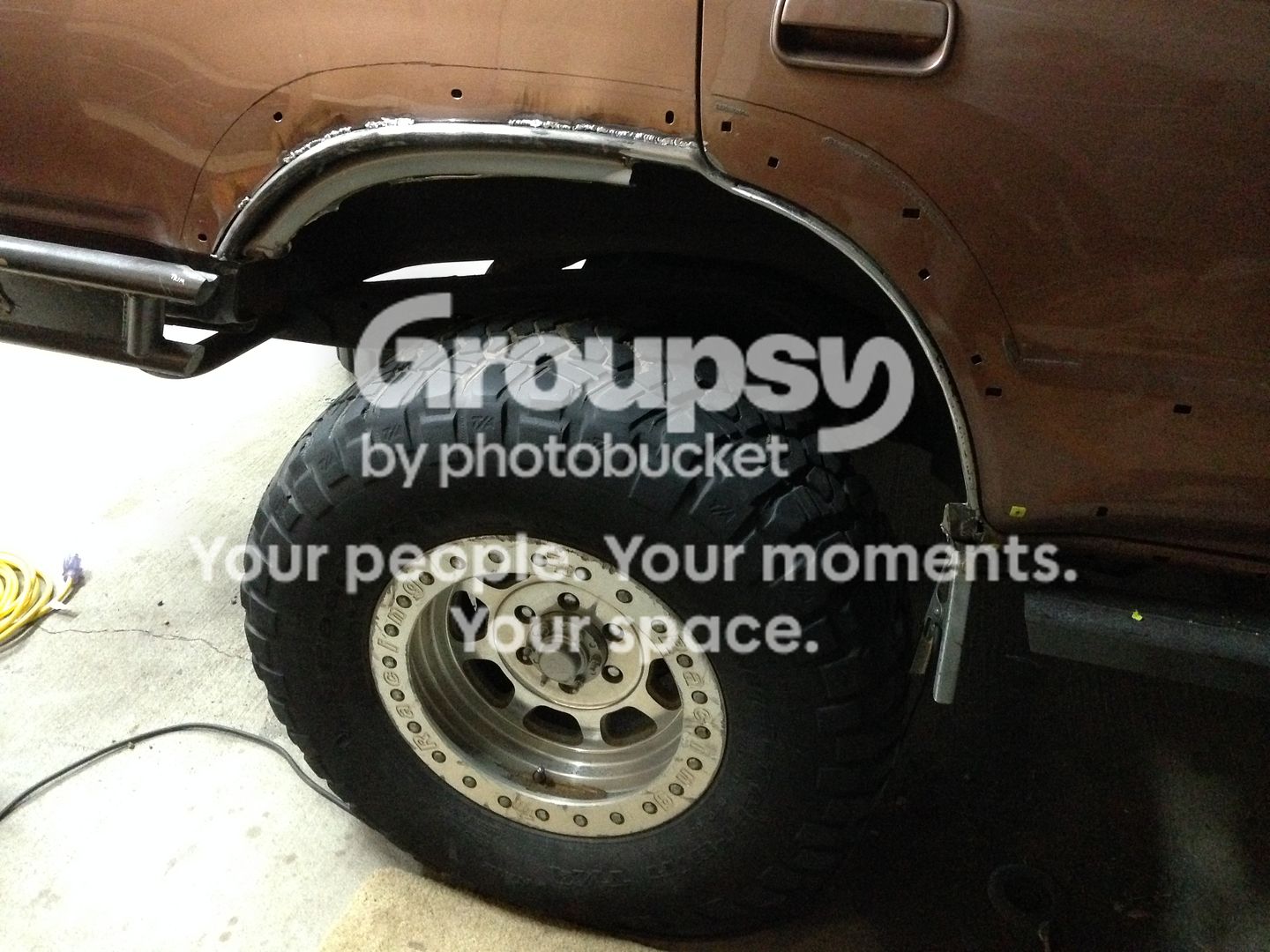

And here’s how it looks after a bunch of grinding and clean up work. I still need to fill the hole where the flares were and put a then coat of body filler to smooth it out.
Madd skills for sure. It looks cool as #$&#@ but what are you going to put over where the holes were? Paint it black? I imagine that painting it to match the copper would show a line, you would have to basically paint the whole truck body.
Or are the flares going back on after this is done?

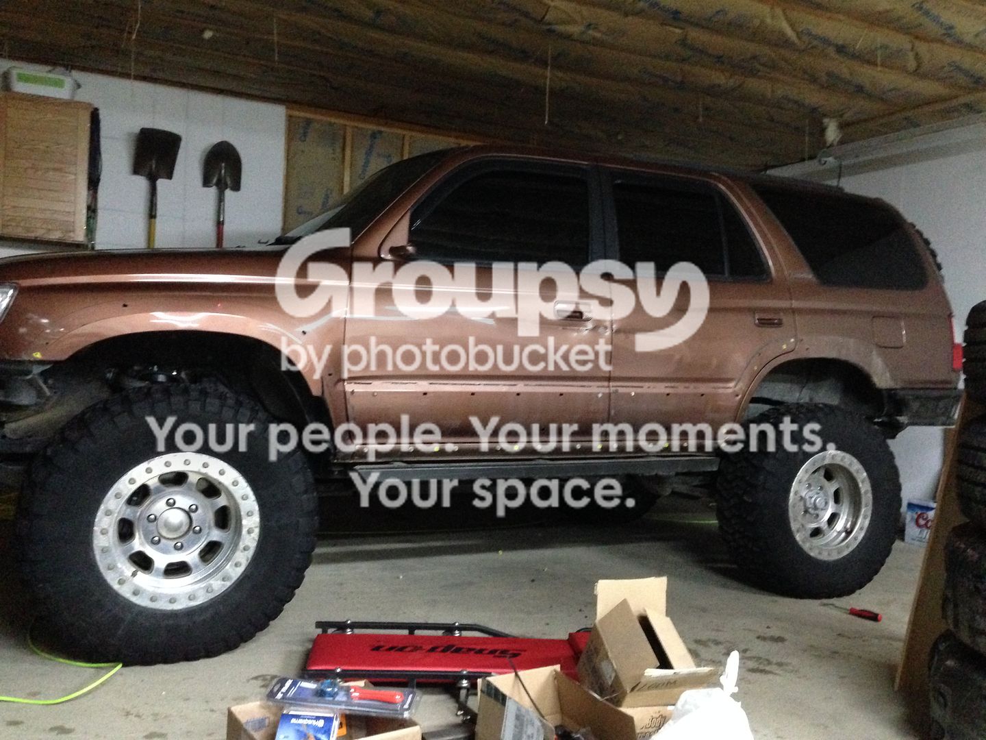

The lower section of the body will get coated in bedliner after I finish trimming, and filling the holes (roughly following the lines of the plastic). There is no way to keep the flares and cladding and run 36" tires. :D

I know its your rig and not mine, but there was something so magical about this rig with its full body and limited cladding/trim... In a way I see no difference between this and a chopped/bobbed/truggy type rig now. I just wish there had been another way, or you had a spare $5k that you could of put into it(new doors ect)...
I know this rig/build is not ment to please me or conform to my ideas or wishes but if I can be brutally honest, I probably won't fallow this build as closely anymore -not to say you will not continue your upper levels of quality craftsmanship and attention to detail, but its no longer "my cup of tea".

I was just pondering clearancing the rear quarters the exact way you just did, how much extra room would you say you gained by doing that since the door is in the way?
