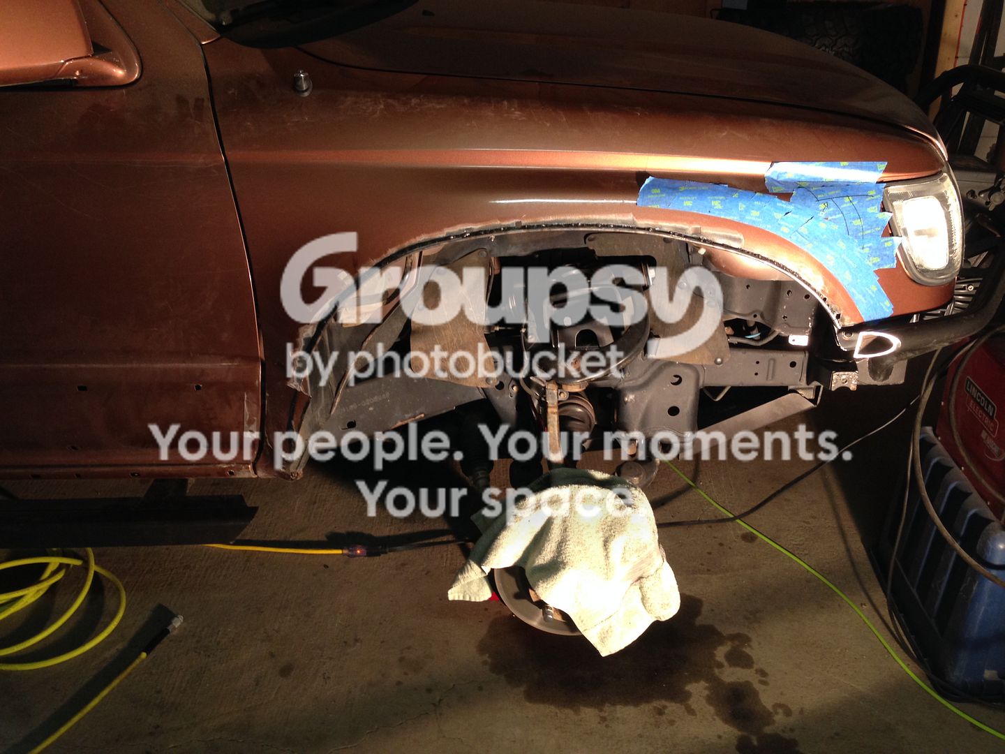

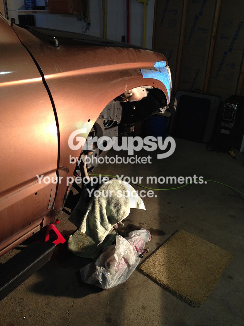

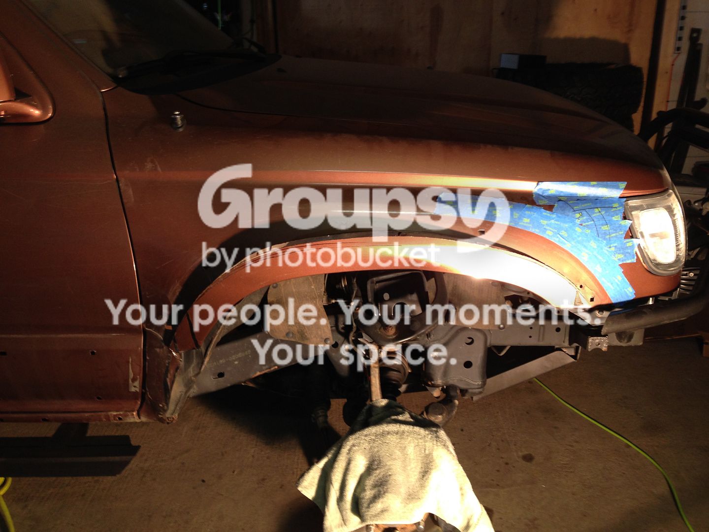

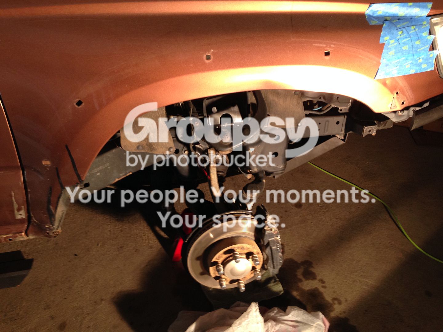

I also started working on the front end, here you can see the stock front fender (and the dent from the tire hitting it at one time or another).

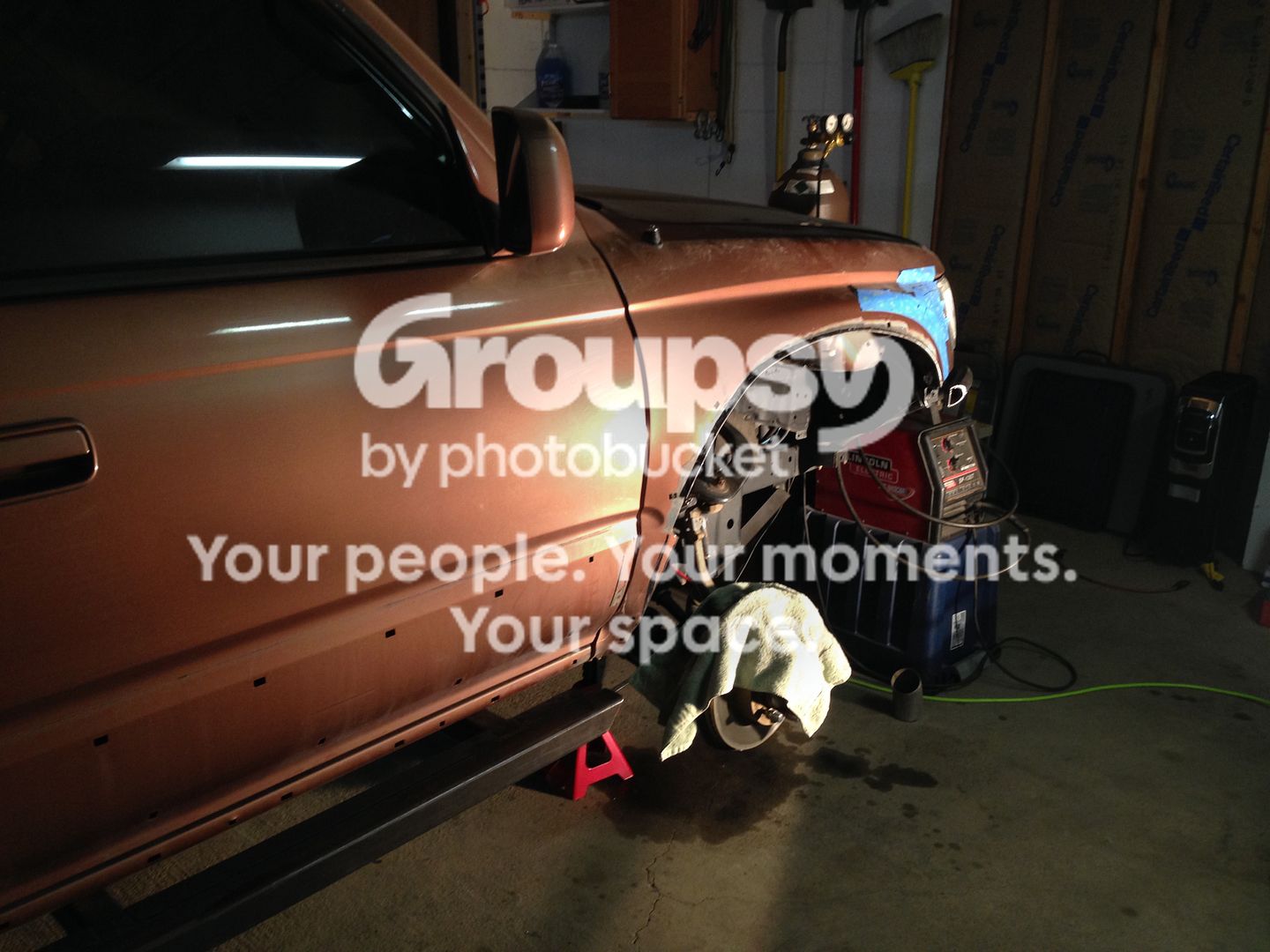

Cutting…
Lower front fender (the silver line is the planned cut)

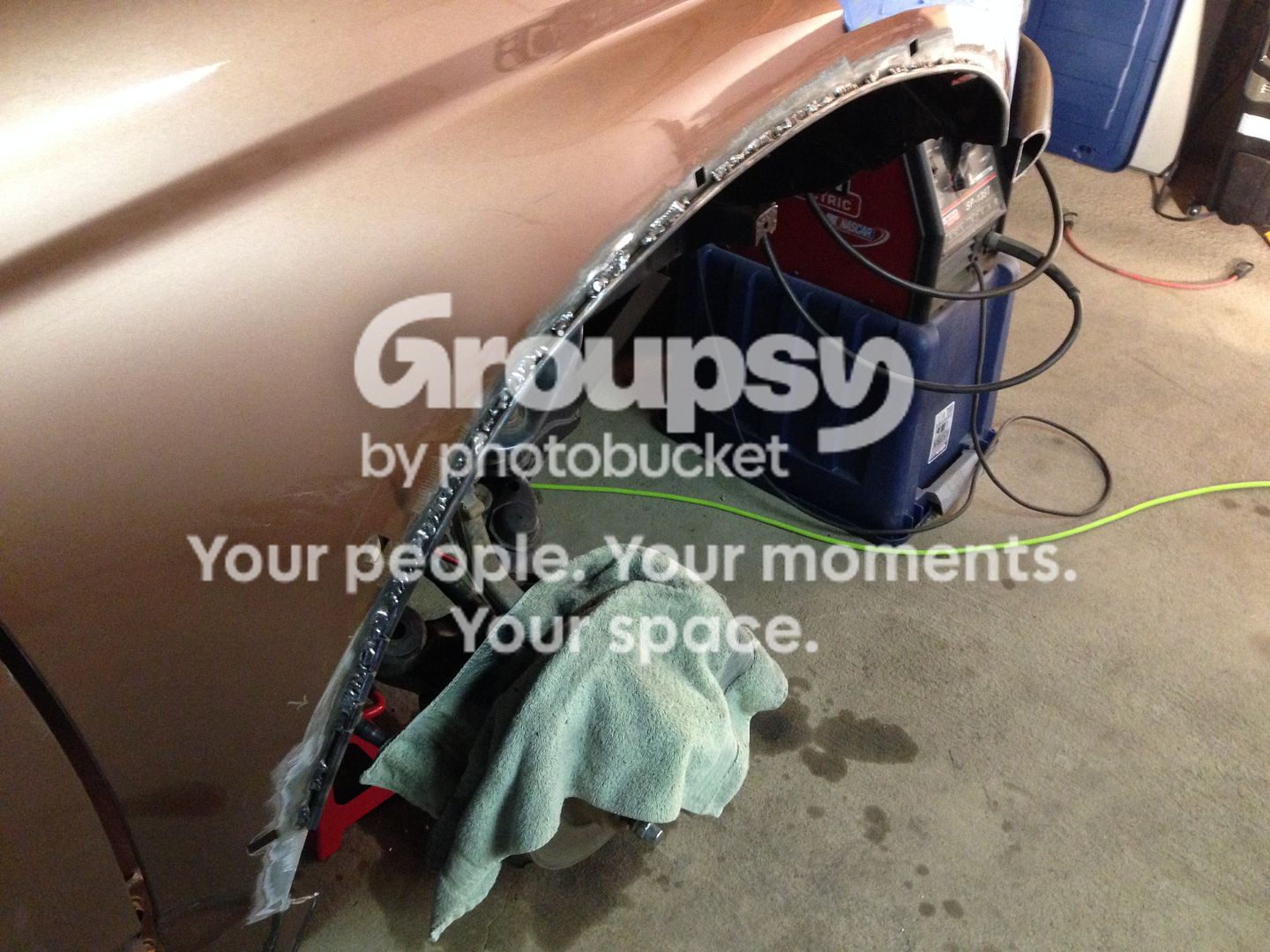

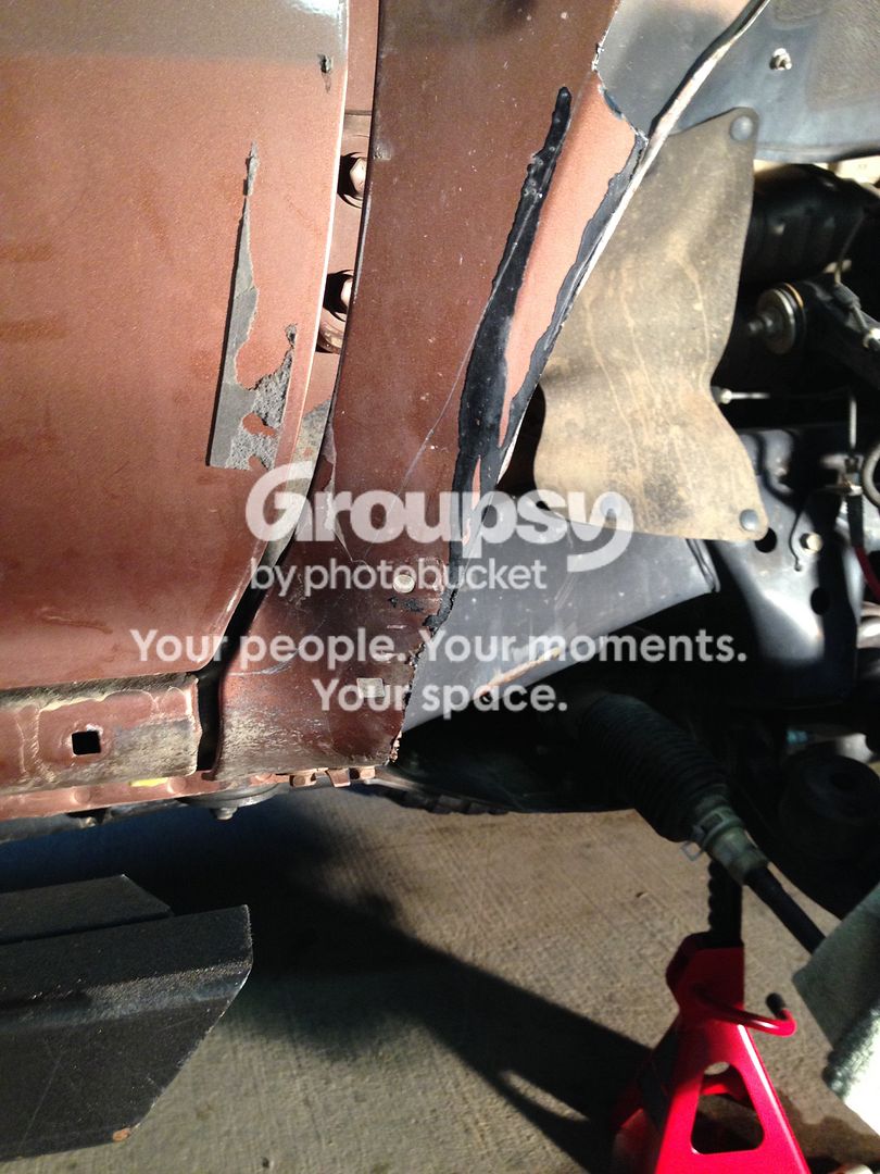

¼” Round rod welded in place for added strength (in progress)

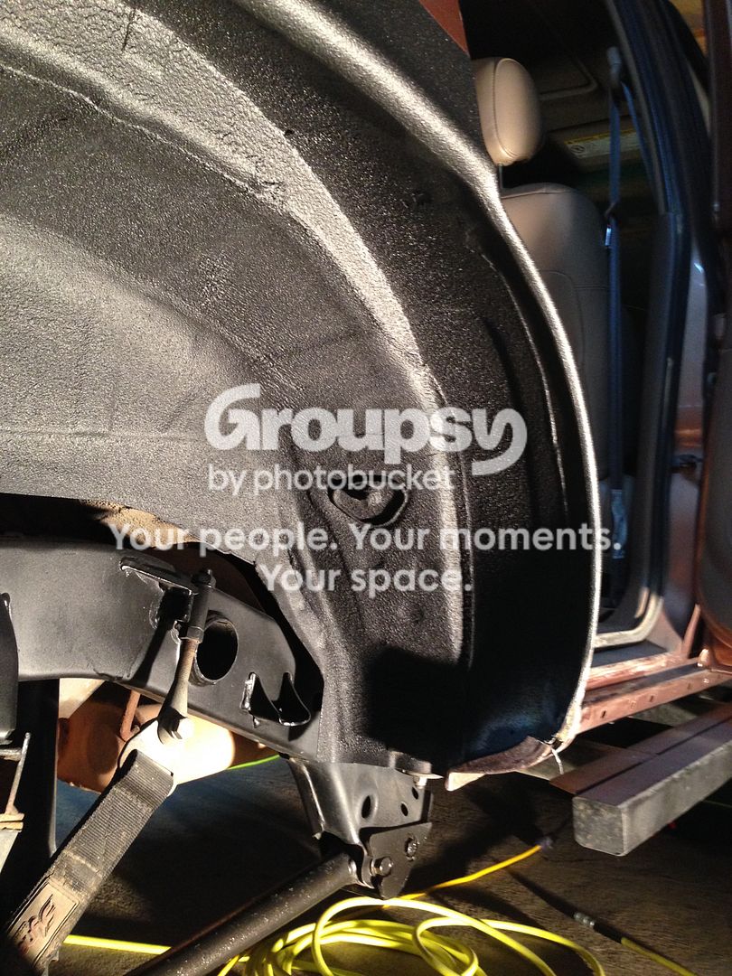

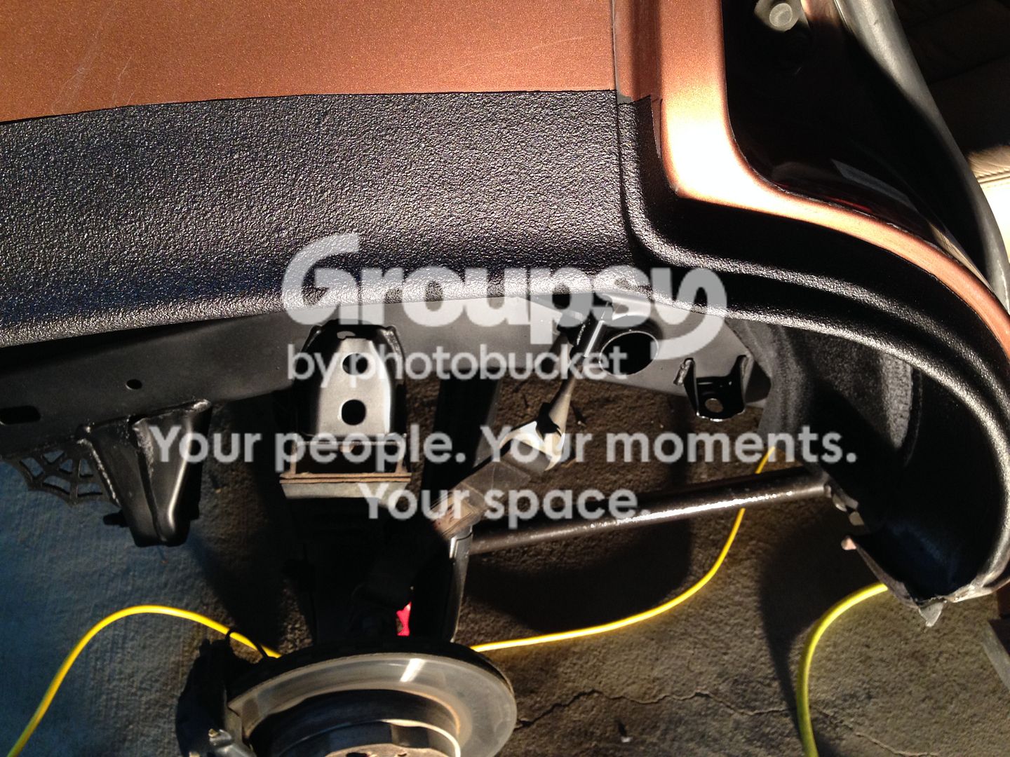

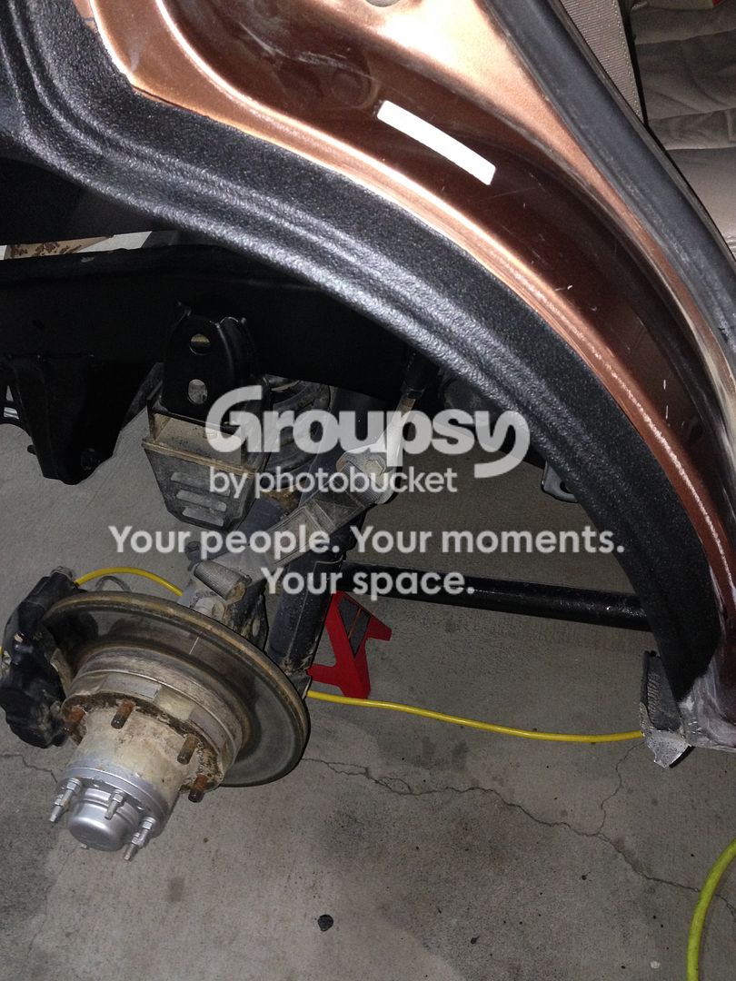

As promised here are some pictures of the rear fender. Here is the super quick run down in case anyone is wondering: I put a thin coat of body filler down > sanded, self etching primer, heavy filler primer > sanded, regular primer > light sanding to blend to factory paint, 3M quality undercoat, and a few coats of Duplicolor (blue can) bed liner.

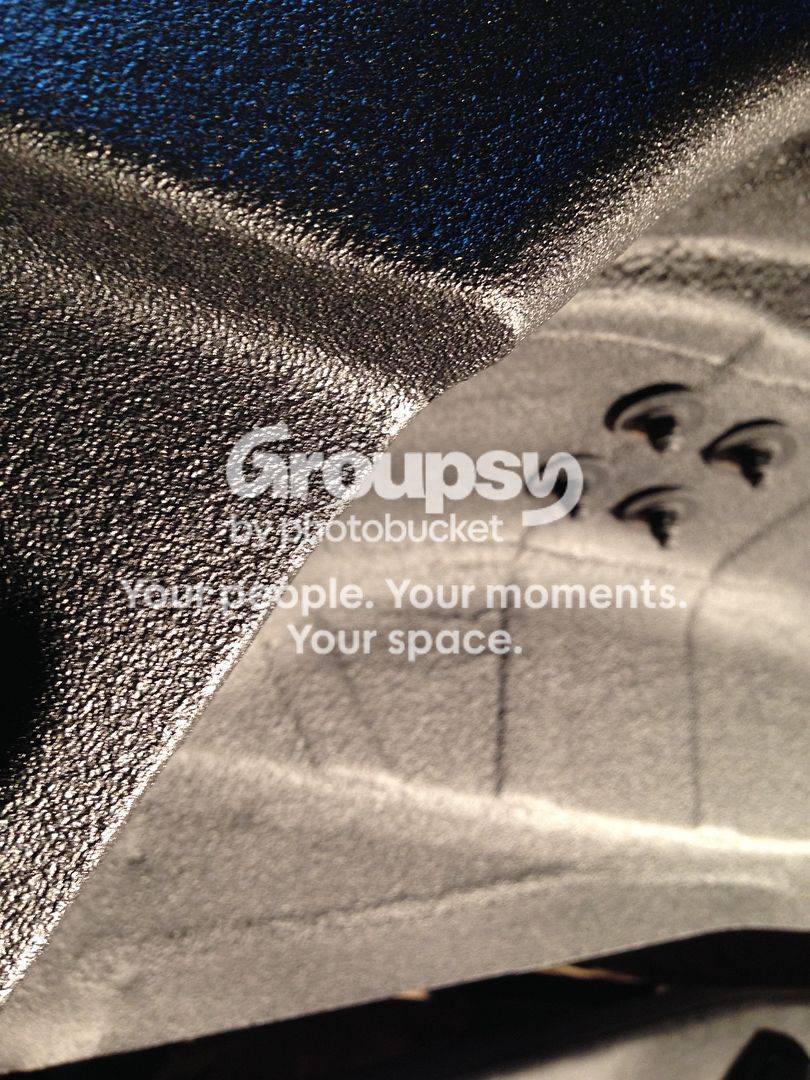

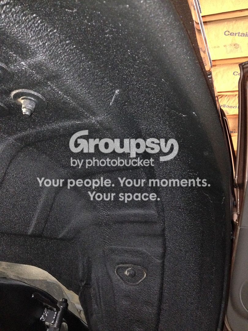

Inside

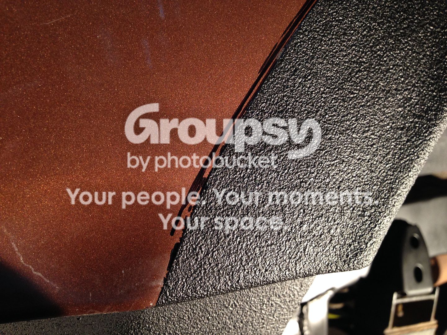

I used Sharpie to trace out the body line, and that might have been a mistake. I'm going to need to use Goof-Off, or something like that to remove the marker lines and not mess up the paint or fresh bed liner.
That actually looks pretty good. I was a little concerned when I saw you cutting the fenders and such, but I think you did a good job! Do you have any pictures from farther back so we can see what it all looks like together?
I used sharpie on a truck previously for marking lines and then ended up cutting less than expected leaving the line on the paint still. Super easy fix, i took a dry erase marker and colored over the sharpie (not just tracing but actually coloring over it back and forth) and then wiped the dry erase off, it took the sharpie lines off with it. No remnants left over whatsoever. Since then I have done it multiple times on other trucks with the same results, however I have never let is sit for a long period of time, few hours at most. Just something else you could try that was very easy and worked great.
Its probably the solvent in the dry erase marker which I believe is alcohol. I would just use rubbing alcohol to take the sharpie off. It won't hurt the car paint and I can't see it doing anything to the bed liner.
First off, this truck is one of my favorites on this site. I've been creeping for a while now and i love the direction that you're heading in.
As an ex-bodyman, this kind of concerned me though, you just used body filler to fill the holes? It might not matter since you've used gravel guard which might mask any cracks. But I wouldn't expect the bodyfiller to hold for more than a couple years without showing through. Especially with the vibrations our trucks see on FSR's.
I bought a limited, as much as I dislike the moldings, and dream of a smooth body one day. But there's a reason I'm an ex-bodyman. I hate the work! I have plans to make clearance like yours, but clear out the area behind the limited arches.
Thanks for the input! You have nothing to worry about; I welded all the holes shut and smoothed them out before adding the filler. I just didn't take pictures of every step of the process; as you know it's a time consuming process doing this kind of work, I didn't want to bore everyone with one million pictures of the same fender.
