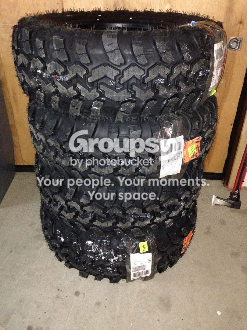

I can't tub the firewall (cough, [MENTION=63060]rickashay[/MENTION] ,cough) without at least one new tire; I thought about ordering just one for mockup, but I have horrible luck with tires going on backorder when I need them. So I broke down and ordered all four, it wasn't in the budget but there was no way to make forward progress without them.

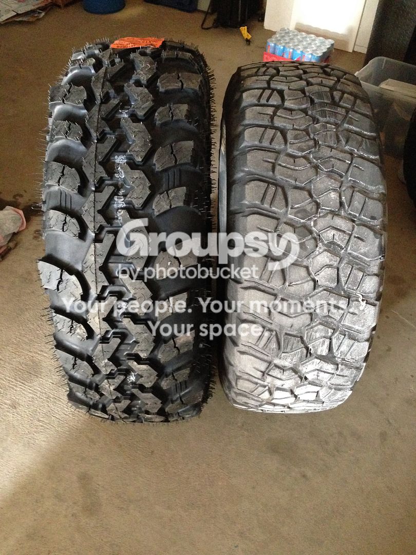

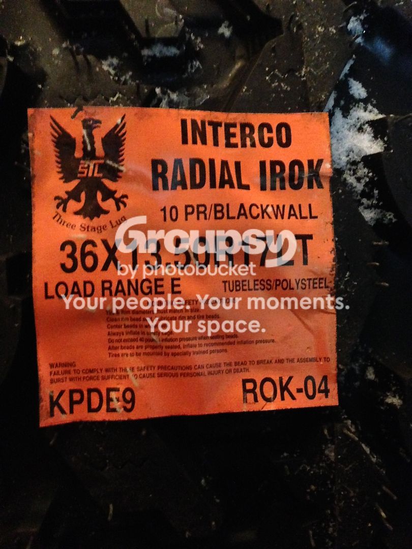

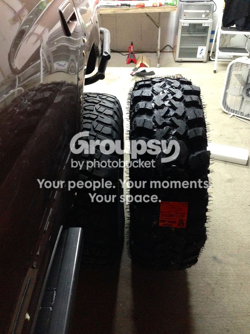

Those are going to look sweet. What's the measured height difference?
Off the vehicle, the old tires (still mounted on the wheels and at around 25psi) measure 34". Unmounted, the new tires measure a true 36", that could change a little once they are installed on the wheels. I did a ton of research on these, and other tires. A few people said they only measure 35.5", but it's possible they measured on the vehicle.
I was a little concerned about the width, being that they are listed as a 13.5" wide tire, but in person they are not much wider than the tires that I have now. This will really help with fitting them and not running into issue's with the tires rubbing the UCA. They will rub the front of the frame like crazy at full lock, but theres not much I can do about that (unless I modify the steering stops)
