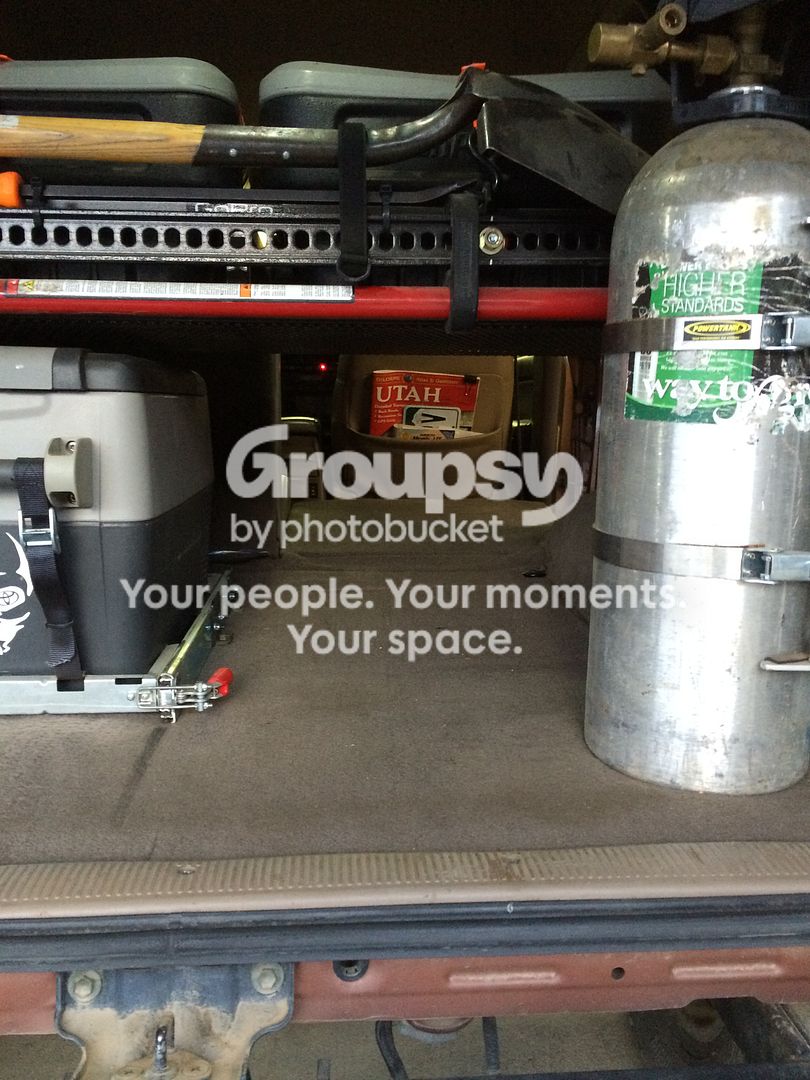

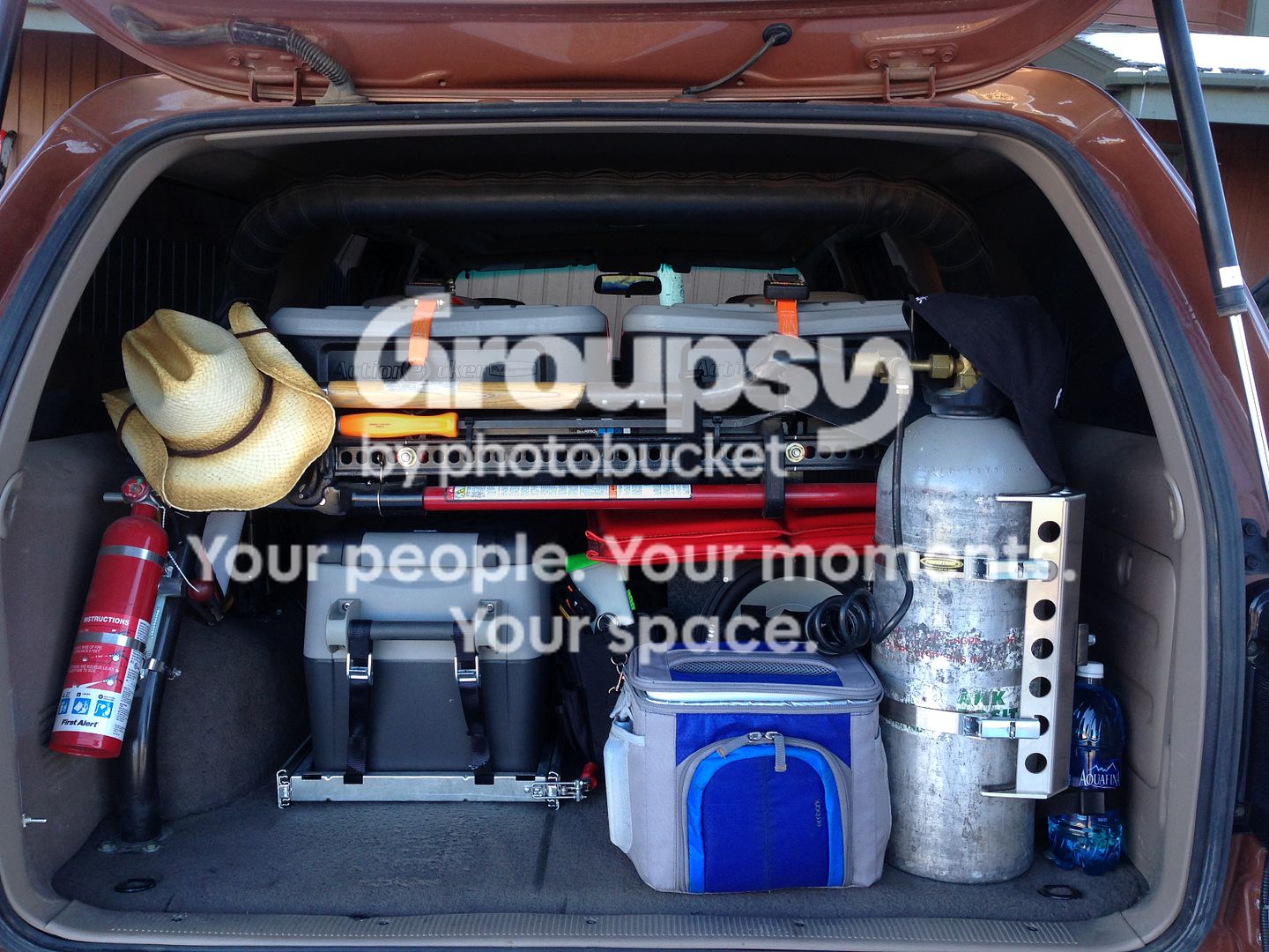

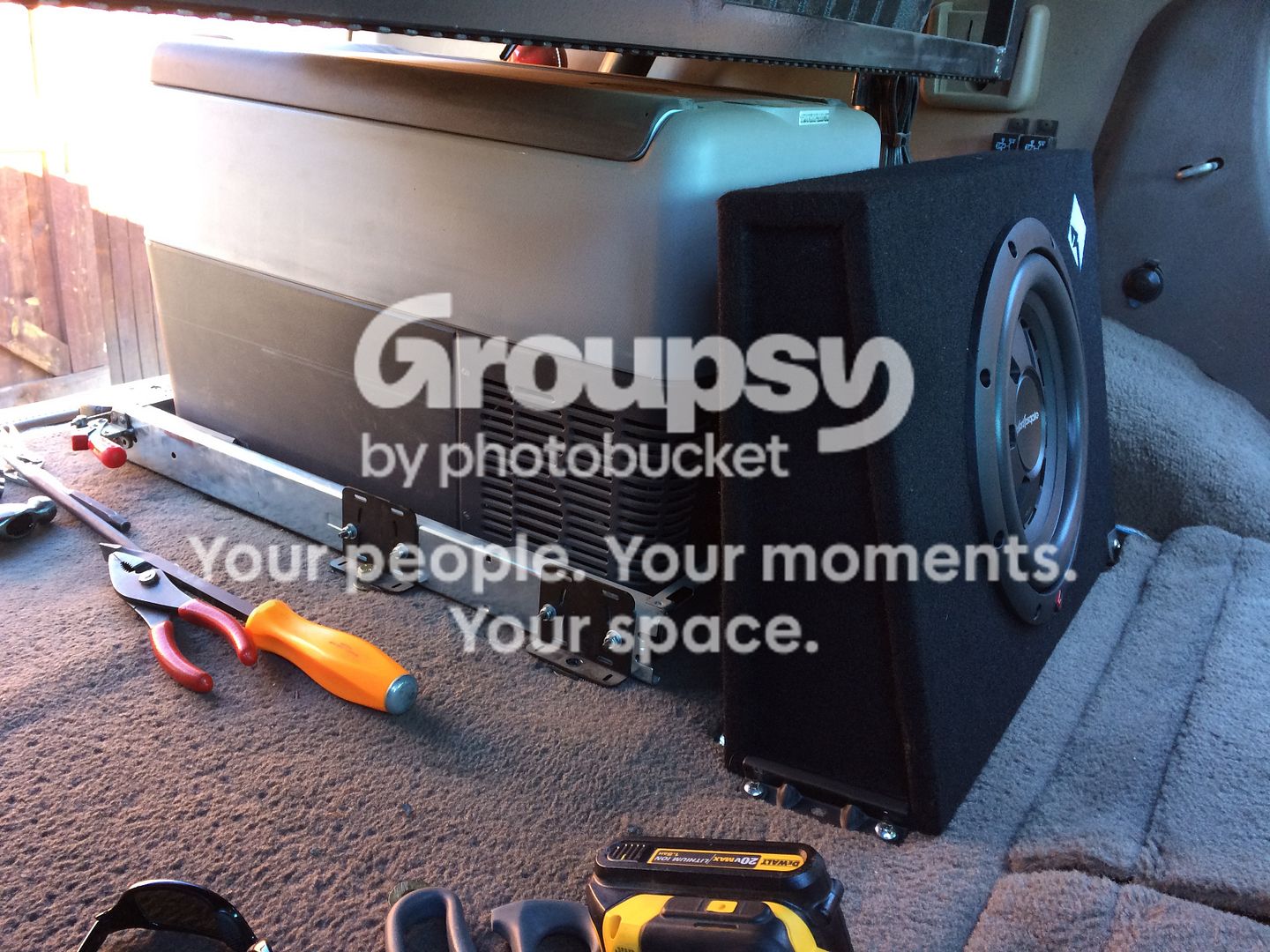

As much as I love the rear cargo area, it has been bugging me lately. The general lay out is great but there is no storage left, and the thought of sleeping in the back is nonexistent. I do have the trailer, but there are times that the trailer isn't very practical (a quick single night trip, harder trails, and the possibility of a overnight breakdown).

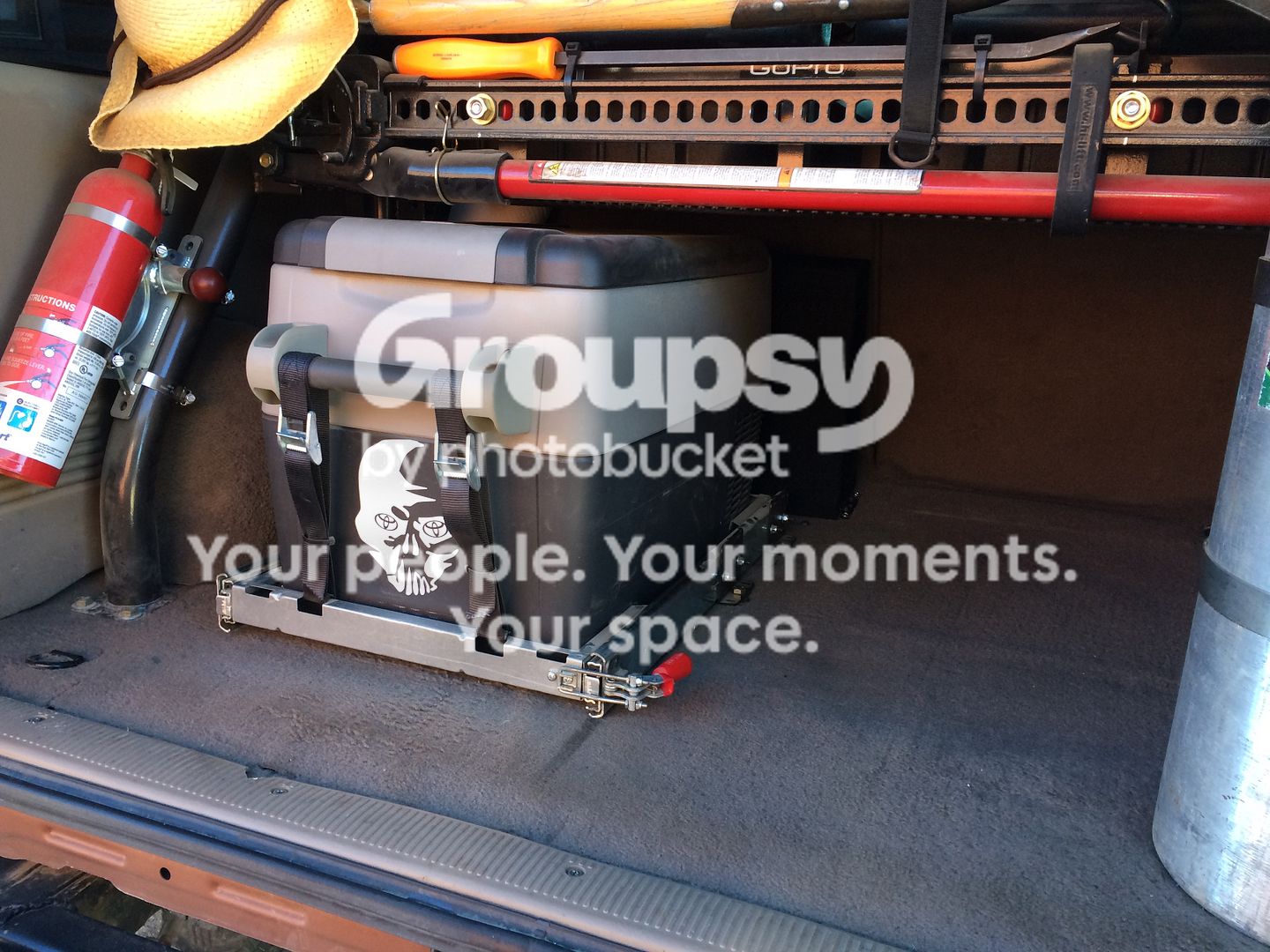

A couple months ago I started looking at how I could improve the rear cargo area. The large subwoofer box was the main issue, it just took up too much room. So I pulled it out, along with all the other gear that was in the way, and made myself a clean slate. I laid in the back and found it quite comfortable (for the one or two times a year I might actually sleep back there), it’s snug but there’s enough room and unlike a sleeping platform I can sit all the way up.

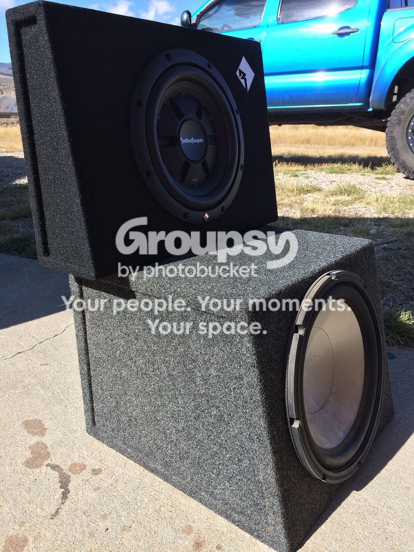

The old subwoofer was free, and it served it’s purpose, but it had to go. I picked up a low profile subwoofer/box and sandwiched it between the fridge and the back seat. I had to move the fridge back a couple inches but it was worth the work.

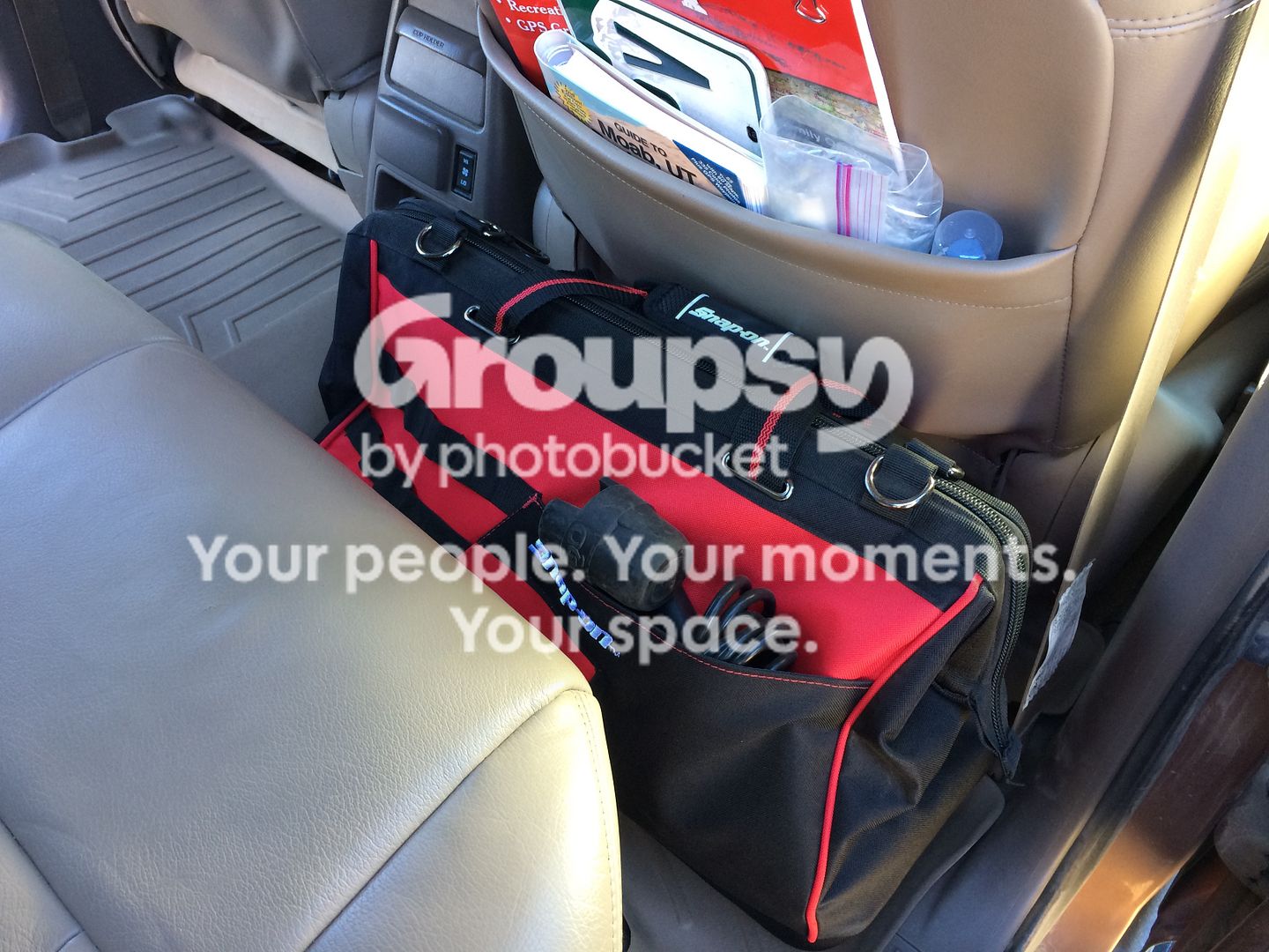

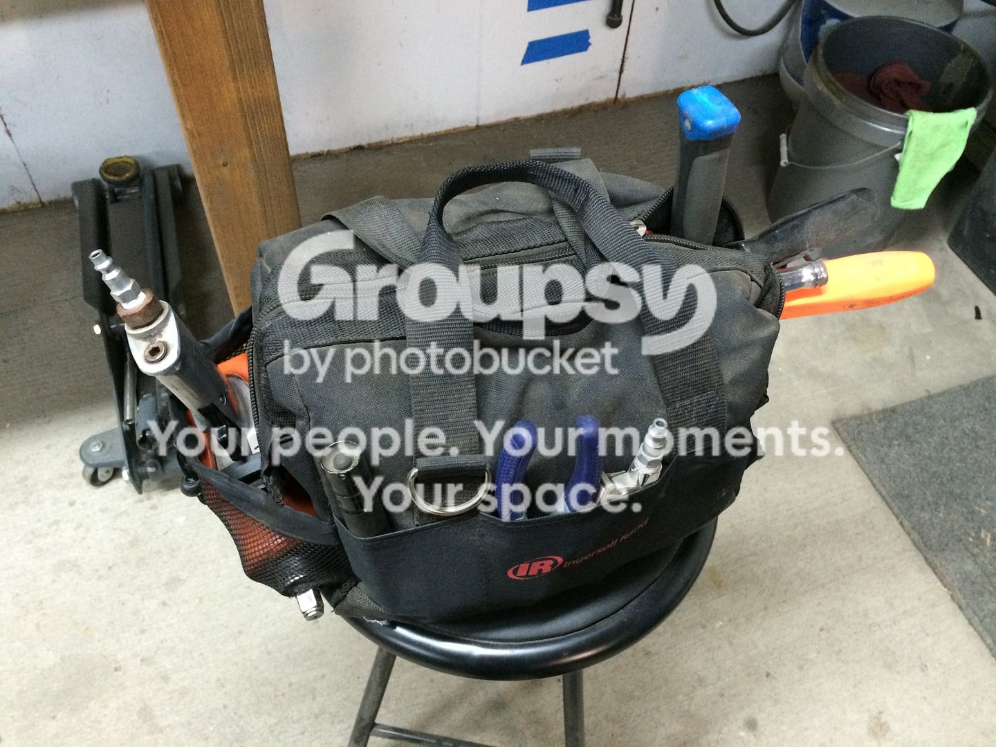

Now I needed to address my tools and recovery gear. My current tool bag was literally overflowing and falling apart; I wanted two nice bags that would also fit snug in the rear seat footwell area (for when the bed is made). I took some measurements and found these on Amazon, the quality is amazing (of course) and they fit like a glove!
Old
New
Was the old sub one of the Infinity Perfect subs?? That was one of the best sounding subs back in the day...
Yes it is, it's a great sounding subwoofer but it takes up a lot room. So far I'm impressed with the sound quality of the Rockford Fosgate subwoofer, especially being in such a small enclosure.

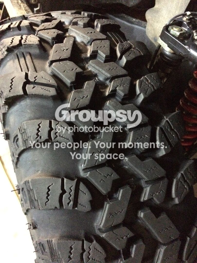

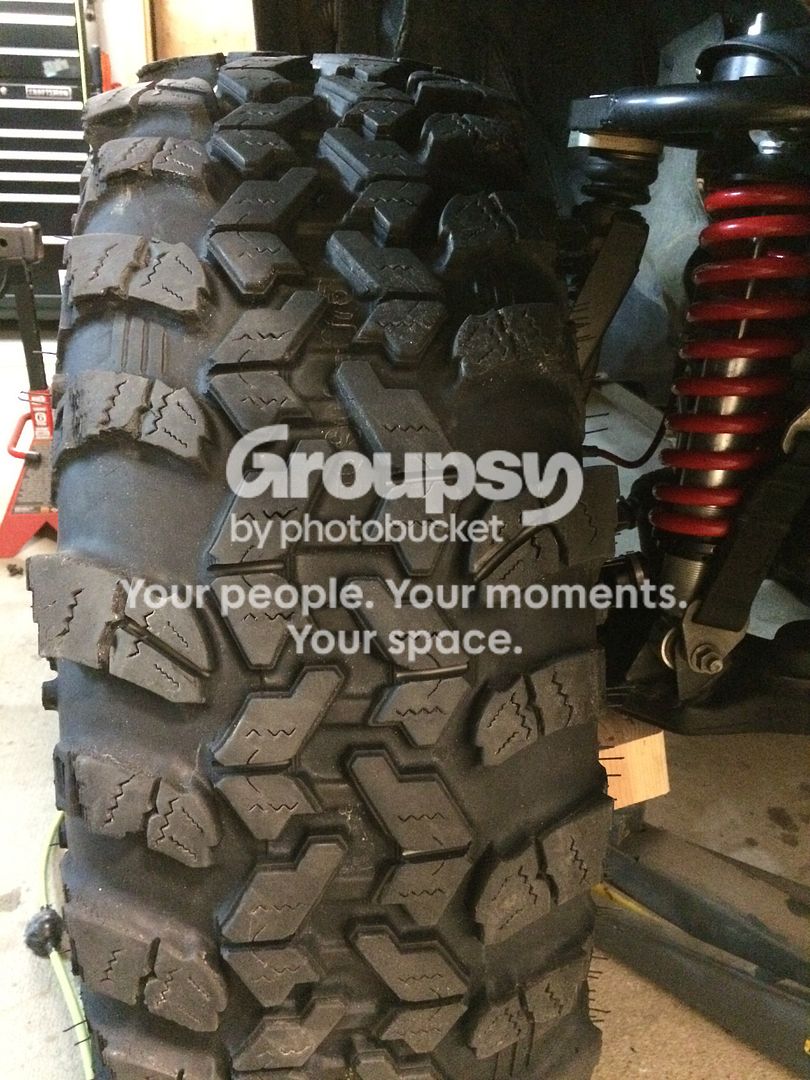

I decided to groove the Irok's. They were less than ideal on hard snow pack or ice, and the grooving should only help in the deeper snow.

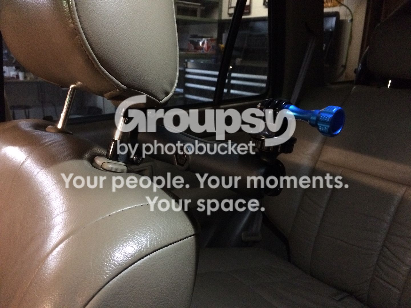

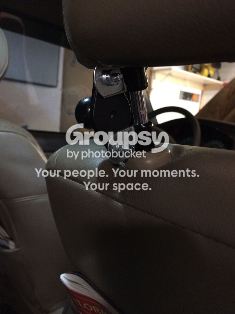

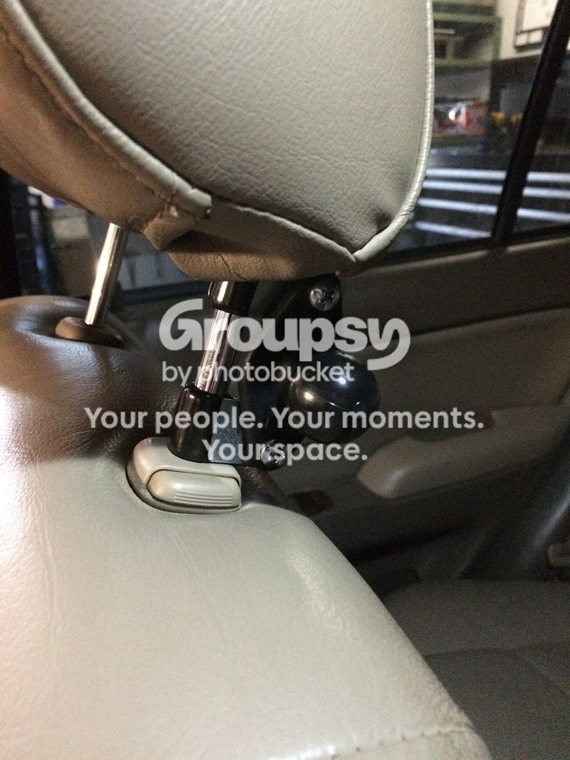

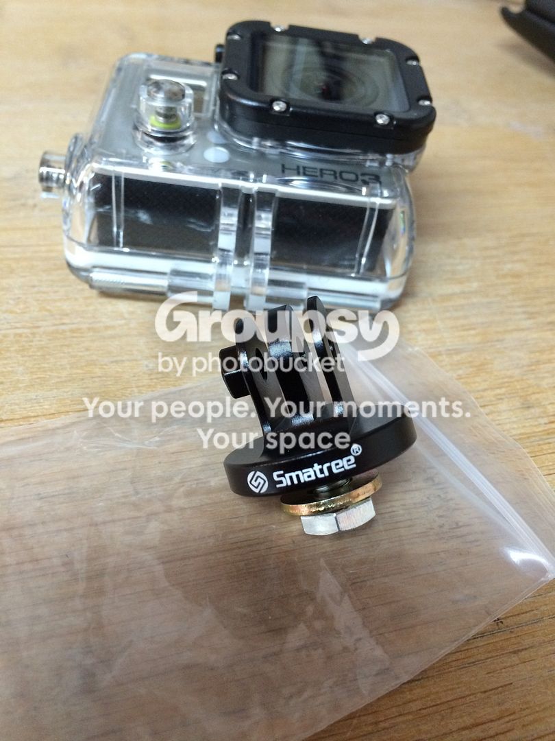

During my last trip out I had issues with the GoPro lens getting covered with snow only seconds into the recording, it's not the end of the world but I figured it would be nice to have some kind of interior camera mount. I looked at headrest mounts but everything out there was expensive and super bulky, or cheaply made plastic crap (Google headrest camera mount and you'll see what I'm talking about). So after some thought I came up with this...
Standard RAM ball mount attached to the back side of the headrest
RAM long arm and GoPro adapter

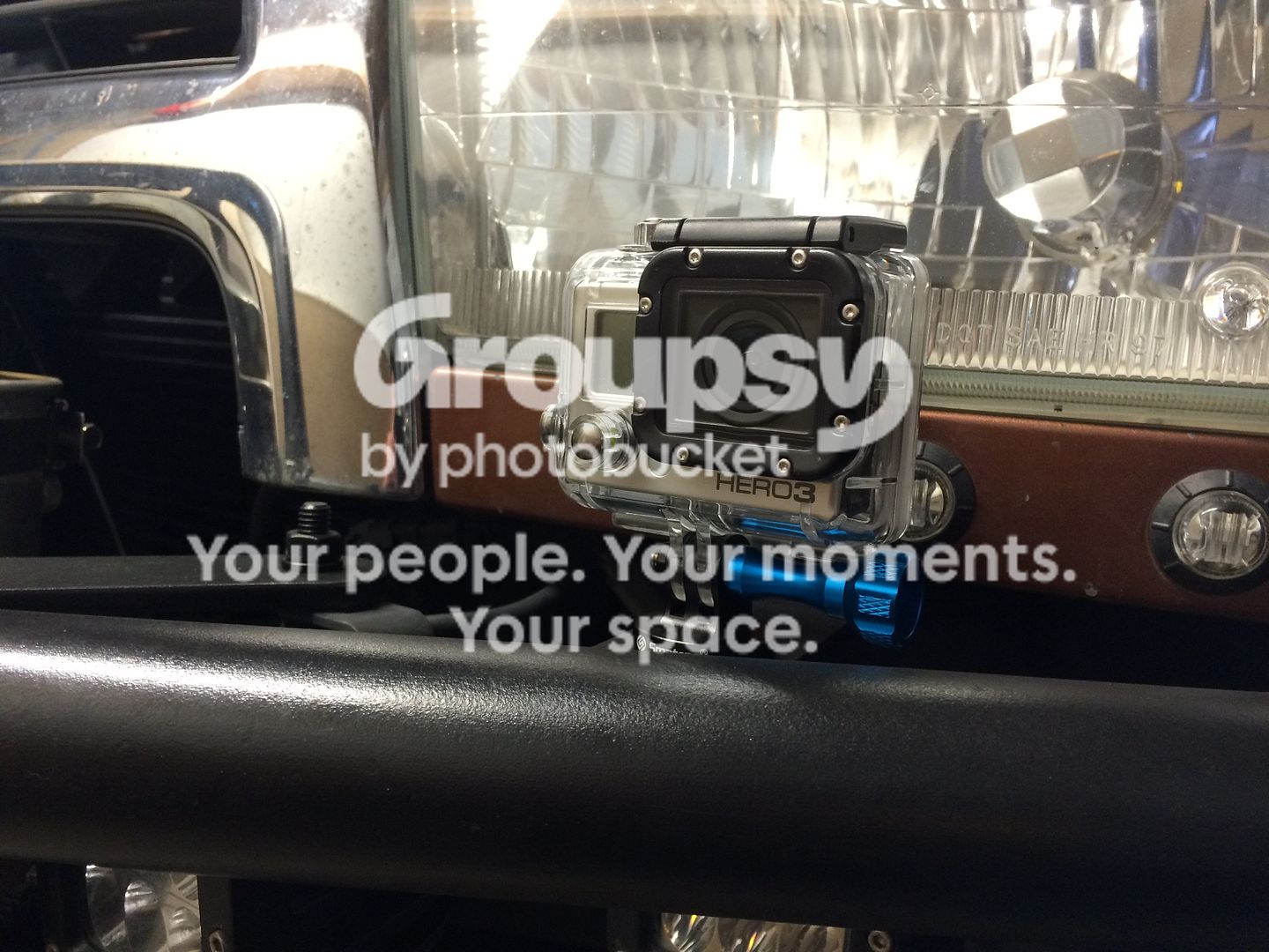

While I was contemplating the headrest mount I figured it would be nice to have designated mount on the front of the 4Runner, so I ordered an aluminum tripod mount and bolted it to the front bumper.
