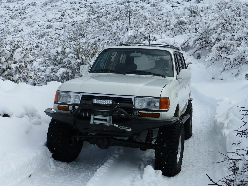

Wow Dirtco I admire your tenacity. I get it, the snow wheeling is a big thing for you, (and I wish I had the same opportunities), but I think those 36's are very much at the edge of the limits for your drivetrain, especially the front R&P.
Like you, I've been there with the dedicated rockcrawler, but have swung back to my roots with a rig that can be driven long distances in comfort, and then back home. Driving experience has a lot to do with that.
Anyway awesome attention to detail, and great fab work. Any idea how much she weighs? My last Toy was a linked FZJ80 and she was near 6k...which led me to the 3rd gen 4rn.
I'm not sure LT is the answer to your problems, FWIW.

Thanks Roc Doc! Yes, the 36's are pushing my luck, but I love them and feel that they balance out my rig (for what I use it for). They are awesome in the snow, and they really hook up in the rocks (especially after I grooved them). The 4Runner even rides better on easy dirt roads due to the extra sidewall height. I did sacrifice some street manners going to such a large aggressive tire, but it's not that bad. I wouldn't want to commute to work on a daily basis; but driving to the trail, around town, and on longer wheeling/camping trips it's fine.
I don't know what it weighs, but I bet it's heavy compared to most of the other 4Runners around here. I would like to weigh it, and the trailer this summer.
As much as I love the idea of long travel, I think I've talked myself out of it for this rig. It honestly just works the way it is, and high speed desert style driving with such a heavy tire/wheel package will take it's toll on the drivetrain and suspension. Although, I'll probably look at getting some high quality coilovers and shocks down the road when funds allow.

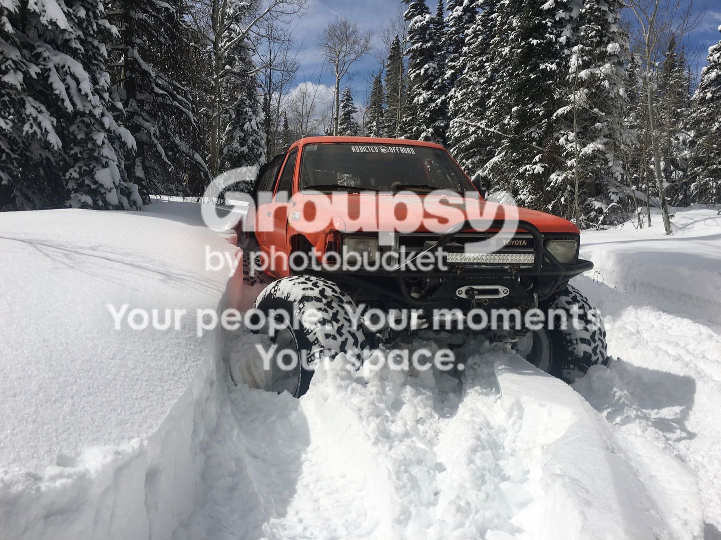

A couple weeks ago [MENTION=63986]Volcom[/MENTION] came up for a little snow wheeling! Snow wheeling is tricky because the weather plays such a large roll in the conditions. Aaron lives down in Pueblo, so he can’t just swing by when the conditions are perfect, but we always make the best of whats out there and have a good time!

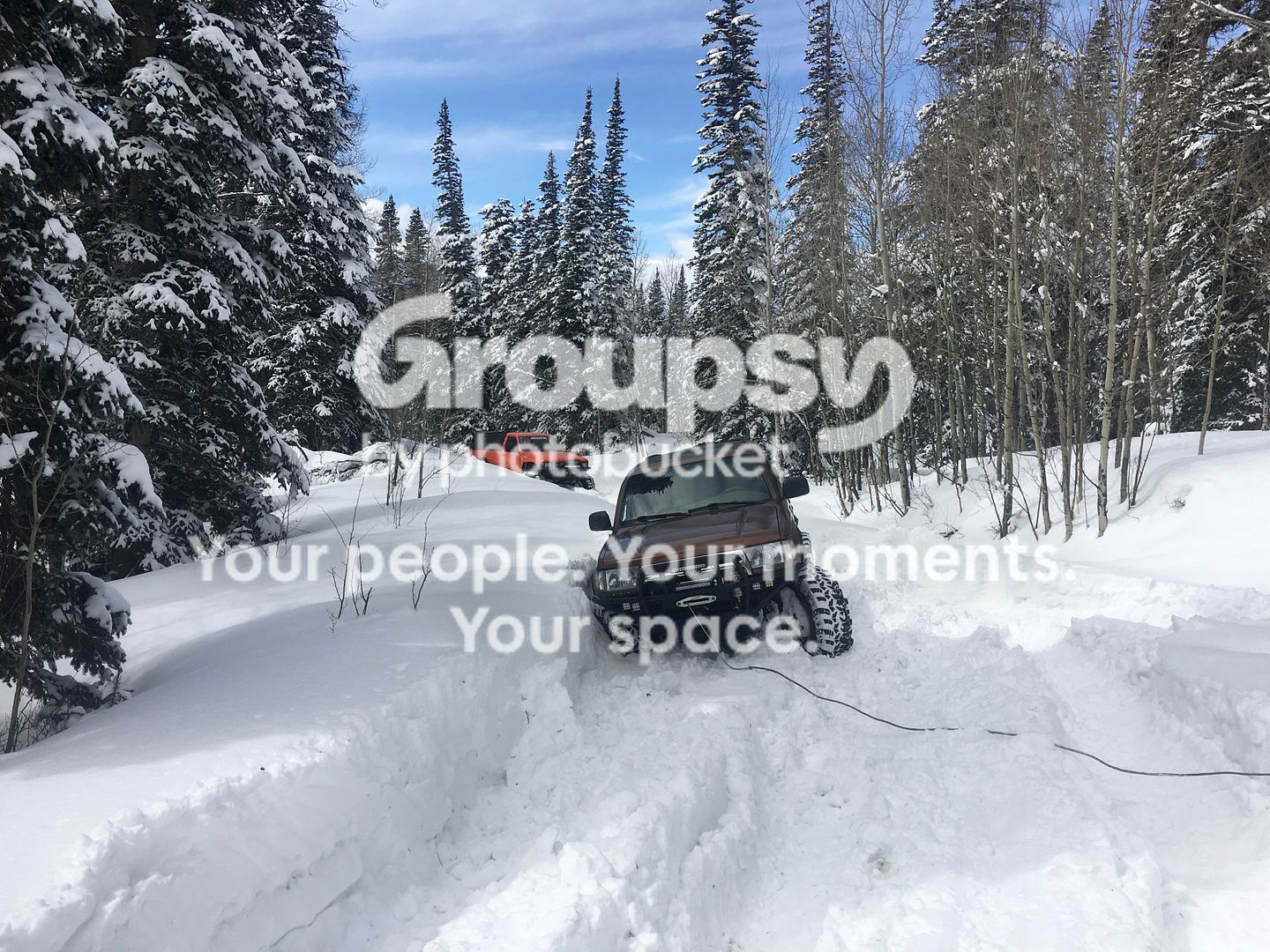

We had a couple storms roll through prior to Aaron showing up, so I knew the snow would be deep. We made quick time up the trail and into the trees were the snow got deep, almost immediately we came across a down tree, luckily I brought my chain saw. A little further down the trail there is a steep hill you have to climb, this proved to be a challenge with how deep the snow was. Aaron was breaking trail, but in the process he slid into the deep snow on the side of the trail.

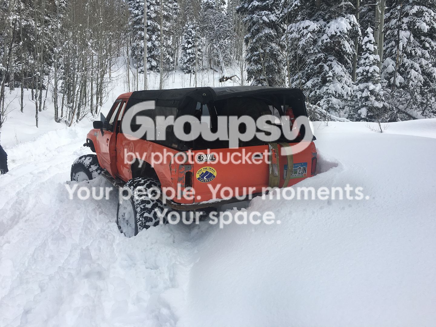

I got around him and attempted to start a new track, but I eventually fell into his ruts and got stuck. (These are Aaron’s photo’s, I was busy with the GoPro)
That’s some deep snow! Those are 40” tires and the snow is almost up to his soft top, and he’s not touching ground!
I decided to try and winch up the hill, since Aaron had come so far to go wheeling and I didn't want the day to end so soon. The trail levels off once you get up that hill, so I figured we might be able to make some good progress once we were on top. That turned out to be a bad idea; I was still fighting the rut on the passenger side, and about 10 feet into the pull I heard something pop in the front end.

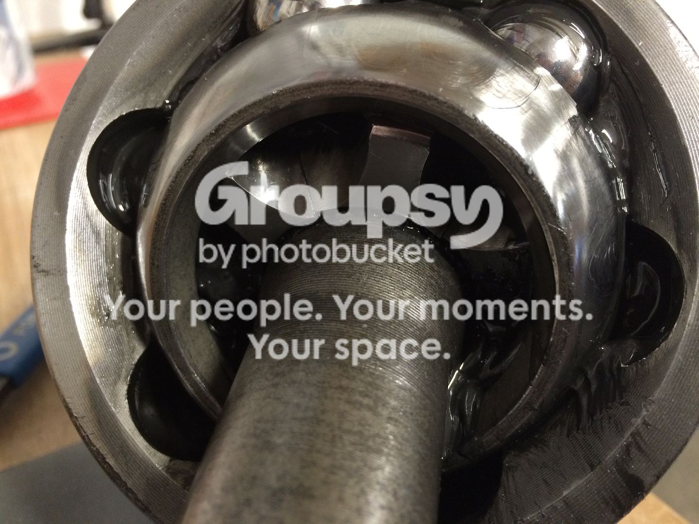

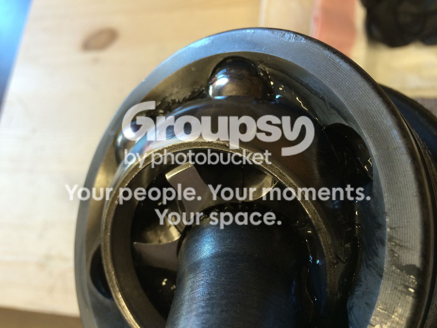

Once I got it home I tore into it to find what had broke, upon further inspection I found that I had broke the inner star/race on the passenger side outer Lotus CV joint. While some people would be upset about the break, I'm quite the opposite. It's never fun to break parts, but I'm amazed at how well these have held up to the new tires and wheeling I've been doing. I have not taken it easy on them, those of you that have wheeled with me can attest to that. I had a spare Lotus axle, so i swapped that in and I put a stock CV in the 4Runner as a spare. I will order another replacement from [MENTION=11013]glenyoshida[/MENTION] when funds allow, and I will continue to run the Lotus axles.
FYI, Every Lotus CV that I have broke has been with the steering at full lock, and front locker engaged. Pretty much the worst thing you can do to a CV joint. I try to avoid that situation as much as possible, but that happens quite a bit when your deep snow wheeling.
From what material is the star made? The Longfields/RCV's are 300m and that seems to be the strongest.
Oh, and damn(!), that's some deep snow!
It's chromoly, Glen would have to chime in with the exact specifics. When Glen set out to build these Lotus CV axles he wanted to make something stronger than stock, but still affordable. I feel they have a good balance between being stronger than stock (upgrading the weak outer joint) but not being so strong that the breaking point moves to the ring and pinion or intermediate shaft. It's still possible to break those parts, but so far I've kept my breakage to the outer joint that is very easy to repair (knock on wood!). That's why I'm not running the "unbreakable" RCV axles. With my set up, breaking an upgraded CV joint once every year or two is reasonable, and is the cost of wheeling such a modified rig. I feel that your average 3rd Gen owner would be hard pressed to break one. The last I heard, there was only a couple people who had broke one (myself included).
One more thing, for anybody running the Timbren/Wheeler's Off-road Bumpstops; they have to be removed to get the CV axle in and out. Mine use a 8mm allen socket, which I did not carry in the 4Runner pervious to this repair. I also put a generous amount of anti-seize on the bolts to keep them from rusting solid.
