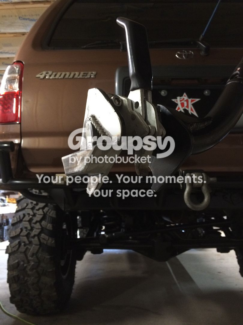

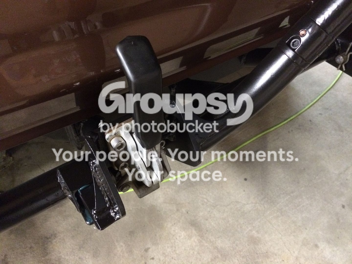

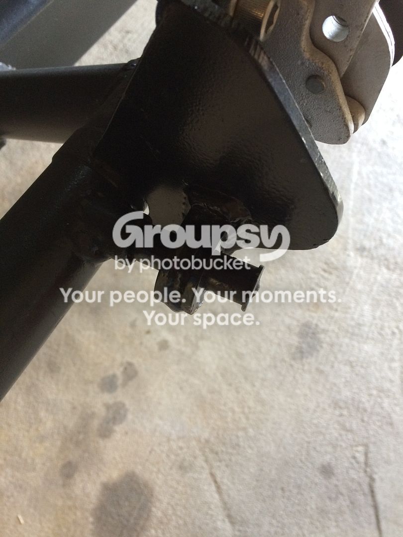

I redesigned the spare tire carrier "index pin"; I wanted something that was a tighter fit, and looked a little cleaner than the last one.
Old
And new

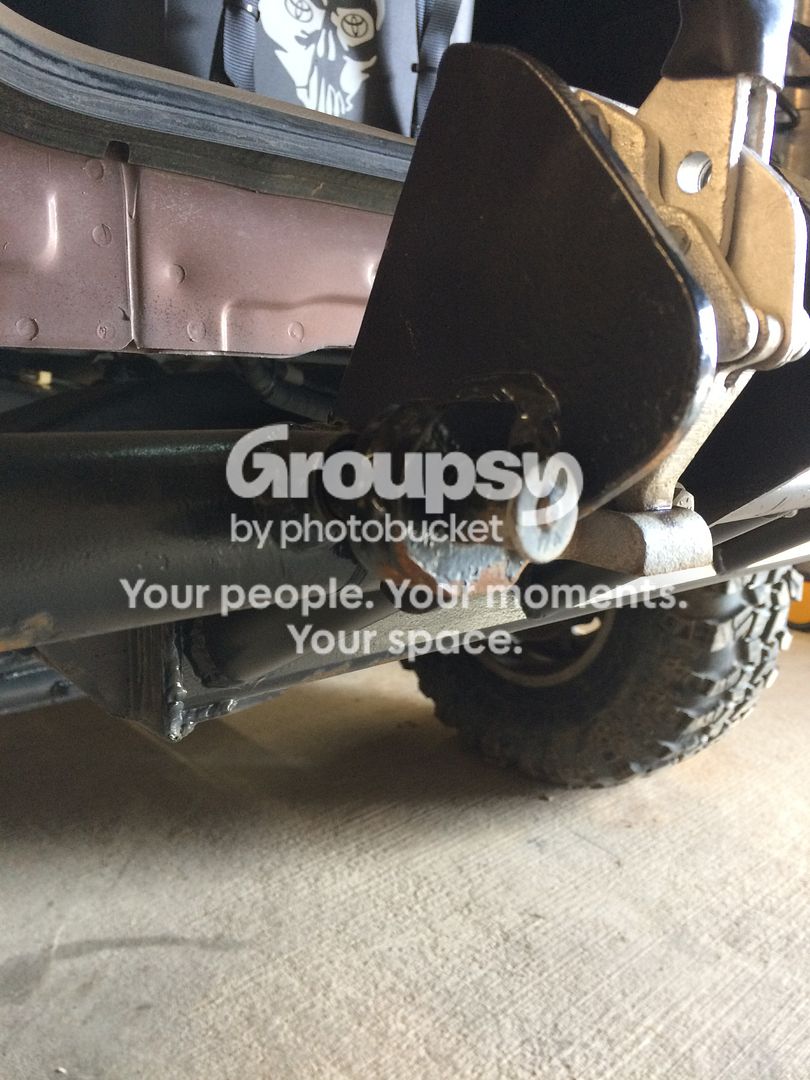

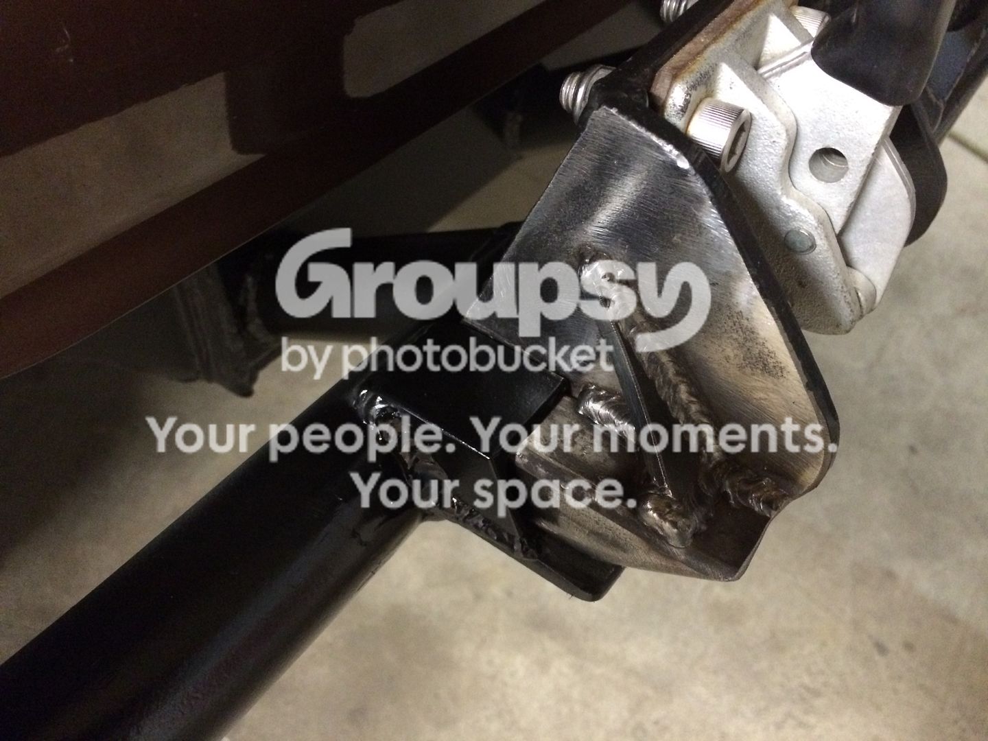

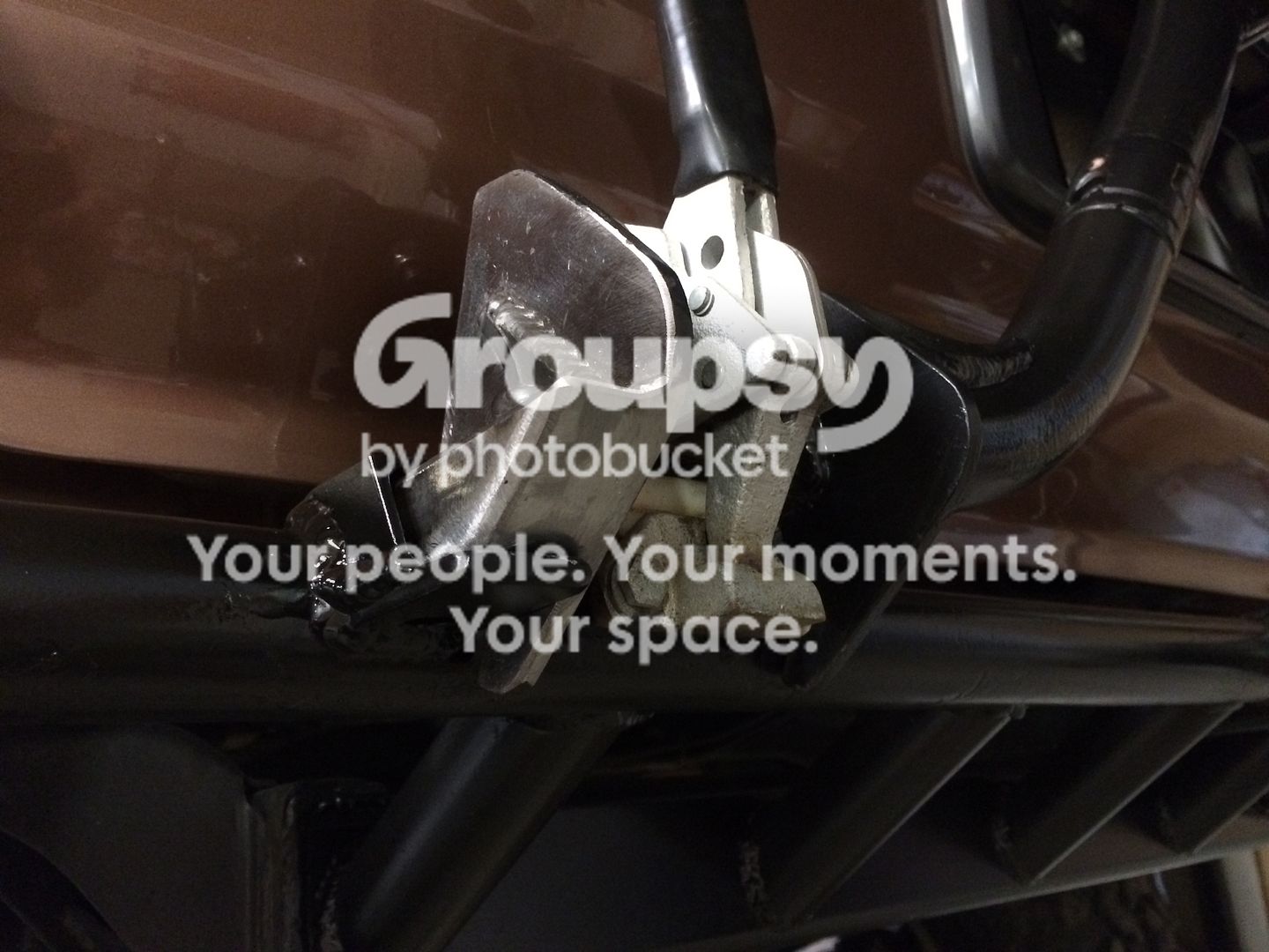

I also added a tube clamp to the end of the tire carrier, I couldn't get the carrier open all the way when the trailer was hooked up to the truck (it would contact the trailer). That wasn't an issue when I was using the trailer as a base camp, but it sucks for overland style trips. Now I pull two bolts and the end of the carrier comes off.

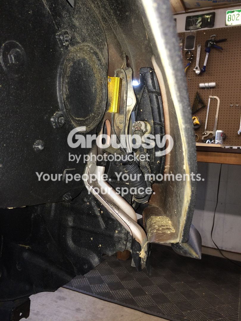

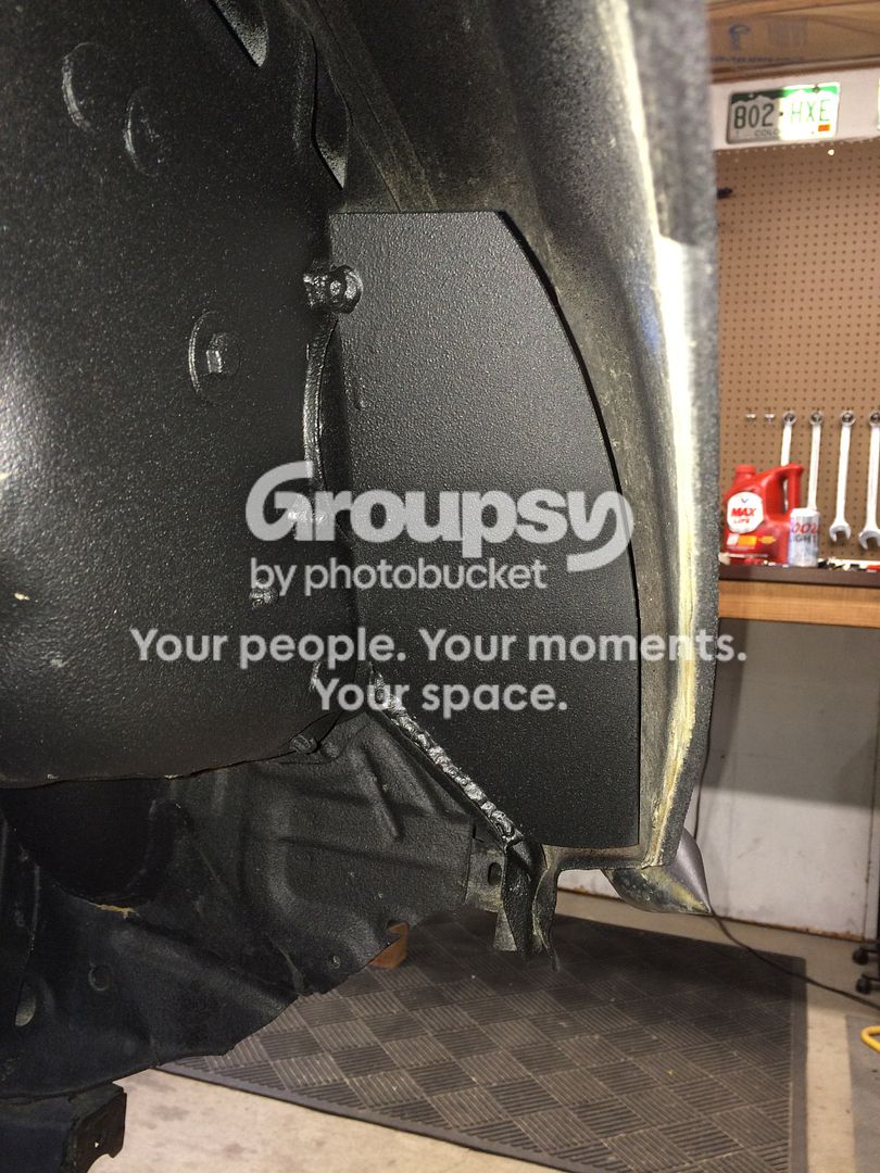

I got sick of the front corner markers getting packed with snow and mud, so I finally made some splash protectors. It's nothing fancy but it should do the job.
Before
After

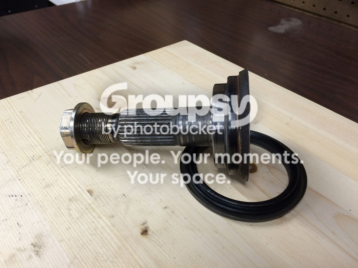

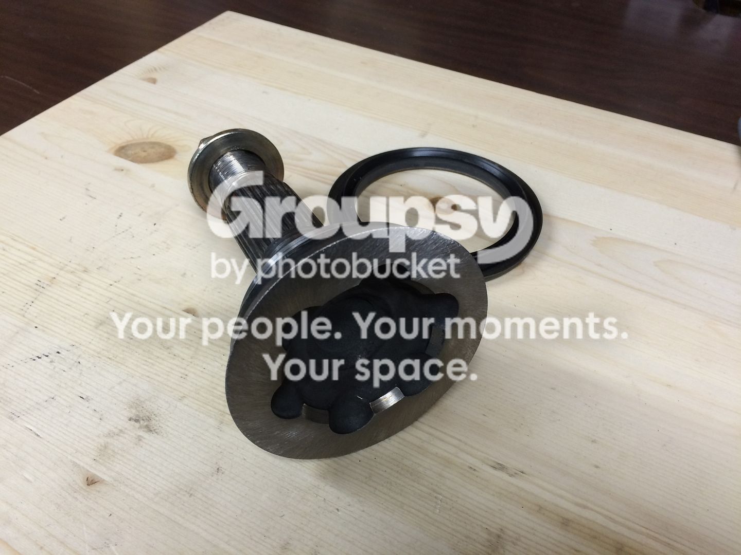

I don't trailer my 4Runner anywhere, I drive it to the trail or destination, and on longer trips it's towing the camping trailer. Because of that I have to take certain precautions to make sure I can get home. I've always been concerned about blowing up a front differential and having to drive home on it. The front wheel bearings are held together by the CV joints, so you can't just pull the CV's and driveshaft. For that reason I carry an outer CV joint to keep the wheel bearings happy, but it was heavy and bulky. So I cut the outer cage off and made a plug out of it.
So would you have to put your modded cv on both sides or just let the front diff soon with the good cv, after you disconnect the front driveline?
Great idea btw
Great idea btw
Thanks! Technically, I should only need it for the driver side. That's the side that goes straight into the differential, the passenger side is disconnected via the ADD when the 4 wheel drive is deactivated. But, I will probably make a second one just in case.
