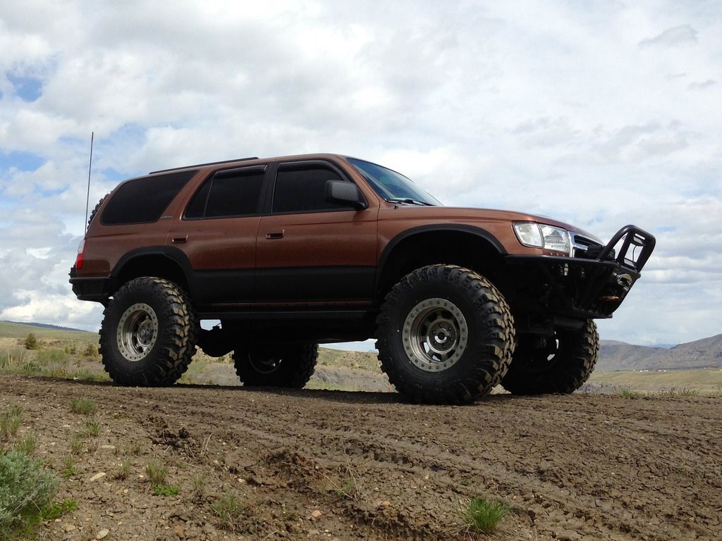

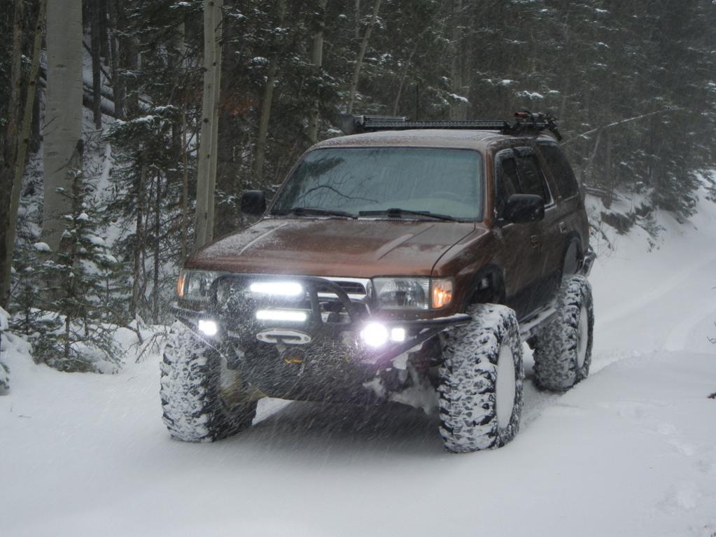

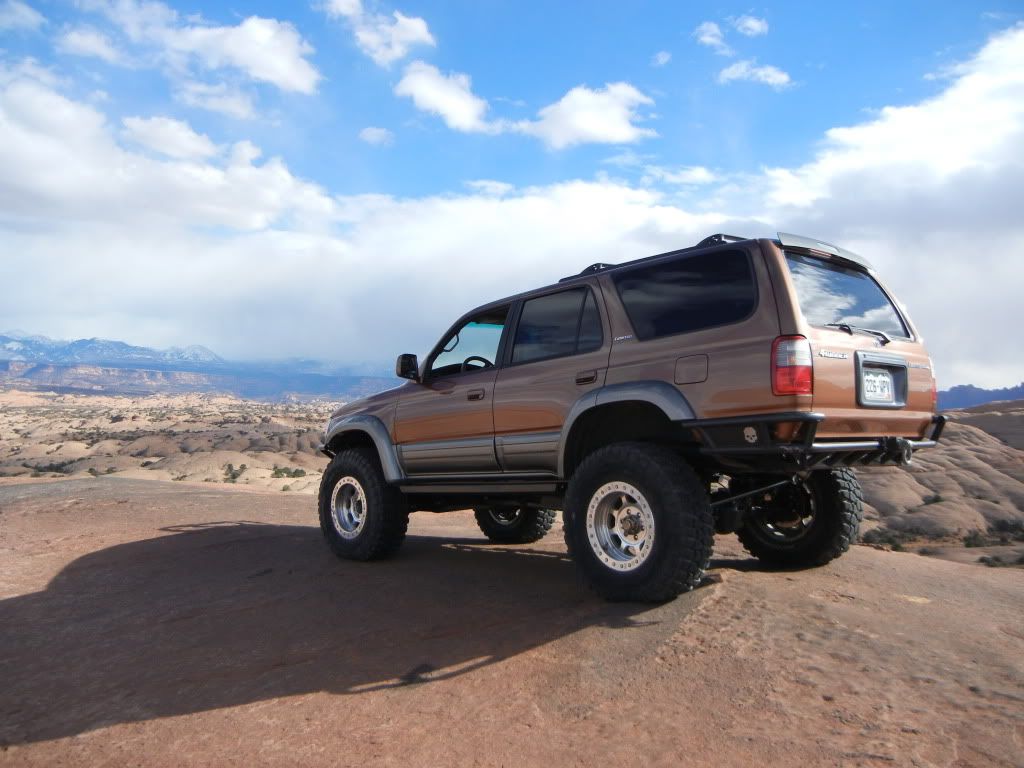

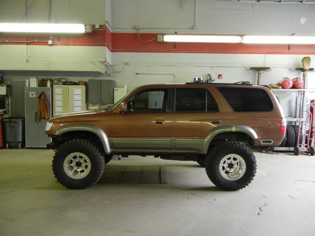

Holy F#ck! The last time I checked this thread you were doing a SAS. It's bad ass & the attention to detail is amazing. I almost wish you bought another rig to cut up because this rare color was one of the most beautiful 4Runners ever.
I suspect that he wasn't planning to cut it up like this before it rolled down a hill.
Also, I saw this color in person for the first time the other day. I didn't care for it in pics, but man is it pretty in person.
Oh trust me, I never planned to go down this road! The 4Runner was just about perfect after the SAS (besides for fixing the rear suspension geometry and rebuilding the spare tire carrier) and it was perfect for camping and overland style trips!
