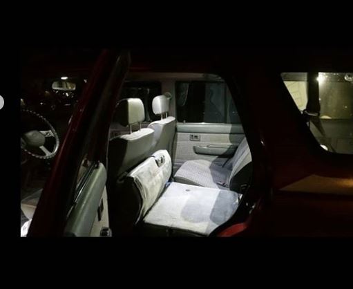

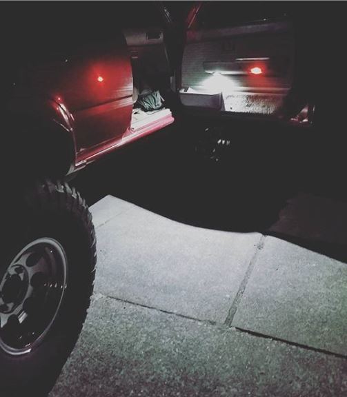

I have several of those knock offs. Their output is pretty dang good.
when my dome light failed I used one. Like you I added a door light. Works great
Truck progress is great!
