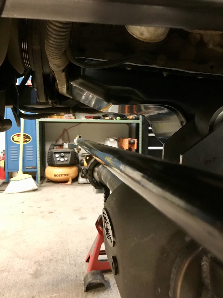

I’ve been waiting to post progress pictures until I got a little further along, setting up a link suspension is very time consuming and you move stuff around quite a bit until it fits. I’m still going to need to tweak some stuff around, but for the most part the major components are in place.
I finally got my track bar brackets after the first package got lost in the mail. After getting everything mocked up I trimmed them down and tacked them in place.

With the track bar in place I could cycle the suspension and mock up the steering box. Due to fitment requirements, and to get the roll center as high as possible, I installed a flat pitman arm on the steering box. I also had to move the steering box as far forward as possible.
