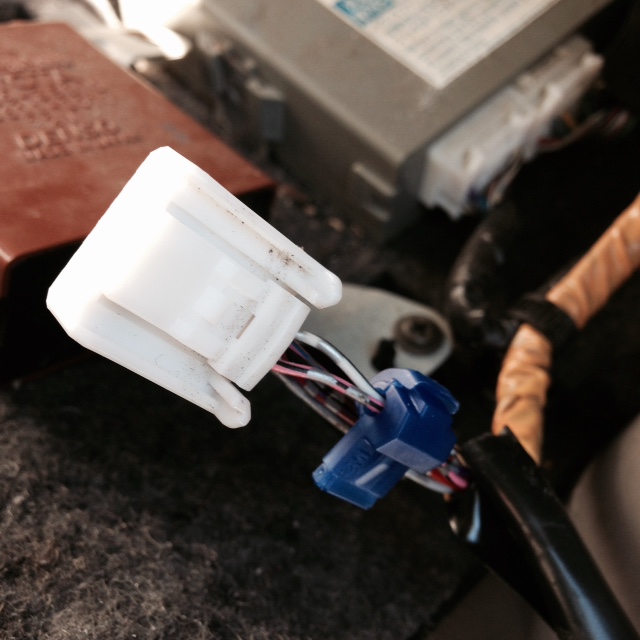

My spare didn't hold air so my TMPS light was always on. Here's how to disable the TPMS light.
This post by txt4r pretty much covers it. http://www.toyota-4runner.org/4th-gen-t4rs/108176-write-up-how-disable-bypass-tpms.html.
I thought I'd show it with more pictures.

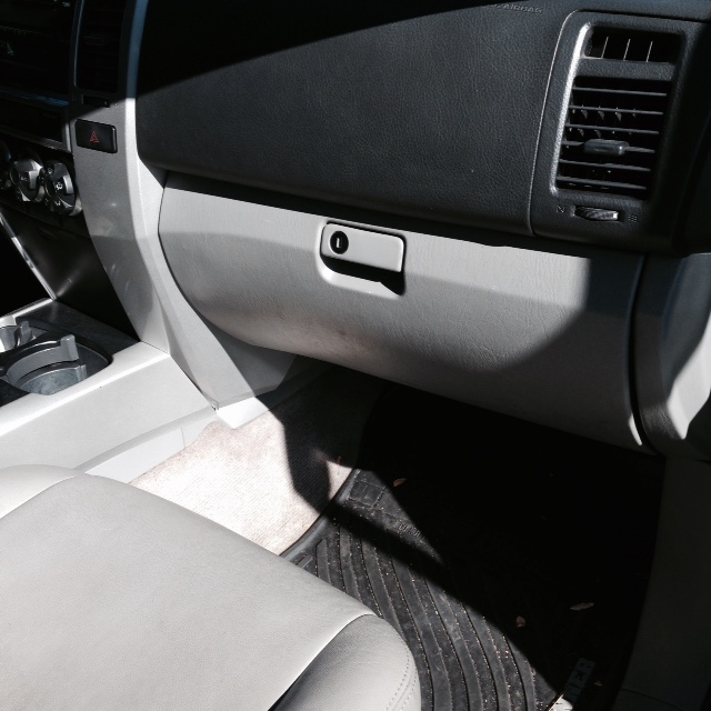

Unscrew (one screw) the cover underneath the glove box:

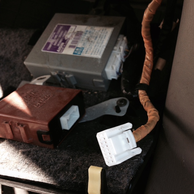

Pop the cover off, then unplug the connector:

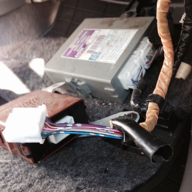

Peel back the tape around the wires:

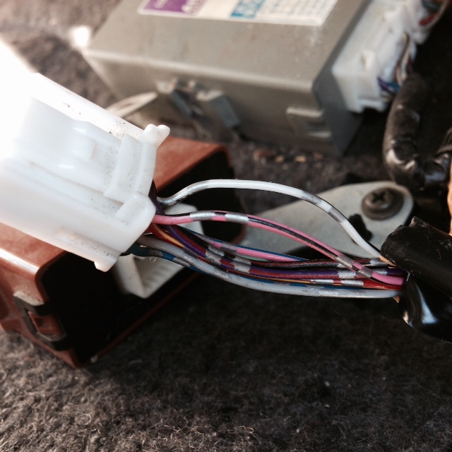

Find the pink/black and the white/black wires:

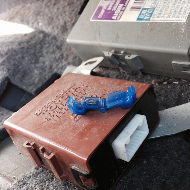

Use this "18-14 AWG IDC Terminal T-Tap Splice Tap T-Tap" (Part Number: IDC-184) which you can get for 19 cents from superbrightleds dot com:
Slip both wires together into the Splice Tap and close it:

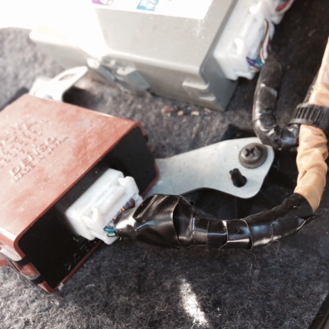

Wrap it up with electrical tape (optional) and plug the connector back in:
