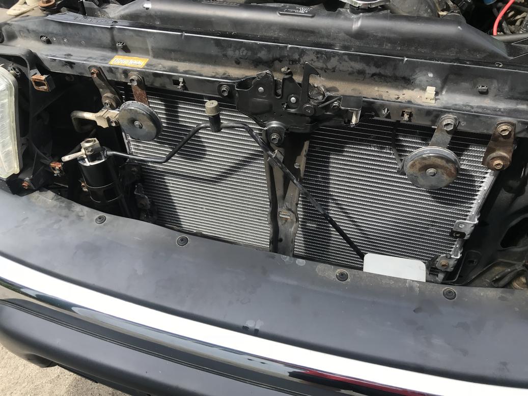

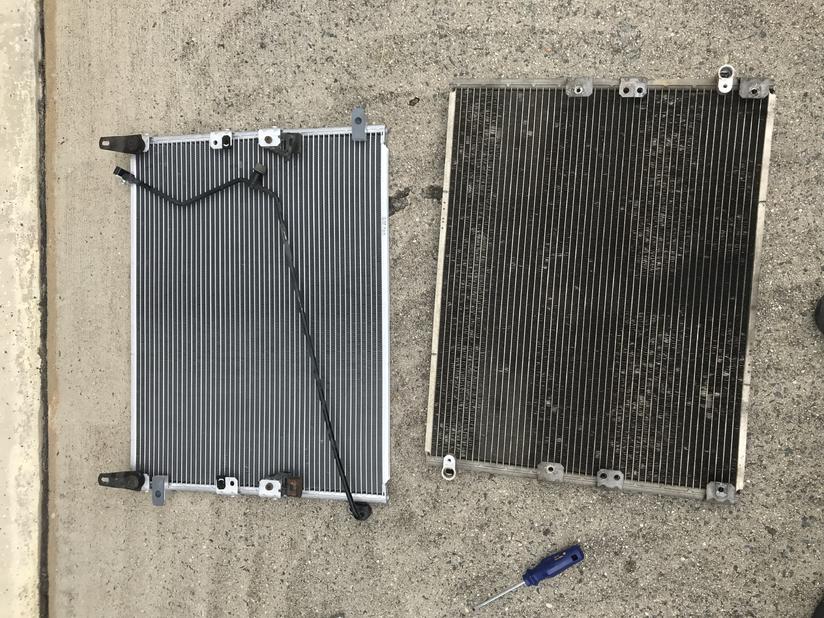

Got the condenser and dryer in this morning. Pretty easy job, just a ton of bolts to take off and then reinstall. Only issue I had was two of my clips that hold the grill on broke. Cable ties to the rescue until I can get new ones.

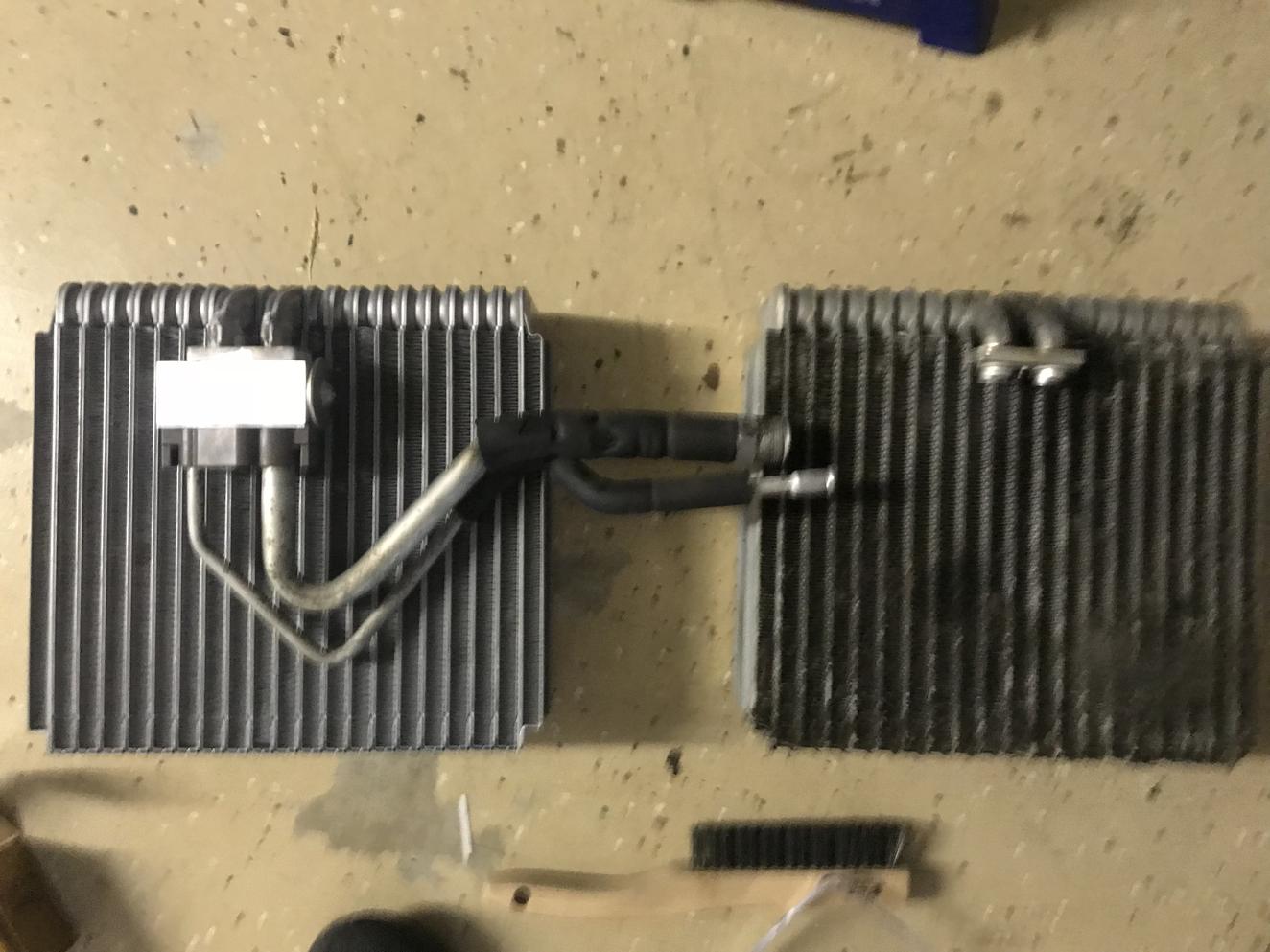

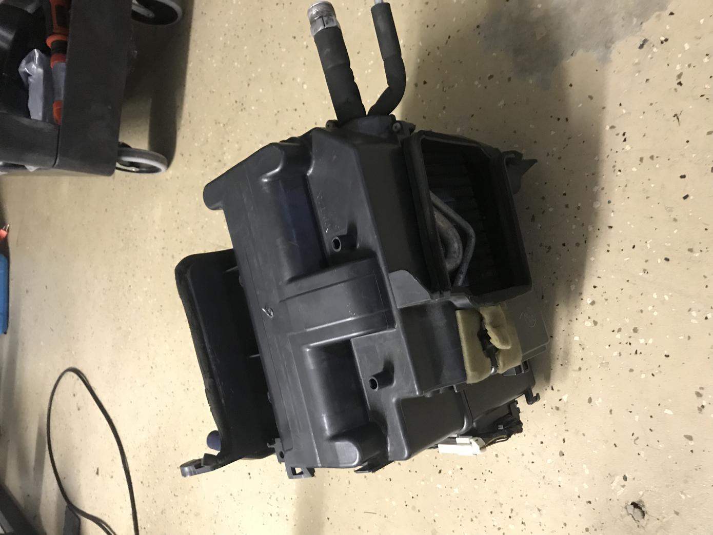

Here’s a couple photos of the evaporator. Mine was filled with 19 years of nastiness. Glad I decided to just replace all these major components as they looked pretty bad after 217k of use... The only non OEM part I used was the evaporator. Got some other brand off Amazon that all had 5 star reviews. Decided to roll the dice on that part based on the reviews. Fit perfect and no issues during the install.

Great pics! man, that evap core was definitely ready to be replaced. I am sure the air in your rig will also smell much better now. Nice job!
One question: How did you end up cleaning up/out the evaporator core case? (I rinsed my out and then put it in the dishwasher...LOL...but it WORKED!)
I used about a tree and a half of paper towels and glass cleaner to wipe it all out. It was a mess! Get back from Chicago tomorrow night then hope to finish this up Thursday and be fishing all weekend, weather permitting! Thanks for the help!
