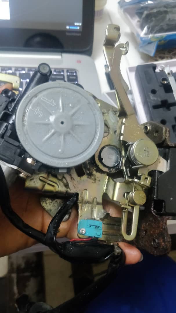

finally got it working ok now, this video helped a lot
YouTube
am super stoked, i was able to repair the assy myself, i hooked up the motor to 12v and used it to move the arms, while i manually adjusted the locking mechanism.
next stop is to repair the weather stripping, cos thats what failed and allowed water into the hatch in the first place
