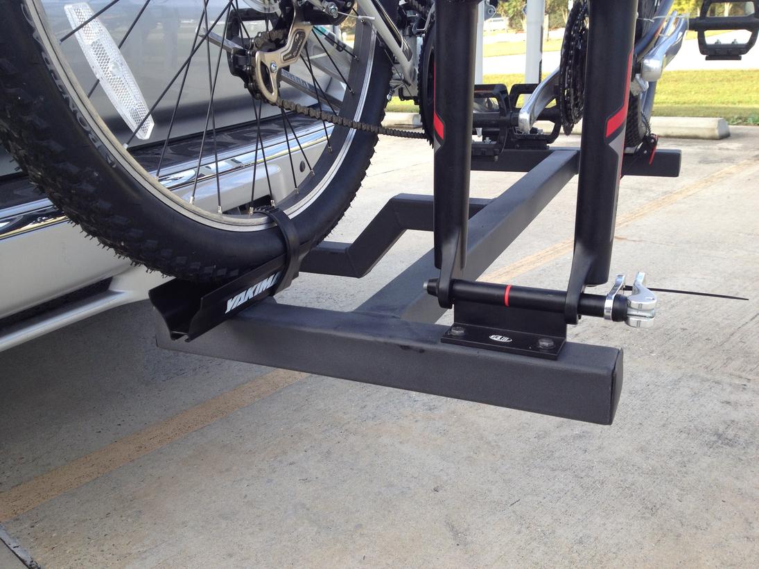

After much back and forth I decided to make my own bike rack. There were pros and cons to each a hitch rack and a roof rack. Biggest con of roof rack was my height disadvantage. Biggest con of hitch rack, the sturdier the more $$.
Supplies:
roughly 8' of 2"x2" steel tubing.

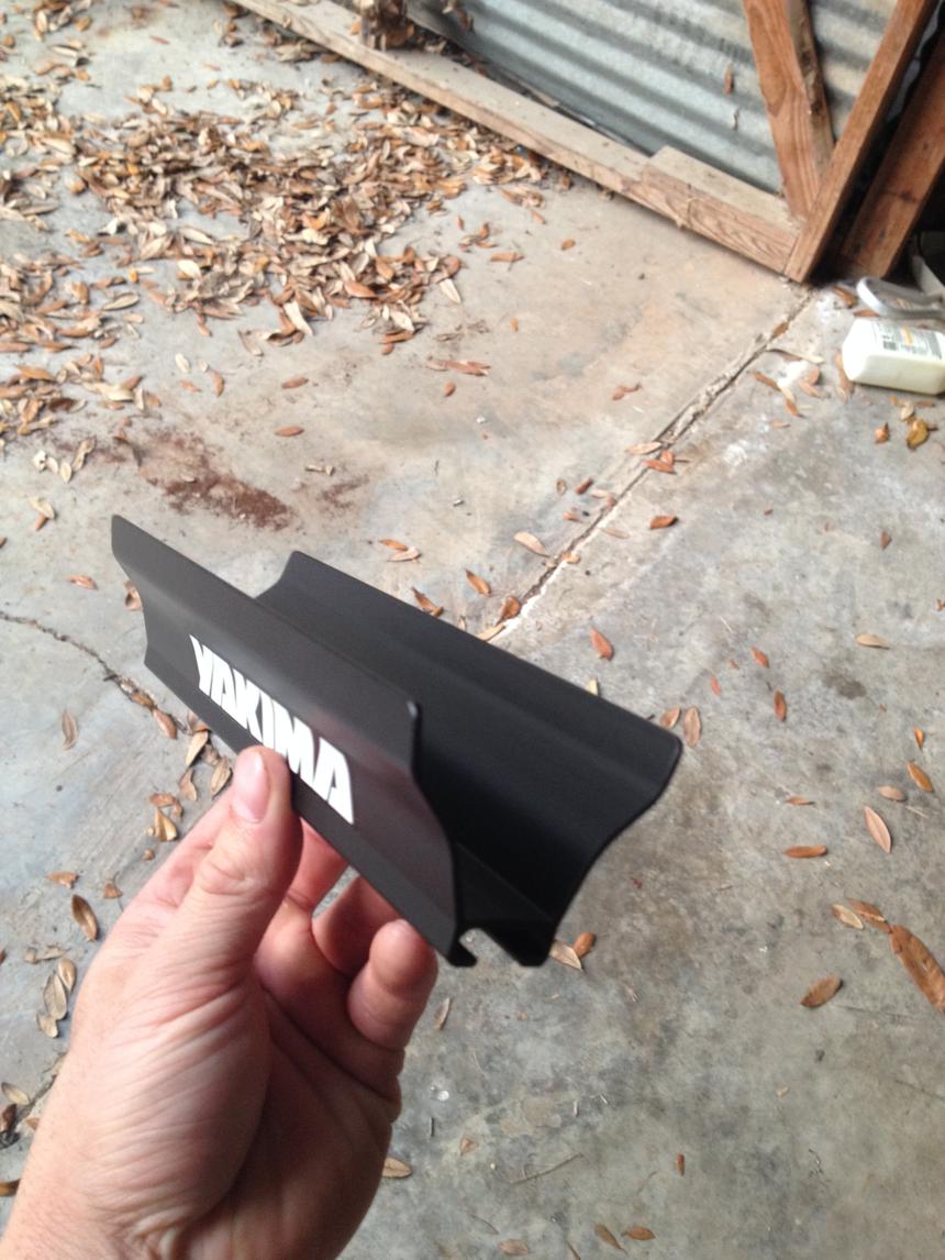

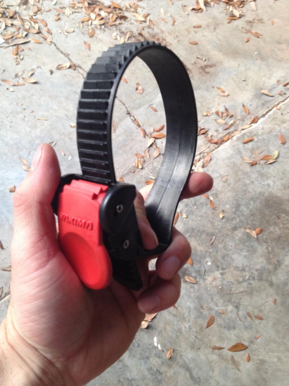

2- fork mounts (Amazon)
2- tire trays (Ebay)
2- ratchet straps (Amazon
2- cans of metal primer
2- cans of rubberized undercoating

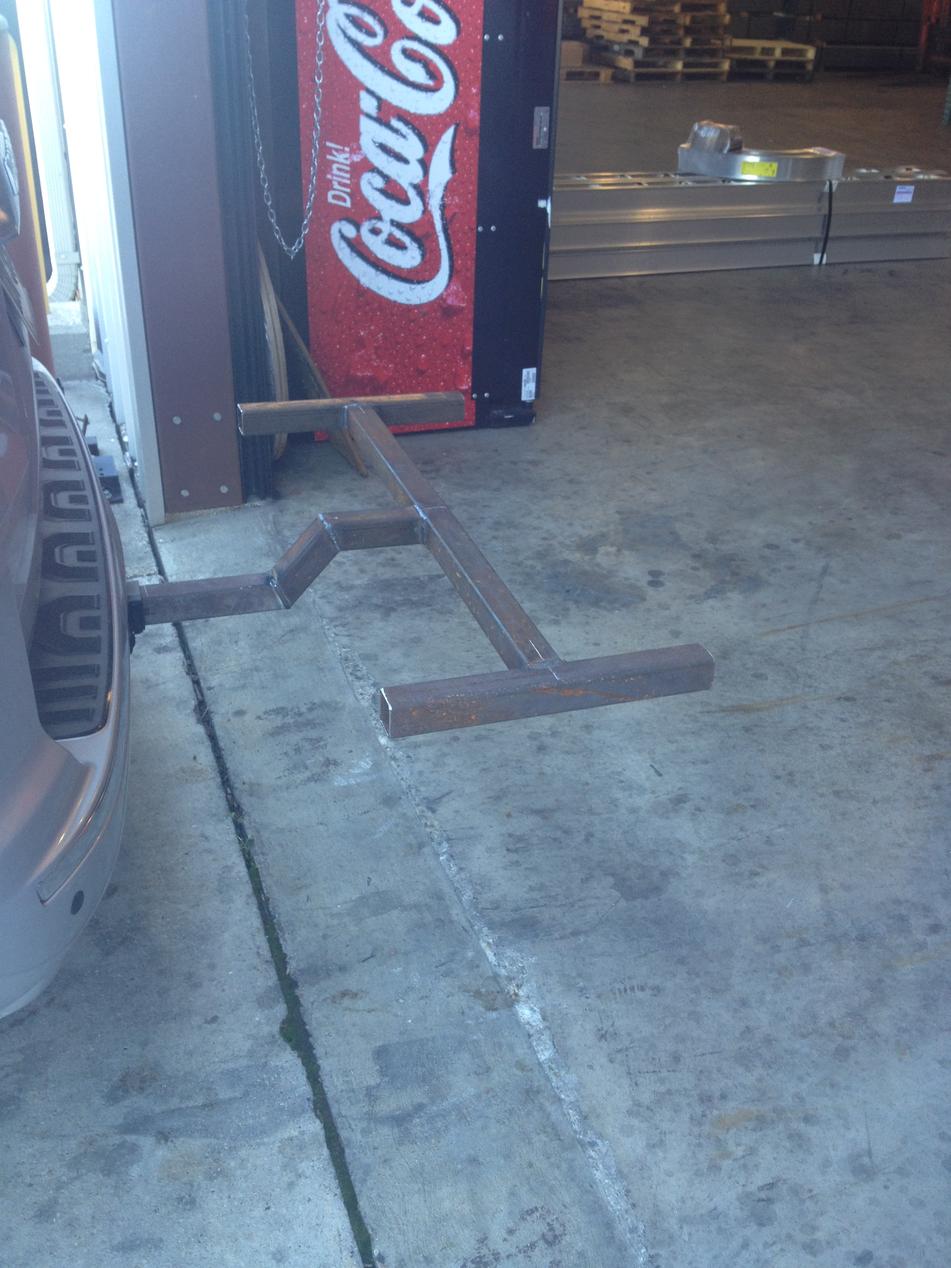

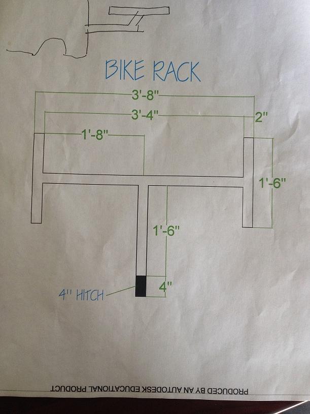

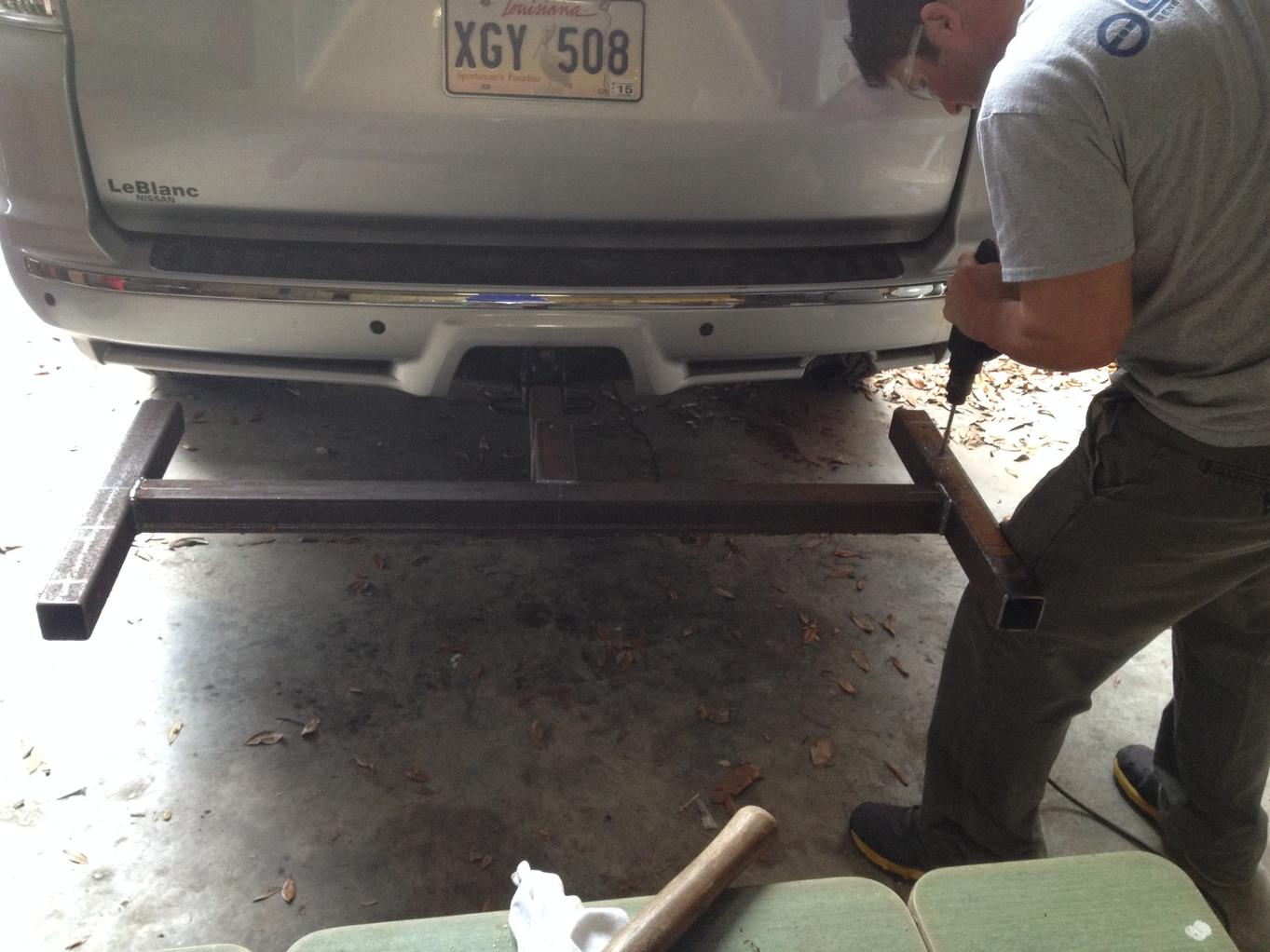

Started with a CAD 2D drawing of the rack, after setting up bikes like I would mount them and take some measurements.

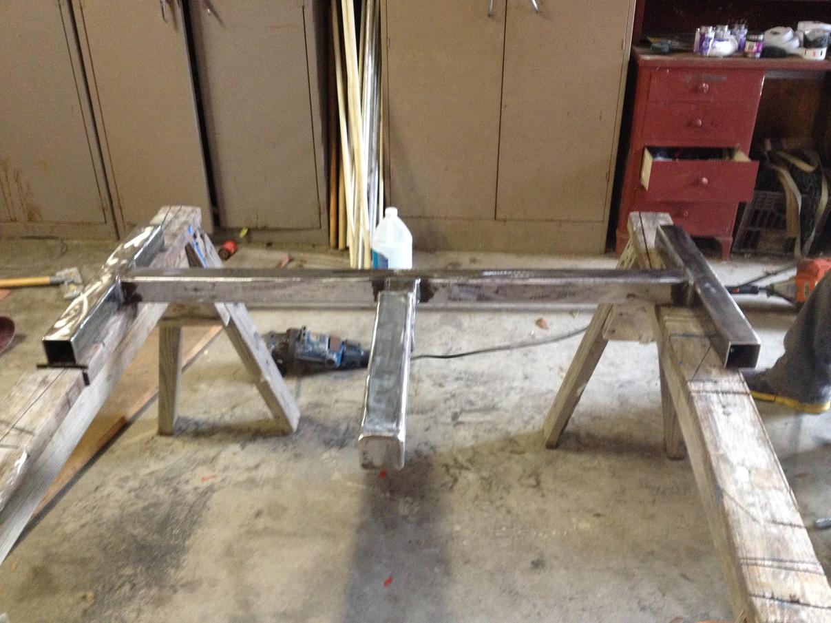

Cut and Welded frame, going exactly off the drawing. (Measure twice, cut once)
-disclaimer- I only did two welds on a count of wanting this rack to look good. My uncle did the rest, mine were just not good.

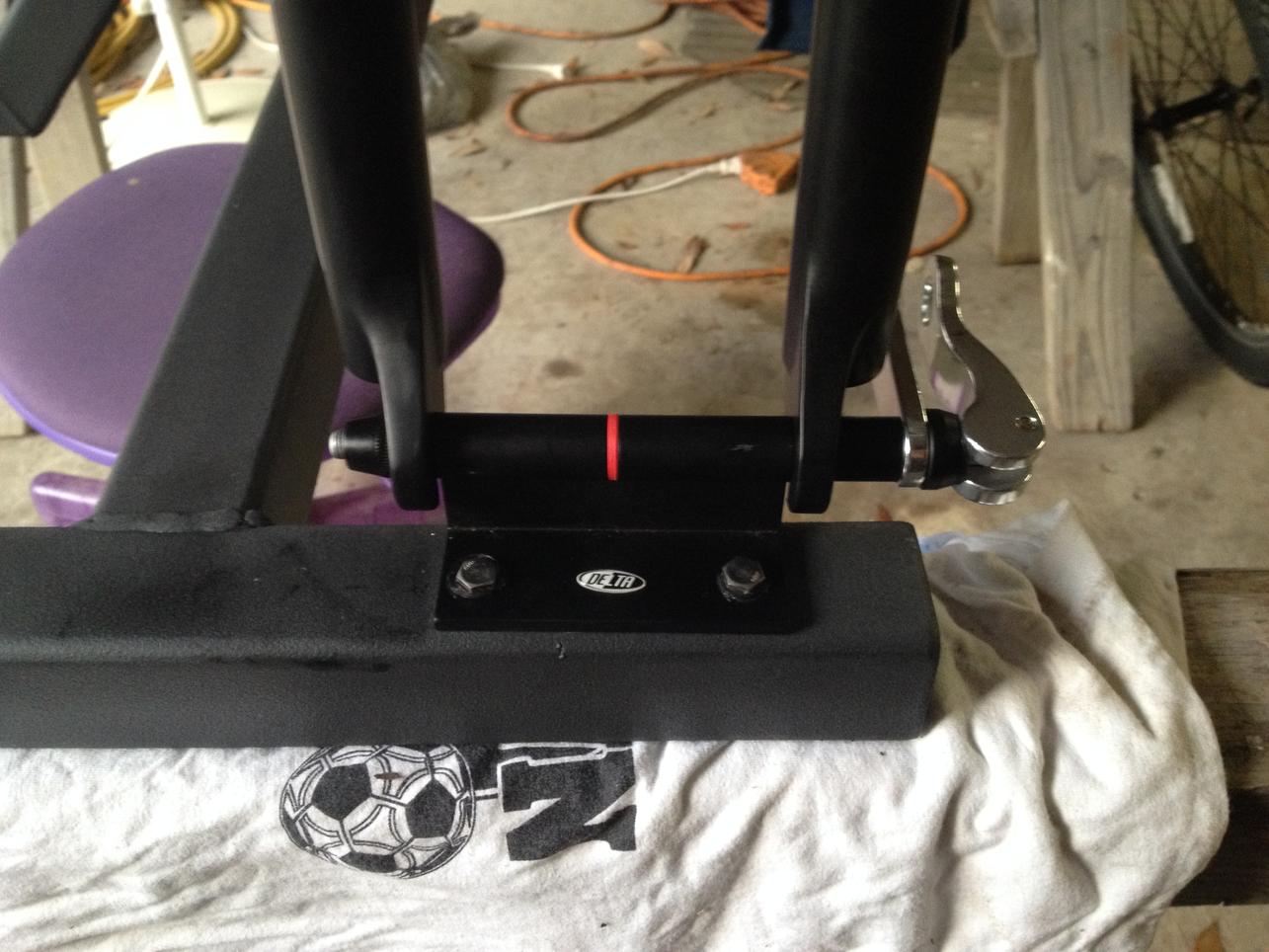

Set bikes on rack and marked where to drill my holes for the hardware.

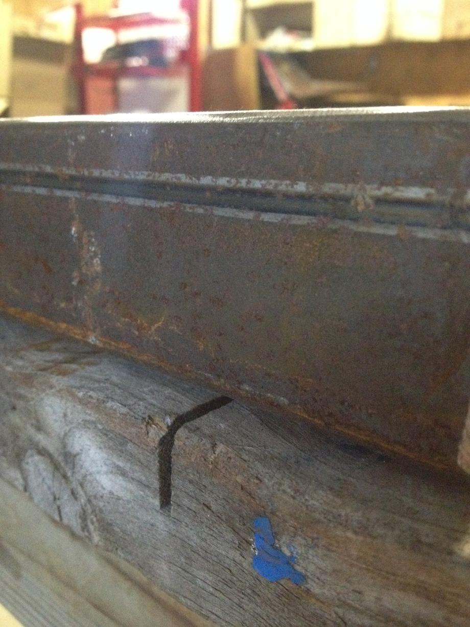

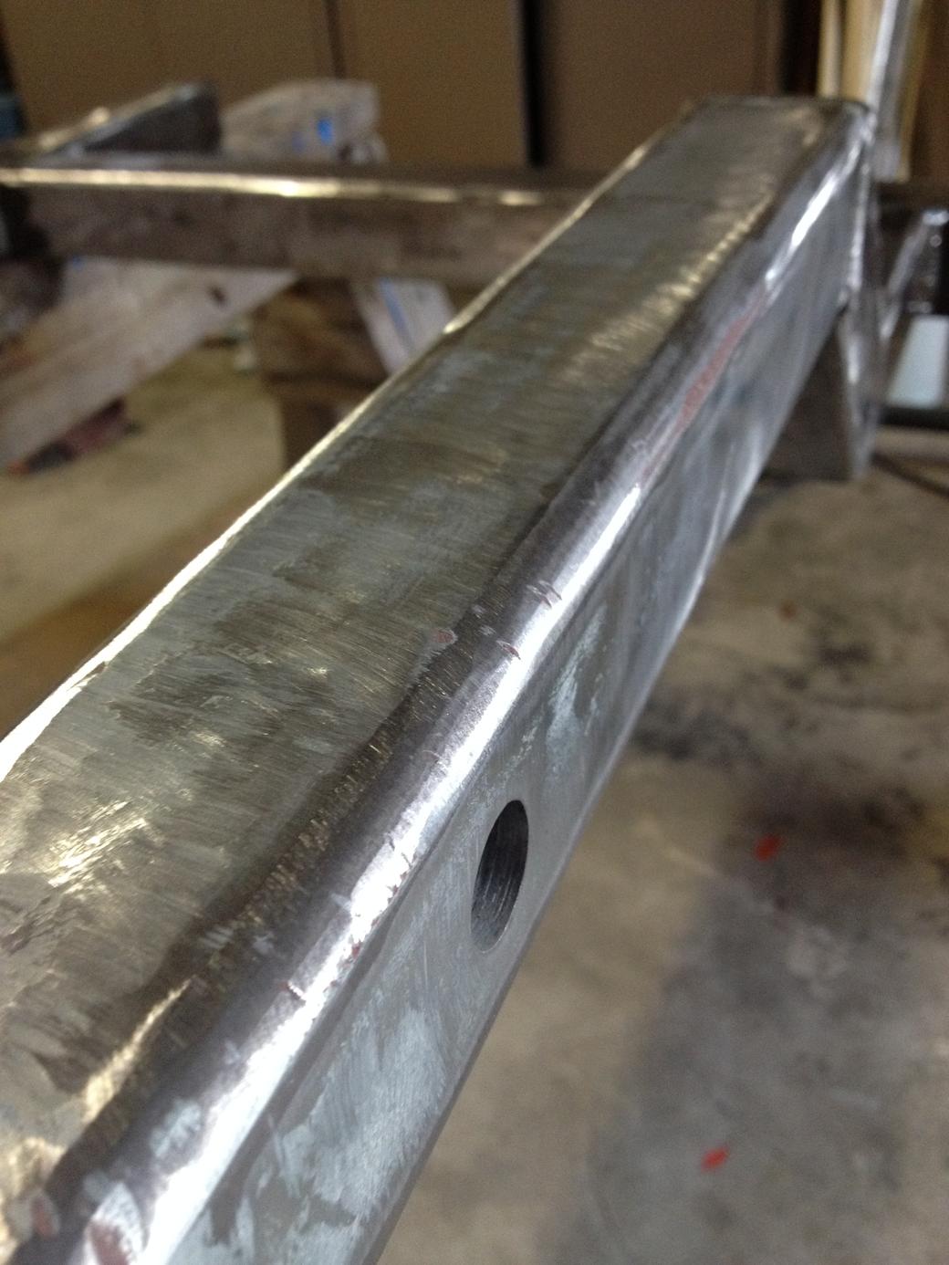

Removed all rust and paint, with metabo sand pands and wire angle sander.

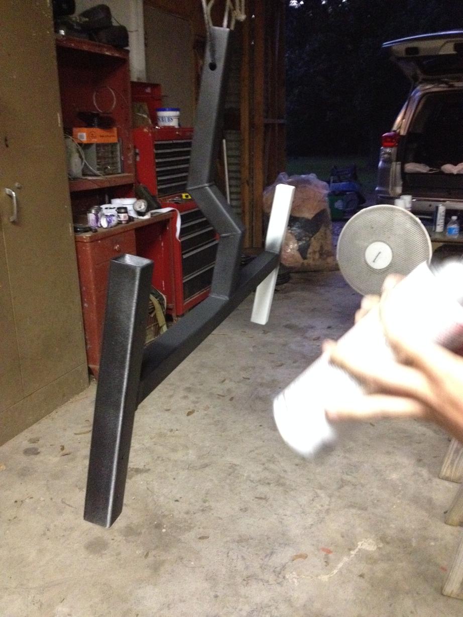

Primed with two coats of Rust-o-leum metal primer. Painted two coats of Rust-o-leum undercoating.
Let dry for 2 days. Then put on hardware from online, using stainless nuts and bolts and some silicone.
FINI!

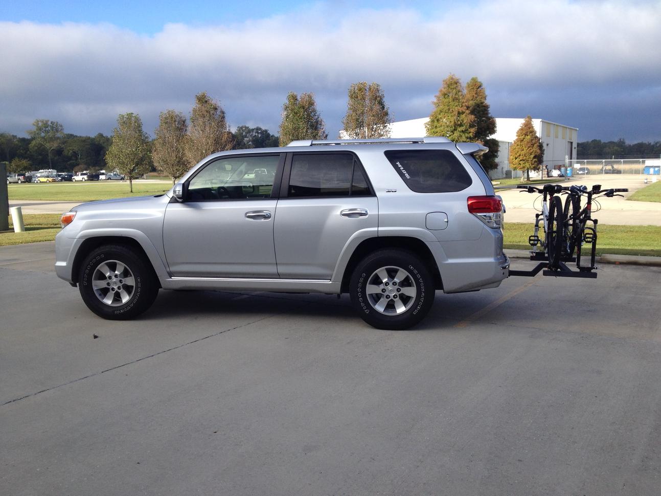

Overall very pleased with the outcome. Saved a lot of money and it's much safer and sturdier than anything store bought.

Nice work! Very similar to a Hollywood rack I had back in the day. I miss the days when everybody used good ol' 9mm front wheel skewers.
Is that thing 100lbs?
haha no. I was worried about that, but I used 1/4" thick on the middle support going to my rig. Then on the "I" I used 1/8" thick. All in all its about 20-25 lbs. Not too bad. I really want to know now so I'll have to get back with you on that.

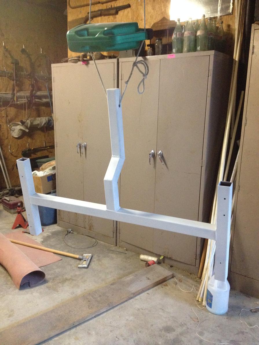

I've always used and like the Yakima Steelheads and decided to remove them from the roof and build a rack off the back. I had several requirements for the rack. The rack had to carry two bikes, any two I own our would carry. This is a mix of road, mountain and cross. The rack had to tilt so I could get in the rear of the 4Runner other than just the rear window. The rack also had to be high enough to not get caught up on anything offroad. I've wheeled with bikes and I don't want the rack or the bikes to be damaged. At the time of construction I also envisioned building some sort of a platform to hold gear and I wouldn't want that stuff getting hung up either.
Here is what I ended up with. The square tubing is metal fence post material from Home Depot (the black metal fence stuff). The round tubes are EMT with an outer diameter larger than Yakima bars. I sanded down the OD to accommodate the Steelheads only where they are mounted. The larger OD is nice because it keeps someone from sliding the Steelheads off the bars stealing them and/or the bikes. The base of the rack is a Thule hitch bike rack I cut up. It's the beefy part and already had the tiling mechanism and a bracket I could use instead of build.

It looks great. I would be a little worried about the weld between the piece that goes into the receiver hitch and the part that is the rack. That is going to flex a lot so that weld could fail, especially since the weld is hardened. It may be light enough where that would never happen, but I thought I would point it out.

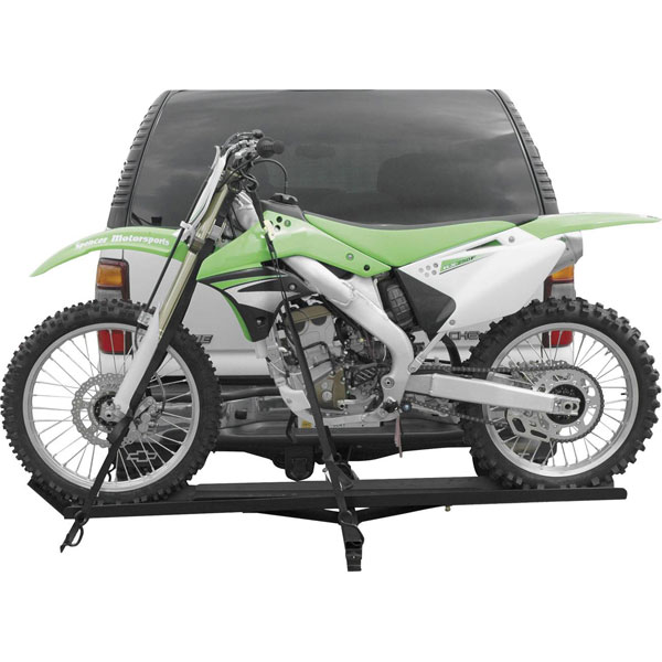

I have a hitch type dirt bike hauler where I roll the dirt bike up onto a the hauler and I noticed its design does not depend on a weld. I have noticed those trailer hitch haulers for equipment are designed that way as well. I spot welded it everywhere (it bolts together) but was careful not to put any long welds that could cause cracking from future flexing. These things flex a lot because they are a see-saw so that is what concerns me. I also have a bicycle hitch rack as well.
It should hold just find under the weight of bicycles. If it starts to fatigue and develop cracks he can plate it easily enough.
I hated to bring it up since he worked so hard on it and it is a great job, but I would rather err on the side of caution than have a problem. Good looking hitch. Excellent job.
Duly noted sir. Thanks for the heads up! I think it'll be fine but I'll look into a back up if it ever happens. Plating it is a good idea.

My worst fear is my dirt bike falling off into traffic. However, I love this thing and the way I lock it down it cannot come off. I put lights on it though because the dirt bike hides all the lights on the car. It is much better than fooling with a trailer.
