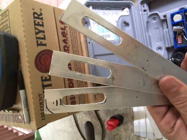

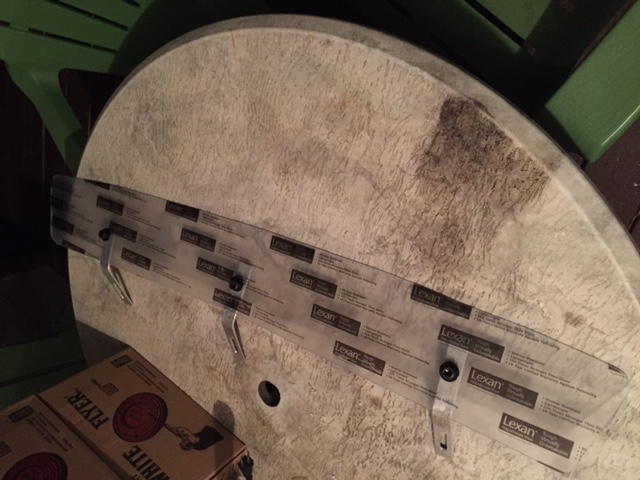

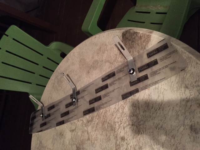

thanks for this thread it was very helpful! I still need to smooth some things out but the bones are complete so the rest is pretty simple. I changed some hardware so it isn't like the original but it's kind of close or one of a kind I guess you could say.

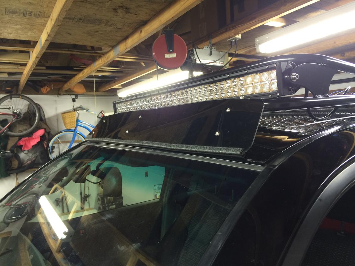

Definitely enough! That stuff is unbreakable man. I literally scored the thing like 20 times as hard as I could with a blade to try and break the oversized sheet in half and it wouldn't break with all my weight on it. LEXAN is definitely the way to go. With it already black she looks pretty darn good.
[MENTION=112497]VA4Runner09[/MENTION] how did that sheet you ordered turn out? 1/8" thick and tough enough?
Oh man oh man yours looks perfect! Thanks for the pic. What weather stripping did you use? Anything special?
Just the stuff that Matt mentioned in his write up. Took some coercing to get her on there but finally got it. This is definitely no quick mod. Took me about 6 hours with my dad's help.
Helpful hint for getting a nice finished look: take a belt sander with a medium-fine grit on it and run it around the edges. It will smooth out the jagged marks from the jig saw or whatever you end up using to cut the lexan with.
Just finished mine. I appreciate the write-up and list of materials everyone. Take note (in post #49) of how far wide the outside plates are. You will want this to contour the fairing more and cut down on the cap on the outside edges.
Definitely a several day project, especially if using a dremel. Take your time the slower you go the better it will look.
