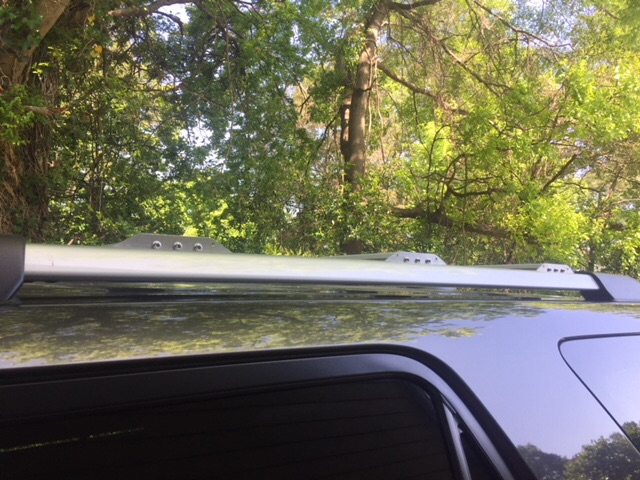

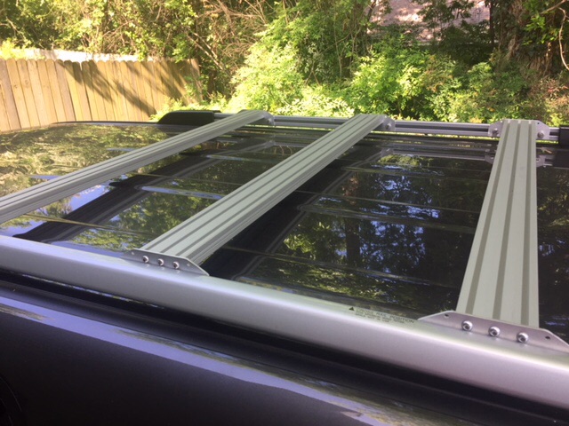

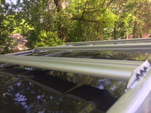

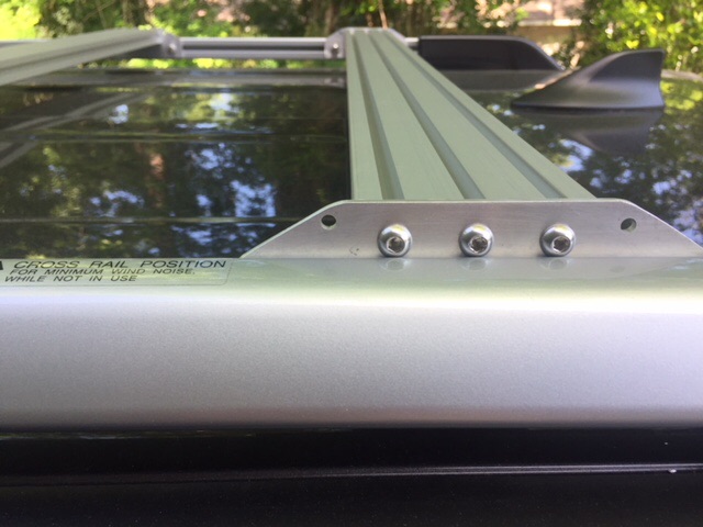

Yes I used the quarter round bar on the front rail. At sixty and above it is a fluttering/buffeting type wind noise similar sounding to if you were to hang something out of the window while driving, sorry hard to describe. It's noticeable but not over bearing. My bars are installed so the center-line of the rail is slightly above the side rail allowing me 3/4" to 1" clearance at the center of the roof and so i could use button head screws, my drill stop doesn't work well enough to countersink and produce the finish i want using flat head screws. I also used 1/4"x 1" x 5 3/4" drilled and tapped bar slid into the rail, that worked quite well. If shifting the bar locations doesn't work I've got a plan to fab and install a fairing. Work has me snowed under but I'll post some pictures this weekend.
I'm really quite happy with the way it turned out.
[/ATTACH]here are a few pictures, first time posting files so let's see how this goes. What's the trick to attaching multiple pictures?

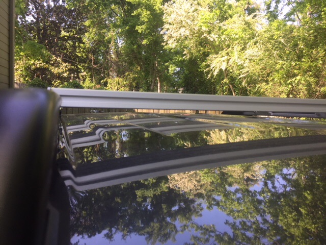

image.jpg clearance of 7/8" from the roof ridges that protude up, about 1-1/4" at the center and 1-3/4" at the side rails.
image.jpg and this is the last one unless someone wants to see anything specific. After I took the photos I moved the front rail forward and then centered the middle one. I'm thinking about building a fourth rail. This is a sturdy setup.
The rails are easy to reposition. If anyone wants more info I'll be glad respond. And thanks goes to Terrapod.

Want to add that moving the front cross bar as far forward as possible helped eliminate most of the wind noise.

That looks like an awesome setup! Did you use 1/8" aluminum for the end supports? What tools did you use to cut those to size and shape them? Wish I had access to a machine shop that could simply know out a few of those on a water jet table...
Thanks for the update! I was about to ask that question.
Correct 1/8"x2" on the end plates. I actually cut the end plates and everything else with a miter saw and used a file to finish it off. You could get the same results using a hack saw and a file, it will just take a lot longer. A drill press is also a big help. Good luck if you decide to give it a try.
