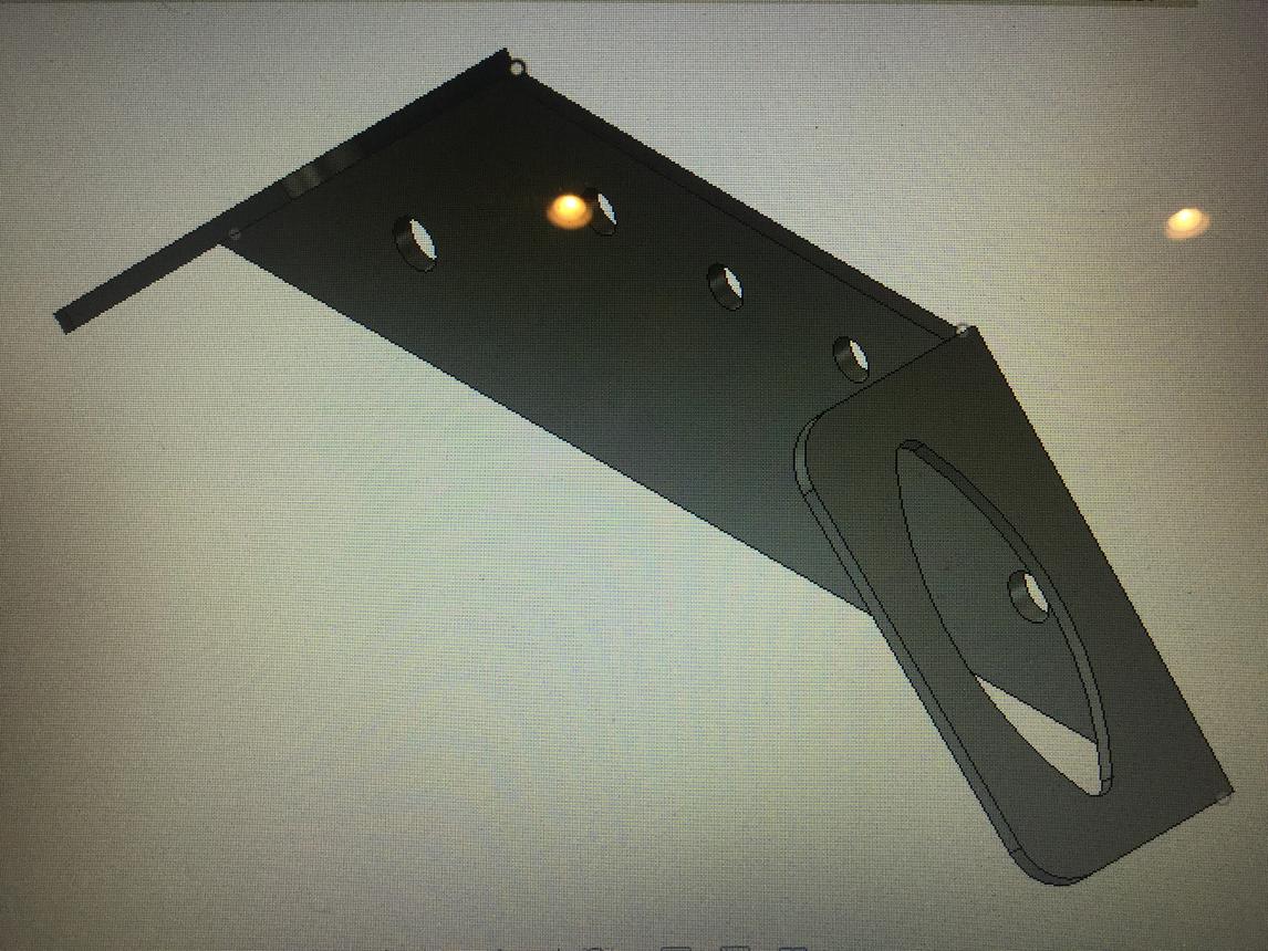

Here's what I came up with. Any critique or additional ideas?

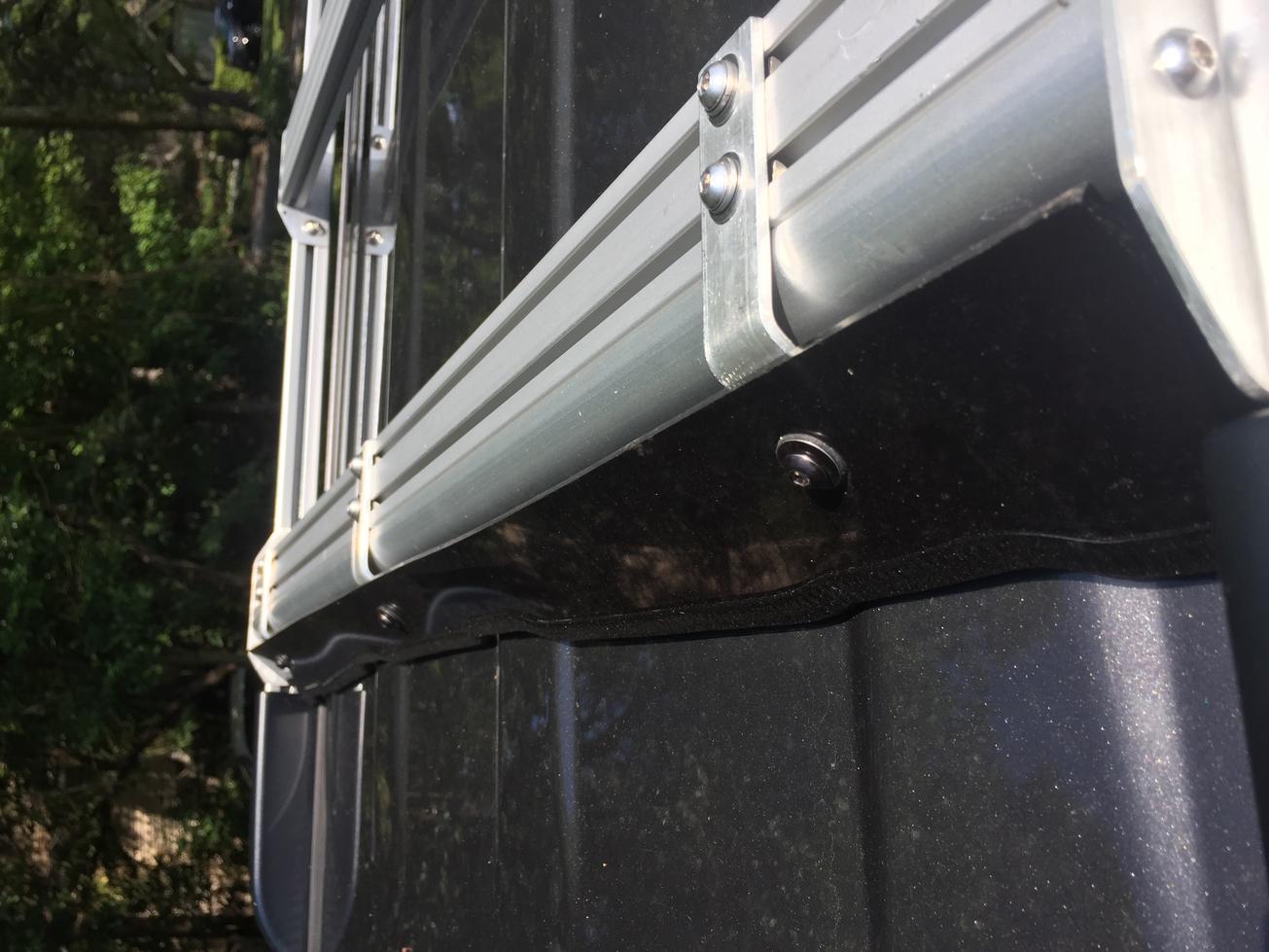

I didn't realize this thread was still active. The rack I did has worked well but I had some wind noise that annoyed me, solution was to build a fairing. It worked, looks good and doesn't interfere with whatever you load. Low profile like the bars, I'll take a picture and upload it this weekend.

I like that design better than the mickey ears. one thing to make sure of...the top of the bent portion does not come up higher than the bars....say I want to strap a 4x8 on top, I want it to sit flush on the bars, not on the bent part.
That looks like a strong design for the bent sections.

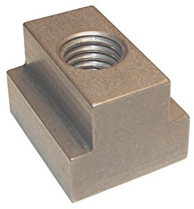

By the way, are you using T-slot nuts to attach the bars to the slotted rails, something like this?

[MENTION=126318]craaaazzy[/MENTION] - They will be flush with the top of the rail. I was doing a quick and dirty model and my wife and son wanted me to come and visit with them so I was rushed. That's why it looks like it's a bit higher. I'll admit, I like the design better too.
[MENTION=200736]ElectroBoy[/MENTION] T-slot nuts are what I plan on using. They typically only come in a black oxide finish though. Also if you use stainless hardware there's the whole dissimilar metal thing to contend with. I scoured the site looking for ones that would fit. The t-slot nuts that were supposed to fit... don't. I got my next choice in order to validate fitment and then I have to find the cheapest supplier.

This is a design that I came up with. I am going to try this out as well as the original low profile design by Terrapod and see what I end up deciding on. I am having the adapter with the anchor points 3d printed to see if I like it. First time ever doing something like this so let me know what you all think.
this is similar to the design I had in mind if I were to make them myself as well. let us know how they work out.

Looks good. Although the diagonal cutouts look a little small. Did you size them for any particular type of tie-down hardware or hooks or straps?

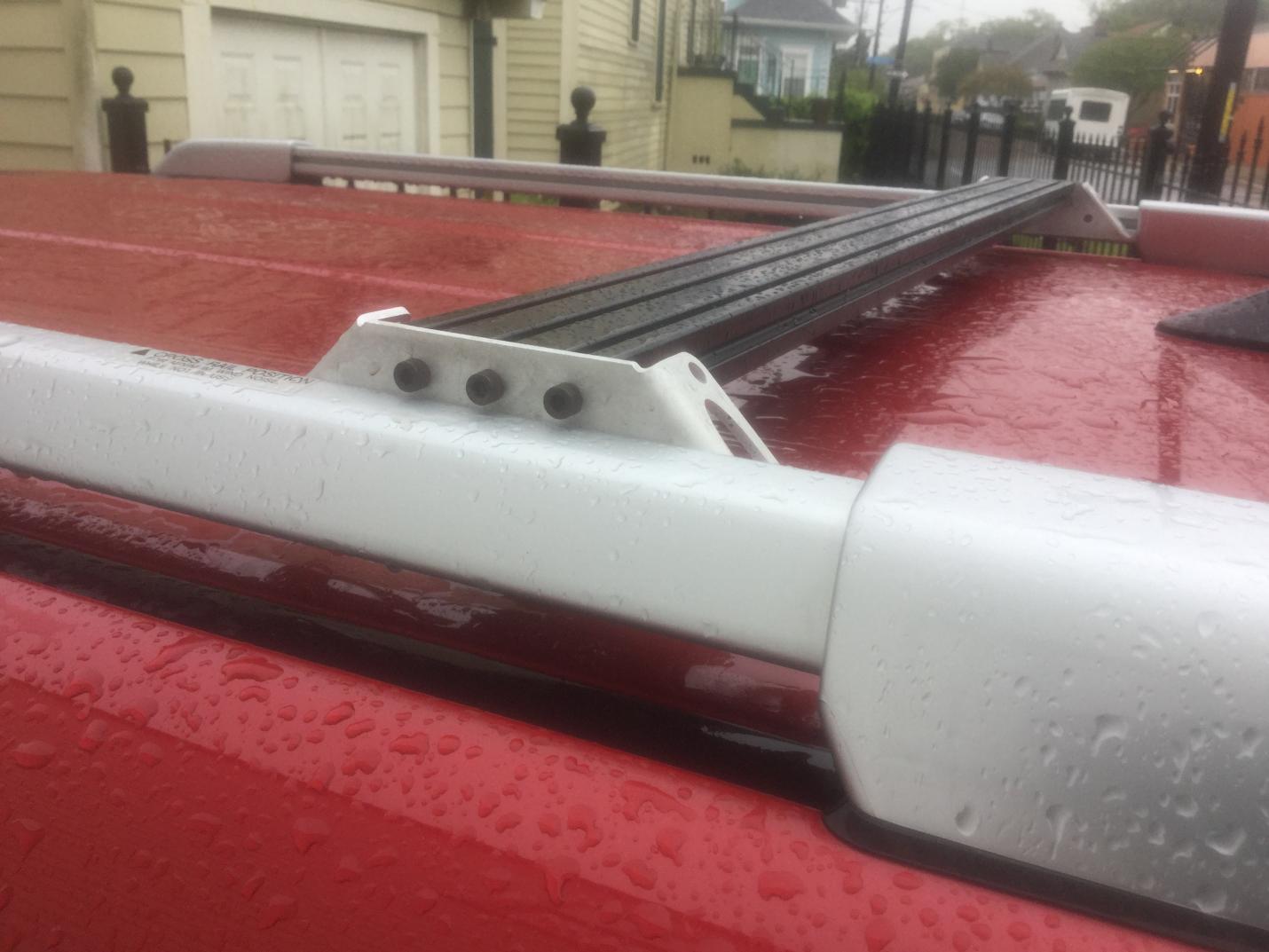

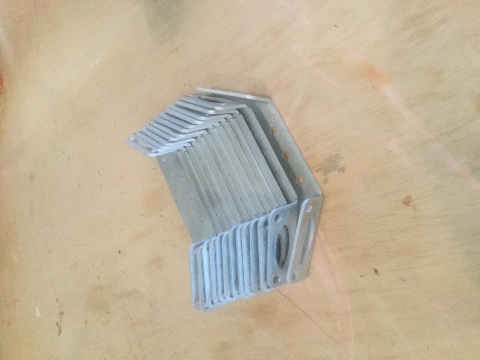

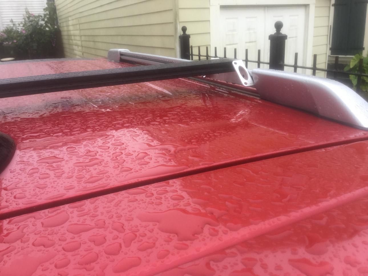

Sorry it took me so long to update this. Finding a place to laser cut these for anything resembling a reasonable price was almost impossible. I had one shop infinitely promise to do it and just never did. I finally found someone reliable at a price that was reasonable. Here is part of the first batch. I’m just waiting on the t slot nuts to have the full “package”. Here is a sneak peek.
Notice that the bars fit so perfectly, they are being held in place with “interference”. There are no bolts holding them to the rail...

Also, I just put the bar with the brackets on the ends on the ground and stood on it. I’m a big guy and it easily held 260 pounds. The bar flexed a little but the brackets were solid and didn’t flex. I think it’s a solid design.
