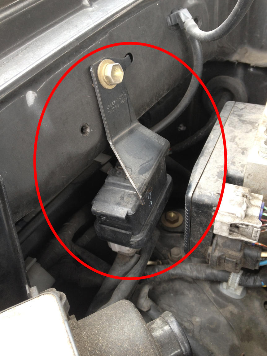

Those components are for the factory alarm system, not keyless entry. My '99 SR5 does NOT have them, but it does have keyless entry. You could try to locate the wireless buzzer on the passenger sidewall of the engine compartment. This is item #2 in the attached diagram. Or you could try to program the system following an on-line FSM and see if it responds.

No, I said the buzzer/chirper thing is on the firewall. There is no module, per se, the wireless function is bulilt into the body ECU and the back door ecu (the receiver part). So the only physical thing to look for is the buzzer:
If you have this thingy in the corner of the engine bay, you have factory keyless entry. If not, you don't. (In this pic, the buzzer is unplugged).
What corner? Looked around, but I can't seem to find it... Looks like the rear, passenger side, corner of the engine bay. I don't think I have it.
I don't seem to have that black patch either. and if that's the same corner as I think it is, I have different fluid and electrical lines as well.
Is this it? it doesnt look quite like yours but it is in the same place and is the same general shape....if it IS it, what next? just order a factory remote?

Okay. I did a little more research. The part I showed is '99-02. You guys seem to be all '98 or earlier. When I search on 'wireless' for a '98, nothing comes up; I can't kind a key fob, either. I can easily fing all that for '99+. So I'm guessing any '98 and earlier keyless entries are port/dealer added, and factory keyless started in 1999.

This last confirms that the module was under the seat for '98 and prior. So if you don't have the module under the seat for '98 and earlier no keyless entry. '99 and after, look for the buzzer in my picture. Hope this helps. Sorry if I confused you guys with the early trucks.
