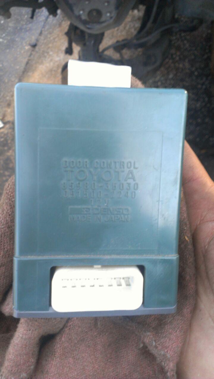

DO you know if this will work in a 98 ? its from a 95 in a junk yard.

Thats the same ECU I have. I dont know about the rear window option though. I know mine does not have that option. The key fob for mine only has the two buttons for lock and unlock. And that one came off a Camry, which obviously doesnt have an opening rear window. You will have to do some research. I think the rear window option came in 99 or 00.

That's the fob and FCC ID I have on a '99 with factory keyless entry and no alarm. Does it also work with the RS3000 dealer/port installed alarm?? I tend to doubt it.

I haven't done it but it certainly can be done on a '98. You just need to find a complete rs3000 somehwere. There is one on eBay right now:
Toyota RS3000 Factory Extra Alarm System Kit VIP Keyless Entry RAV4 Camry | eBay
On this one, would need to find the fobs, too.
All the '98's were port/dealer add-ons, so there really is no 'factory'system.
You cannot retrofit the '99+ factory system into a '98 because that system is integrated into the Body ECU and the Back Door ECU, which is wildly different from the '98 and would be a nightmare to rewire. You could not pay me enough to attempt it.
