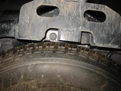

does the spare fit as well? if not, what would you do if you blew a tire on the highway? wouldn't the different size tires mess with traction control and vsc?

I'm still going to try get a new spare in there, but the way it looks with the V-8 hitch isn't promising.

The spare tire/V-8 hitch link is interesting. Here's the 2-D pic that convinced me it might be tough. Your 3-D pic has prompted me to try it soon. I'd be interested in a measurement of the Revo's shoulder width from sharp edge to sharp edge. It's a full 9 inches on the KOs.

It does look as though there is not enough room. But even though the height of the tire is approximately 1" higher than stock it is only 1/2" higher from the middle (radius). In essence, just figure 1/2" more from your tread that is presently next to your truck's hitch and you will see that you will be able to get it in there. BTW, my spare is fully inflated to 36 psi.
Cool. I'm glad you took that good pic. It has been bothering me a tad that I didn't have a full size spare back there. I guess it's time to jack it up and put a wheel in there to verify.
