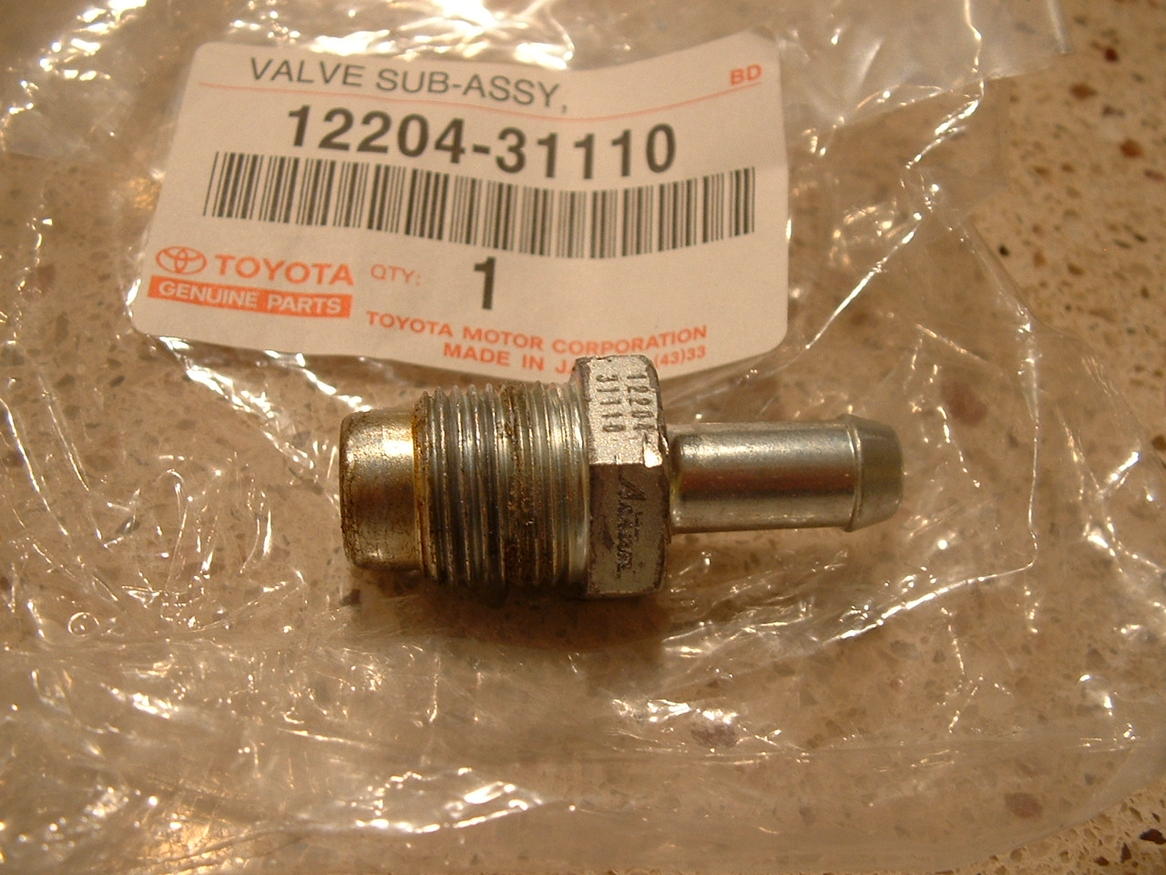

I replaced my wife's PCV valve (2012) this morning at 30K miles. It was over-torqued and seemed cross-threaded from the factory (it was difficult to back out the whole time).
When I installed the new valve (OEM), it didn't seat all the way down to the valve cover. If someone can check their factory installed valve to see if there is a gap (doesn't look like it seats all the way to the valve cover), please let me know. I don't want to torque it down anymore without this info. Thank you!

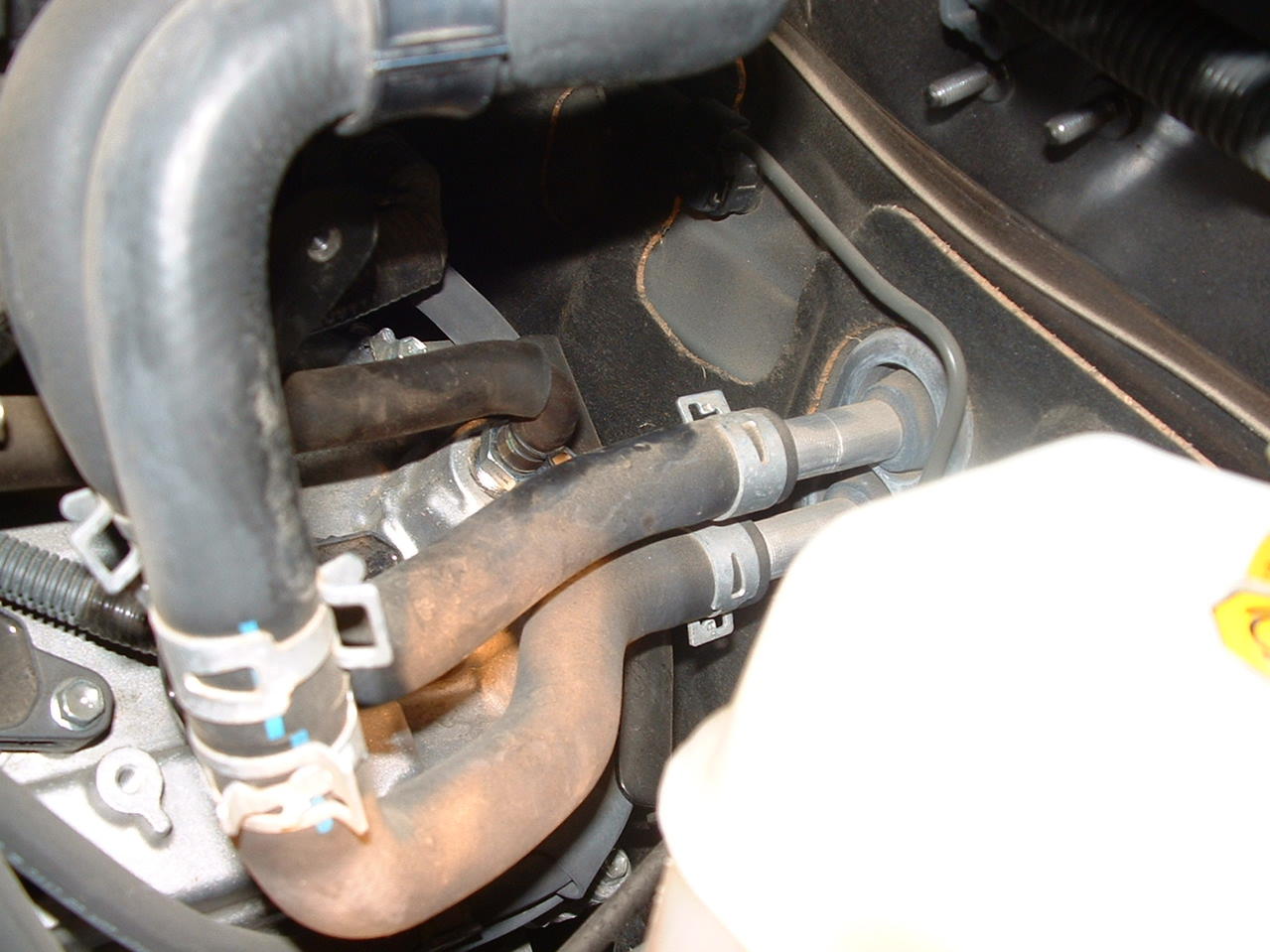

Here is a picture of the original PCV valve. You can see how shiny the top threads are, making me think it wasn't fully seated.
Next is a picture of how the new valve is seated.

Looks like a "tapered" pipe thread to me. Just crank it in till tight. Should be good to go.
Don't crank it TOO tight! Spec is only about 12 ft-lb if I recall correctly.
Ask me how I know what happens if you torque a tapered thread fitting into an engine block too far (oil pressure sender in my woeful case.)

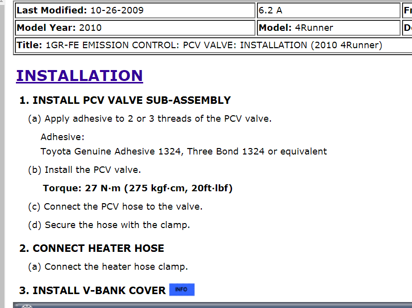

Sorry to resurrect an old thread. Can’t seem to search in my FSM on the iPad.
Is the 12ft-lb torque spec correct? The threads should be dry, no thread lock or anti-seize. Correct?
Doing a little preventive maintenance. Thanks.
I replaced one on a 2GR-FE engine used in many Camry, Avalon, Sienna; Rav4, etc. I did not bother with a torque wrench. I just snugged it down a bit - not getting crazy.
If you have a torque spec, from a manual, I would use it.
In the 4th gen V6 the torq 20 ft-lb, 19mm deep socket.
