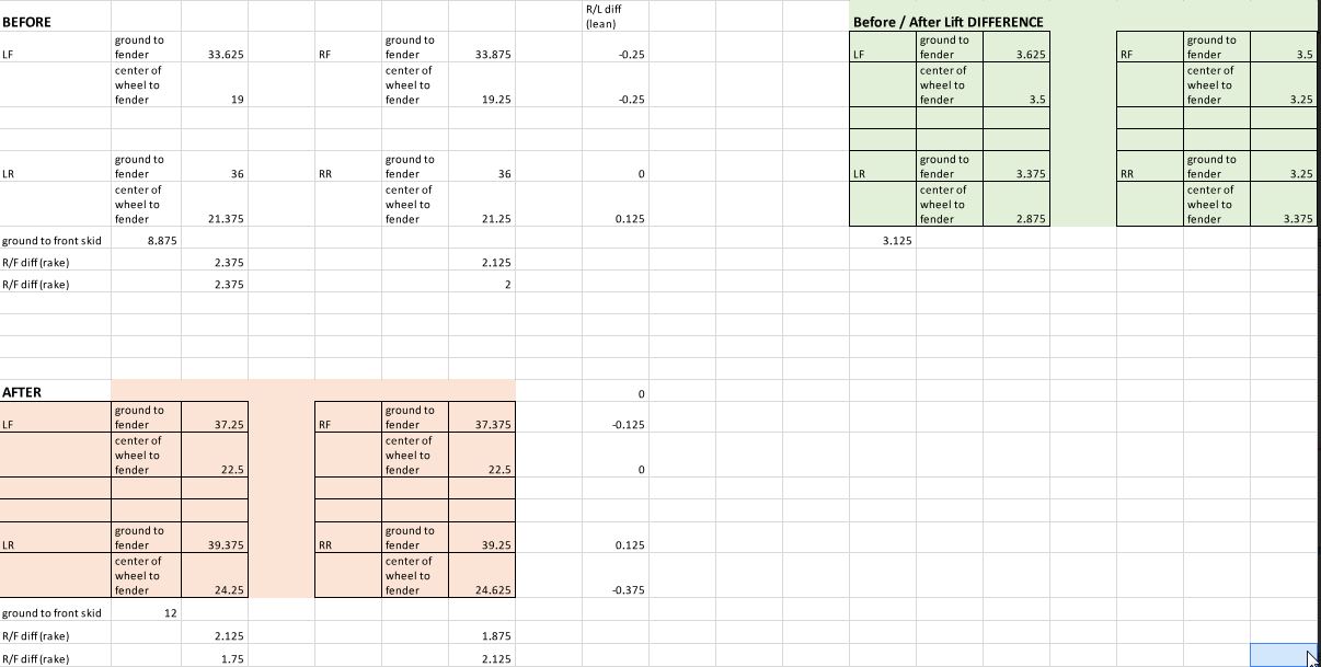

How is everyone measuring to determine lift that was achieved? Everyone measuring from center hub to lower fender/quarter panel lip?
Does 23.5 inches from center hub to lower fender lip equate to 3.5 inches of lift if stock was about 20?

I regret getting the 3" Icon Overland springs. They do NOT handle the weight of a CBI rear bumper and camping gear well. Will be switching out to OME 899s in a week or so.
I measured from the ground to the lip of my fender flares, and made sure I had equal air pressure in the tires when I remeasured. I didn't measure the lift right after it was installed, drove it about 50 miles over the course of a couple days in the city to make sure it was settled.
