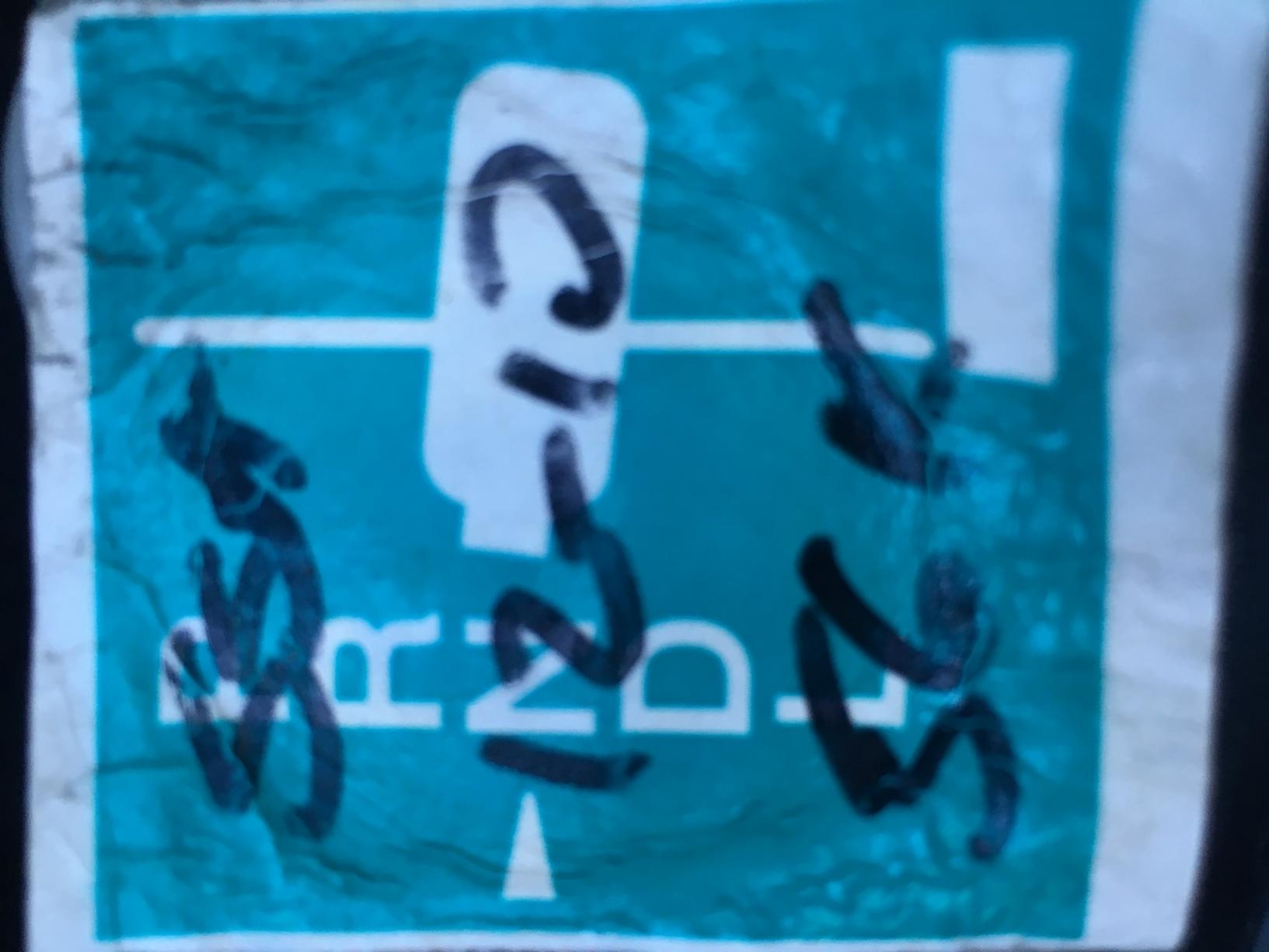

The previous owner kept records but being this 4runner sat so much, I decided to do all the fluids, timing belt, water pump etc. I wanted everything to be up to date and felt better knowing everything has been changed. The only thing left that needed to be done was the tranny fluid, but my mechanic told me it didn’t need to be changed.
I found this sticker under the hood. Do you think this means the transmission was serviced at 56,000 miles?
