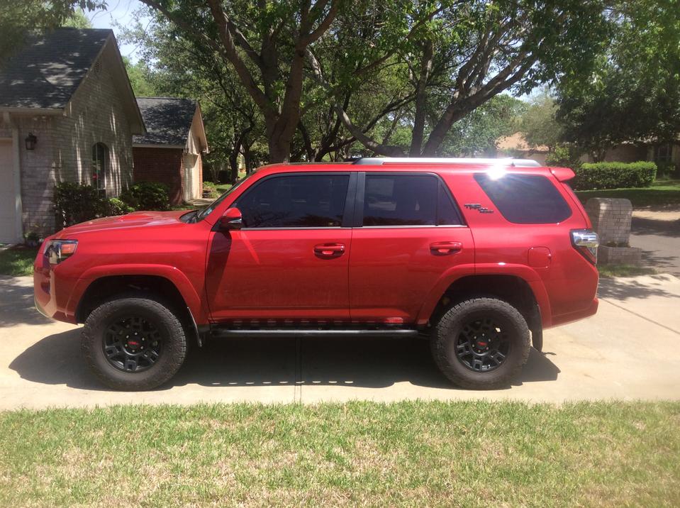

We’ve had our Dobinson’s Suspension on for less than a month. 4,000 miles later and we are extremely happy with the lift, handling, and ride quality. I should have done this on day 1. Thanks to Mike at Dobinson’s and Kyle at Treaty Oak Off Road!

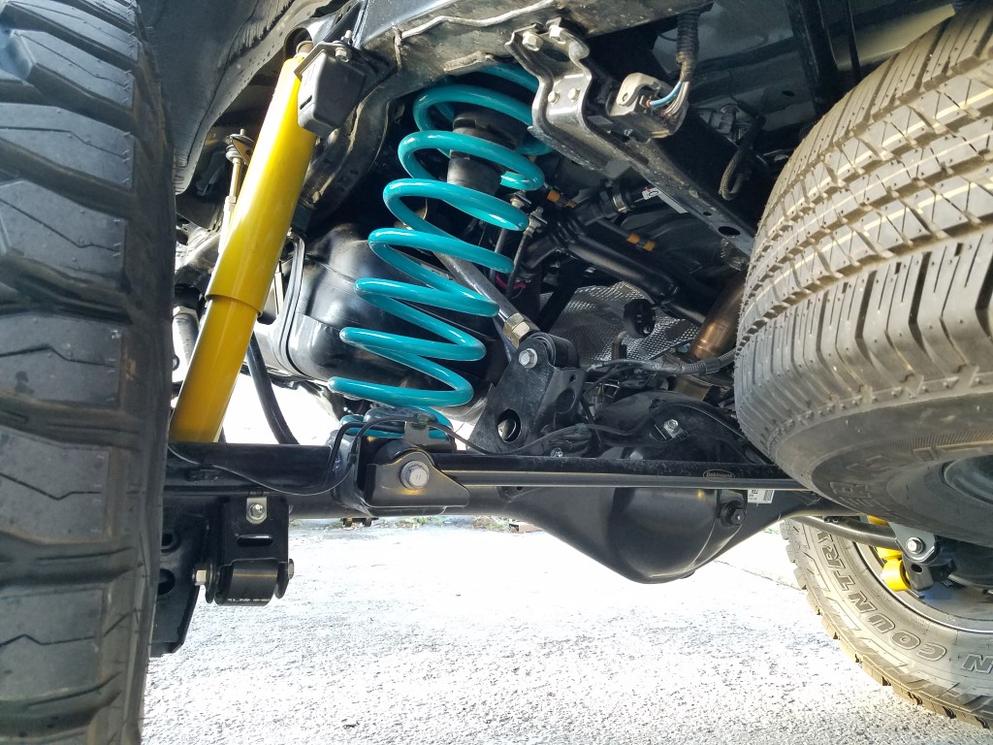

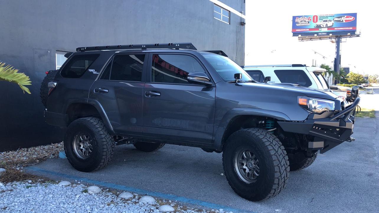

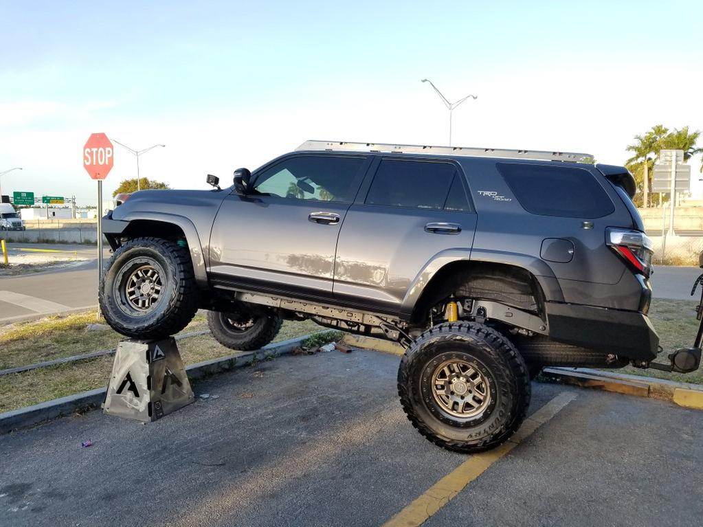

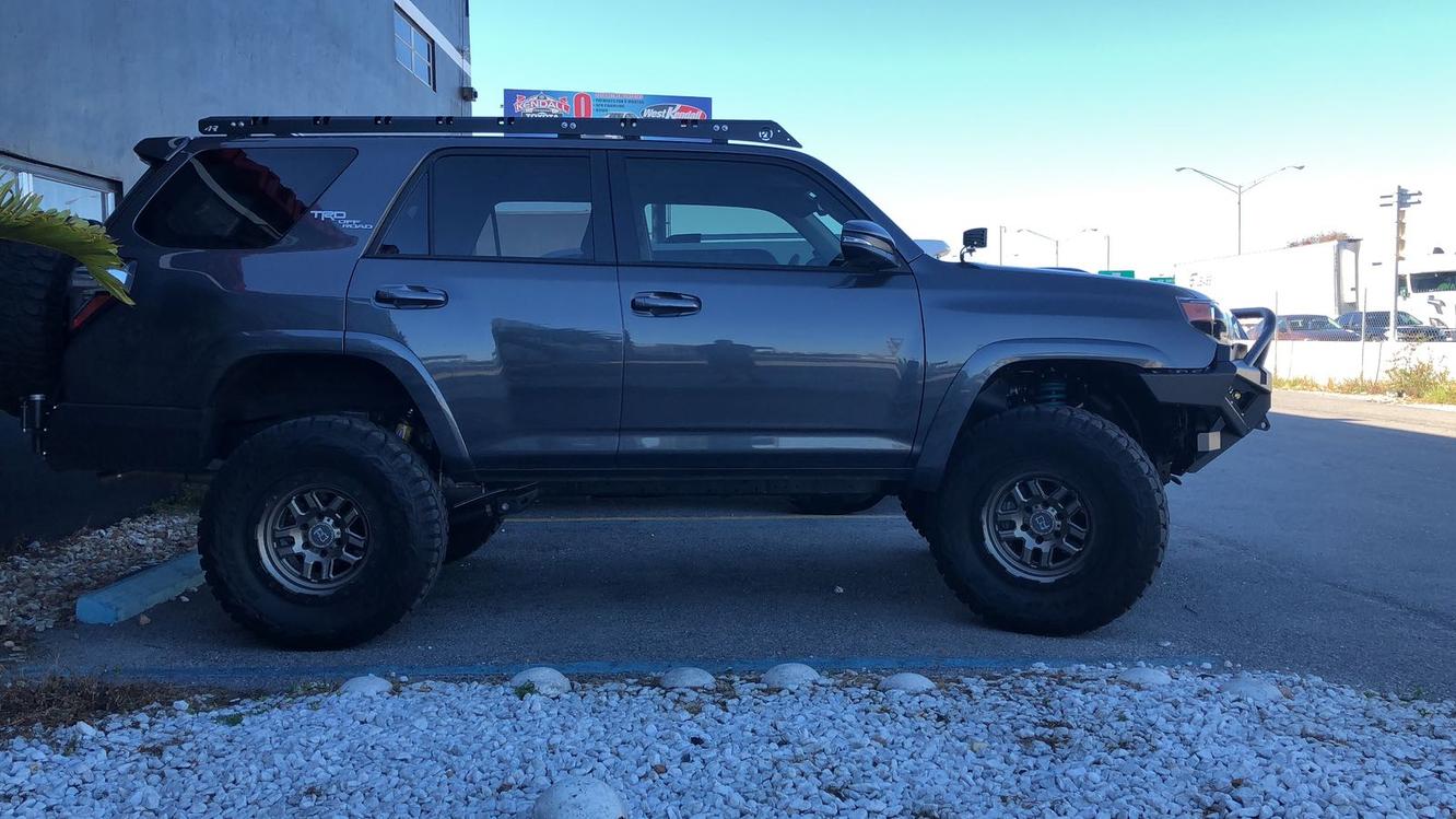

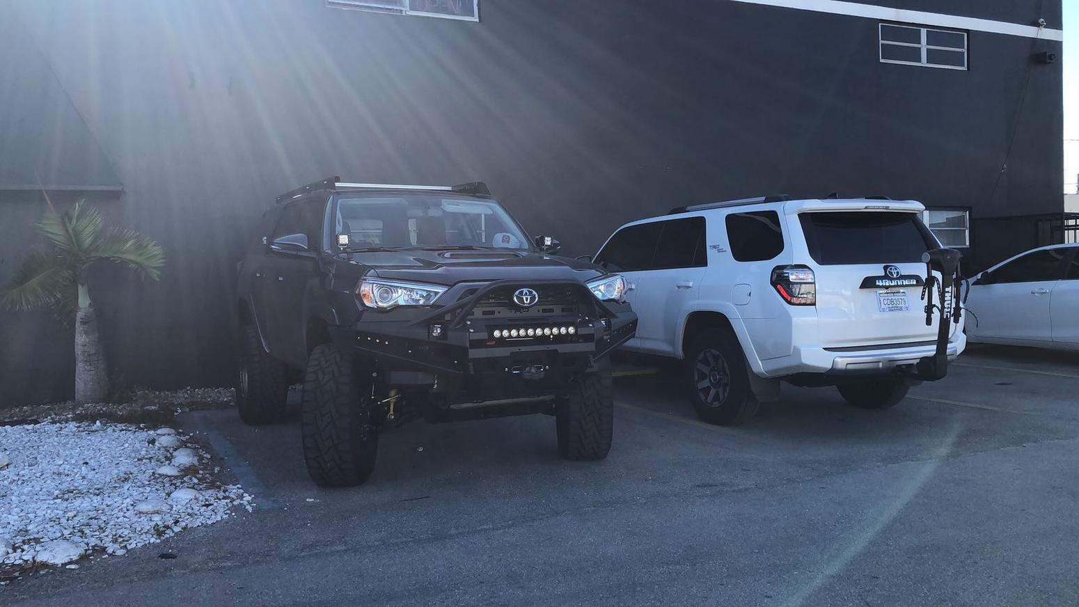

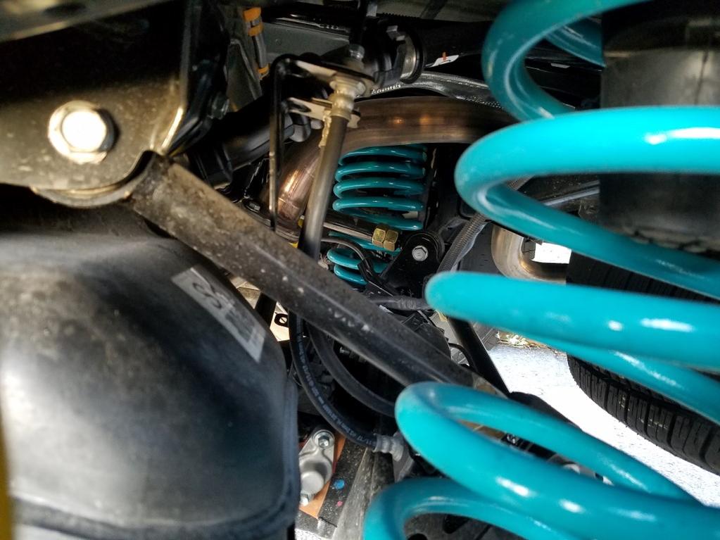

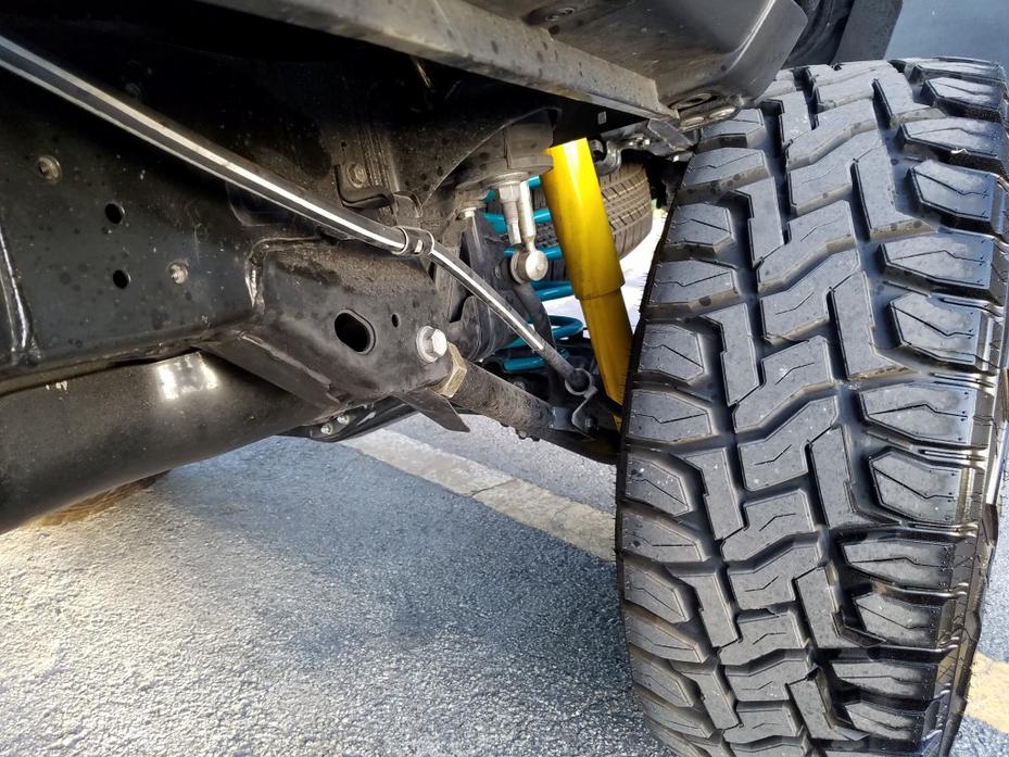

Full Dobinsons long travel setup
Here are some new photos from a local shop, Proline 4x4, who is running all of our parts on their 5th Gen. He's also running 35's, so he cut and chopped a few bits here and there to make that happen.
On the rear, this has our long travel rear coils, shocks, sway bar links, upper and lower trailing arms, and panhard rod.
The front has our GS59-574 struts with C59-352 heavy load coils, UCA's and diff drop kit.
Full parts list:
Front
GS59-574
C59-352
SC59-001
DD59-527K
UCA59-002K
Rear
C59-701V
GS59-575
WA59-520K
WA59-522K
SE59-529
PR59-1423

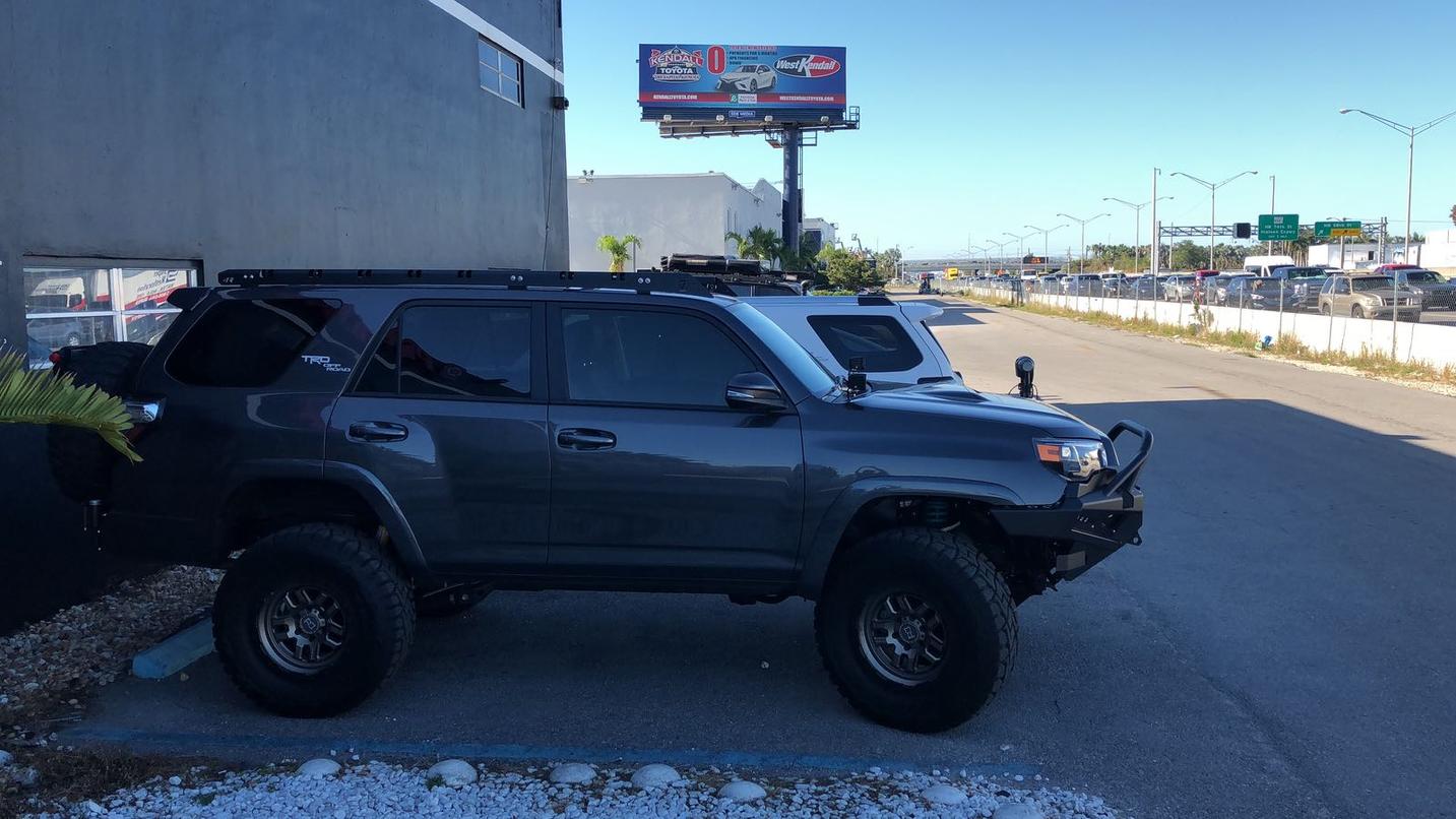

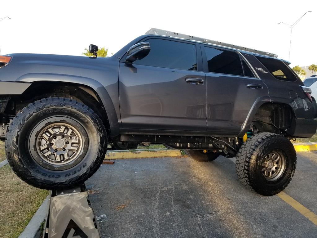

Mike, we need to see more pics of that 4R on 35s! Side shots not flexed? That thing looks good!
Here you go bud :yo:
And look, the spare is now on the new rear bumper!! hahaa
