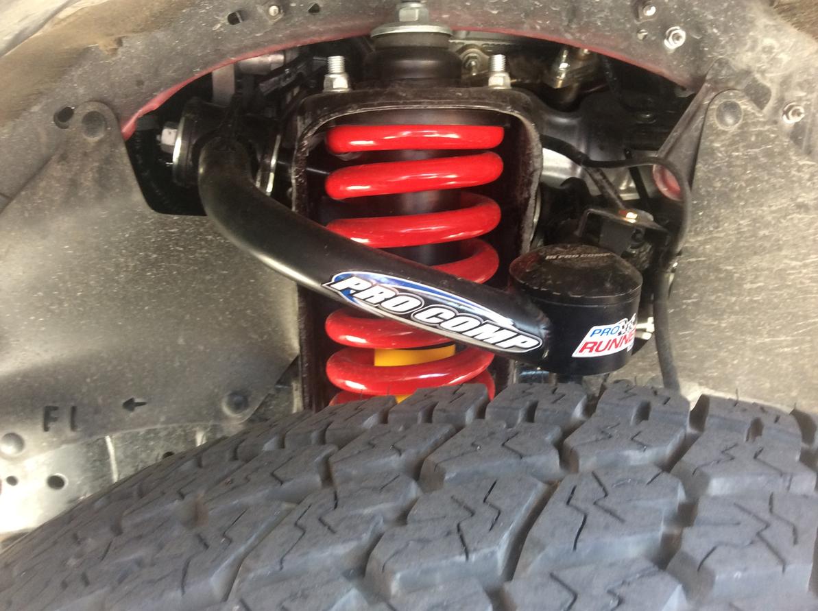

We’ve had our Dobinson’s Suspension on for less than a month. 4,000 miles later and we are extremely happy with the lift, handling, and ride quality. I should have done this on day 1. Thanks to Mike at Dobinson’s and Kyle at Treaty Oak Off Road!
Great to hear you like it. What lift did you do front and back? It looks like you kept your stock UCAS, any alignment issues? Also does your trail have KDSS?

I think if I had to do it all over again, I would have just done the C59-302 front springs, but I was afraid I would break my budget if I had to do UCAs too...

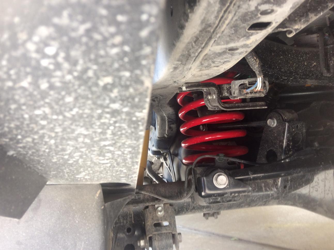

Here you go bud :yo:
And look, the spare is now on the new rear bumper!! hahaa
I really wish I would have went with your 3" heavy coils and suspension all around. The height looks great! It would have saved me so much time and money trying to figure out what setting I would like compared to my 6112s paired with 700lb springs. I've torn down the front countless times. It's funny how I'm now contemplating this when I've gotten it just the way I like it.
