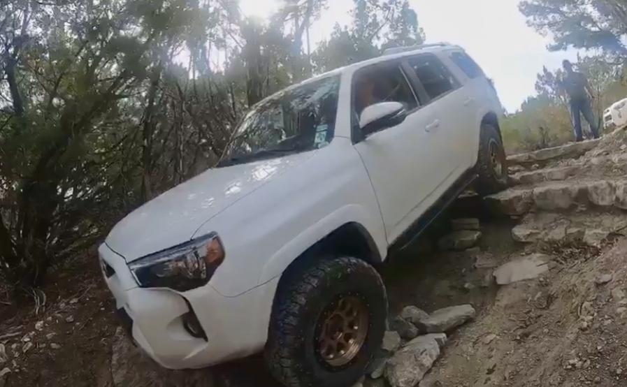

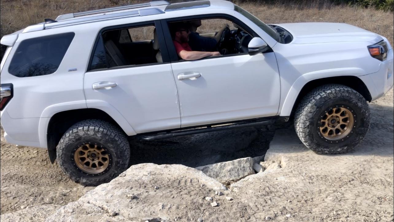

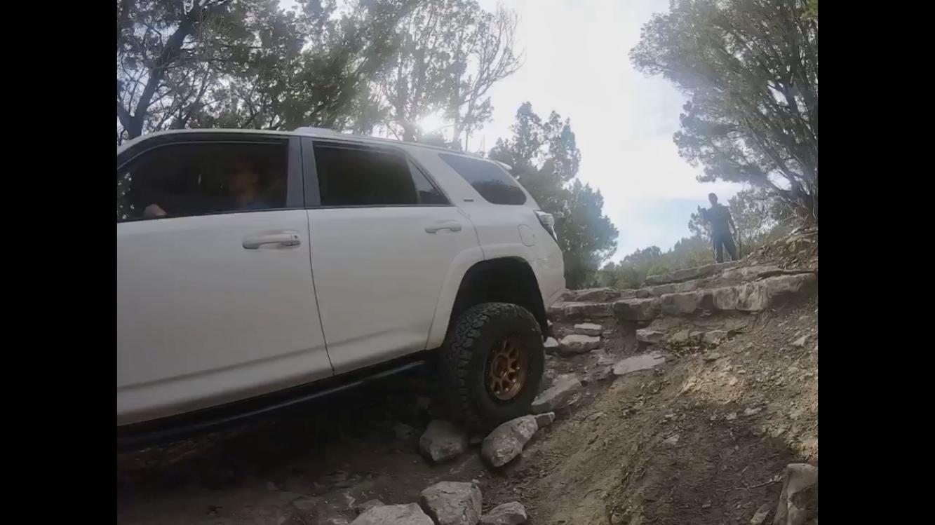

Stretching out the new Dobinson’s lift. It performed very well. Smooth and stable, firm but not too stiff.

2019 ORP w/KDSS
