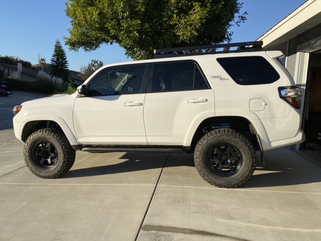

Had time too install the C59-505 In the rear got exactly 1.75” lift. Fronts are set to 2.5” on king shocks adjusters.
Im trying to do the same set up, but unsure of how much front preload on Kings. I would like to know how much ribs are showing on your front coils or how many turns on the coils? Just need the front pre-load settings?
