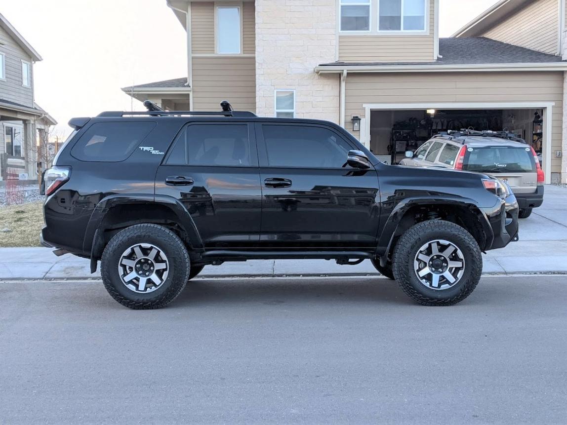

I've got about 25K on them since installing last year, a combination of highway driving, off-roading, and city potholes.
These things have been GREAT! I did recently install my C4 Lo-Pro and winch bumper, so I needed to adjust the height (C302s with std. shocks). Based on the information from Mikes posts, I took the shocks apart (used the no compressor method with a buddy, super easy) and the threads were CHOCK FULL of mud - would have made for a bad day had I tried to just crank the perches.
Once everything was installed I looked stuff over/cleaned up the shocks - they look great, were showing no signs of bushing failure or leaks, and got re-installed.
I've likely set my ride height to the max for these (23" hub to fender now) and the ride is still wonderful, not noticing a lack of down-travel etc. Based on how I drive, I'll likely pull them off again at 60-70K and see if they are due for servicing, but I'm sure I'll end up going 90K before a rebuild happens!

I've noticed ZERO change in ride with the preload - I had about 25K on the shocks / coils before adjusting (I drive a lot). I've taken it wheeling since raising the front, also no disenable difference. For the rears, I've got the C725s (C325 with built in offset for KDSS) which were supposed to be approximately 2" in the rear - they are holding around 2.5", which is why I ended up wanting to bump the front up more.
Once I get my roof rack and RTT things might change again, but I'll assess at that time! My hub to fender measurements are 23.0" F / 24.3" R.
