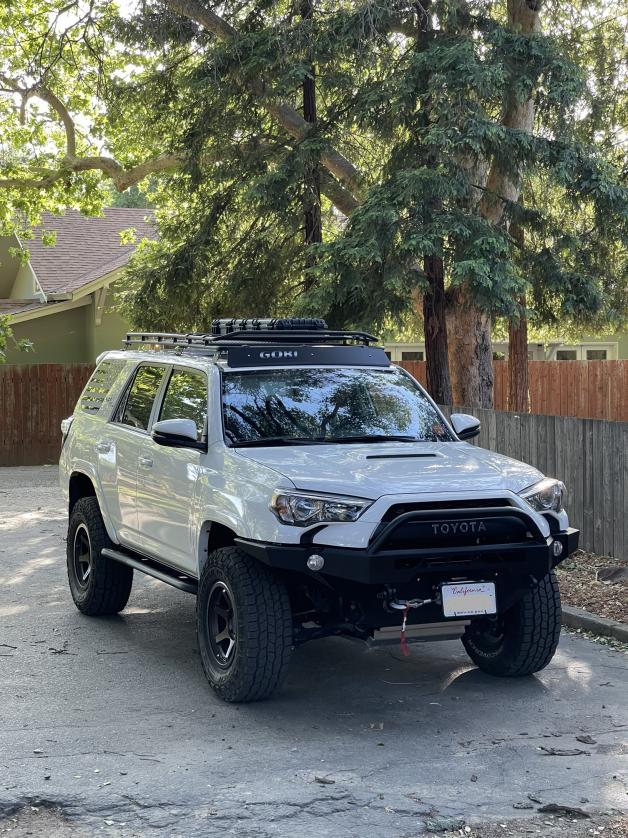

I think with the 505s you'll be very happy raising the front more - my buddy has 302/505 combo and it looked perfect for rake.
I've noticed ZERO change in ride with the preload - I had about 25K on the shocks / coils before adjusting (I drive a lot). I've taken it wheeling since raising the front, also no disenable difference. For the rears, I've got the C725s (C325 with built in offset for KDSS) which were supposed to be approximately 2" in the rear - they are holding around 2.5", which is why I ended up wanting to bump the front up more.
Once I get my roof rack and RTT things might change again, but I'll assess at that time! My hub to fender measurements are 23.0" F / 24.3" R.
Thanks for the info and pic. Looks sharp! How is the tire fitment? You running spacers? Trimming?
Thanks! The tire fitment is great! I've got 255/80R17s. In this picture no spacers on, and no rubbing (just the occasional rub on the mudflap at a weird turn offroading, very minor).
Since the photo I've put on Spidertrax 1.25" spacers. I was rubbing bad on the front mud flap, so those got hacked up - they are pretty much off at this point. I do rub in reverse on the front fender liner slightly, so I need to adjust that or do a high clearance cut - just not sold if I want to do the cut without the C4 wings - so going to mess with moving the fender liner forward this week.
I think it'll be setup pretty good for a different wheel/tire combo (looking at 33x10.5 Kumho RT's next) with no rubbing. The skinny's help with MPG - it dropped with the bumper/winch install but is still holding about 18-18.5 depending how I'm driving.

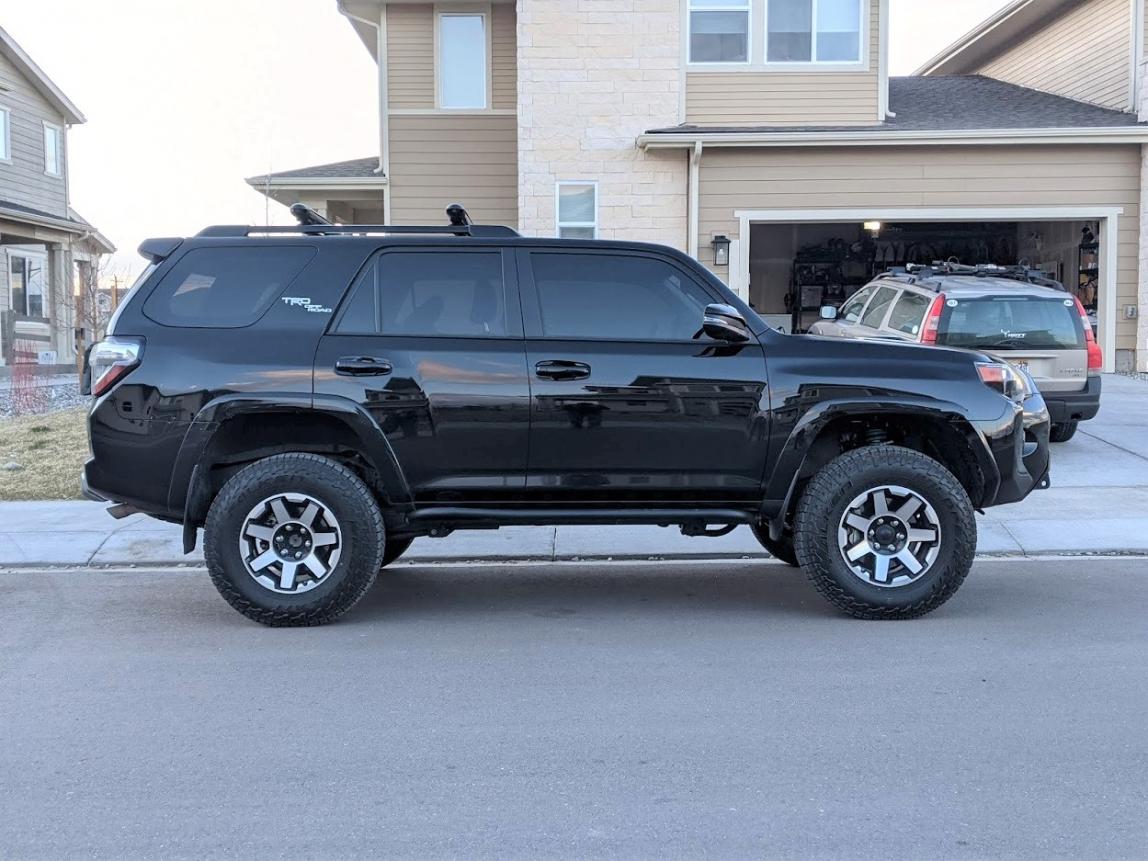

Got everything installed. This is 574/302 up front and 329 springs in the rear. Still running shocks from another Australian mfr that shall go unnamed.
Going to have to fly in some IMS rears under the Mrs radar. Everything is riding pretty tall right now but I’ll get measurements when it settles in. So far very happy with the drive.

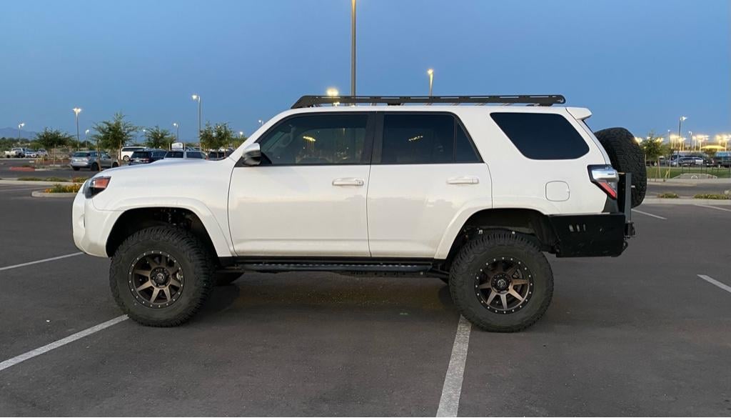

Looks good! I have a similar setup, but with the C302 coils. I'm sitting about 24.3" in the rear (i've got the 725 coils, so the passenger has a built in 15mm spacer) and I've raised the front perch from 213mm to 226mm. My front is sitting at 23.0", which was my max want for having some down-travel left. Just rocked it on 16 miles of very rocky offroad trails over Memorial Day and it road great.
Also much easier to lower than raise without dis-assembly. Just spray some oil on the threads first to make your life a lot easier.
