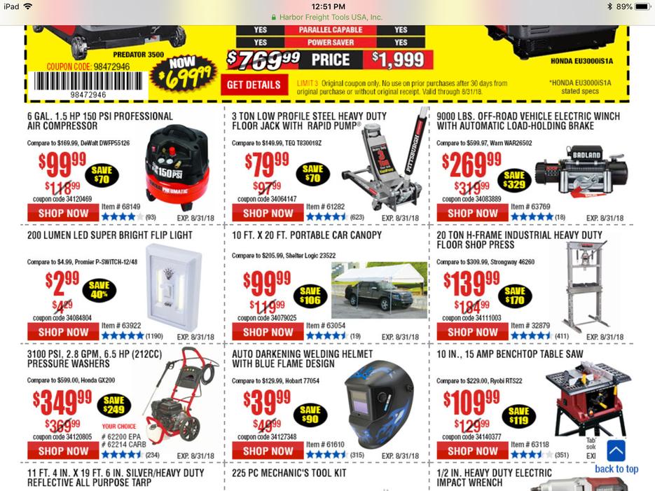

FYI, Harbor Freight has the 20 ton press on sales for $139 until the end of the month. I just bought one the other day.

Is there a coupon code (says $184.99 here) - I used to get Harbor circulars but haven't seen one in a long while, ooh I found a 20% off coupon in my mailbox, which is not bad. Makes this have $37 off:
https://www.harborfreight.com/20-ton-h-frame-industrial-heavy-duty-floor-shop-press-60603.html
FYI - I plan on replacing my LBJs at same time, so will probably pop the ball joint anyway.
