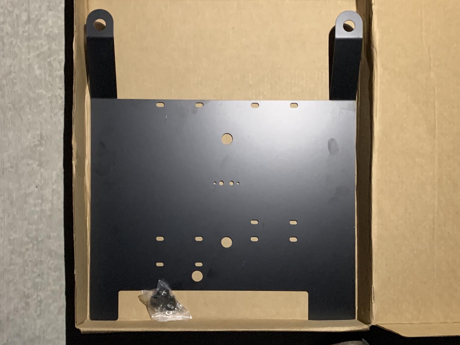

I bought it but it's in storage. If I can get to it I'll post up dimensions. Honestly I'd just get on their chat and ask.
My plan is to put my OEM Audio amps on it plus a HAM radio.

Seems like it’s too tall in profile to use with any other amp but the TacoTunes amp. IIRC the height of their amp is really small compared to most other amps carried on say crutchfield. It’s also hard to visualize this but I’d be concerned about being able to reconnect seat cables.

Their 4 channel amp is listed at 1 9/16” and most amps on Crutchfield are 2”
The rack is as wide as the track under your seat as it uses the bolts for your seat to hold it down. I will see if I can get measurements of it under the seat and how much space is between it and the bottom of the seat.
I have it holding an Alpine PDX900. Works fine, plenty of room. It is actually flimsier than I though it would be, but gets the job done and does a nice job of hiding the wiring keeping things clean.

well.. i could barely fit a rockford prime r500.1 (1.98 x 6.77 x 8.5) and the lc7i together under the driver seat. I have a prime r300.4 (1.98 x 6.77 x 13.19) under the passenger and that fits only by itself

I bought one but sent it back. It was too tall to use with my 5 channel JLAudio amp. I ended up cutting square pieces of 1/3” plywood and slid a piece under the carpet below both front seats. Then used wood screws to mount through the carpet into the wood. I have the anp under drivers seat and an audisson bit 10 under passenger seat. I just installed a ham radio. I used the super duper velcro to stick the mounting bracket to the carpet. This is under drivers rear seat. No room under either front seat. I did use a dual amp wiring kit when I installed the amp and ran 2 gauge wire to a double distribution block. This allowed me to grab always on power from the spare fuse block for power for the ham and a fridge receptacle.
