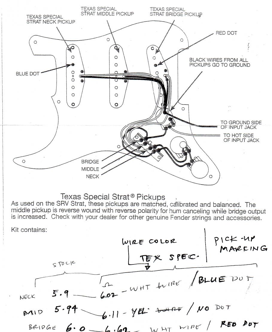

Guitars are fun. I installed Texas Specials on friend's Standard (Mexico-made) Fender Stratocaster, and we called it Jalapeño Special. :)
Right on! I like Texas Specials, but have never had them in any of my guitars. I've gone more towards lower output vintage style pickups, and love the Lollar Blondes I have in one of my Strats. The output you have listed for the stock pups are more my speed. The Blondes are Alnico II magnets and 5.6K neck, 5.8K middle, and 6.0K bridge. They sound sweet! Had some CS Fat 50s people rave about, but didn't do it for me.
