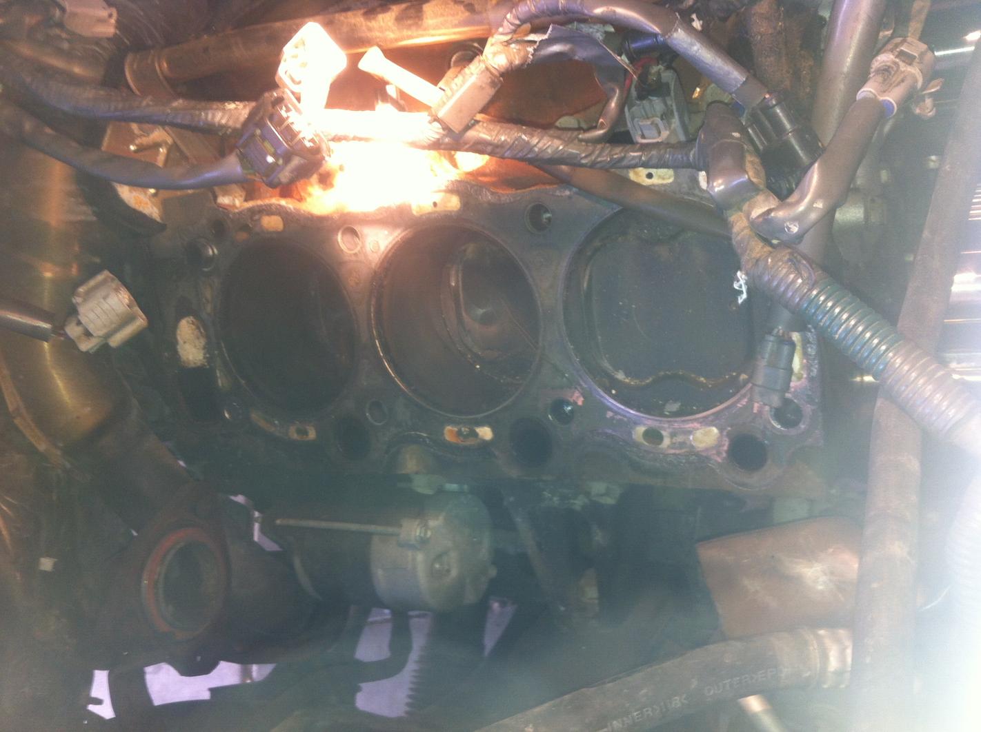

College student here who had a head-gasket go on the driver’s side about 1.5 months ago. Since then me & pops have been working away here and there because we couldn't afford a new engine/labor costs. Long story short: White smoke out exhaust, over heating (actually had my radiator blow on the way to Phoenix-replaced that + thermostat ; then when problems persisted + I saw the white smoke I assumed head gasket), gunk under the oil cap, loosing radiator coolant with no leaks found.
SOO I started making moves for head gasket kit, started disassembly (took so long because we could only work on it for a few hours at a time with my work/school schedule), finally got to the heads this last week. Took the heads in to be resurfaced & valve job - - - - -
George at the machining shop called me yesterday and told me that while the head is cool it holds up, but when it gets hot it loses pressure/leaks. He told me that he recommends buying a good head for my driver’s side.
Where is the best place for a new/refurbished/used head? Should I replace them both?-- The passenger side head seems to be holding up fine, but will this create imbalances? I AM ON SUCH A BUDGET.
--Have some pretty cool pics, I will post in a minute.

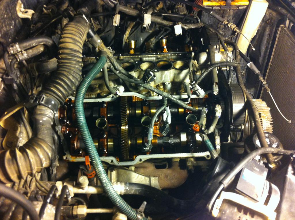

Camshafts, Timing belt, etc still in

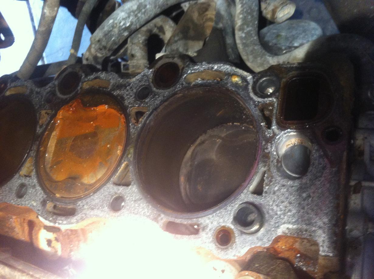

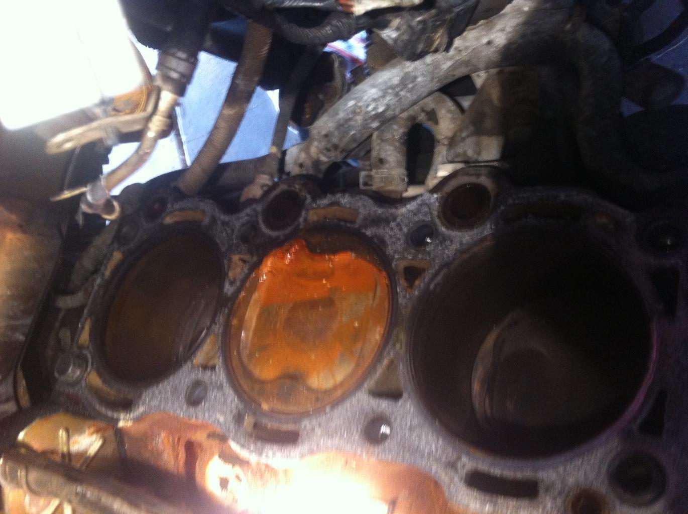

Big jump in progress to Head off*** driver side leak/orange gunk
Same as above
Same as above

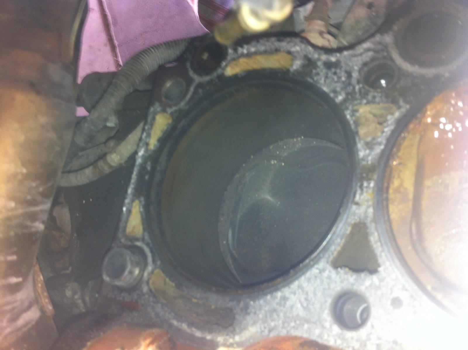

Passenger side head, no leaks

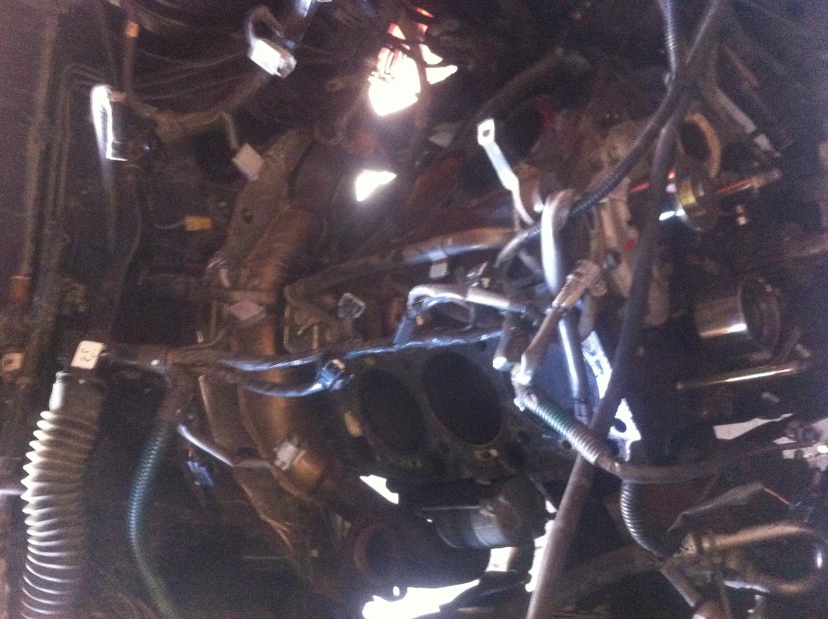

Shot of engine from afar

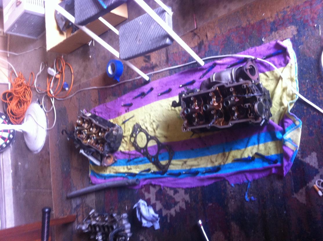

Detached L&R heads & bad head gasket

I can see from the pics that the cooling system has been seriously neglected, which is likely the reason that the headgasket corroded and started leaking.
If the one head is still good after being thoroughly inspected that everything is within spec, and the valve stem seals replaced, then I'd just replace the one bad head.
Once it's back together, flush the cooling system very well to get all of that crap out of there. You said you replaced the thermostat, so that should be good. Ideally you would want to replace the water pump.
I see that you have an auto trans. If the transmission cooler in the radiator is still in use, then I'd also strongly suggest that you replace the radiator too.
Judging by just the looks, it seems the coolant may have been that all makes all models stuff which = bad for seals/gaskets.
